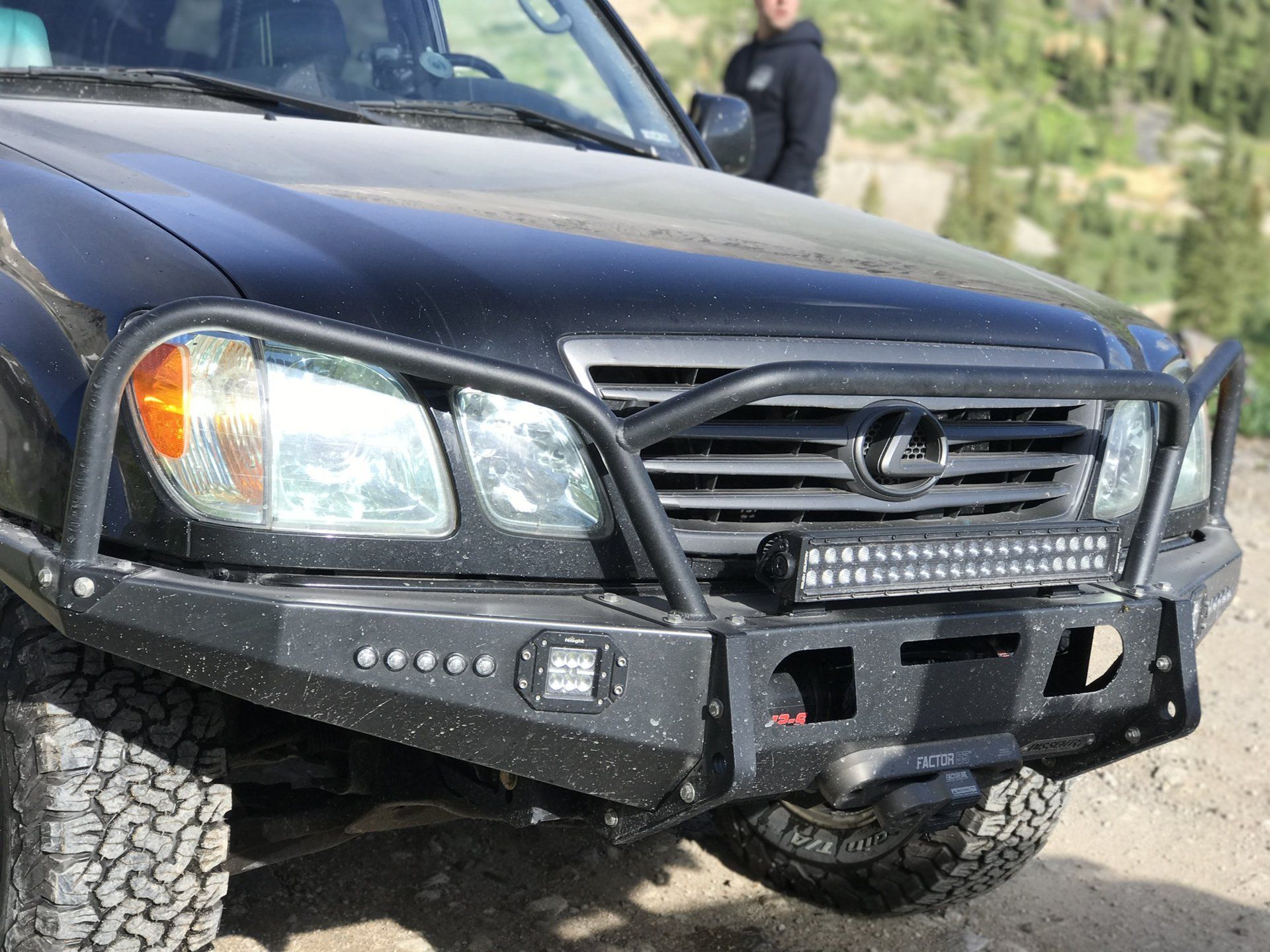

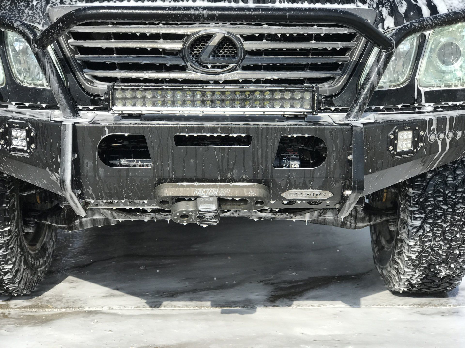

Where did you relocate the control module to for the winch? The install looks really clean. I am working towards figuring out where to put the control module on my VR-10 S winch. I was thinking about putting it where you have the light bar. Ha ha, but I want to mount a light bar exactly where you did.

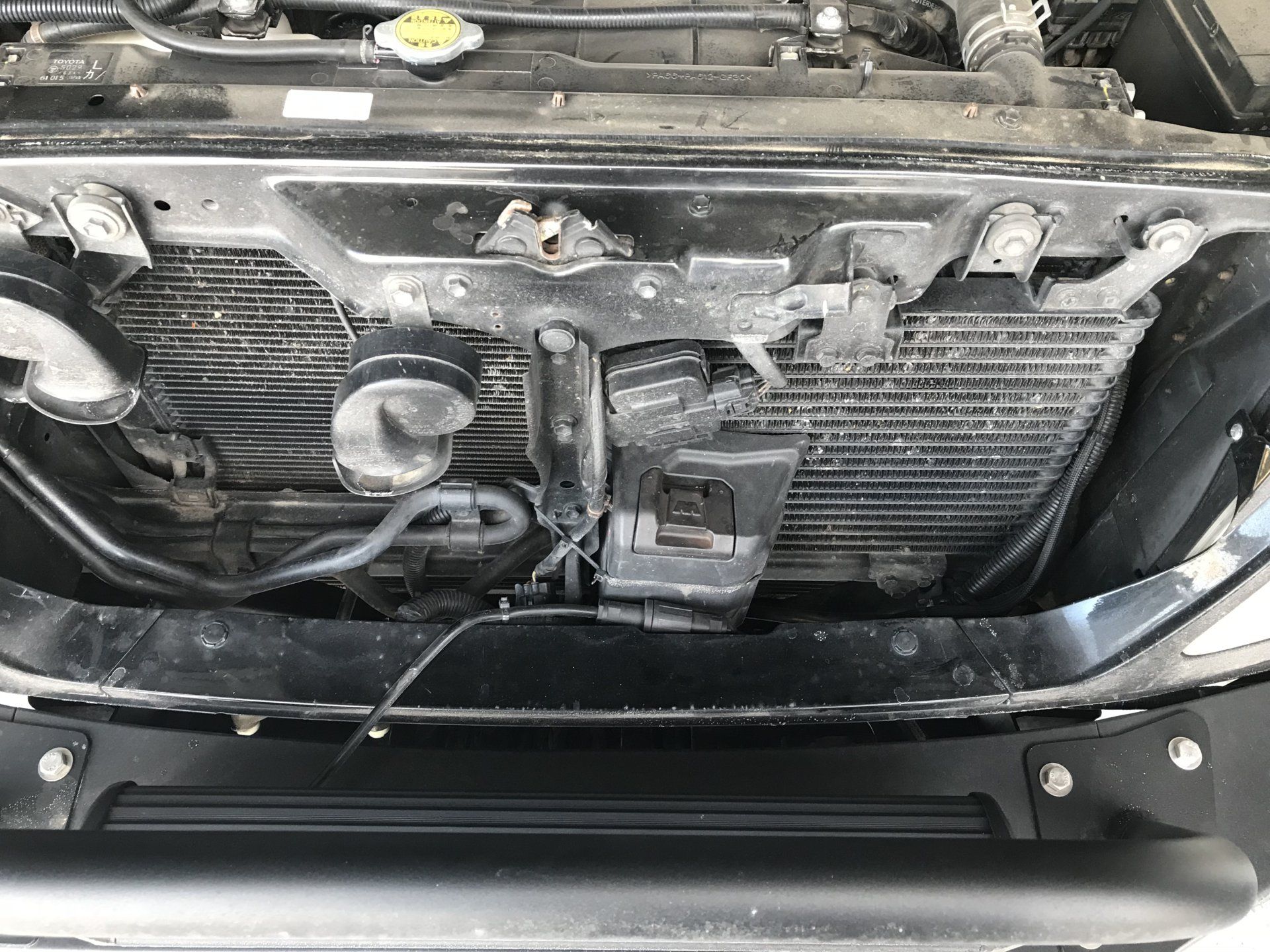

I wouldn’t say this is optimal - but it works. I have it tucked in against the center cross member with a zip tie to keep it from shifting. It’s in pretty tight. The end state intent is to fab up a bracket to keep it tight - but this is working for now ...

You might try and mount that to radiator brace where the upper horn is mounted. Make some L brackets and use the various threaded holes available on the brace to mount to.
Be carful to not let that rub on your cooling fins too long.

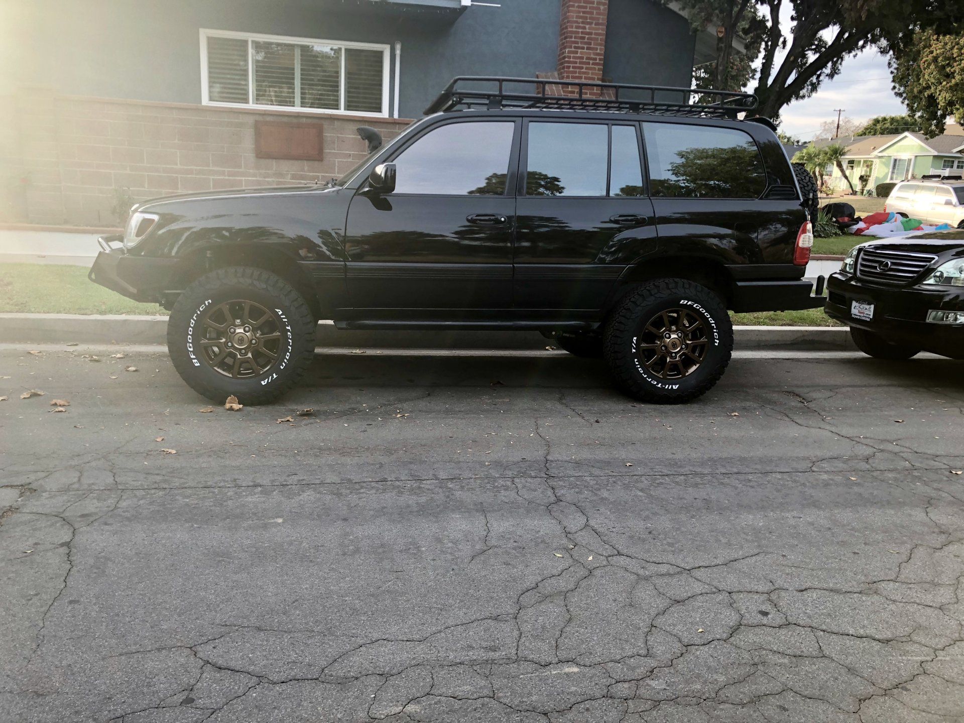

New plates and new tundra wheels powder coated Bronze wheels with 35” ko2’s . I need to find a better color match for the center caps, but not bad for now. Ps. My Cooper STT Pro are for sale in the classifieds. Only 6k miles on them.

Awesome. Thank you for posting up those photos. I believe that I am going to get the long relocation kit and move the module to where I have some extra room around the primary battery. Your setup definitely gives me food for thought though...

Your wheels look great.
I know it sounds corny, but try putting down a wet coat of your bronze spray paint (looks too light in the picture, right?), then when it flashes for just a few seconds but it is still wet enough for another coat to "burn in", dust it with black spray or even better a bronze that is darker. Dust it til it looks right and you should have it. It did a similar deal with my "grey chrome" wheels and it worked great.
