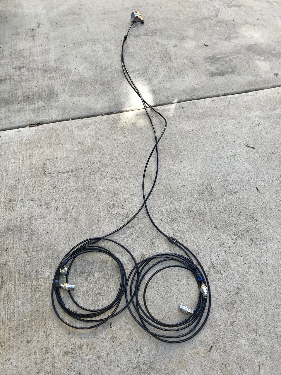

In preparation for an upcoming Baja trip with @Dan2722 and @bushdoctor , I assembled a kit that will allow me to simultaneously air up all 4 tires on my 100. The kit won't shorten the time it takes to air up, at least not measurably, but it sure is easier! Looking forward to putting it through a more thorough test on the trail.
Some benefits:
1. Equalizes tire pressure between tires
Ensures even tire pressure around the truck. Want more air pressure in the rear? Simply unplug the front tires and keep inflating.
2. Hands free operation
A major plus in my mind. Plug it all in, turn on the compressor, and watch the gauge.
3. Works with any compressor and/or truck
Good if you have more than one truck with different compressors, or if your wheeling buddies don't have their own compressor and want to use your OBA set up...you know who you are!
The whole kit...4 air chucks, high pressure air lines, some Ts, a gauge, and a quick connector to the compressor
Plugs into compressor output (mine is at the back of the truck), unrolls on each side of the truck toward the front wheels

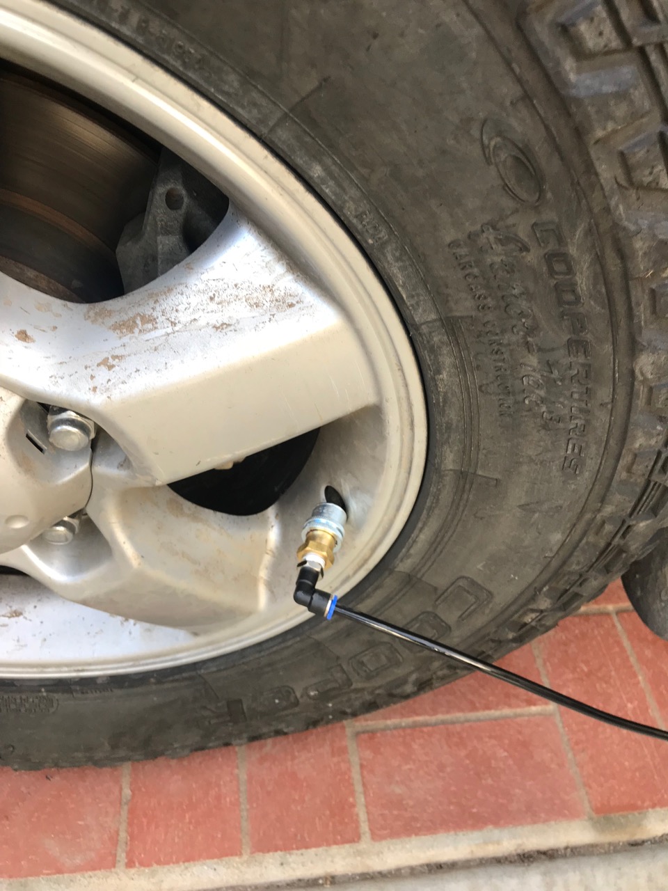

Connect to the wheels

Nice. I know 4crawler sells these kits but I've been skeptical of how well the design performs, with some people saying the tire pressures are never equal and need individual topping off anyway. Interested to hear your experience with it.
