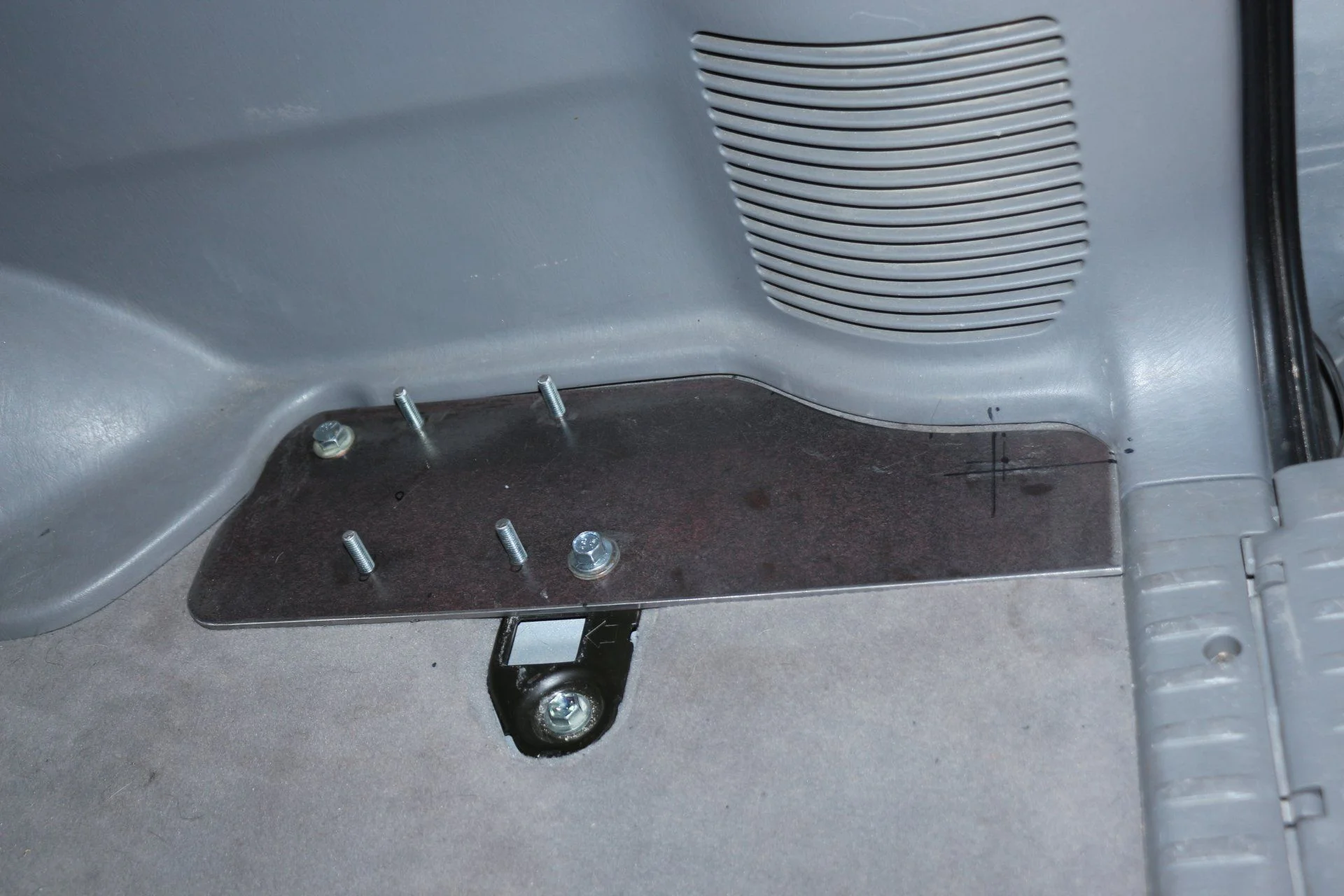

PUMA mount progress
Using existing threaded hole with sized spacers
Compressor mounting studs threaded into base and welded from the back
Spaced so compressor clears plastic fender cover using H@!% plastic with nylon cap nuts.
Super solid do not see the need for the 3 bolt on the tail base. Looks like I will be cutting off ~6"

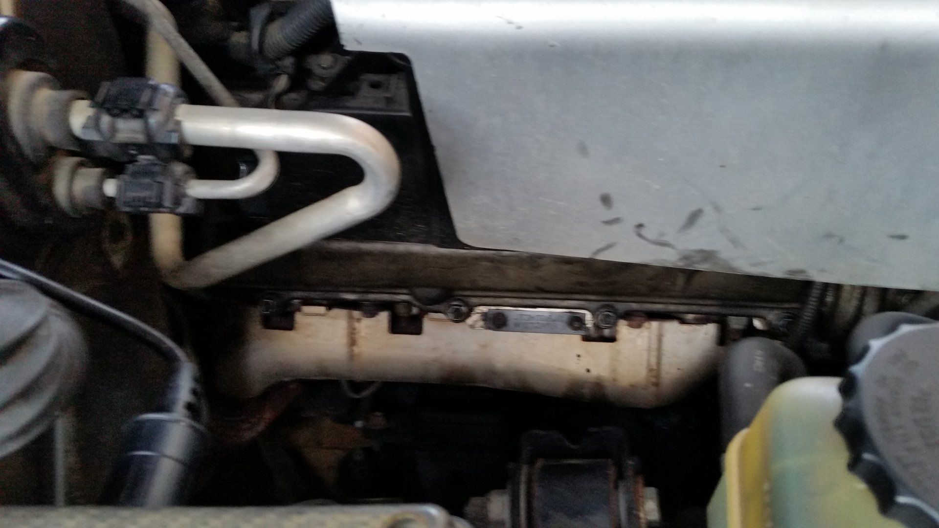

Tightened up my valve cover bolts (slight oil leak, very loose! ) Also routed my winch control cable thru the firewall and into my glove box!

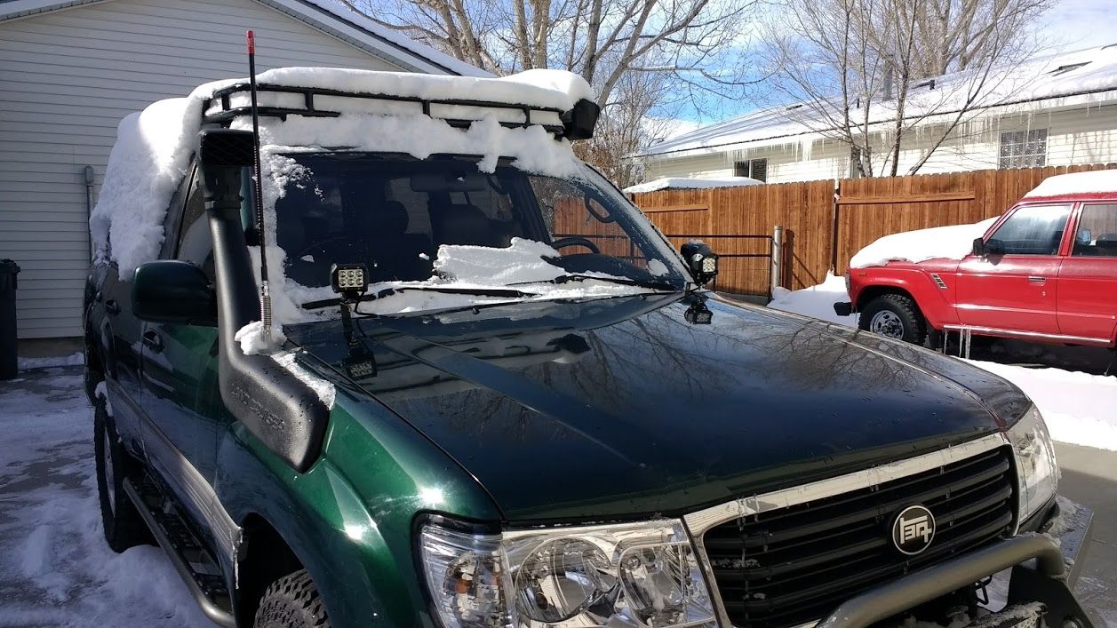

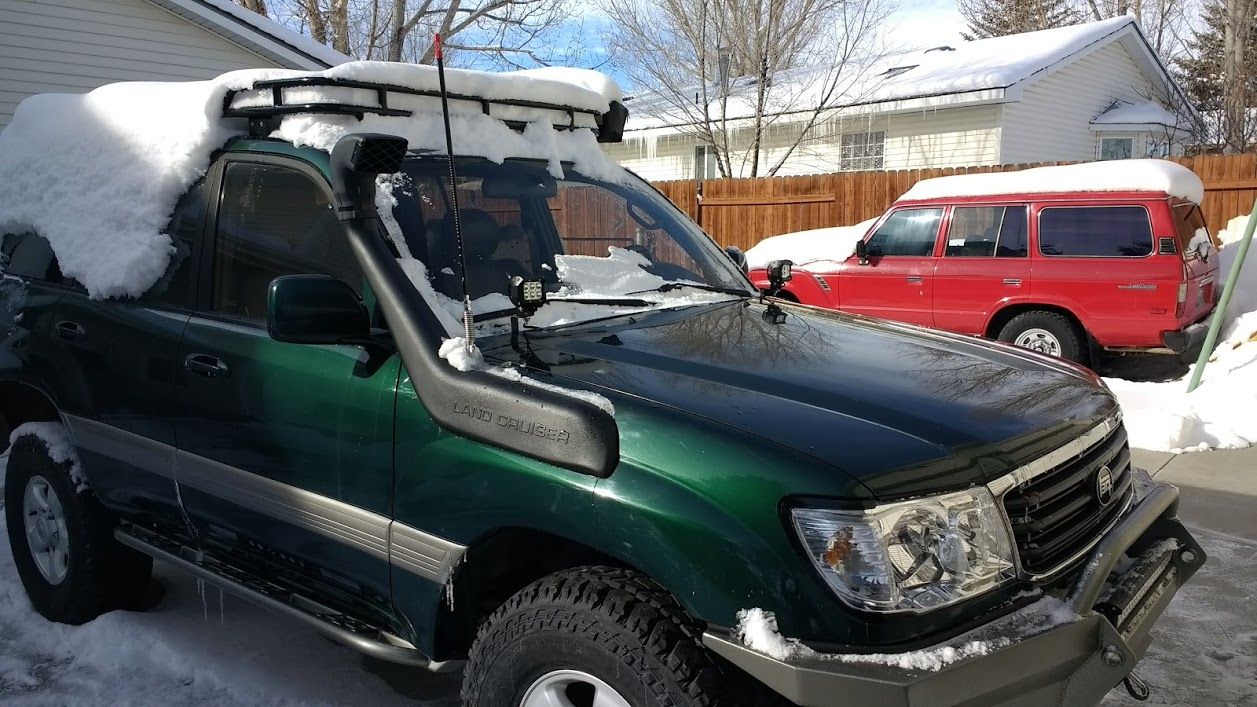

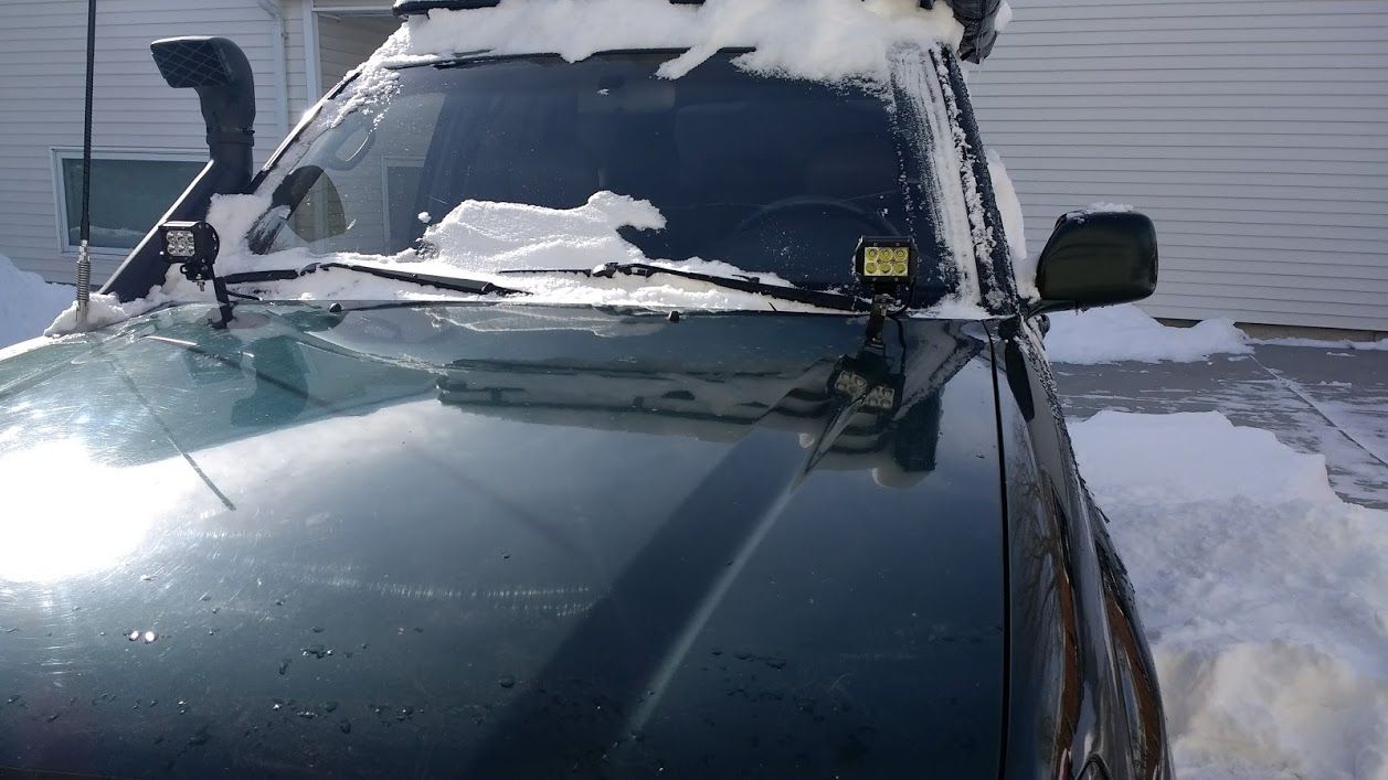

I was contacted by @krice118 about making some LED hood pod mounts. I had some time this morning, so I bent some brackets to get a feel for the location and height. I prefer the one on the right, but I think I'll drop it another 3/8-1/2". At that height the windshield to pod clearance/spacing will still be good.
These are 24W CREE pods.
Let me know if anyone else is interested in this.

I don't really like the light placement I would prefer more on the side but that's just me and understand its hard on the 100 but this would be awesome for a gopro or similar camera

I think I want the edge of the pod right at the hood opening and then dropped up to 1/2".

I tend to agree. Any chance of supporting other types of lights?
Funny though that you posted this now as I was going to post this weekend and ask if anyone had tried to do this yet.
Do you happen to have any close up photos of the mount @reevesci?
Thanks for keeping us all well stocked with your work.

If I were trying to do something like this, I kind of like the concept of Yodateq mounts for the 80 series:
Ditch Light Mirror Mounts - FJ80 Toyota Land Cruiser Lexus LX450
but this probably wouldn't work very well on the pictured 100 series because of the snorkel.

IMO it might be cleaner to do the mirror mounts like Yodateq:
I'd buy these if they made them for 100's.

I want the edge of the pod right at the hood opening and then dropped up to 1/2". Any further out and the pod will always be the first strike point. While not an issue for some guys, the ones in the wooded areas will always be at risk of damage.
The mounting bracket will have to be made to make ease of install for all. Right now, it is looking labor intensive or too large for my liking due to the material span to attach to existing bolt holes. I'll keep playing with it.
J
You may be right, but it sure looks like the Yodateq stays within (or nearly within) the footprint of a folded side view mirror.
