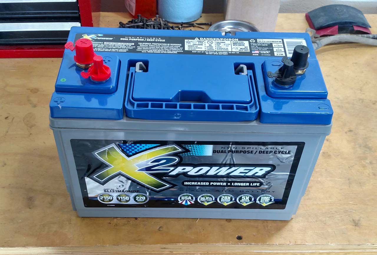

I finally got around to installing the Slee primary upgrade battery tray that's been sitting in my garage for over a month now (this roughly translates to: I didn't go skiing this weekend) and a X2 Power group 31 dual purpose marine battery. This battery is monster compared to the group 35 Yellowtop it replaced. It weighs 75 lbs and damn near gave me a hernia when lowering it into the bay!
These batteries are made by Northstar and are made in the US.
Specs: 1150cca, 220 minute reserve and a 4 year warranty, AGM dual purpose (starting/deep cycle)
Eventually I will install a dual battery setup, but wanted to start with a bigger primary since I will be installing a 12,000 lbs winch and bull bar in the next month or two and I still need to rely on deep cycling for camping and general reliability in the backcountry.
Compare the size of this g35 yellowtop to the g31 X2 in the image below.
