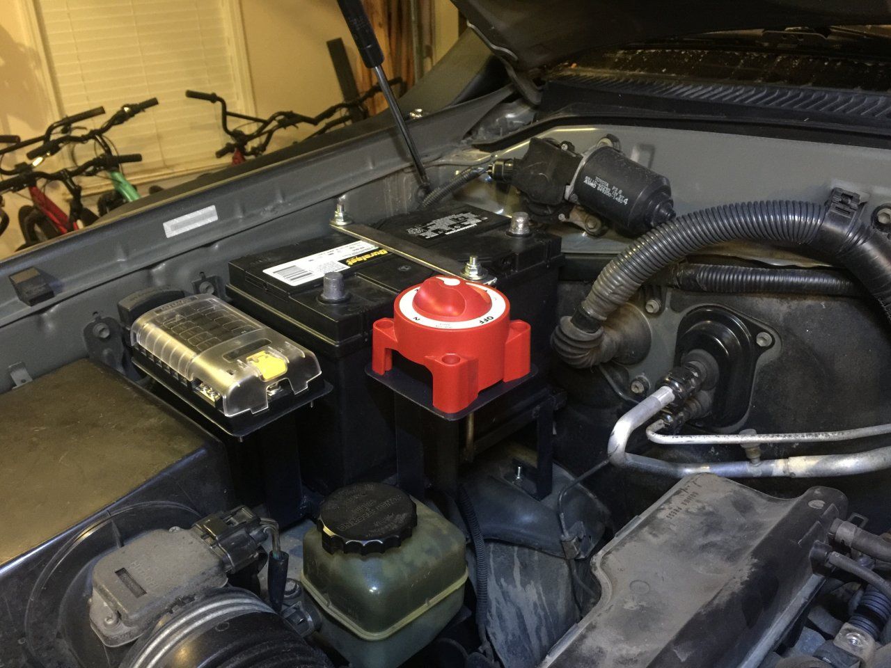

Finally got around to (cooled off outside) to completing my second battery tray. Just needs to be wired up now...
Nice job. May I suggest the addition of a plastic battery tray.

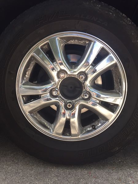

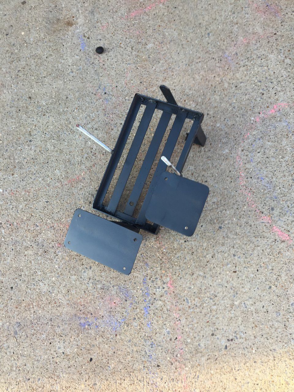

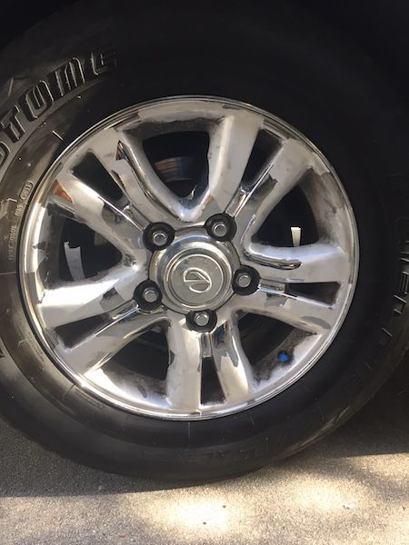

Decided to plasti-dip my peeling chrome wheels. I cleaned them, peeled off whatever I could, cleaned again and applied about 6-7 coats of plastidip (Matte Black). Also did the chrome trimming in the back, the front grill and a squared off area behind the license plate. The last one was to prevent rust, since previous owner put the license bracket on so tight that it cut into the paint and was scratching it off.
Overall pleased with the results.
Thanks. Just curious, every car I've ever had, had a factory OEM plastic tray. Why?
Looks good! I've been debating doing this to my wheels as well until I get new ones. Any more pictures of it?
Acid can't eat plastic or glass, helps protect the paint and metal.
Tip: When cleaning battery always sprinkle with baking soda to neutralize acid before rinsing lightly with water.
