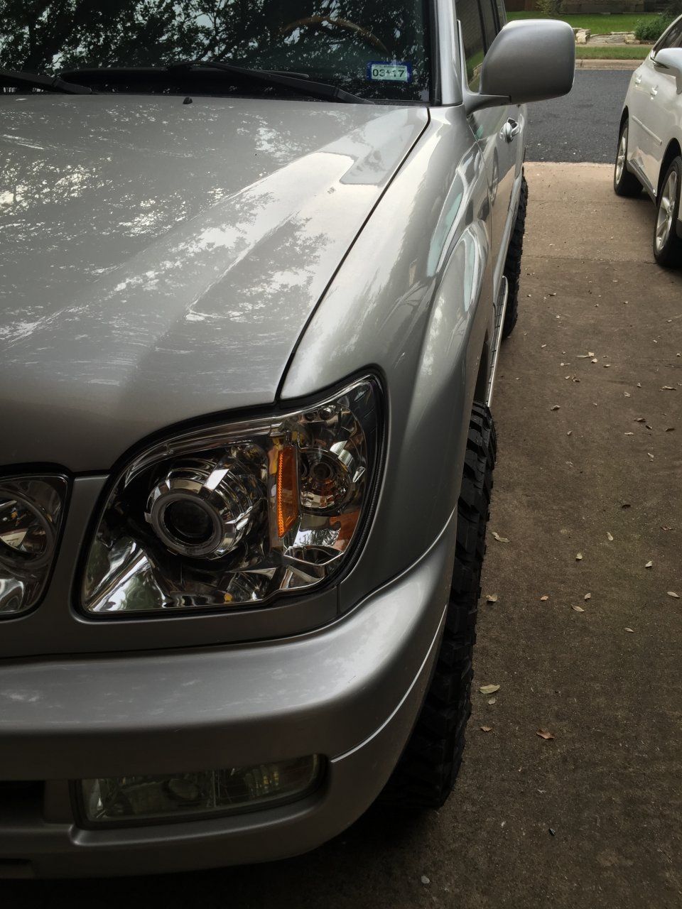

The rims I'm running have a 10mm offset which is prob why it sticks out a little. I may go with 275 or 265 may be flush with the wells. Rubbing slightly only right turns. May have to do the AHC lift mod/tbars/slee 's 30mm spacers.
eBay lights were installed by po. Not a fan...but they work pretty well. Know anyone with oem headlights or do I have to get em from the stealership?
love this look, does it rub while you wheeling?

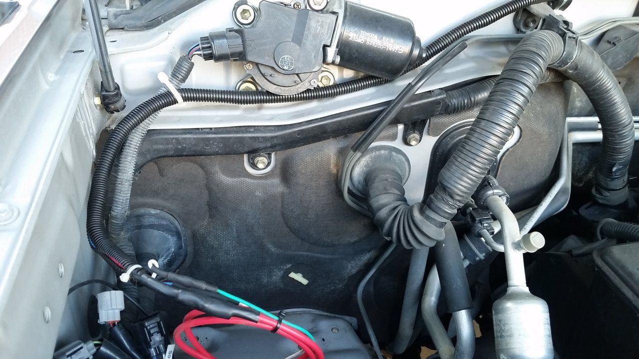

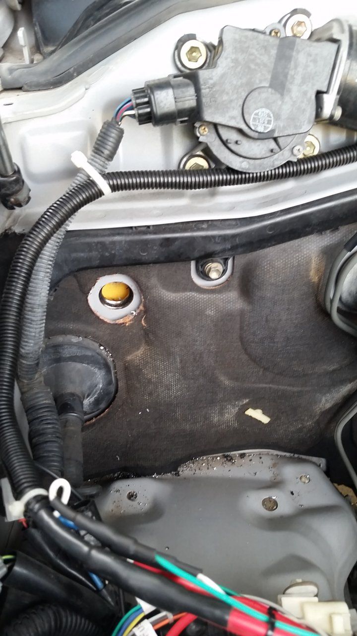

Ok so it's safe to drill here if anyone wondered.
