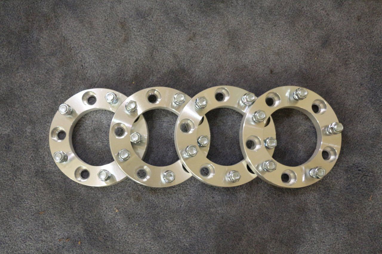

So these show up in the mail WTF I dont even like spacers......
note to self no more late night drinking with PayPal account open:rolleyes:
With all the bad 100 thread on vibs from spacers this should be a waste of time.:worms:

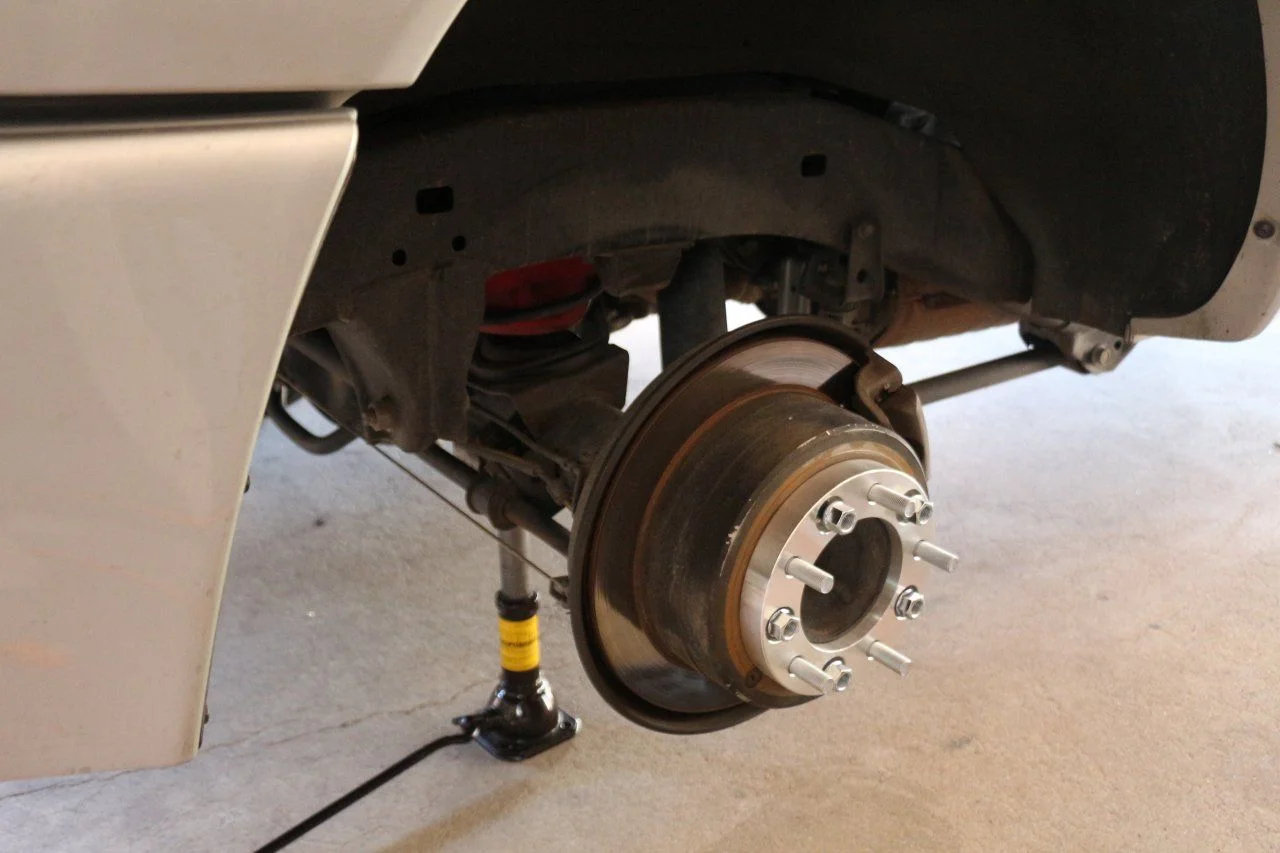

The factory jack with adapter makes for a safe install.
To give myself the best chance I clean all mating surfaces spotless. First test drive <55 is looking good. Sunday I hook up the boat and head out. So far zero vibs the only thing different about my LX470 and most others is Im part time.:hmm: Maybe the game changer with IFS and spacers:meh: I do like the look with the the spacers and the narrow tires I run.

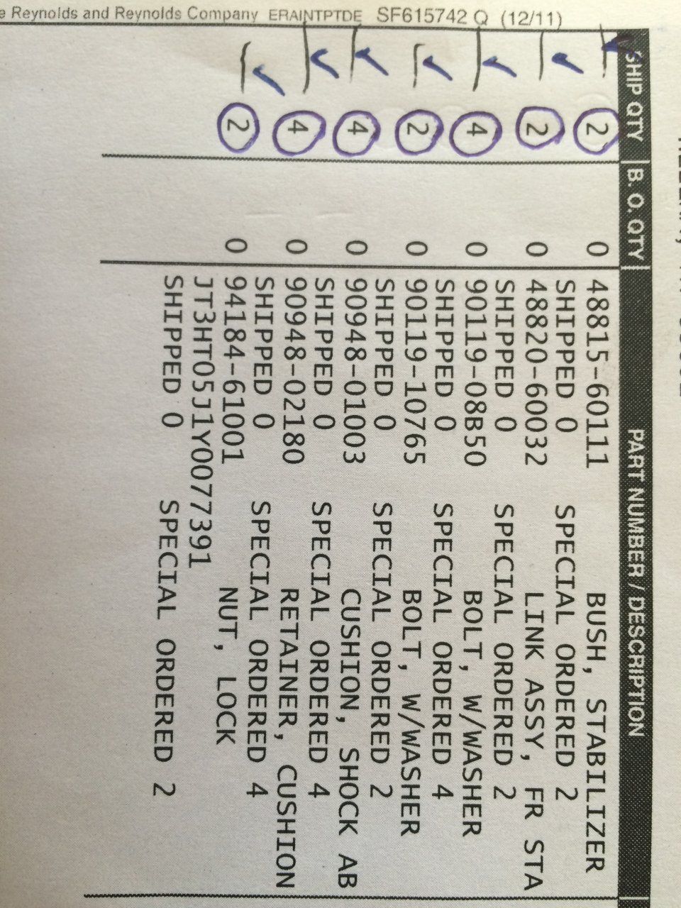

Do you have part numbers?
Part numbers for those that are interested. I have a 2000 LC. Not sure if the part numbers are different for the LX or later years. Sorry for the sideways photo.

Are those 1.25"... am thinking of getting the bora 1.50" -- my current tires are 285/75/16... Look forward to your updates on how well they work for you
The spacer are 1", stock wheel offset, and my tires 275/70-18 slightly taller and narrower than a 285/75-16. I do like the look and hoping for no issues poping up in the future.
