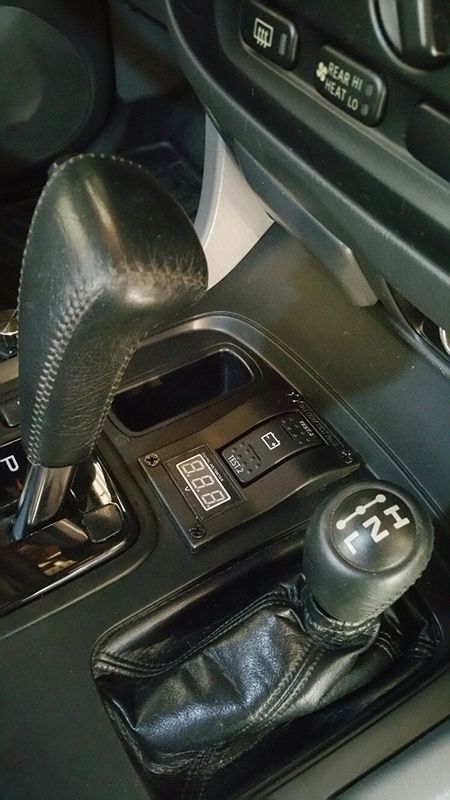

The switches are not the ones I wanted. I have some sitting on my office floor which are so dreamy and Land Cruiseresque but my husband was worried about how they would look mounted. The ones he used ended up looking really clean and I like the fact that you don't notice them at all in the driver's seat. They control the front floods and spots, and rear floods. I wanted them where the ashtray was located, so my husband fabbed up a piece of metal, painted it, and placed the switches there. There is a ton of room behind that ashtray and I'm sure I'm not the first one to come up with the idea to put switches there.
Then, we put CBs in the same place in both LCs. I had a big box connected to the one I had in my 4R and it took up a lot of room. I've gotten a little snotty about how well things mesh with my LC and while I love modding it I still want the interior to look beautiful. I think this cb works well in that capacity.

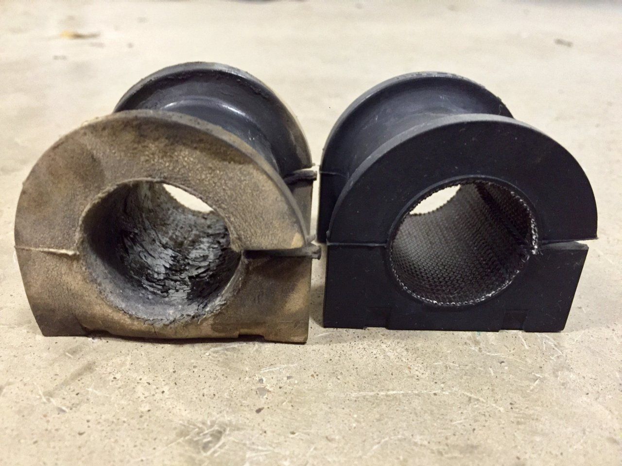

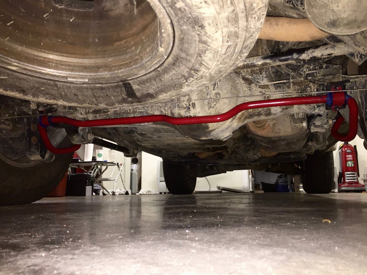

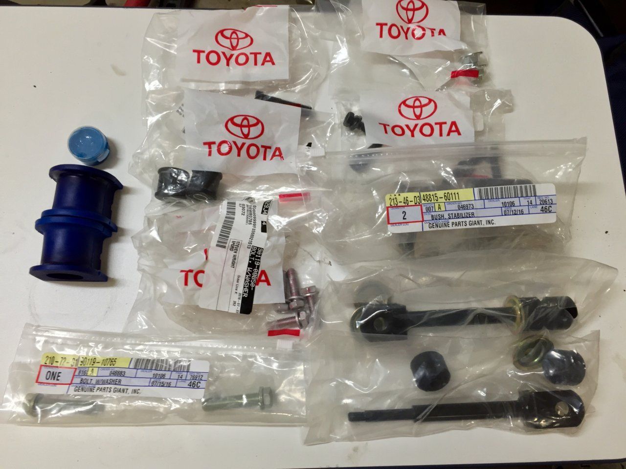

New front sway bar bushings (the ones that mount to the frame), as well as all new rear bushings, links, and hardware. Went OEM on everything except the rear bushings that mount to the frame - decided to go with the Ricochet poly bushings there. I just wanted to see if I noticed any difference with them and hoped they would tighten up the rear sway a little bit more. Maybe, maybe not. Finished late tonight so will test drive tomorrow. Something about a handful of Toyota parts bags gives me a warm fuzzy feeling inside...
Old vs. New (180k)
Also noticed a little bit of pitting in the ASB due to small rust spots, so I wire wheeled and sanded it smooth and hit it with a few coats of red because I wanted to. Went a little overboard on the poly bushing grease but I will clean that up tomorrow. And yes I know my undercarriage is dirty, I took a trip to the Ouachita Nat. Forest last week and just haven't had time to wash her. I'll take dirt over rust any day though!
Old vs. New (180k)
Cool to see the front sway bar removed like that. I just ordered new bushings from Amazon (AC Delco). My passenger side sway bar link broke, so I'm waiting for that part to come in. I kept hearing a donk sound when turning left and found the link bolt sheered.
Old vs. New (180k)
How was the ride, did you test it yet?
