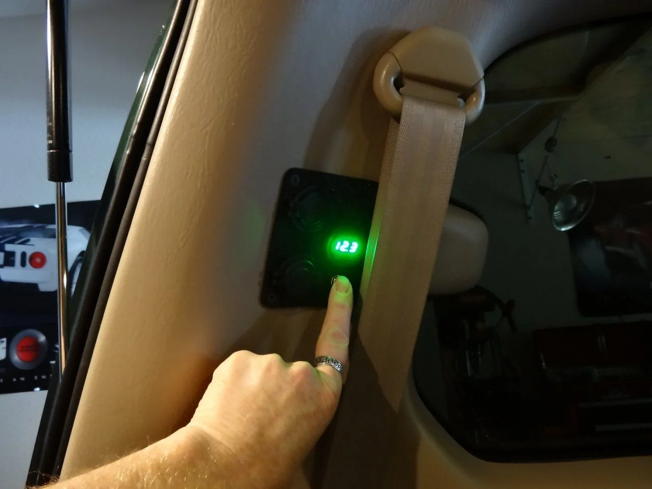

I got my cargo area 12 volt system wired in, and the LED spot lights in the lift gate. I went with the "warm white" LED's due to their similarity to incandescent lights. And it's a great amount of light! I also fabricated a simple panel to hold the 12 volt charging ports. (usb and the standard type), and a volt meter. I wired in a momentary switch so the meter only comes on when I need it. It all came out very clean!
