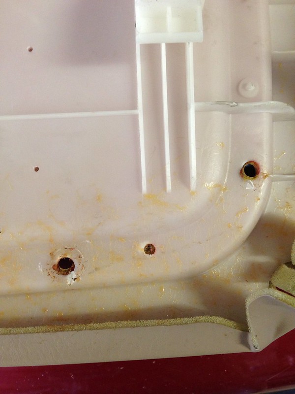

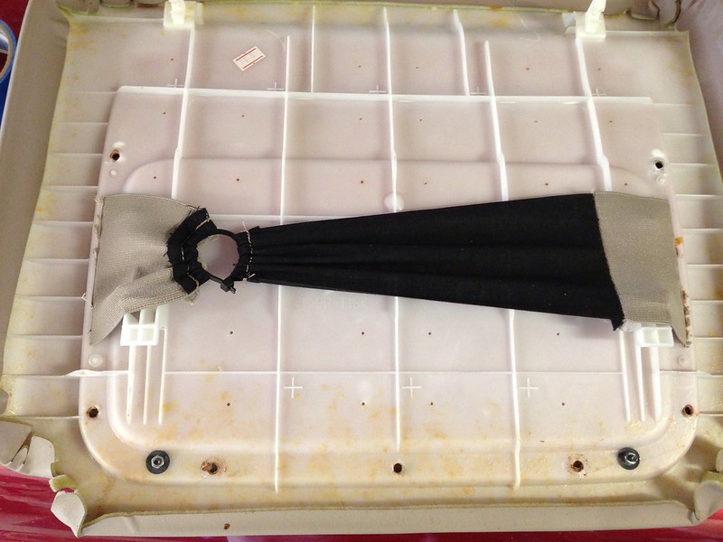

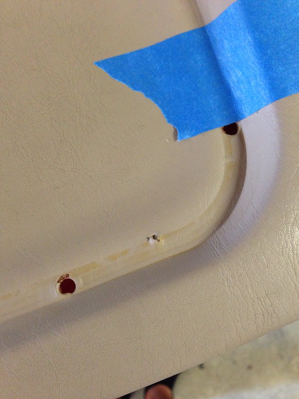

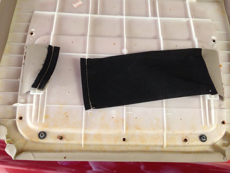

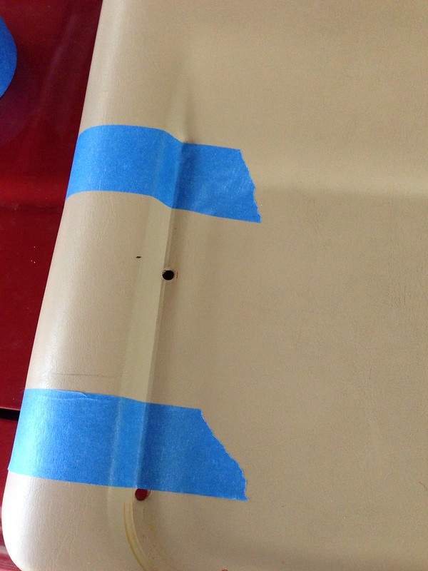

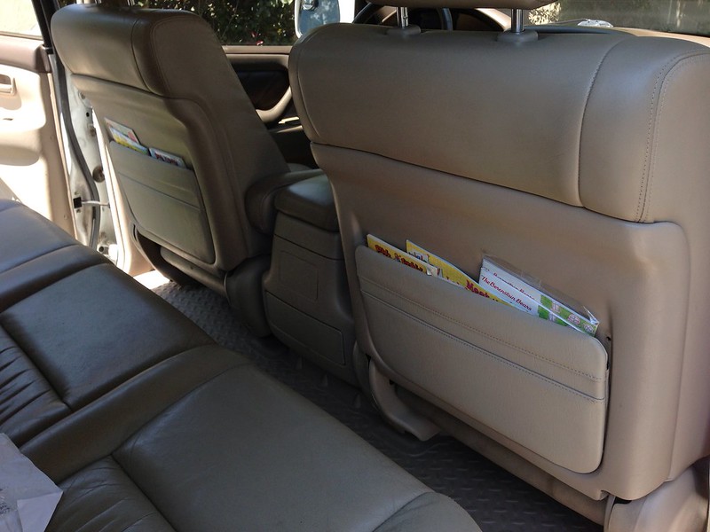

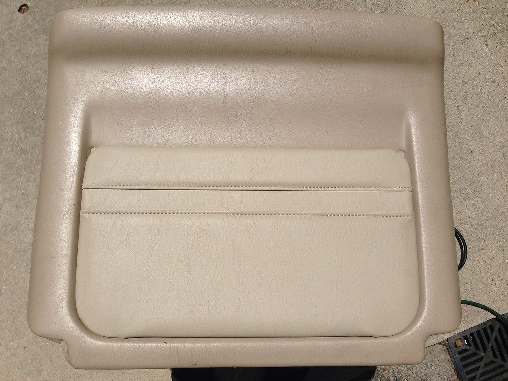

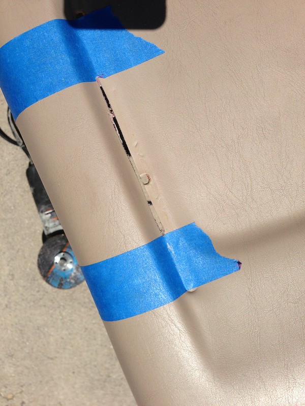

The seat pockets finally came in and the seat backs had to be slightly modified to make them work but I'm very happy with the result. The lower mounting holes are in the seat back and you just need to punch a hole in the leather. I then had to use a cut off wheel to make a slot for the elastic bands to slip through, then I used a 11" zip tie to hold the bands together. Part number is 71780-60040-A1, took about 30min total to install, see pictures below:
Thanks, there are two small visible holes near the top of the pocket but I'm going to see if I can find a plug at Autozone for those. The pockets are also just a tad lighter in color than the seat back but that didn't put me off much.
