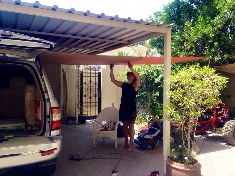

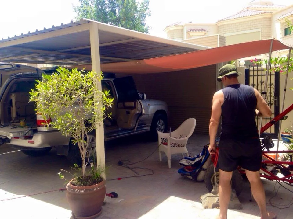

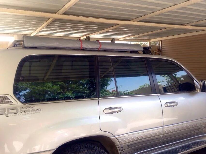

Its been a while. The princess got an awning last weekend. They don't sell them commercially over here so I had a tent maker sew together everything from UV resistant and water resistant umbrella fabric, got some extendable aluminum poles with some 550 para-cord as guide ropes and had a heavy duty synthetic bag made up for it... much like the Howling Moon ones you can get in South Africa.
My Roof Rack is very short (front to back) so its only about 1.5m wide but I made it 4m long for extra shade with grommets half way along so it could be tucked in and taken to the ground if it got windy.
The extra long 4m material means I can take it to the ground like this if its windy.

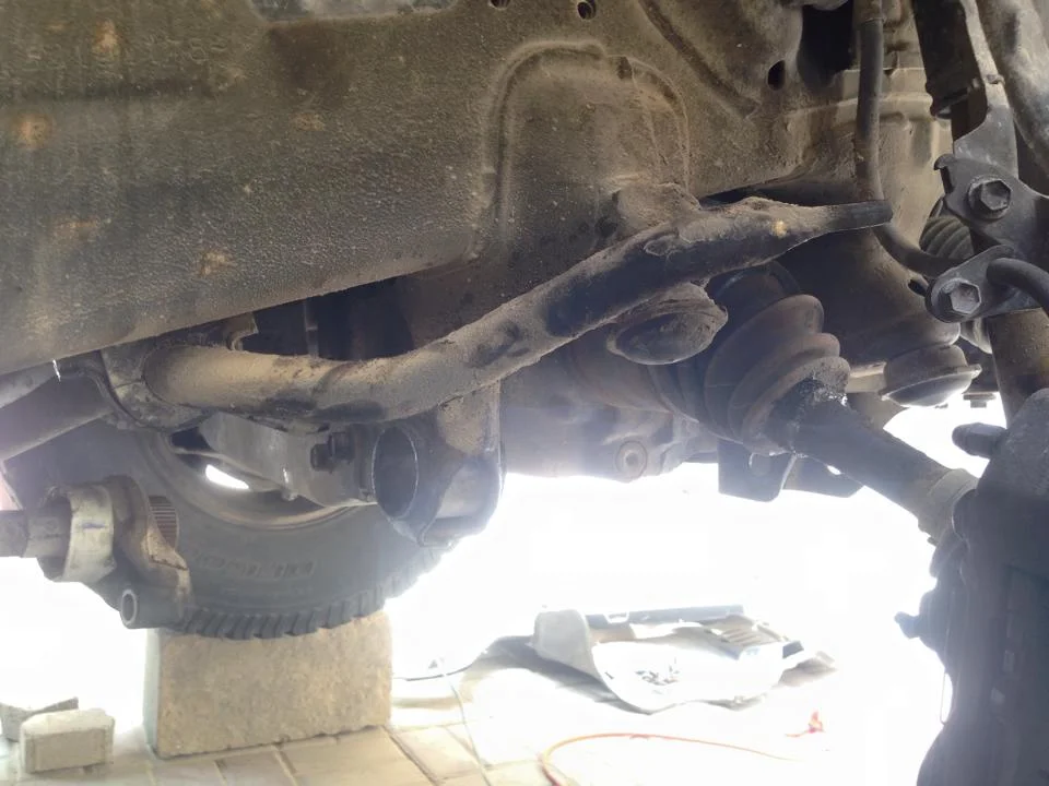

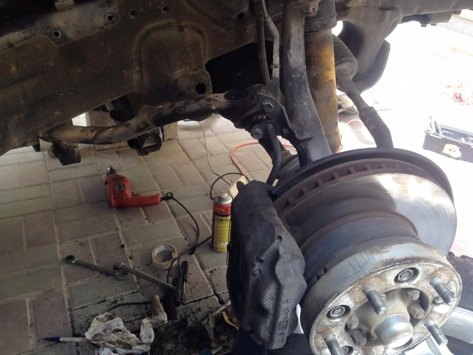

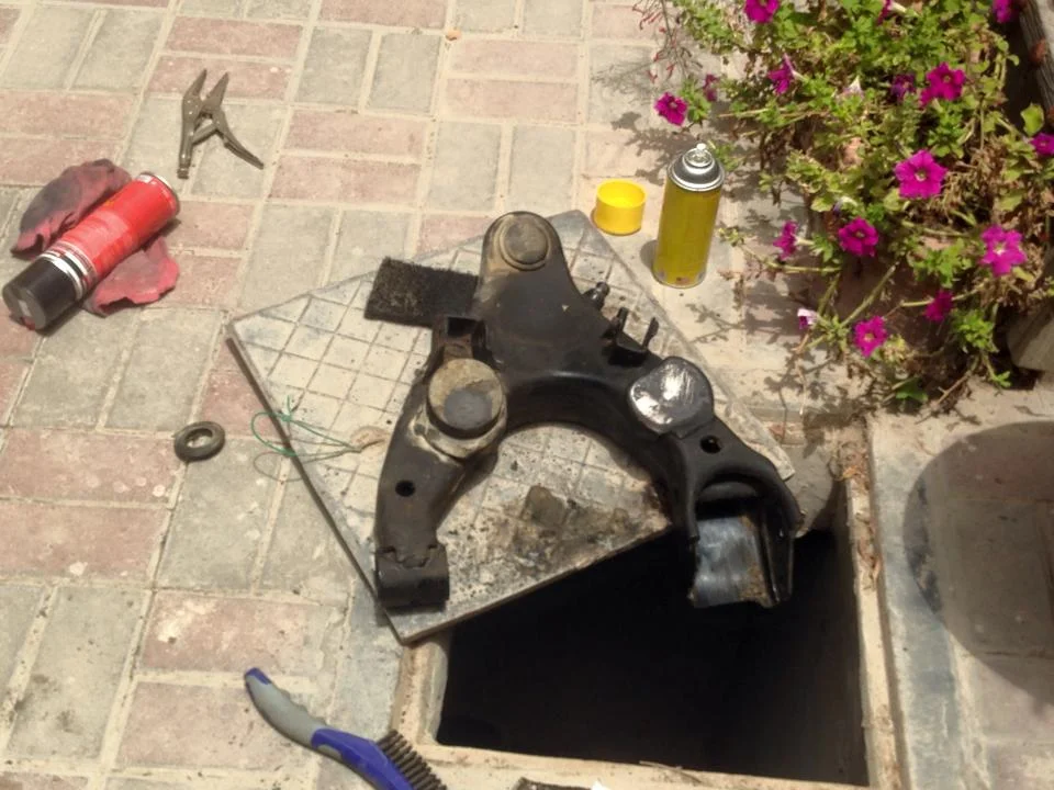

My front end was getting pretty shot and I wend through everything to work out I needed new LCA bushings and new ball joints.
Toyota Qatar wanted USD 1,000 a side in parts alone to change the LCA bushings (+labor).
(They actually pissed me off to no end because they first refused to press in new bushings, insisting that the whole arm must be replaced. Then when I told them that the No2 busing was in the chassis and they would have to either press in a new one or try to sell me a new chassis they told me I dint know what I was talking about and they just replace the arm). :bang::bang::bang:
I went to the TOYOTA parts department (imagine that) and they where more than happy to sell me No1 and No2 Bushings for less than 150usd including new hardware.
It was not easy but I put them in myself over the weekend and now have a nice tight front end. I have some re-boxed spicer ball joints in the post at the moment for another 100usd and my local garage will press them in for me.
(My Boots are loose and leaking grease... no one is perfect :slap:)
