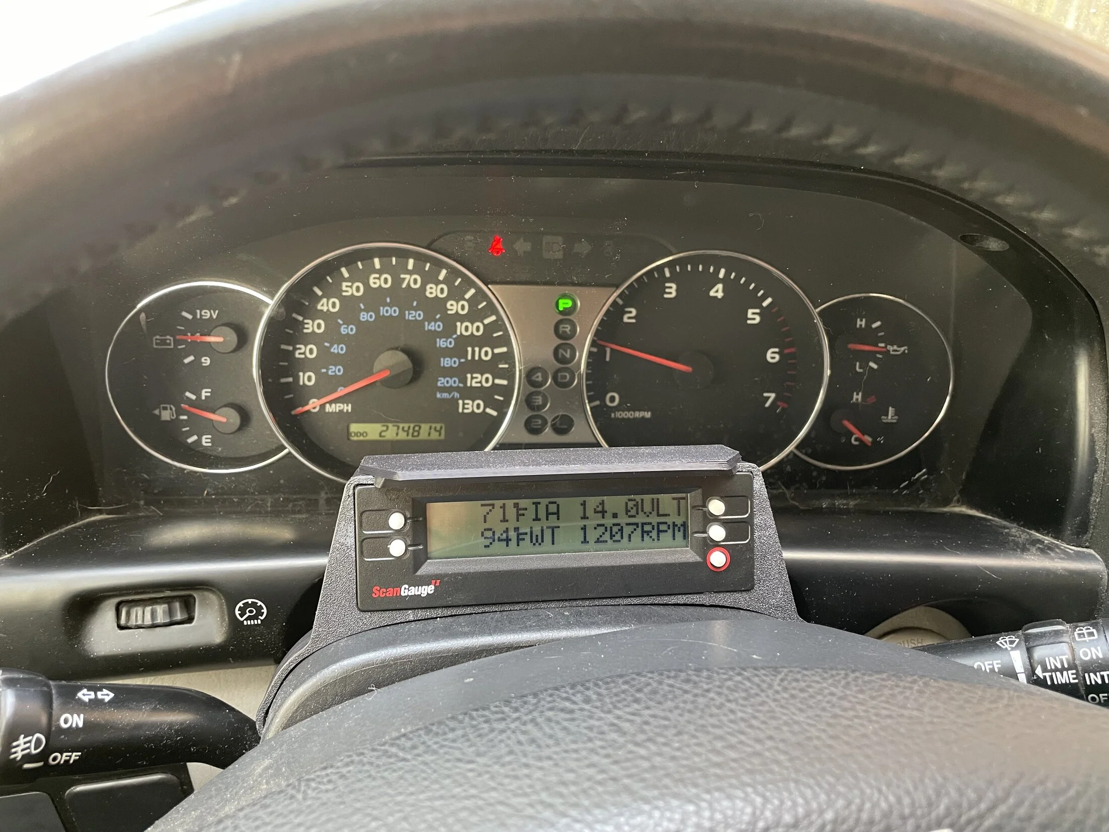

I installed this scan gauge mount I bought from Artesian Garage. It fits and looks really clean.
That color looks good. I need to do the same. Mine might need a little more love. I’m honestly embarrassed with how bad the paint looks.

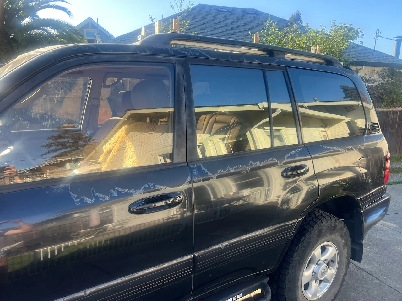

The previous owner actually had this repainted at Maaco back in 2016/2017ish. When I bought it a couple years after the fact, it looked great. Since it gets parked outside the sun has just absolutely cooked it.
I’ve been considering some of the bedliner coatings, (Monstaliner, Raptorliner, etc.) but not sure I want to go with that look/feel. Also have been toying with trying to sand off the current clear that is failing and respraying new on top. If I go that route I would probably do a panel at a time.

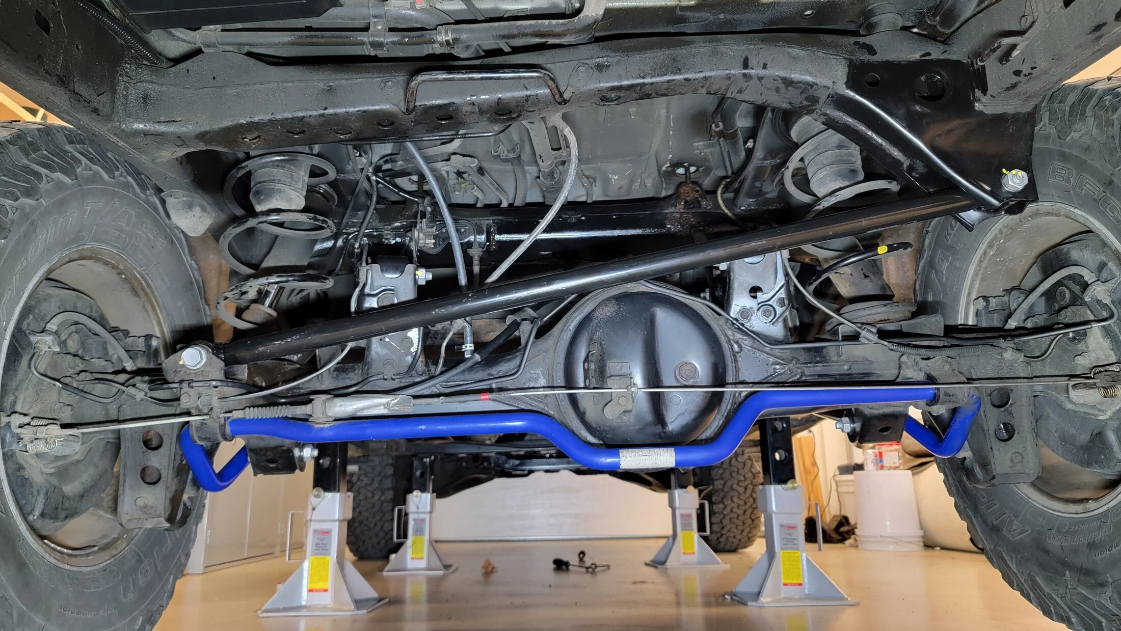

Woo hoo! Finally got the rear arms (with new hardware) installed. Resonator removed for extra room and to help access rusty areas (to spray Fluid Film).

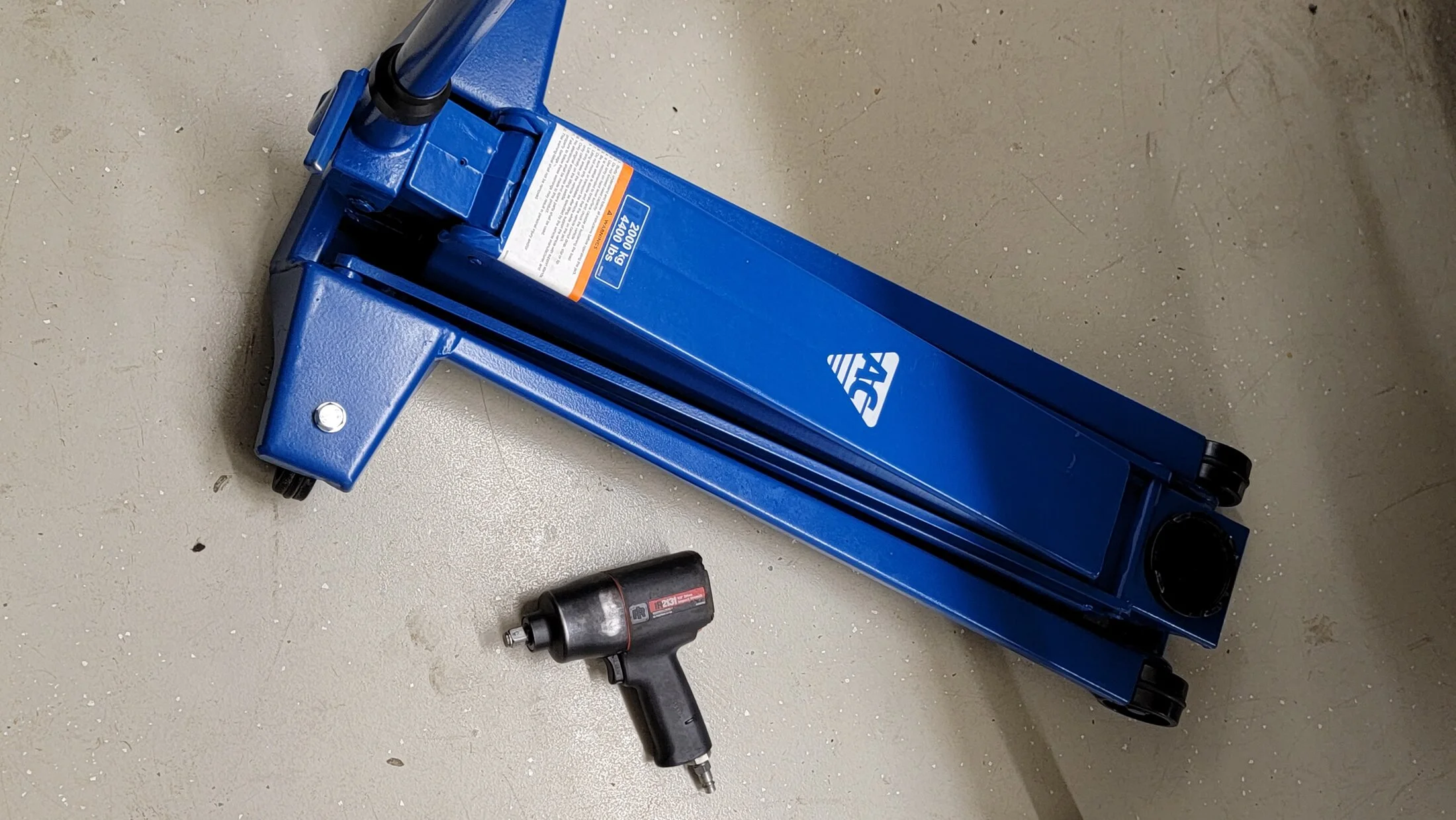

The new floor jack is a joy to use. Impact gun for scale.
What's the diameter on that rear bar?
I swapped in a standard (non AHC) rear bar on mine. It's only 1mm larger in diameter but that equates to being 19% stiffer.
27mm, I believe.

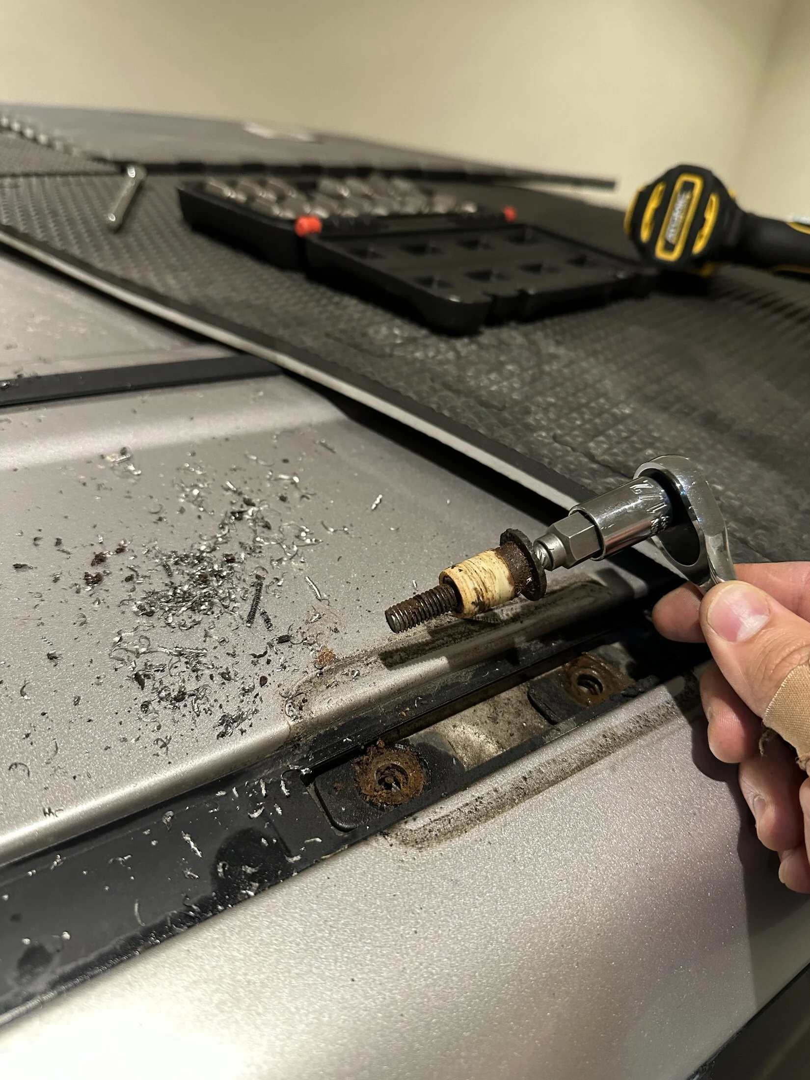

On wednesday I took off the OEM rack to prep for installing the Prinsu Rack. I'm glad I broke it up into two different days. The bolts for the front and rear supports came out pretty easily, but the bolts for the centre supports were rusted and necessitated the use of an extractor. View attachment 3877079

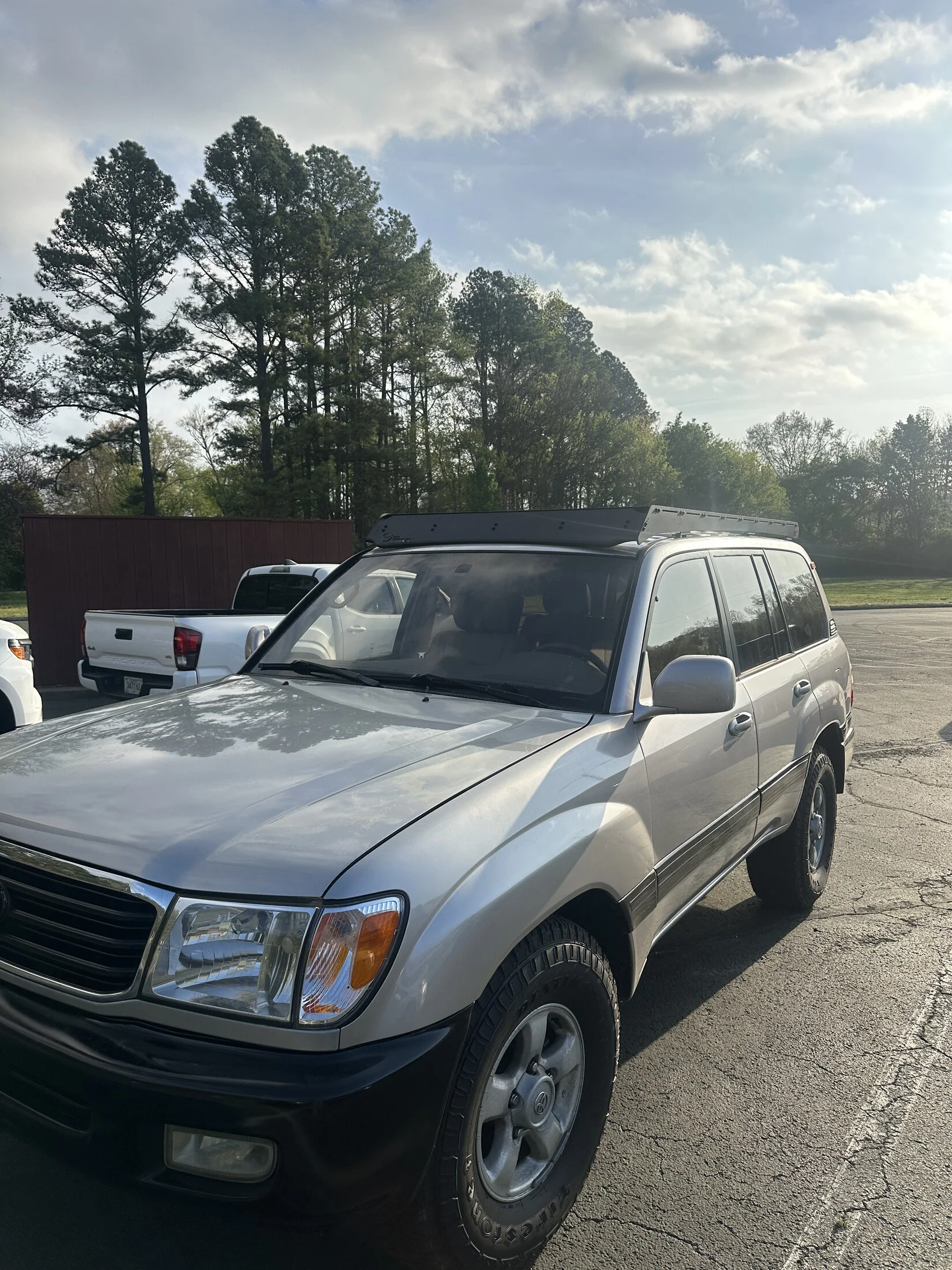

Last night, I installed the new roof rack. The only time I wished I had a second set of hands was when I was putting on the paint protector. It's a little cattywampus, but it is on so there's that. Other than that, it was pretty uneventful. Its not the best picture, but this is what I took this morning. View attachment 3877080
At least you didn't spend time prepping and cleaning an are you weren't going to use. I was pissed when I realized it. I seriously thought we were going to be in and out in an hour. 3+ later we were done. I'm dreading the winch and bumper now, its just sitting in the garage now.
