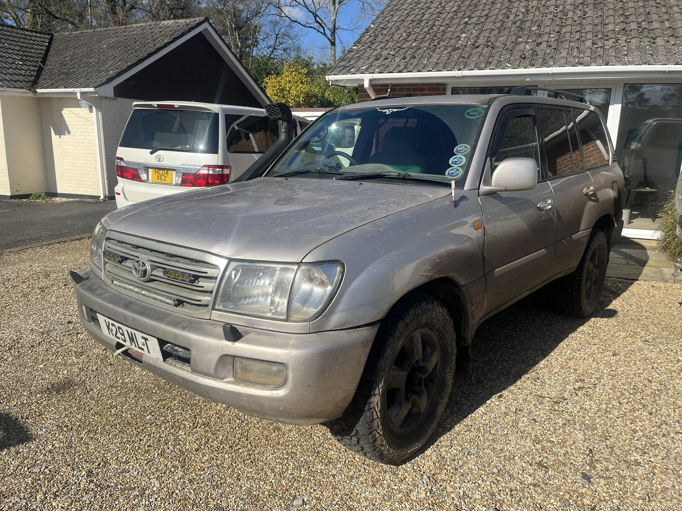

It's been a while and I had hoped to be able to give more of an update, but the answer to 'what have you done to your 100 series this week?' is buy even more parts.
Some of you may recall the obscene amount of stuff I bought from Japan for my 100 series that arrived in preparation for it's overhaul, and well it's not been 100% smooth sailing sadly! The truck has been away for about 1.5 months so far due various additional complications but we're getting closer to being able to pick it up.
Despite using my VIN for parts verification on Partsouq before ordering from Japan via Japan4x4, I somehow managed to order the wrong radiator, so after the cost and shipping, import duty etc, it was wrong, so my LC guy had to go out and buy the right OEM one (-£650!), plus I ordered the wrong Aux belt and pulley (these 3 things I didn't check the numbers on myself/visual check before ordering to compare, so it's my own fault for trusting a 3rd party website). The radiator and all coolant hoses, T pieces, and radiator fixings have been replaced so that's good for another 20 years now.

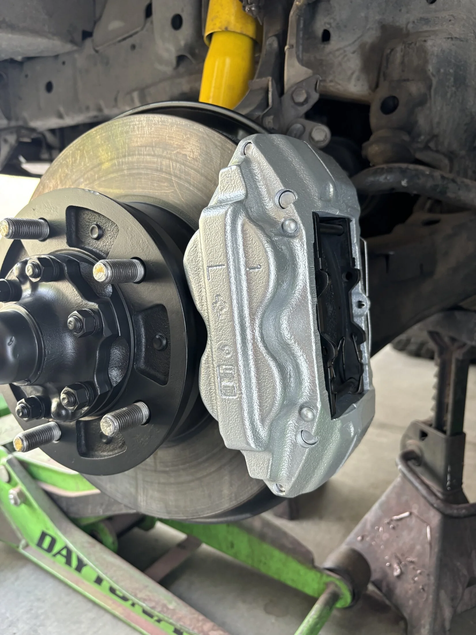

The front is getting the full works minus the shock absorbers as they are okay for now. Upper & lower control arms, discs, pads, bearings, spindle bearing, CV axles, steering rack are all in progress, and it'll be taken in for a full alignment to get it running lovely. I noticed a wobble/vibration at circa 60MPH upwards which I never knew if it was any of the various components that were gone, an imbalanced wheel or something else, this will hopefully resolve it :)

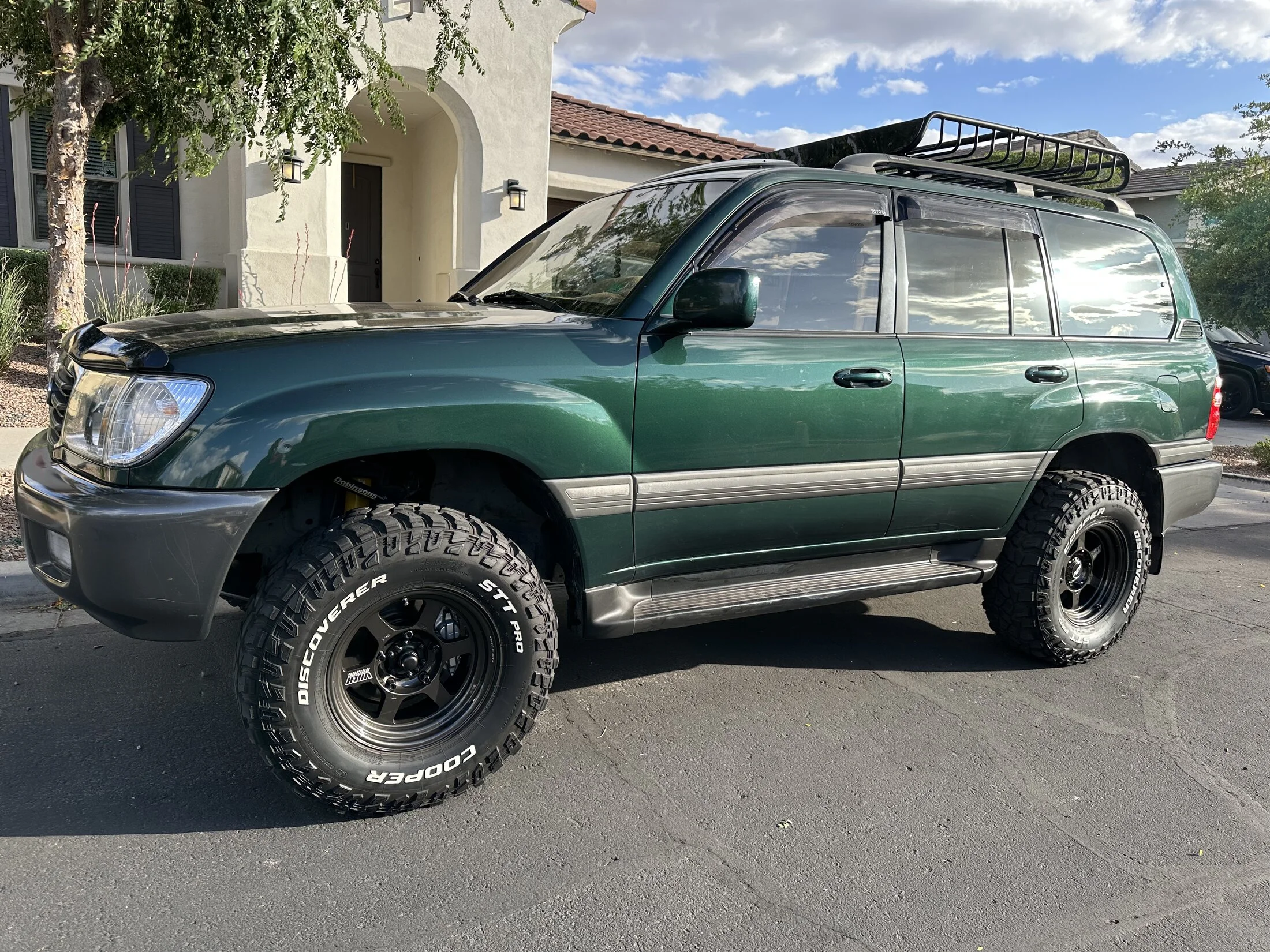

Install the slee second battery and compressor mount. I don't know why because I run a lithium battery inside and I don't own an ARB compressor. Looks pretty tho 🤷‍♂️
I lied kinda, knock-off ARB twin compressor. I would call it a Chinese knock-off but the ARB is also produced in China

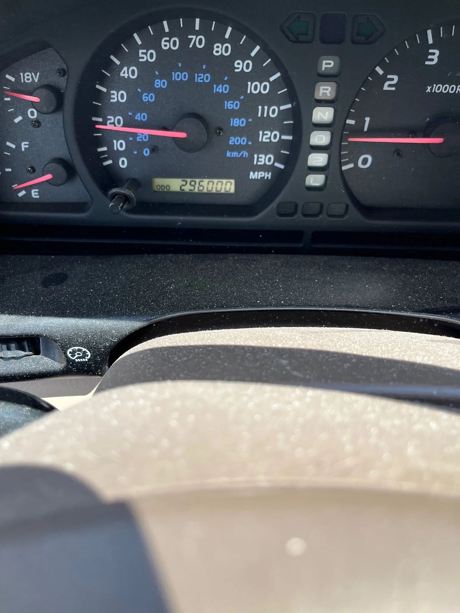

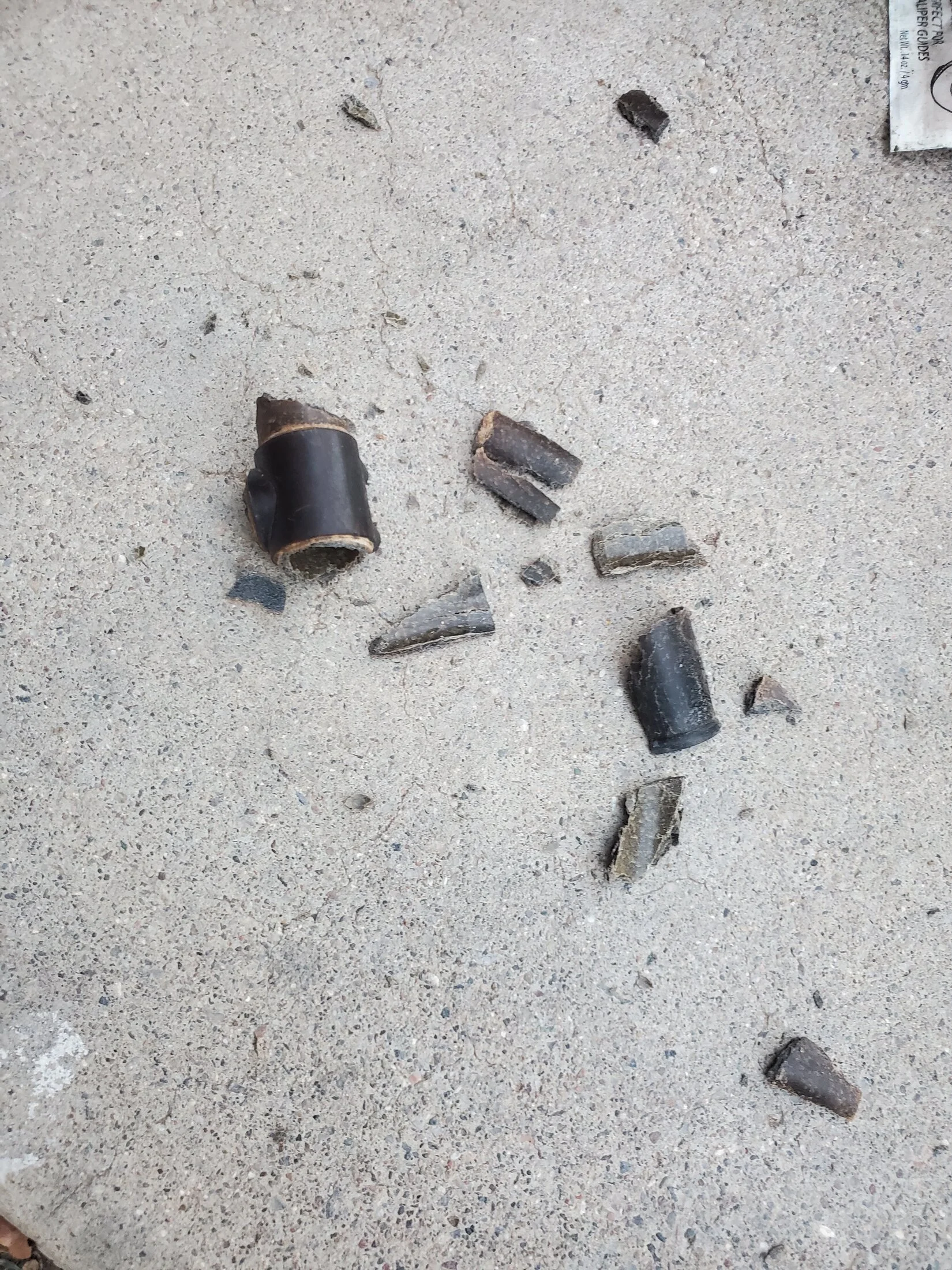

Change PCV Valve, grommet and hose today. What a pain in the a$$ to get out! Took me 20 mins to get the damn thing out! The hose was so hard that it felt like pvc pipe! Glad I got it done. I'm at 295K miles so not sure if it's ever been changed.

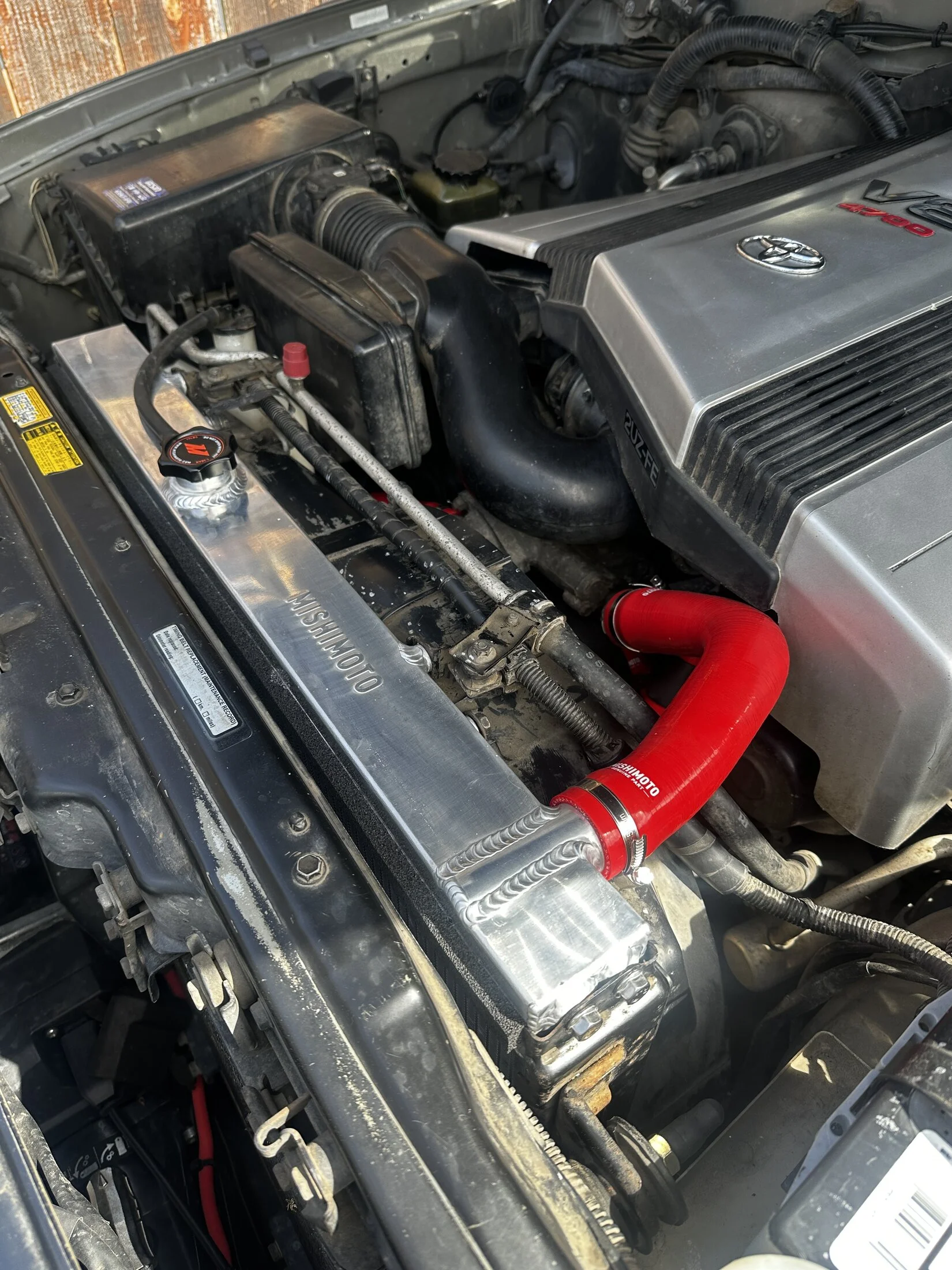

Making me worried about the new OEM rad I have en route from Serra Toyota! Out of curiosity where did yours fail?
I thought when I replaced mine 2 years ago that it was the original, but after talking to my brother in law that had it before me, turns out he replaced it only a few years before that. Mine failed somewhere in the passenger side where the radiator part crimps to the outside. Just a slow drip. My current one has 2 years and so far so good. Here’s to hoping it lasts a longer time than the last one.
