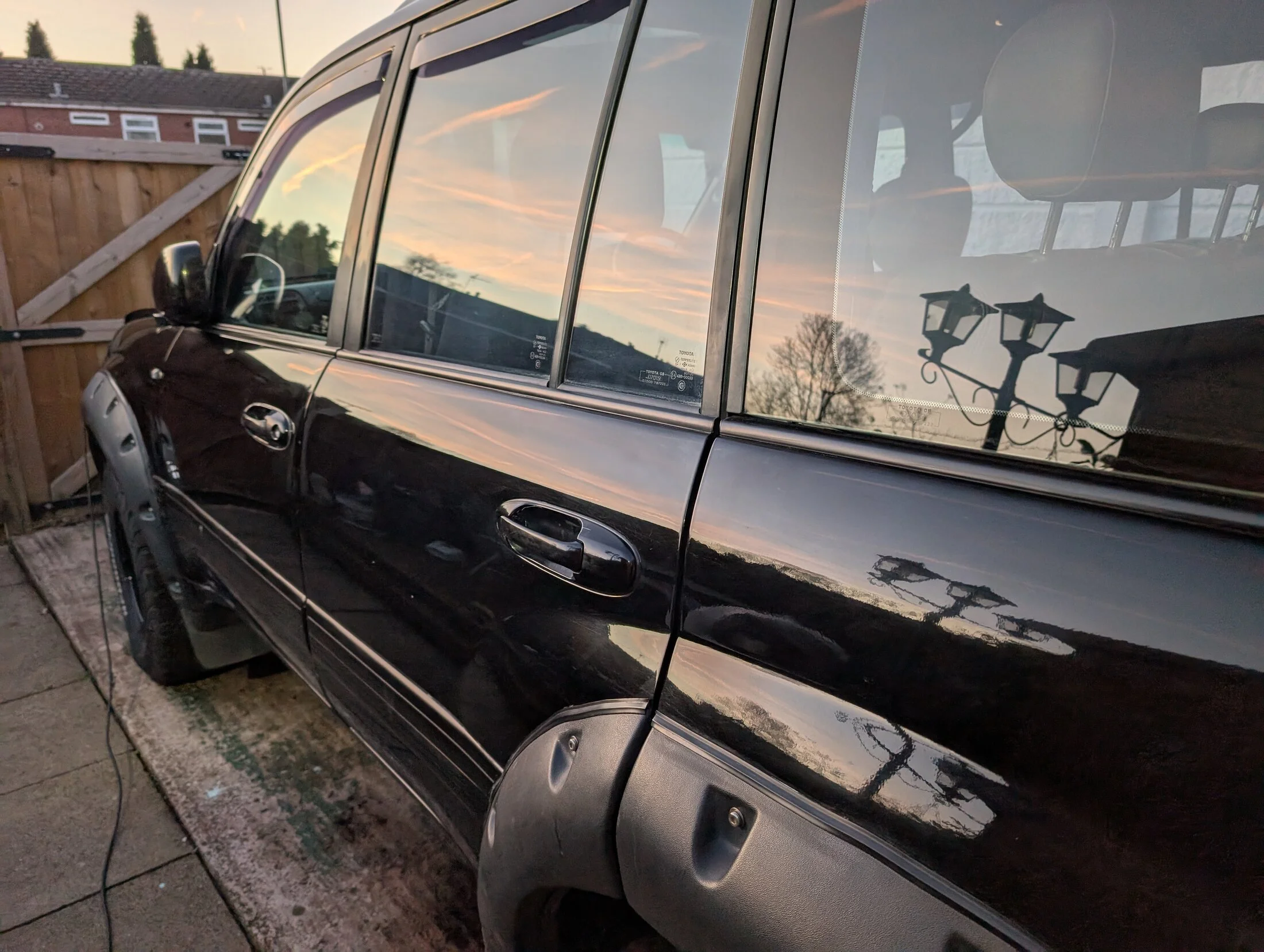

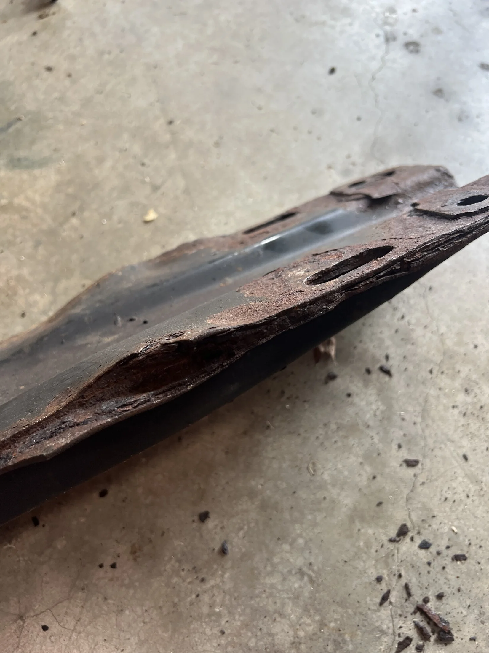

I've been putting my old gal back together, the interior panels are all back in and all the crap inside is cleaned out and ready for a good interior clean after the welding is done. Might even have lost my head and threw a bucket or 2 of water over her.
What window visors are those? I can't seem to find the ones that go in the channel anywhere.

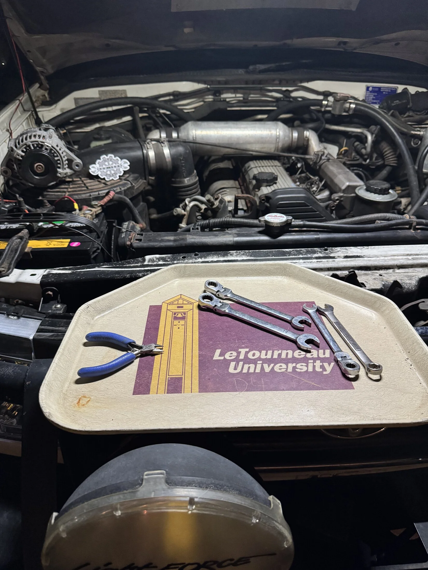

Installed new “new” take off alternator from Off Iron
This YouTube is spot on for a changing a 1HZ alternator.

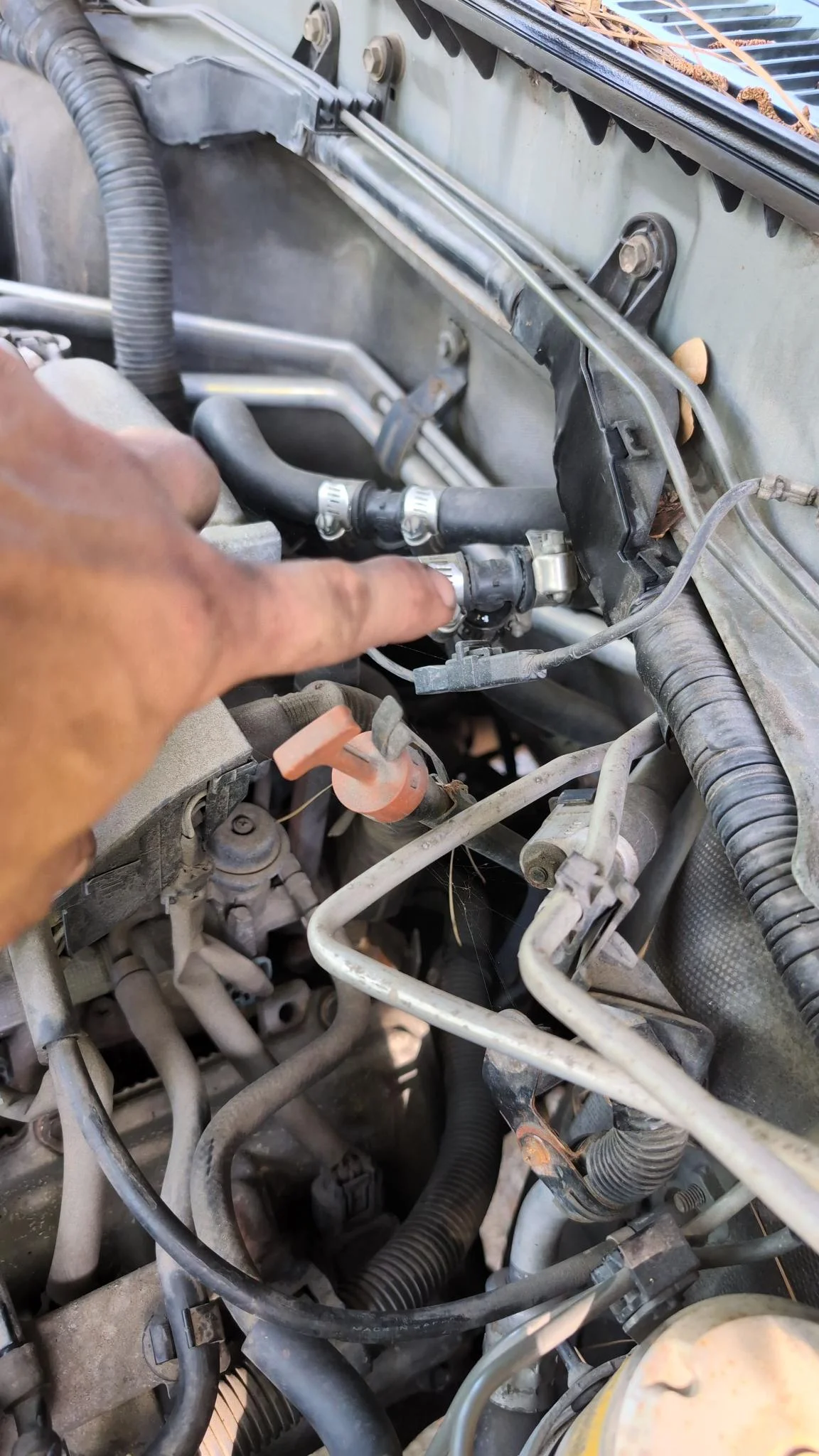

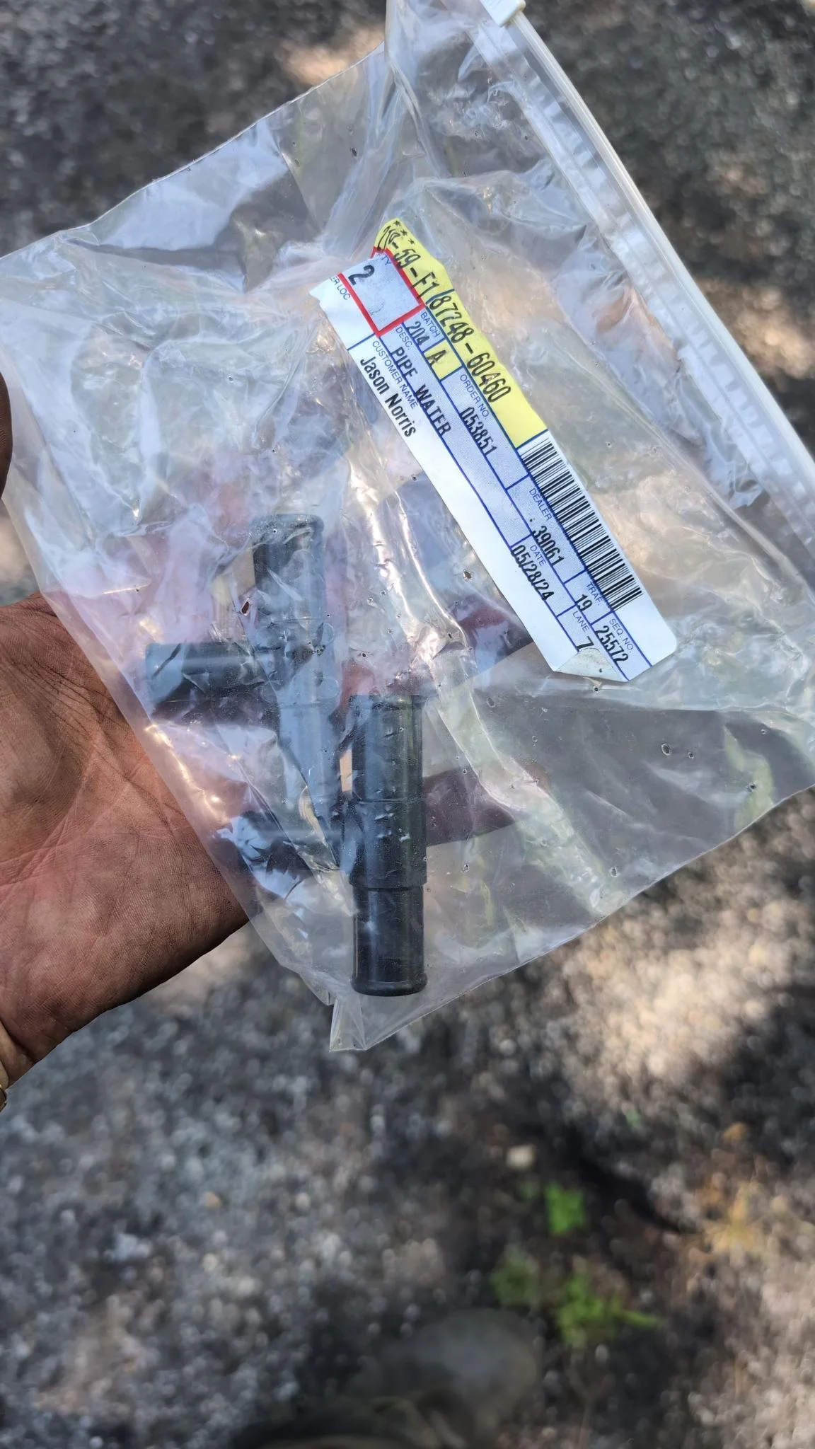

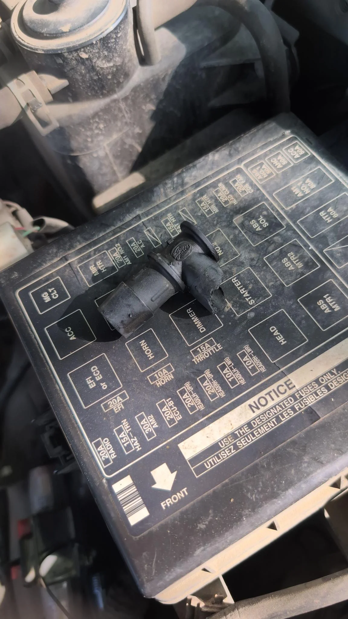

Ugh. Finally got everything reassembled from my steering rack, power steering system replacement and went for a short drive. Aside from the expected alignment issues and check engine light from starting the car with the maf disconnected to bleed the PS lines, I got home to find steam pouring from a broken tee... At least I have new ones on-hand. Now to fish the broken pieces out of the lines.
Guessing aftermarket tees were utilized during my previous timing belt change. Note to self: do it yourself if you want it done right.

Get yourself the OEM hose clamps too

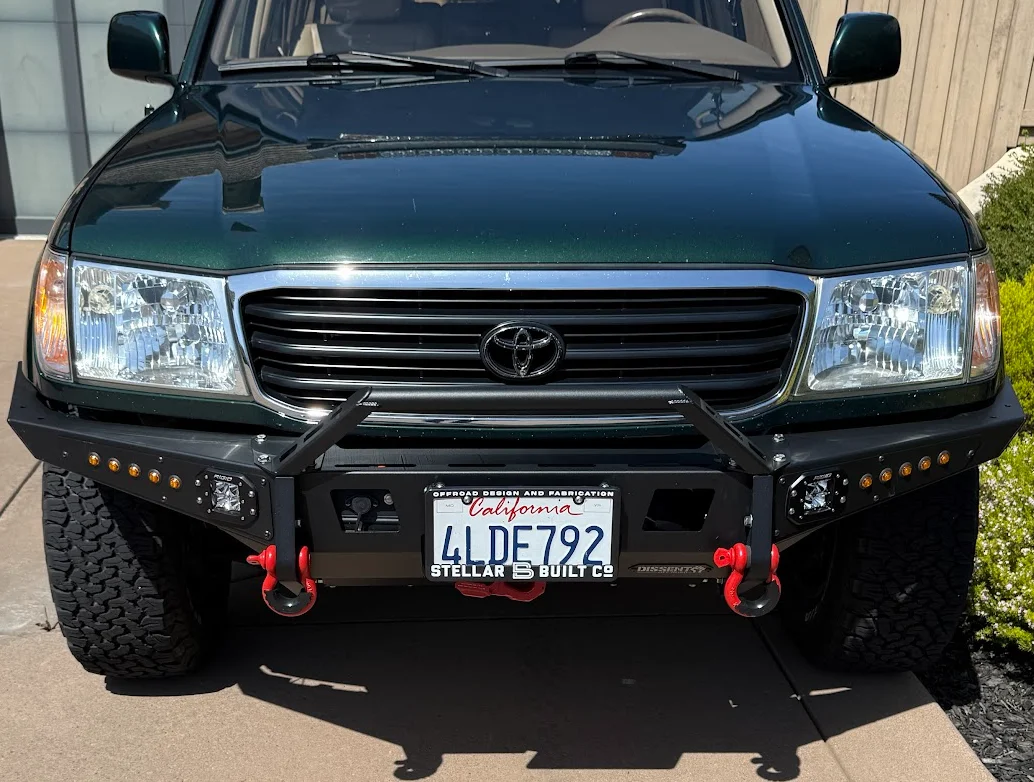

Installed the Garage Alpha front grille. I ordered it on Tuesday, and wasn't expecting it to get her so fast...luckily I had 30 minutes to spare to install it. The grill installed in under 5 minutes, but it takes a bit of time to put the letters on before installation.
BEFORE:
AFTER:
Now I really do like that. Top job!

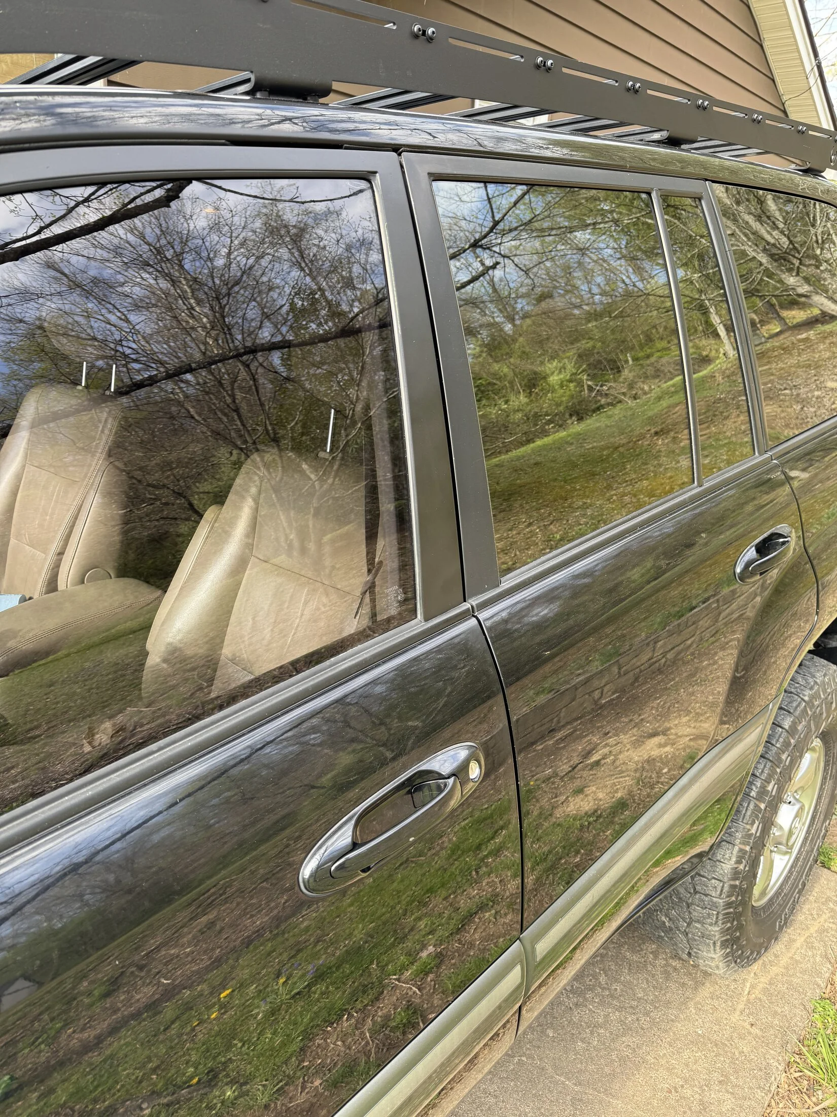

Made my first trip to the dealer in the 7 years I’ve owned my LC for an alignment after installing new UCA a few weeks ago.

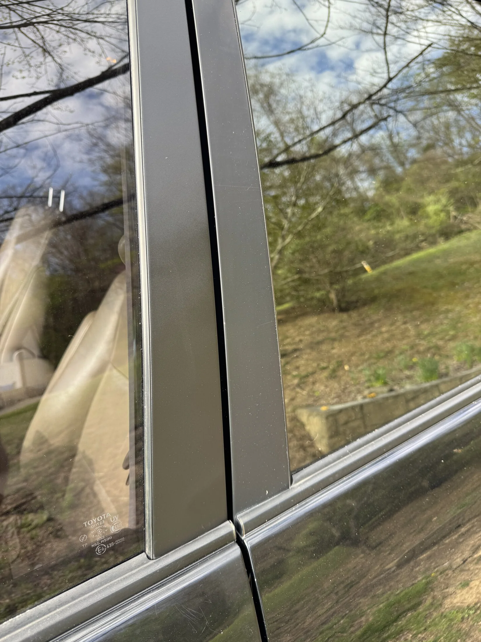

Also removed the old, cracking and peeling off vent visors on the front doors. Cleaning the old adhesive was a mess and as expected, destroyed the pain under it. Much to my surprise, Rustoleum satin black is just about a perfect match. We’ll see how long it lasts.
That color looks good. I need to do the same. Mine might need a little more love. I’m honestly embarrassed with how bad the paint looks.
