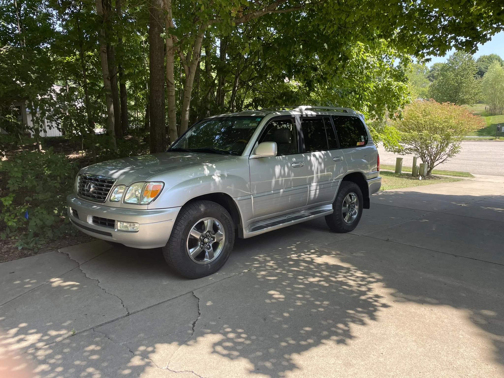

Finally had new wheels and tires put on today. Went with the 18” Land Cruiser spec OEM wheel with a new set of Michelin LTX Trails (265/70/18) that I picked up for free. Need center caps, but they can wait. Drives nice with them.
Previously I had a set of Michelin LTX M/S2 (265/65/18) which lasted +67k and 8 yearsView attachment 3687826

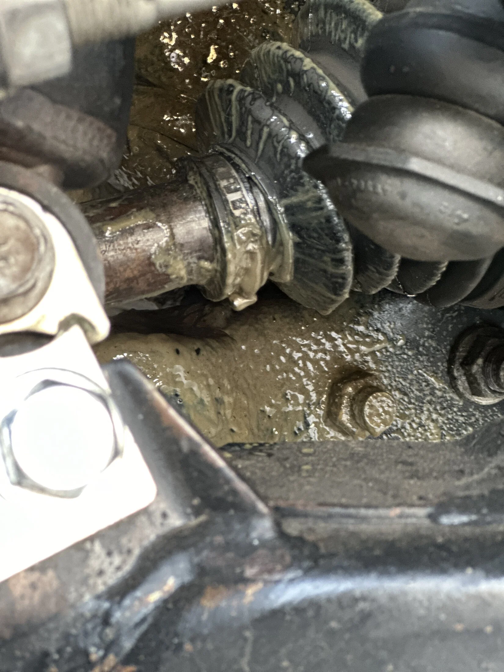

I recently installed a brand new OEM steering rack myself (full time mechanic here. Have installed dozens of racks).
After install I noticed my steering wheel doesn't stay perfectly centered. 90% of the time it stays centered. After a sharp left turn or U turn my wheel is slightly off center.
I had a helper turn the wheel, while I watched the rack...it moved A TON left and right.
Just curious if you had any similarities with the new oem rack. I bought superpo rack bushings to stop the movement. Will install soon.

After my rack install I had a similar issue where my steering wheel was off one or two teeth. Had to remove and reinstall it.
It was noticeable when I was in the left lane with a left leaning grade. Right lane with a right leaning grade the wheel was straight.
I suspect you may have the same issue. If resetting the wheel for perfectly flat level driving does not solve it, make sure everything is kosher with no slop or binding. Get the front wheels off the ground and move the steering wheel left and right to see or hear what’s happing.
My rack is perfectly centered. Equal turns left to right at the steering wheel. The rack itself is moving left and right at the mount points. The poly rack bushings I got will stop the rack from moving.

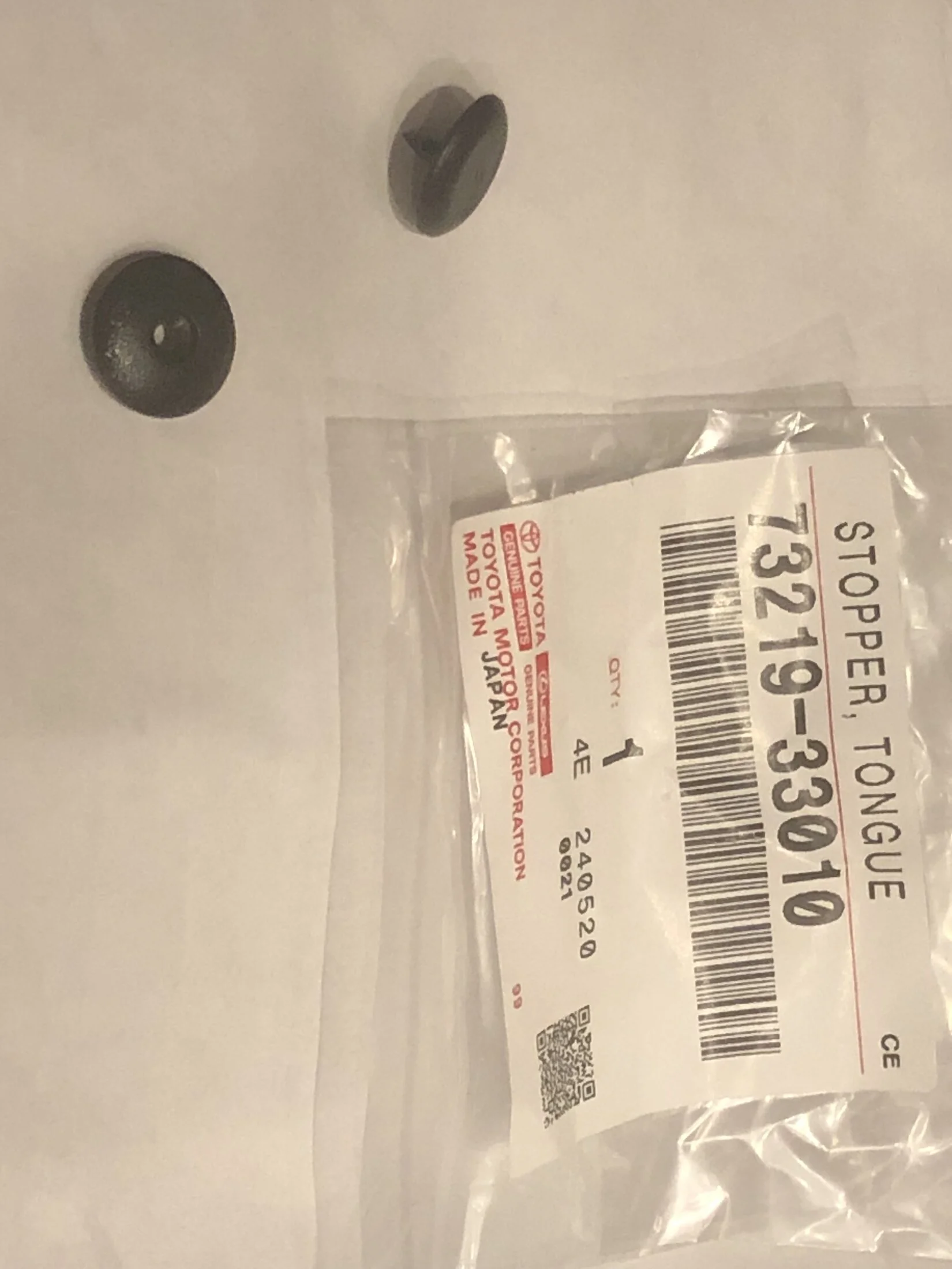

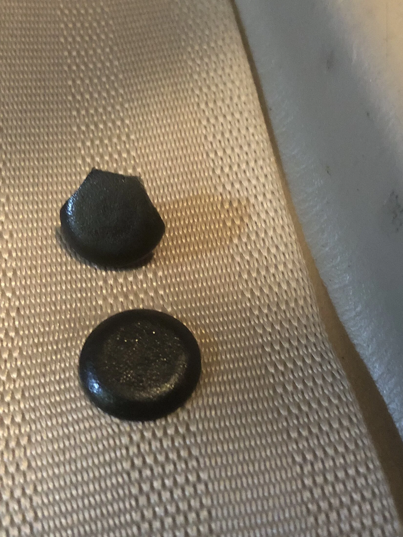

Here is what I have on order.
7321933010
I should have it by early next week and I will see it the dimensions match up to the original. I’m only hoping it is close enough. For $1.50 I will give it a try.
Excellent match. Thanks @AARONTLC for the tip on installing it!
I had the same issue and it would set off the VSC as well. Turned out it was the rack bushings.

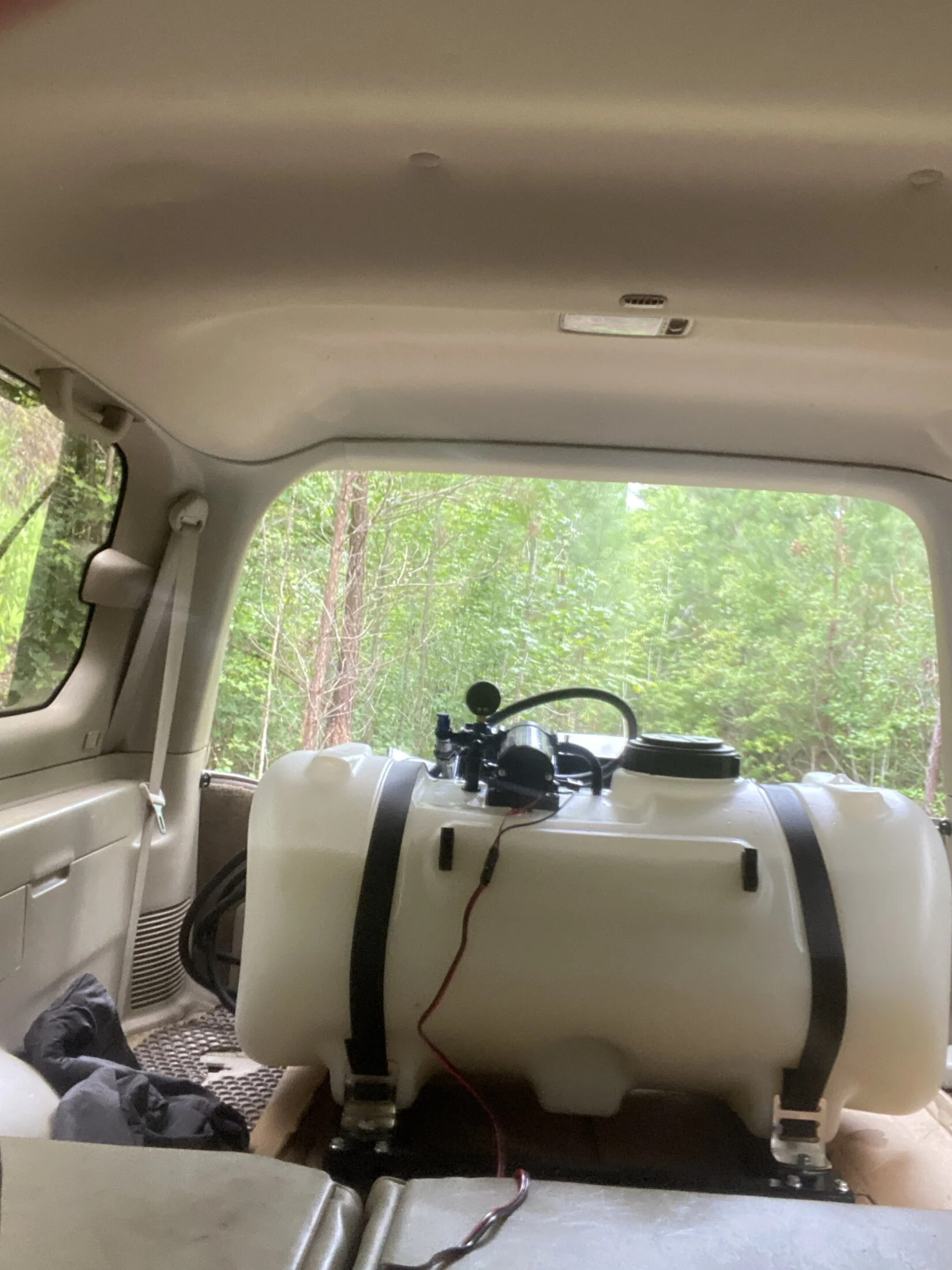

I turned mine into a farm sprayer. The sprayer was designed to go over the tailgate of a UTV so it worked great with the tailgate on the 100. Newly cleared paths on really hilly terrain with some tight turns, stumps and low muddy areas. Stock LC did great carrying about 450 extra pounds of roundup in the back. Had a lawnmower battery on the floor in the back seat with a 12' lead with on/off switch. Could control spray while driving. Doing this so I can hopefully throw a nice whitetail in the back this deer season!
