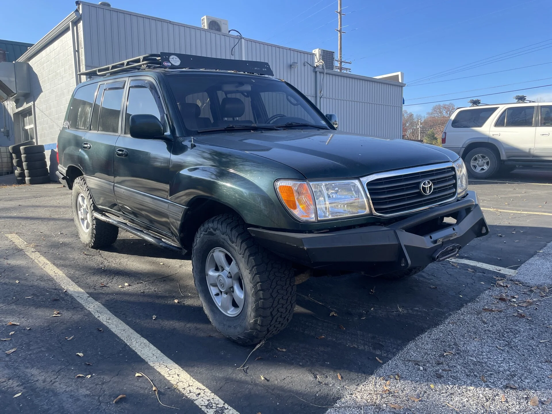

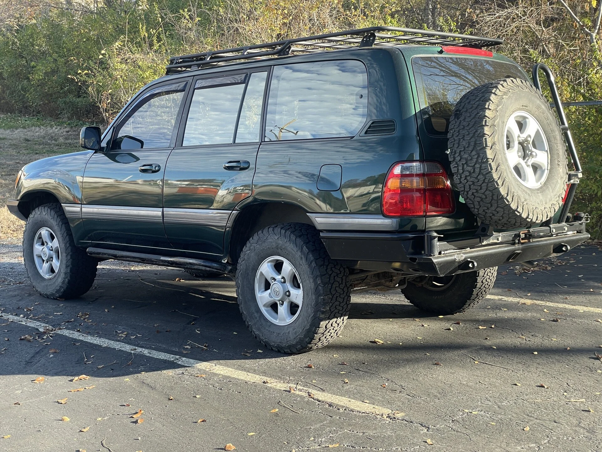

Bought a new one. I’m back in. 1999 with a Slee front bumper and armor, sliders, Gamiviti rack, 4x4 Labs rear swing out bumper, 2“ OME HD lift, rear OEM Locker and BFG KO2 33’s there isn’t much it needs! 196k miles just warming up. I do need to grab a winch..

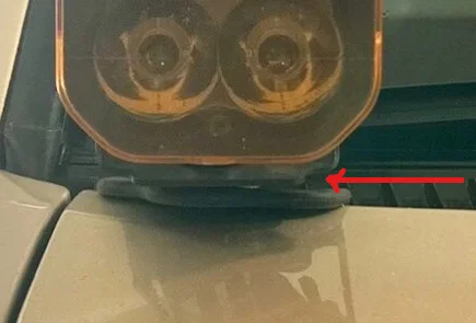

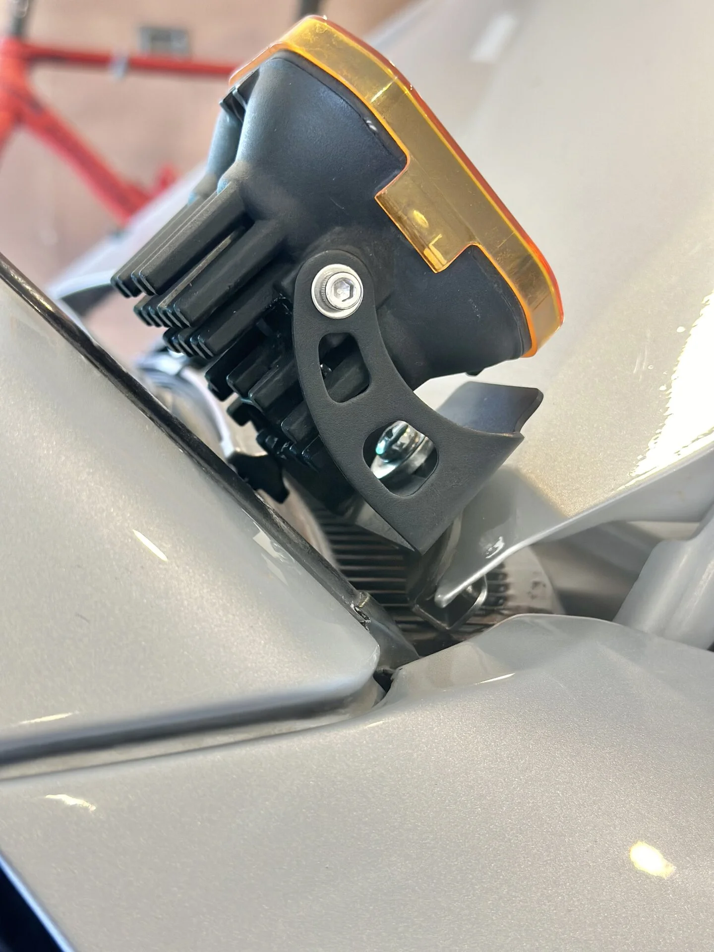

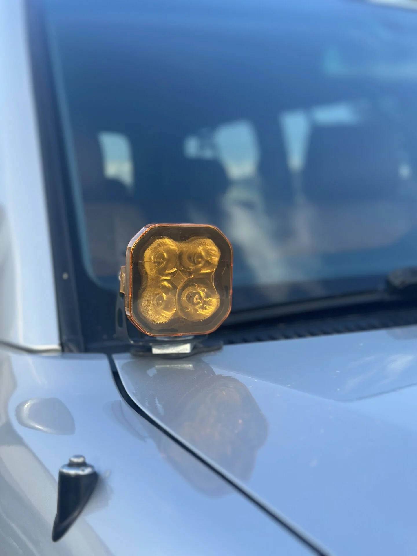

So you put that beveled washer here to level it? I hate that I saw this because now I feel like I am going to need to do the same thing. Can't unsee it.
Here hope this helps
The trick is to rotate slowly the beveled washer L-R. Also, I had to buy longer Stainless bolts from Lowes because by the time you put that beveled washer between the light and the bracket, it’ll be too short.

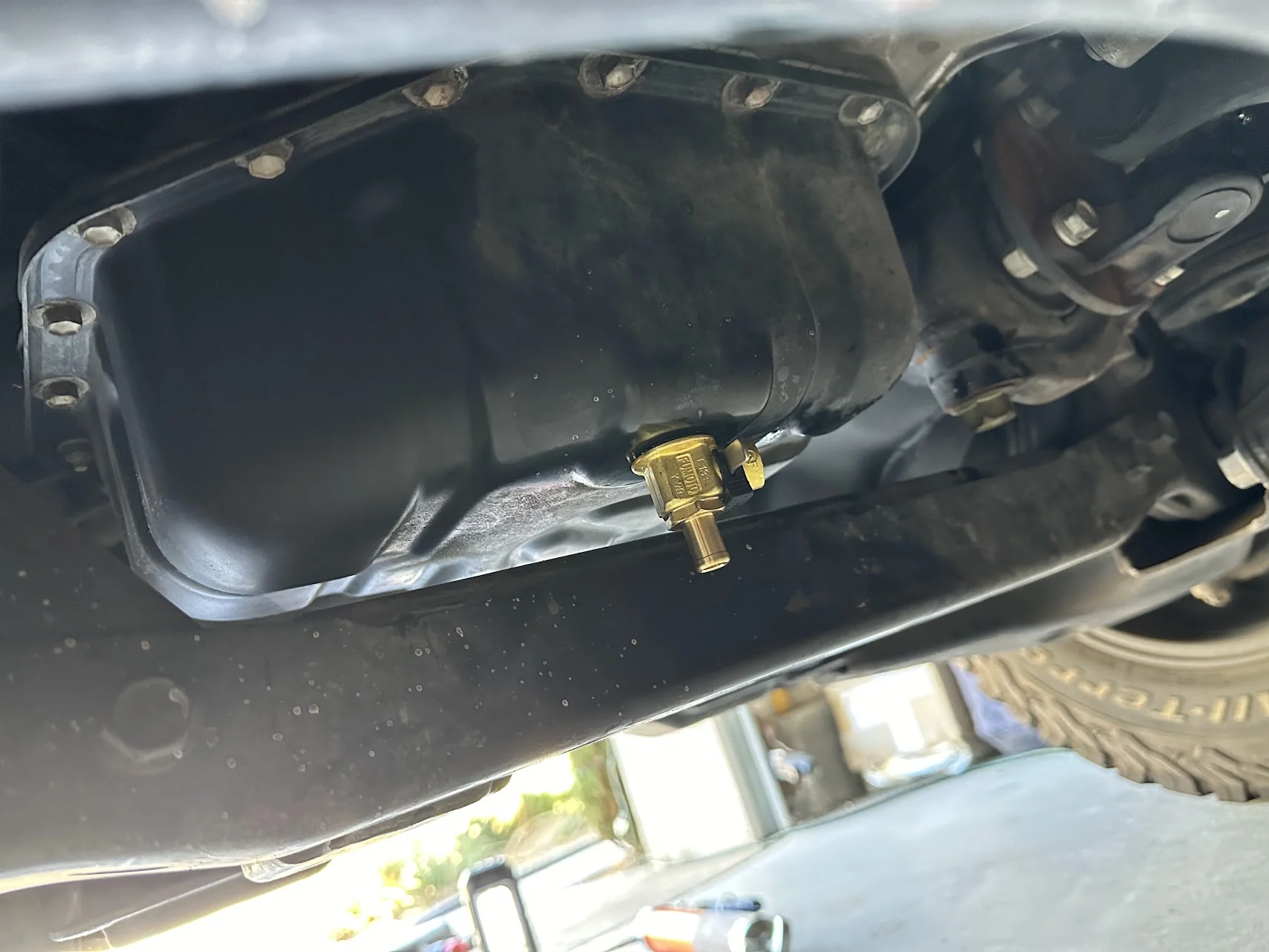

Just did my 185k oil change and installed the Fumoto drain nipple; this should make oil changes a lot quicker. Also I like to grease my U-Joints etc while I'm underneath and the stars must have aligned today because ALL the grease fittings were accessible with no need to roll the truck to get the grease fittings to be easy to reach. I truly enjoy working on this truck as things are somewhat easy to get to the way Toyota laid things out.

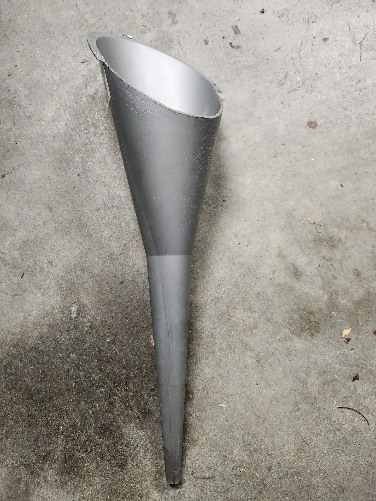

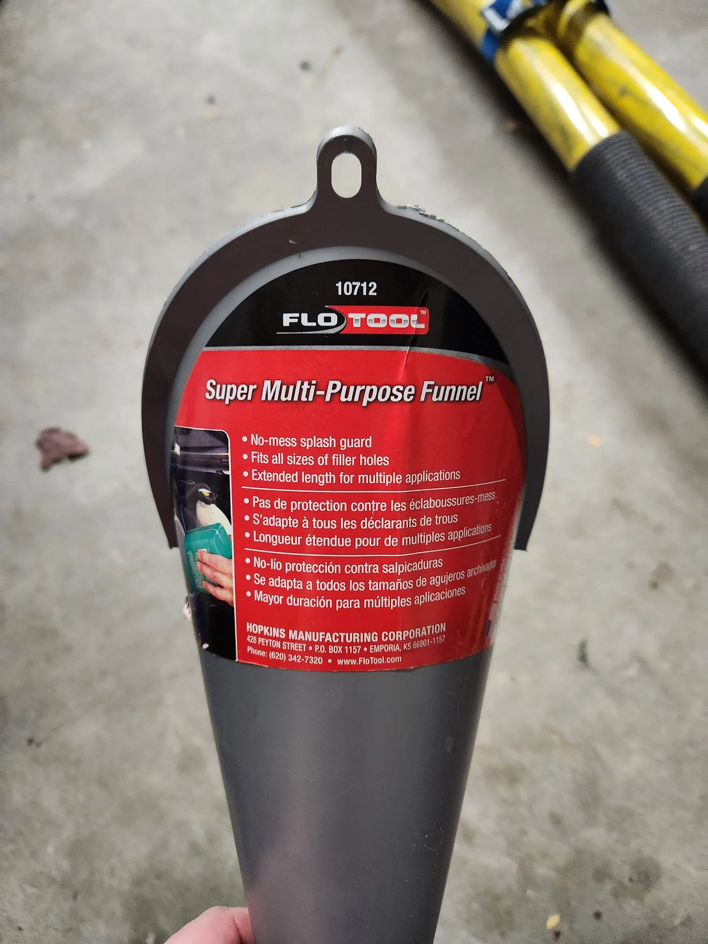

I love the Fumoto valve, and being able to drain directly into used jugs with a short piece of hose. I no longer have to remove my Asfir skid plates to avoid making a mess. The other piece of the puzzle that I recently figured out was a modified funnel that fits under the oil filter without removing the skid, and lets me drain that oil straight into a jug. My last oil change I literally didn't spill a drop on the concrete.
