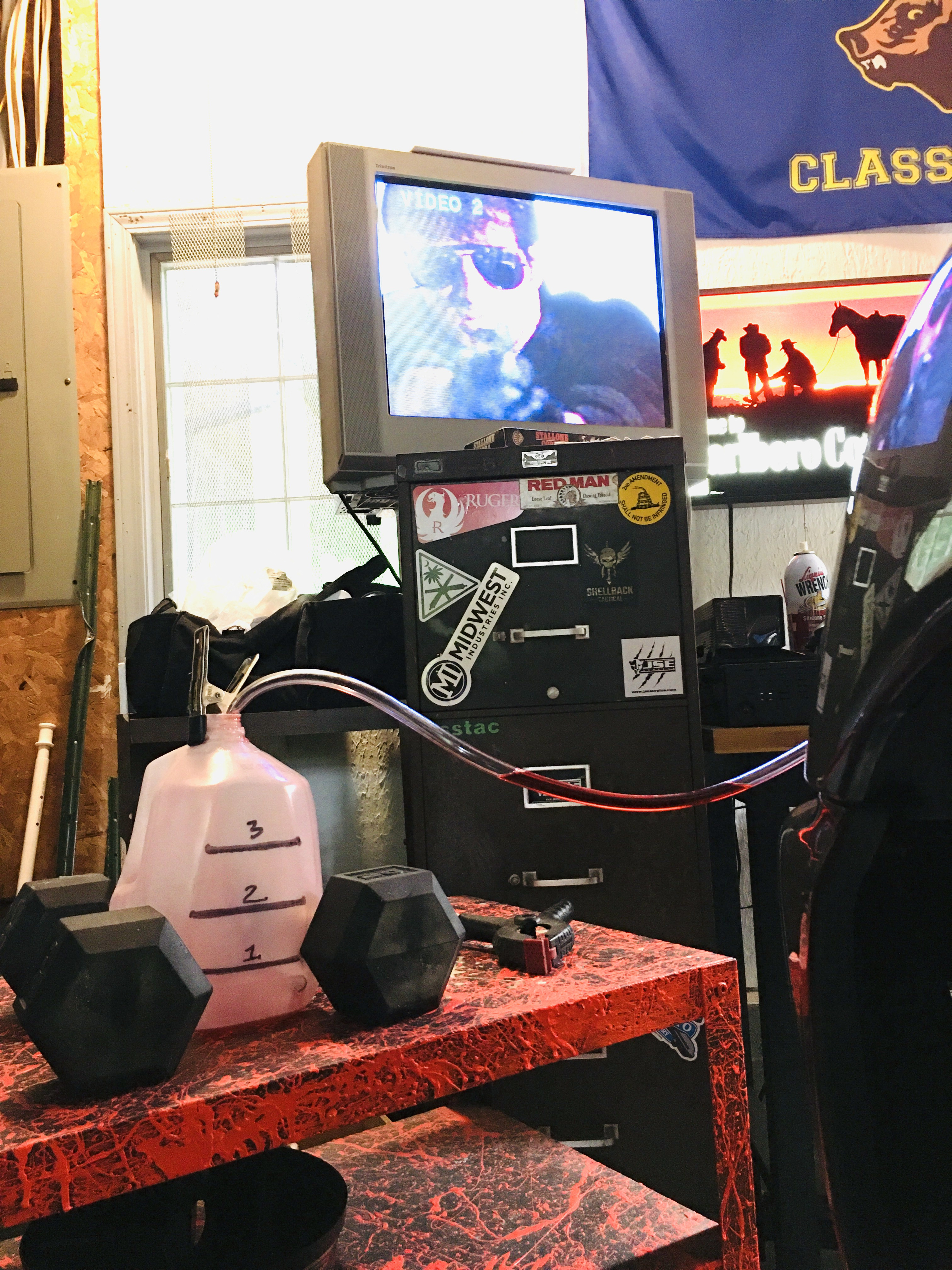

After 20yrs finally figured out how to bleed the brakrs right. After eatching Otram's video on youtube, ai purcjased a powerprobe afapter and proceeded.
Few preparations are,
1. Trickle charger connected.
2. Compressor set at abput 20 psi.
3. Fresh bottles of Dot3 fluid.
A. Lifted all 4 wheels off using my new quickjack7000.
B. Removed old fluid from the reservoir to min mark.
C. With key off, pressed the pedal abput 35 times to empty the brake booster tank.
D. Noticed the reservoir back to full so removed more of the old fluid.
E. Topped off the reservoir with new fluid.
F. Turned key to pn to depressurize the booster and then connected the powerprobe adapter with 20psi air.
G. Starting from RR connected a simple bottle with a hose and released the bleeder scrrw. As the line is pressurized, no aor sucked back.
H. With the bleeder open pressed the brake pedal few times and watched the old fluid come oit.
I. Repeated all other wheels and filled the reservoir up as necessary.
J. Cleaned up everything and wjeels back on. Drove to the gravel part of my driveway and activated the ABS.
K. Topped off the fluid level and went for a short drive.
L. Felt great with a newly renewed great brake feel.
M. Decided to share my experience on IH8mud.
