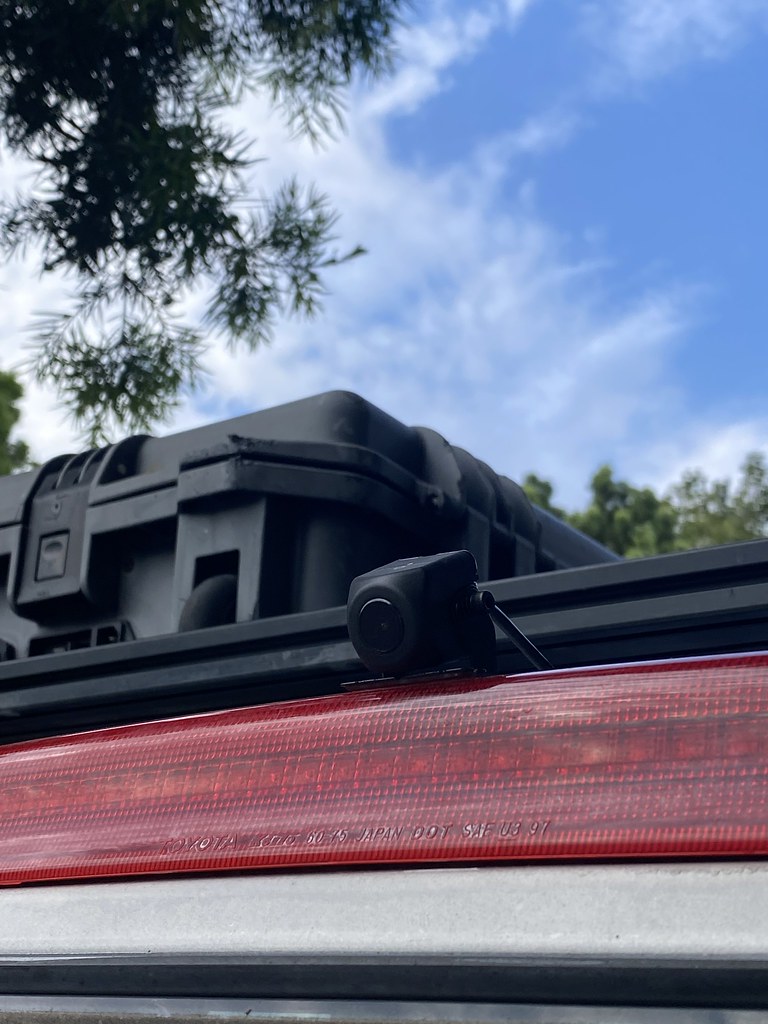

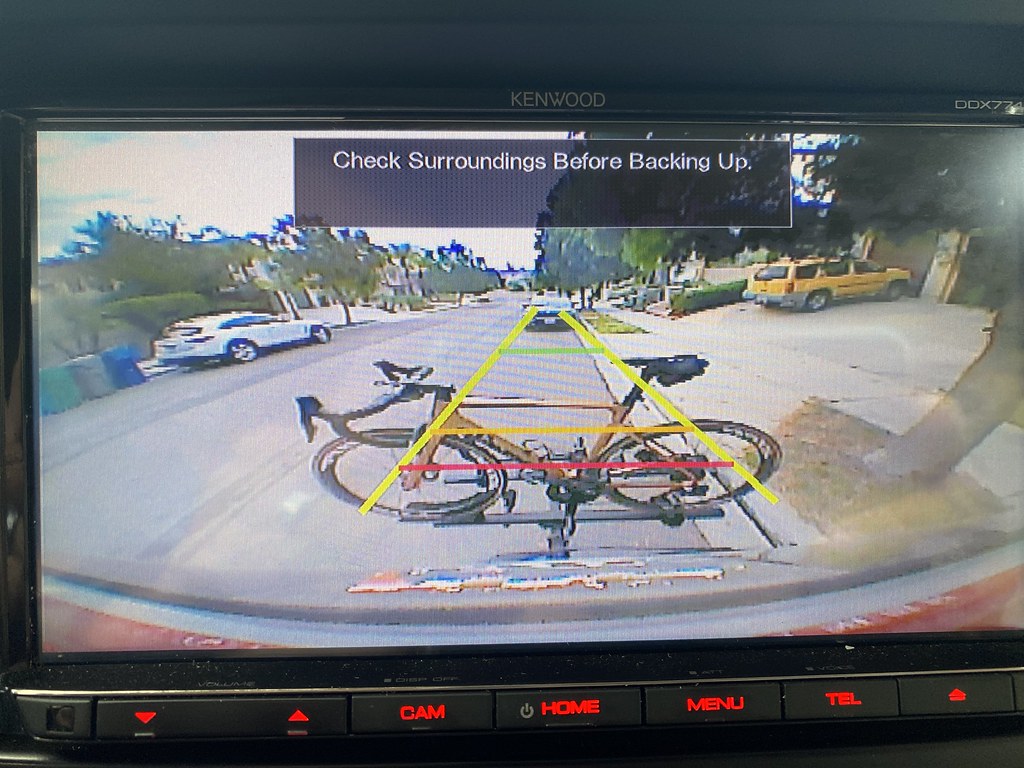

finally wired in the the back up camera to the Kenwood deck. Mounted at on 3rd brake light for wider sky view angle, as I always have bike hitch on the truck. Also installed some Wells window visors. Nice sound improvement when windows are open too.

What exactly was your reverse cam solution? I'm in the same situation with my bike rack.

not the best res or even close but the screen is also low res so mute point. Used Pioneer NDBC8 wide view, decent night vision that is more grainy. Mounted direct to scuffed up 3rd brake light using the stock double sided tape, used same grommet as the 3rd light into the roof liner with silicon to patch the hole. Camera cable was plenty long enough to run this route to the deck. If the tape fails I'll get more robust epoxy. Got the idea from Sprinter Van bird's eye camera view. Works great with the bike rack, I have the red lines to the 2nd bike tray and right side matches the curb. Kenwood deck had a "trigger" wire that would sense when in Reverese. I tapped in the tailgate reverse light. My 01' LX didn't color match what 00' wires into the ECU so I didn't want to take chances and just run into the bulb.
