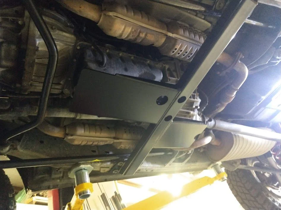

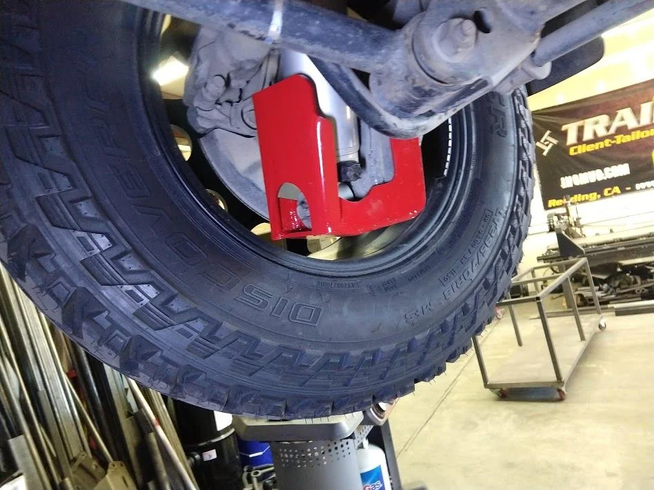

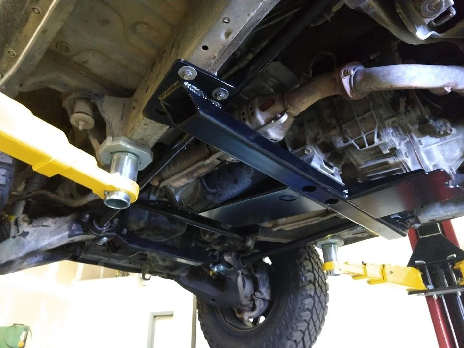

Rear shock guards and CREEPER skid installed.

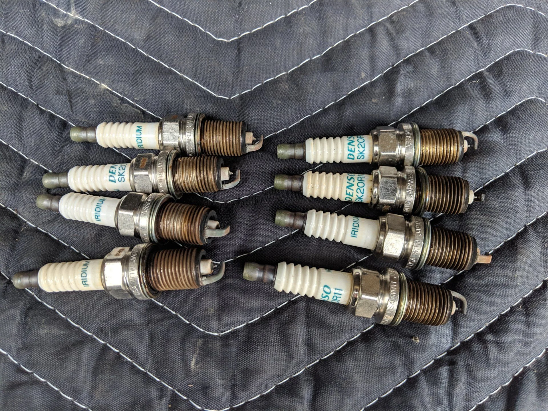

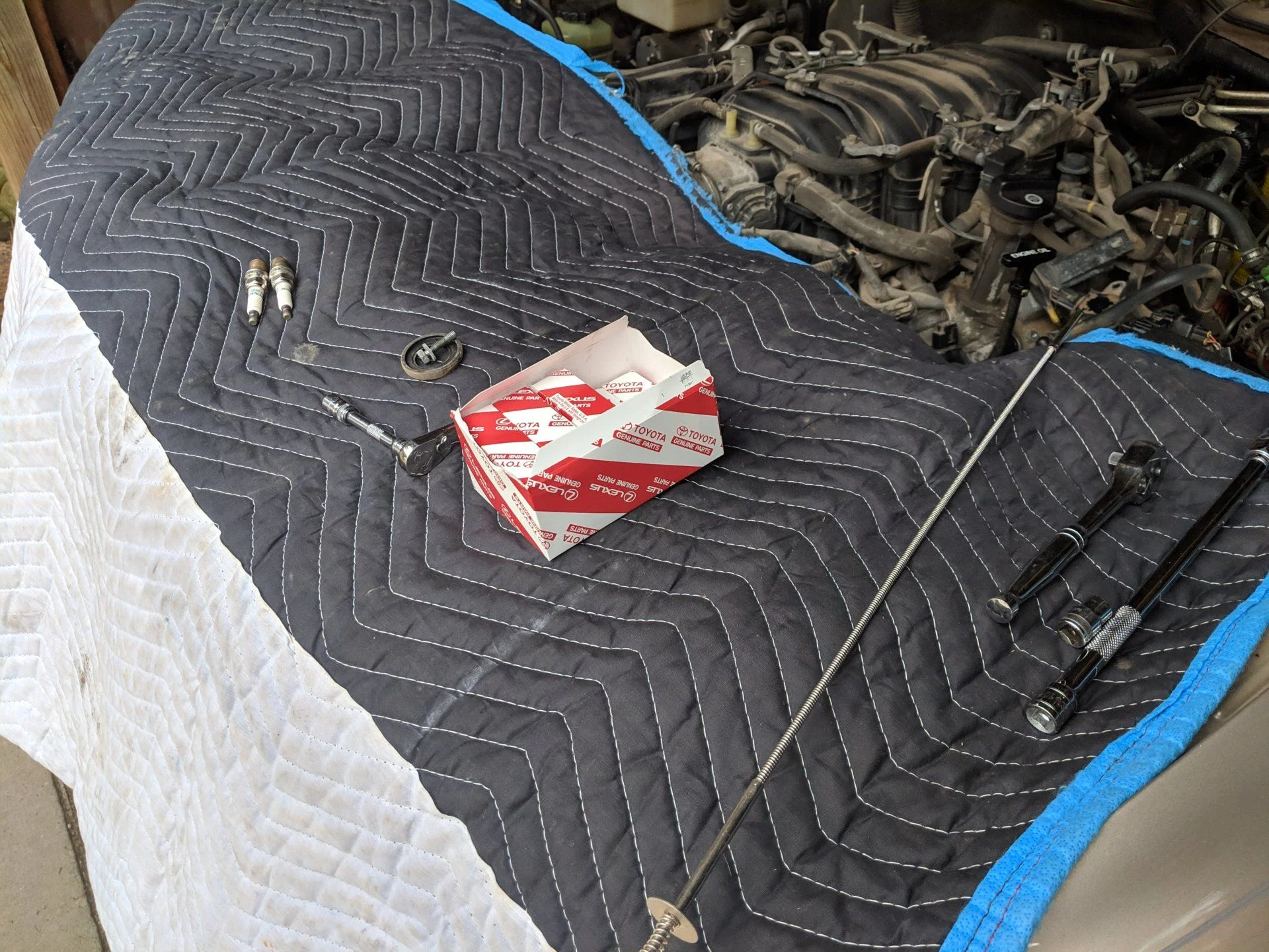

New plugs today. Local parts store only had seven Densos in stock :bang: so I went to the dealer who wanted $12/ea. Told them I'd take one and go to parts store for the other seven, but the good man at the counter offered to price match the $8/ea to save me the trip. :clap:
Install was a breeze. I don't know how many miles were on the old plugs, but they looked good.

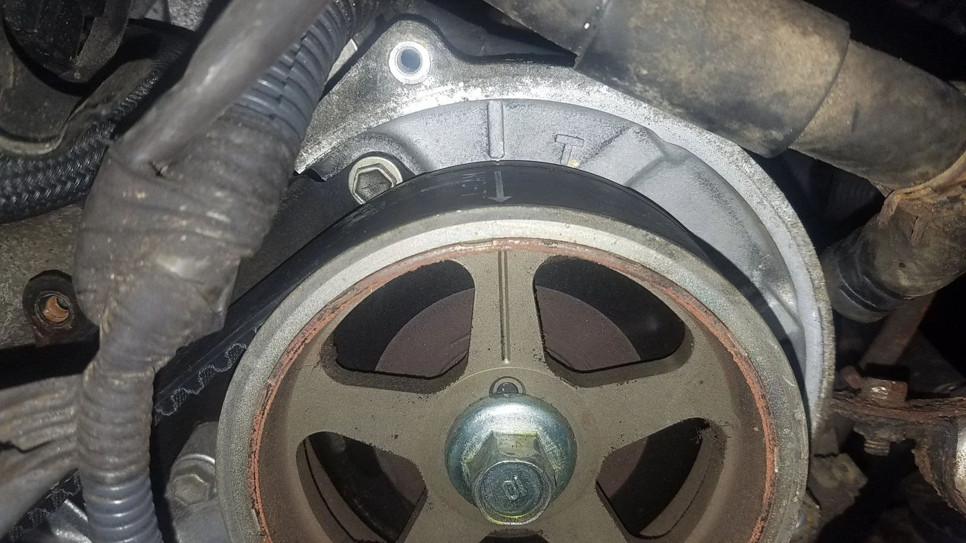

Replaced timing belt, fan bracket, water pump, etc etc. Most of the job went smoothly. Except a broken bolt (alternator mount) and crank pulley bolt!

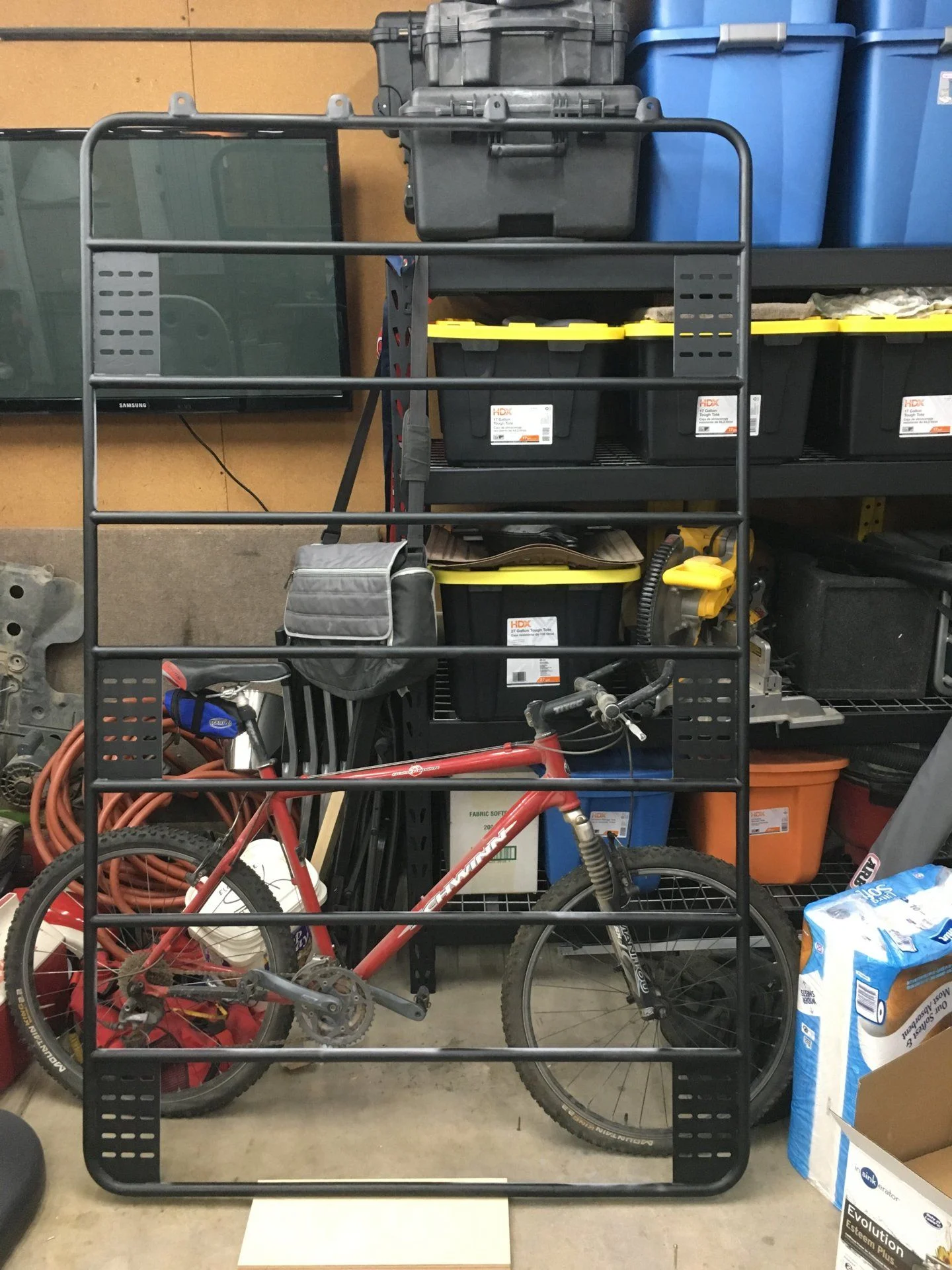

Repainting my rack, which seems to be an every 2-ish years job- still have a couple coats to go tomorrow (this is just one coat on one side)

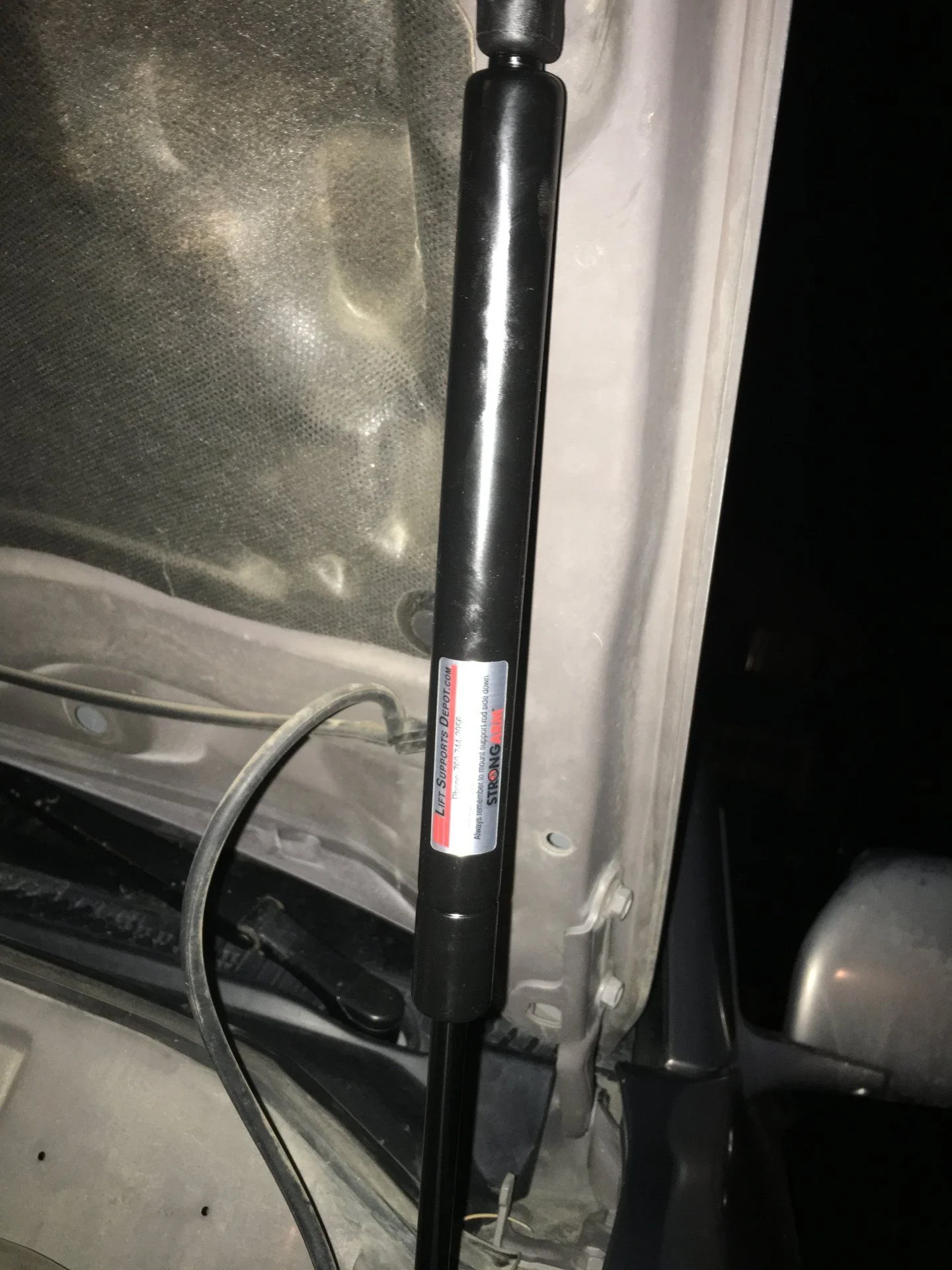

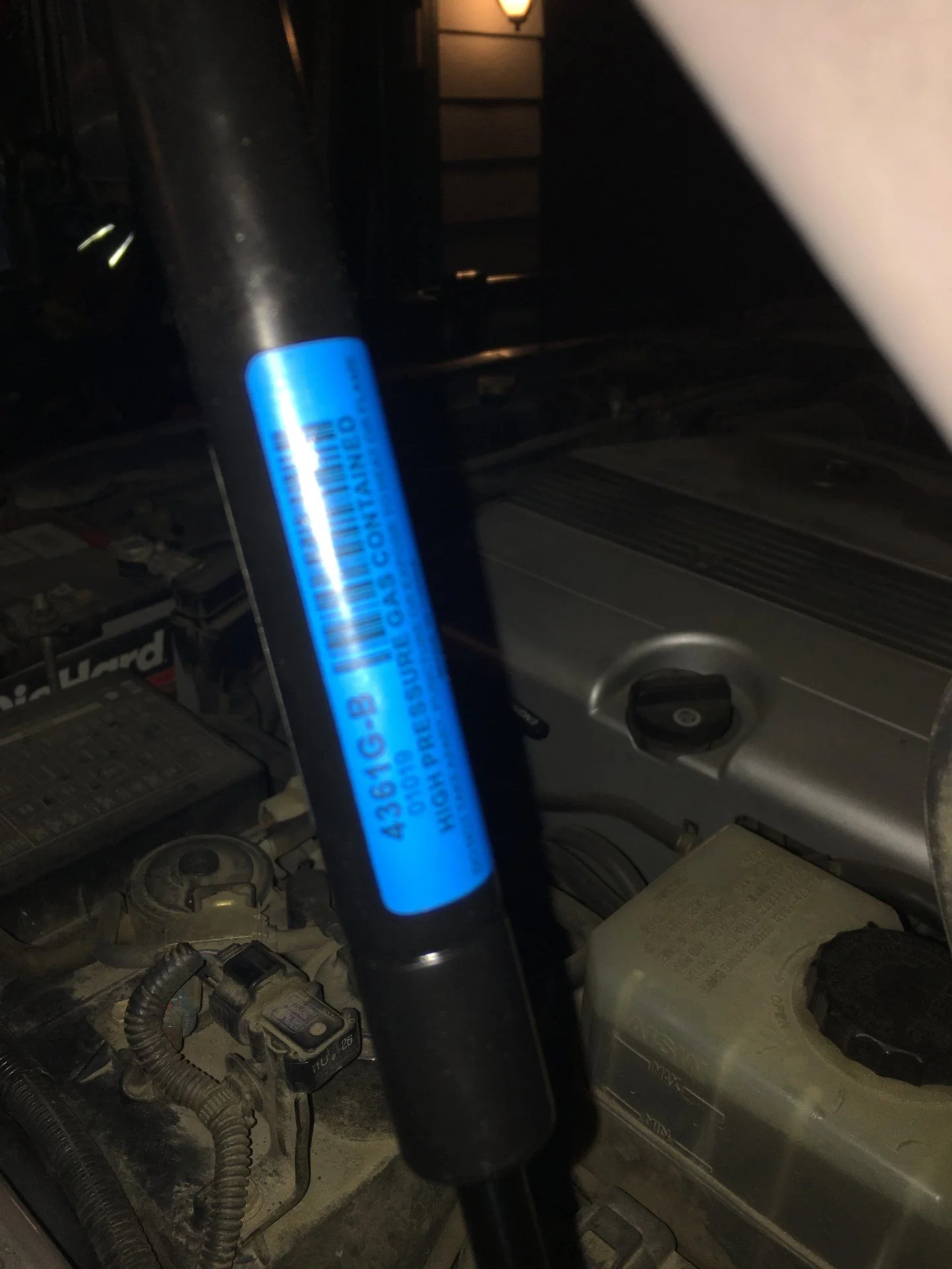

... and I FINALLY replaced my hood struts. I’m not sure why I put it off for years- took all of 5 minutes to swap out and they were only $27 with free shipping on eBay lol.

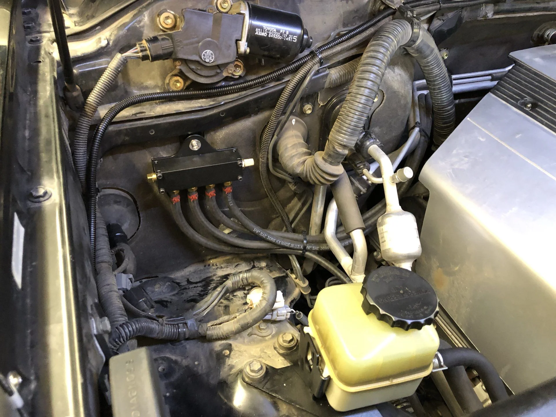

Finished up my home-brew diff breather kit. All in all, a pretty rewarding little project. BUT, reaching the transmission and t-case breather ports was a major PITA and I hope I never have to do that again.
A big thank you to @willbt for your write-up on the subject! More info here:

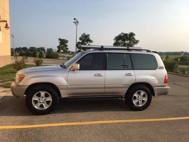

poser pic from fall before it got real cold here

Where'd you source the body lift? I'm on the fence with the idea of adding 1/2-1", and I kind of want to see what all is involved for the 100 series specifically. TIA
Made 1" thick aluminum pucks at work. I have machine shop access. Ordered bolts and material from McMaster-Carr. Any machine shop can make them for you. If you can't find one let me know, where you located?
Best info here:
Thanks for that—Salt Lake City. I think Trail Tailor mentioned making sets, too. I'll run though that link and see what's what. I'm still in the research part—"research" is about all I get done when it's cold out.
