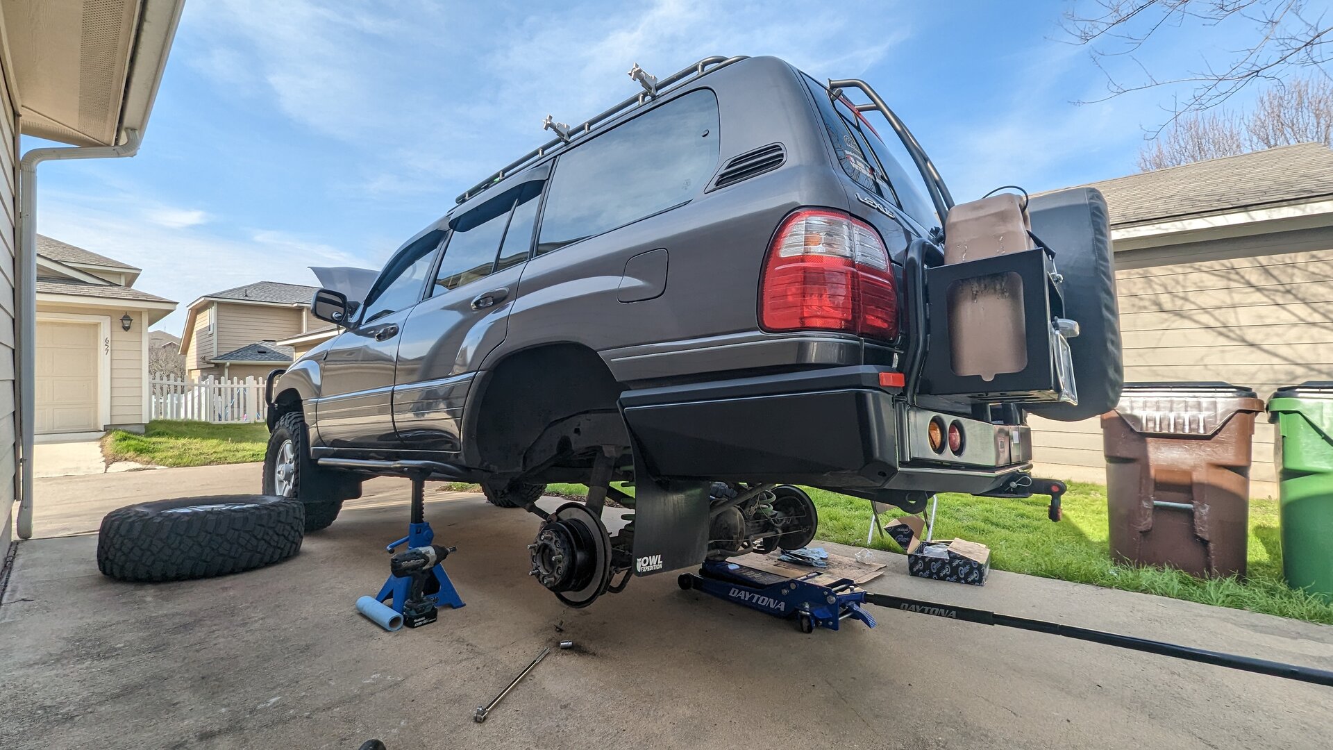

Spent the weekend swapping in heavy springs, brakes at all 4 corners, lower ball joints, nitro upper control arms, and servicing the wheel bearings. Feels like a new truck again. No more odd creaks or pops when first getting into it, it handles the typical dips around my house much better up front and in the rear, and I have the peace of mind of freshly serviced wheel bearings. Spindle nuts on both sides were finger tight, showing obvious signs that the last person to work on it simply reinstalled them with a flathead and hammer. Sitting at Firestone now getting an alignment.

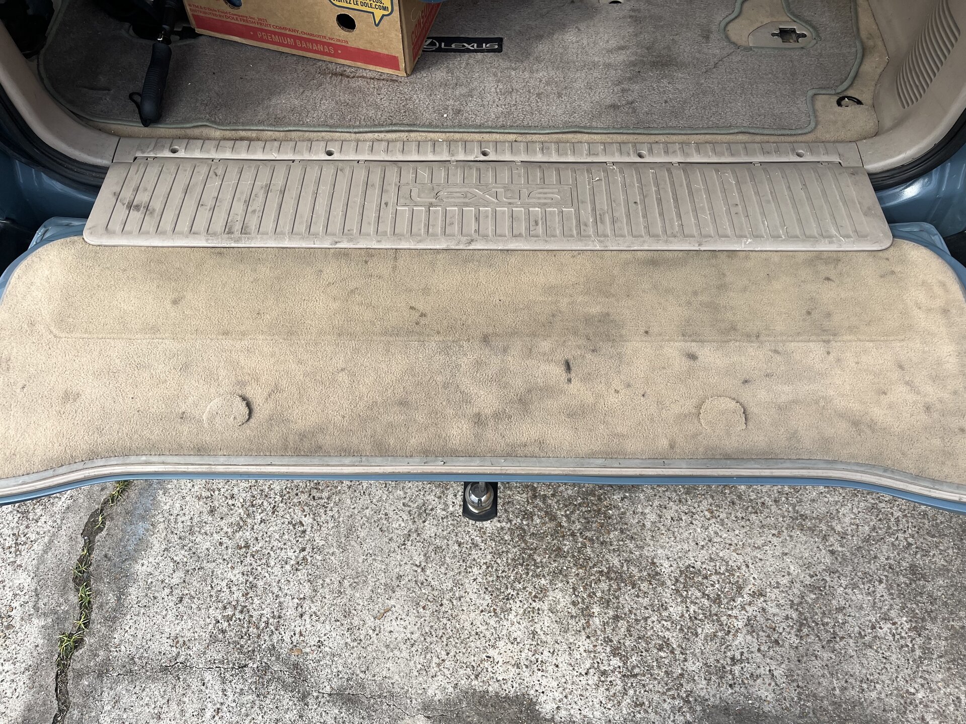

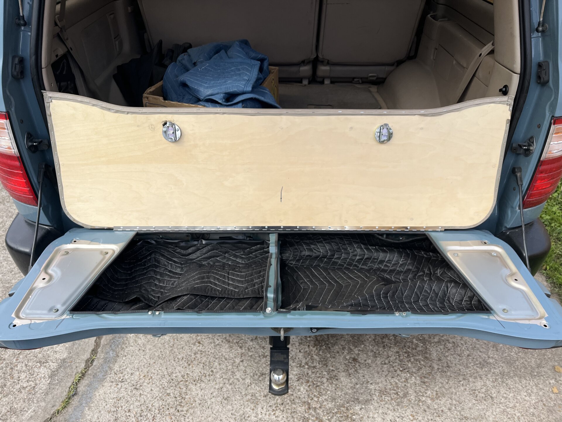

Nice! What kind of latches did you use?
First things first, I DO NOT recommend the latches I used. I had them lying around so I used what I had.
Amazon product ASIN B07P6WNV26
The problem with them is that they are extremely hard to fine tune. In order to get the lid to close firmly, I had to go back and forth and back and forth slowly grinding away at a stopper until the fitment was perfect. There are some flush pull latches that have a little bolt you can adjust to the correct height. Get those instead!
Only other requirement is something that can be locked. My cruiser has been victim of a smash and grab before, so if I want to leave stuff in it, it better be behind a lock. Even then it wouldn't be too hard to break the lid off, hence why I tried to (sort of) conceal it. If you weren't looking for it you probably wouldn't notice it.
