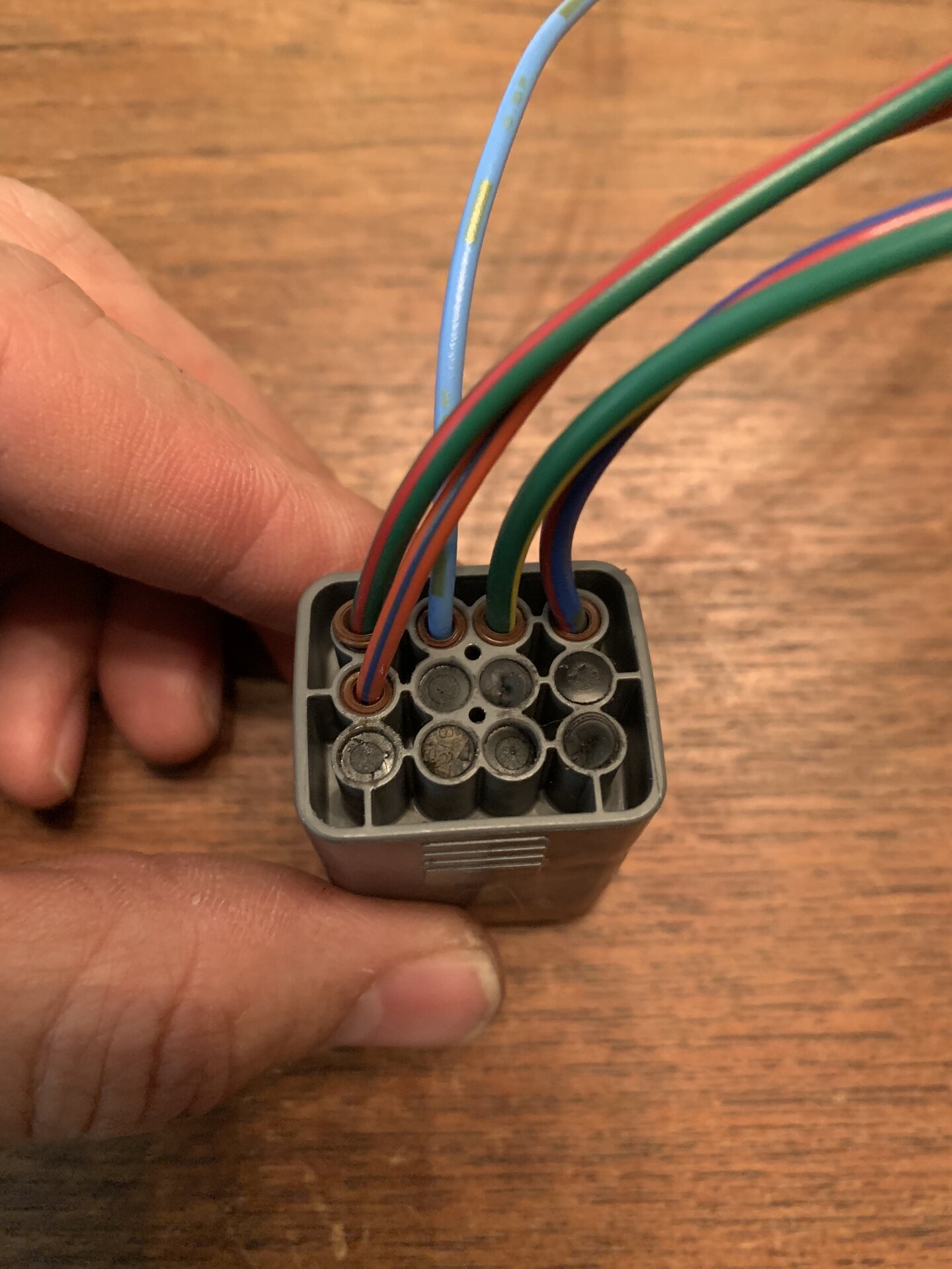

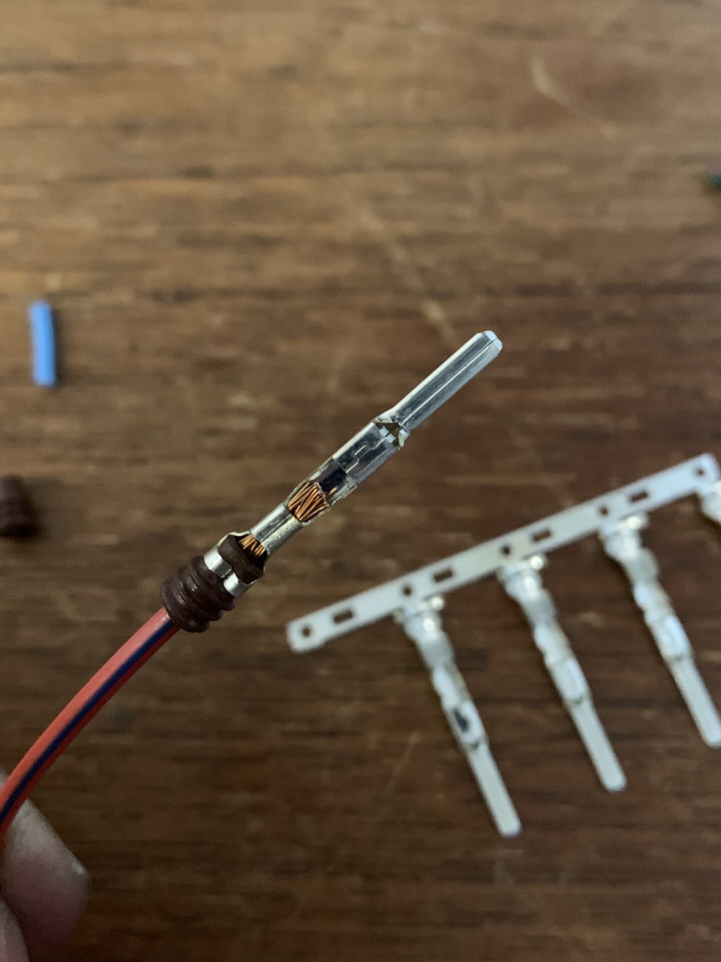

I bypassed the amp 7 years ago when I installed my first aftermarket radio, before amp bypass kits were available. I don't think it was a difficult task by any means, but I am also a wiring geek and enjoy looking at the EWD's :) I ran 8 new wires from behind the radio to the amp area under the seat (2 wires per speaker) and soldered them to the wires feeding the door speakers. I remember soldering power and grounds together under the seat as well. You will loose the factory sub. I am no audiophile, but bypassing the amp made a huuuuuge improvement in sound quality even utilizing the well used factory speakers in the doors. Don't worry, you won't miss the crappy factory sub.

I used some Metra adapter, but all I am using it for is the 12v+, ignition and ground. The power antenna trigger also goes through the adapter but I don't have it hooked up since I have a manual antenna due to snorkel interference. I did add a generic 8 pin connector for the speaker wires.

I did a double din from crutchfield along with front speakers and they included the amp bypass harness with it. I paid $24 for them to connect all the wires specifically for my 01. Install was super easy and I'm not an audio/electrical guy whatsoever, so it was worth it to me. CarPlay wasn't a must but it is quite nice and I haven't had any serious issues with it other than it cutting out once in a blue moon.
