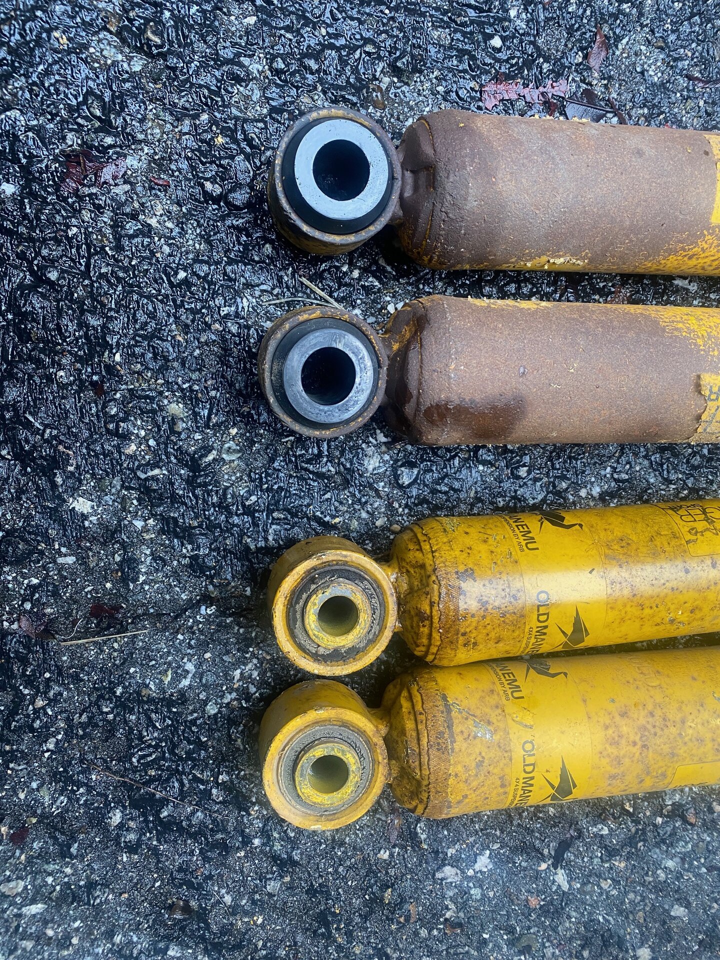

Here's what the OME Nitrochargers look like after about 50k hard miles:
Don't have a lot to say about the Dobinsons IMS setup yet but anything would be better after seeing the state of these old Emu's.

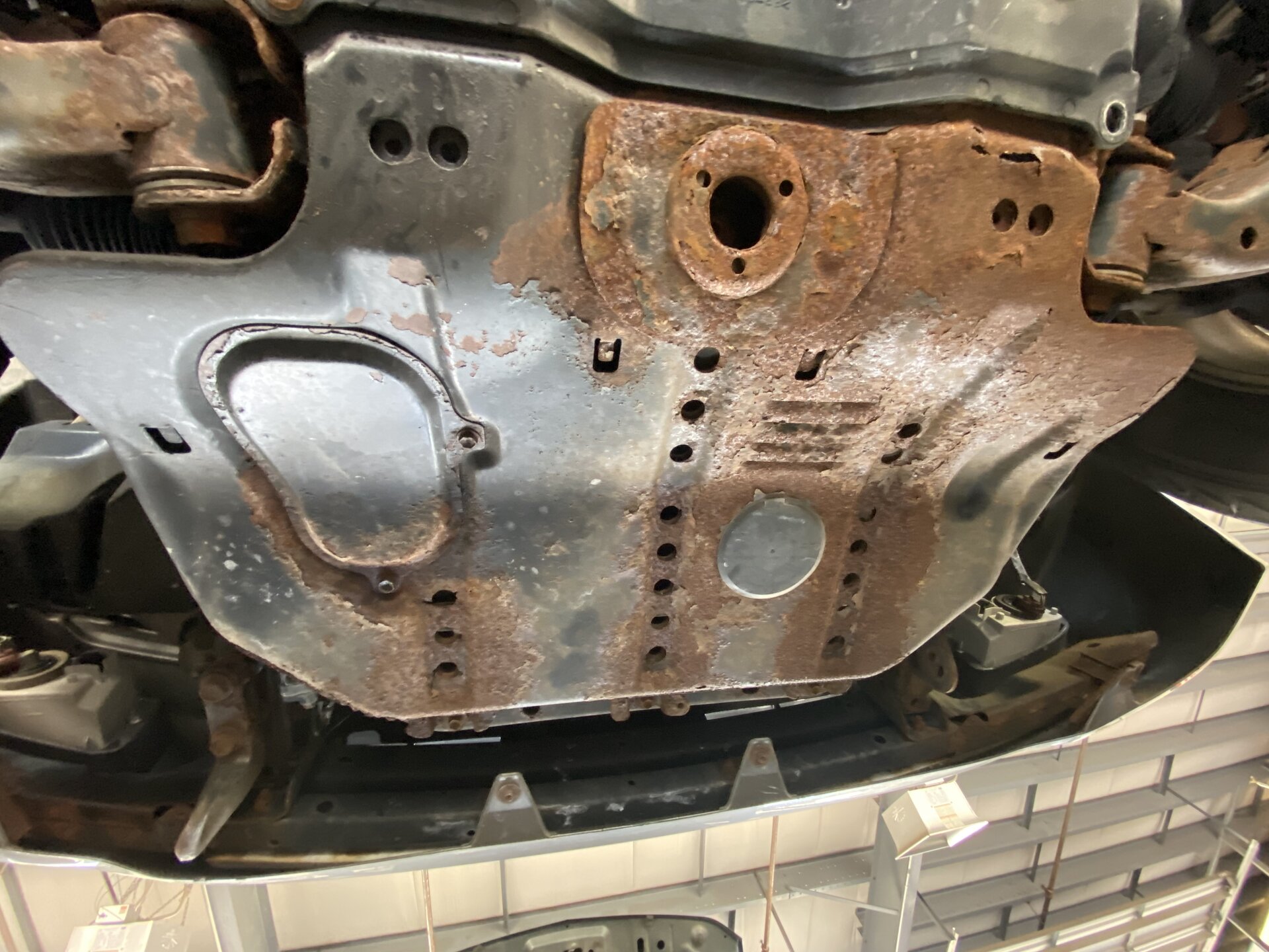

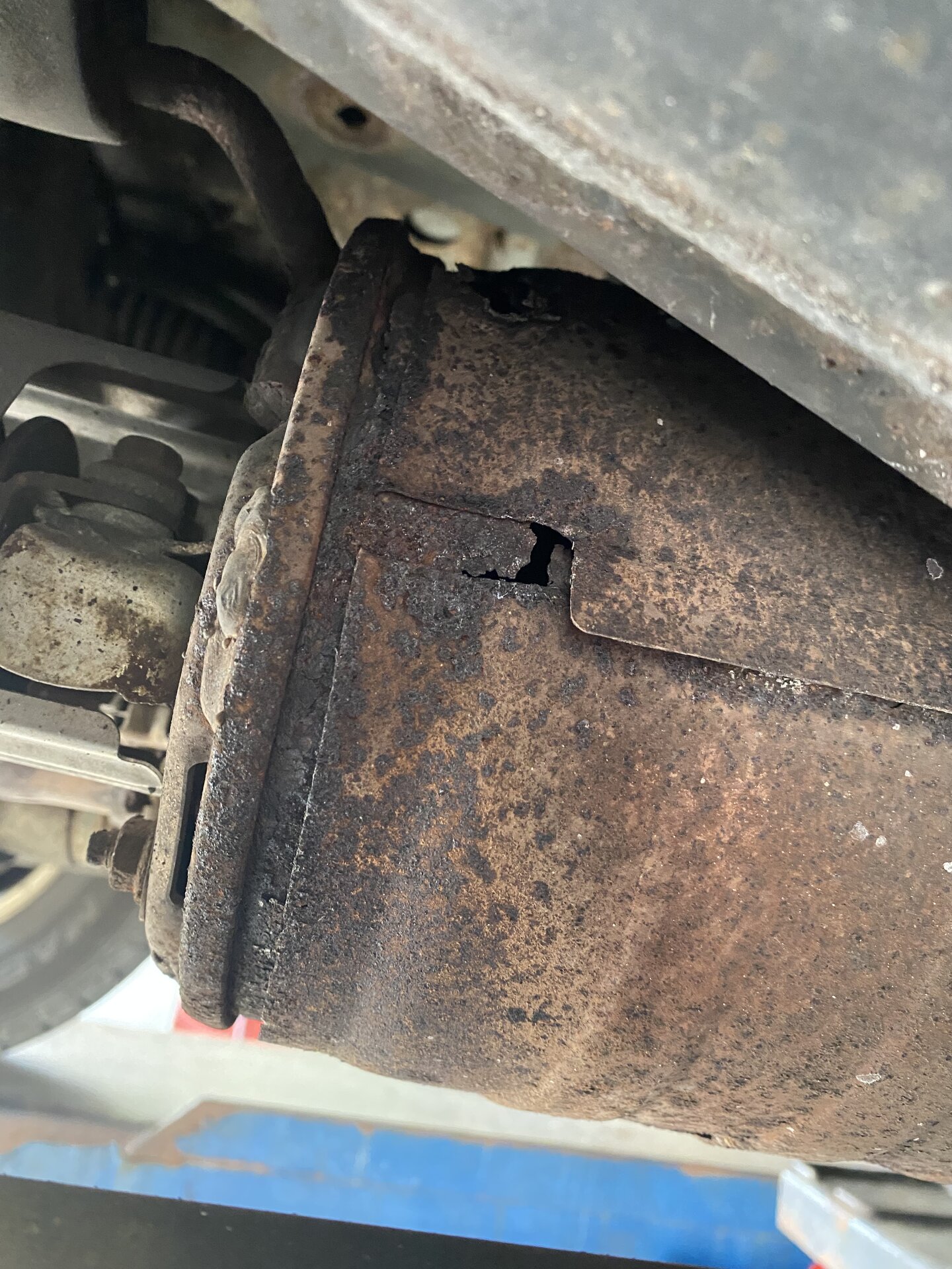

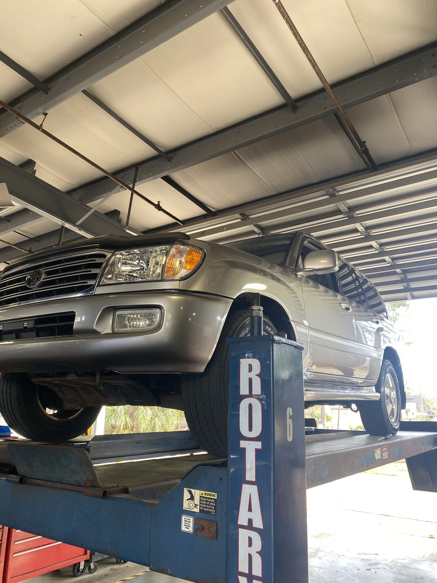

Went to the base today and got her on a lift. This is an Ohio truck, my wife is original owner, less than 100k miles. Now in Florida.
Bad: muffler is gone, gas tank shield is gone, front engine ‘guard’ is close to gone.
Good, after scraping appears only surface rust on frame and welded supports (crossmembers may need replaced someday), brake lines looked good.
After all the scraping, did what I could laying on the ground with some rust converter. Will likely become a semi annual maintenance check item as well.
Regardless, frame seems good (knock on wood), time to start replacing every bushing/hose/rubber piece I can find, moly the drive shaft, get some steel tundra wheels….and on and on and on….!
Yep, that's it.
It's worth mentioning that for the same price you can get an Asfir skid that is 1/4" aluminum and considerably more substantial than the stamped sheet metal factory one.
Thanks, I did see a thread on those but haven’t had a chance to dig into it.
