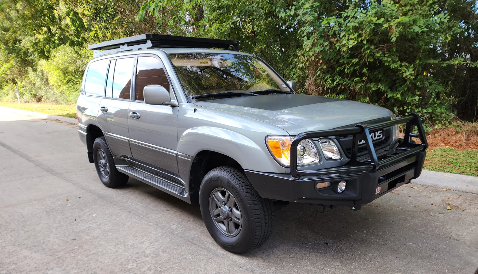

Hood blackout installed. Bumper installed. Additional master key added/programmed.
I have a faded clear problem, as well. I have another car that's black and needs paint. Sooner or later my truck's hood will likely turn black. Did you mask and paint or is that a vinyl overlay?
It's the vinyl from Crawlorado. It did wonders to cover up faded clear coat and I really like the way it pulls together my truck visually with the bumper and roof rack being black as well. The instructions from Crawlorado could use some serious updating, but the install wasn't difficult. I ordered the felt squeegee with the vinyl and some vinyl spray from Amazon.

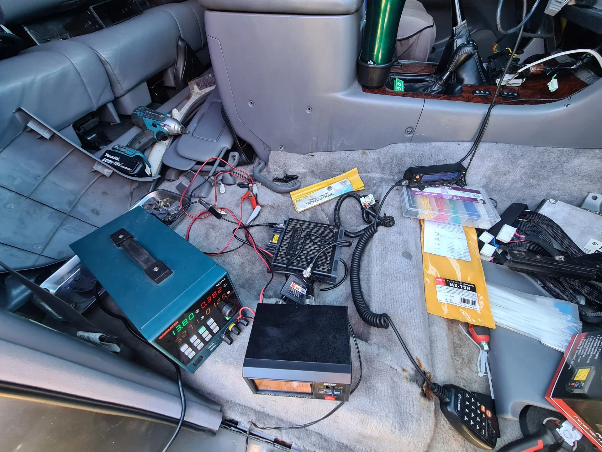

Decided to change radio's position, replace CB antenna, install a second one (UHF) and a duplexer.
Of course that I eventually half disassembled the rig and fixed other things too as they've popped along the process....
Enough for today, it's getting cold.

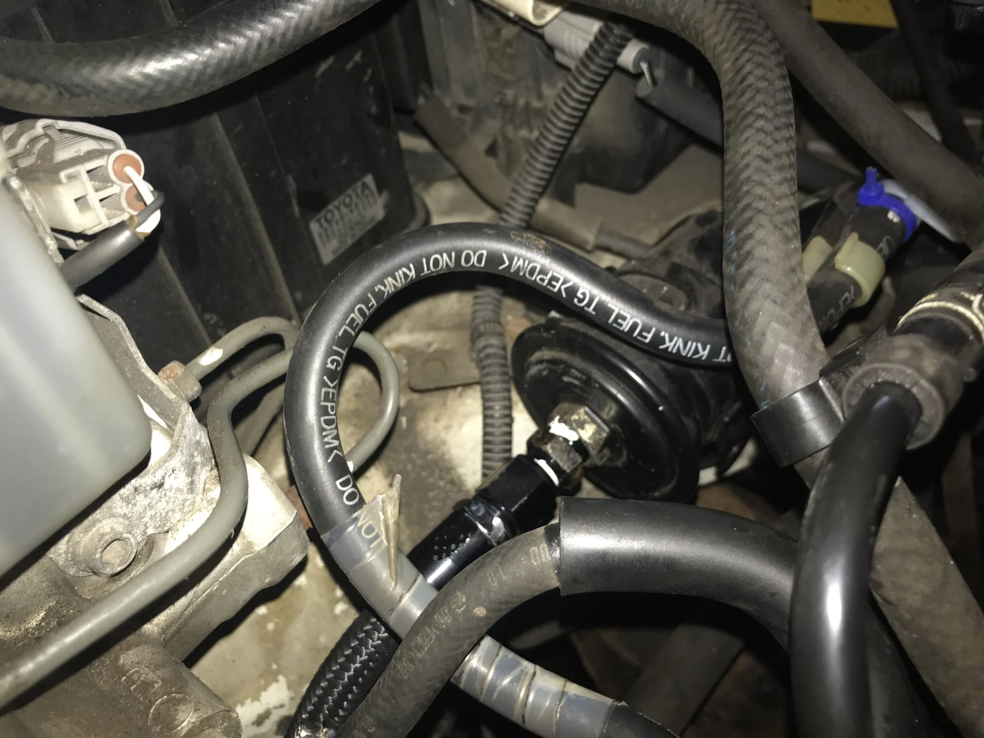

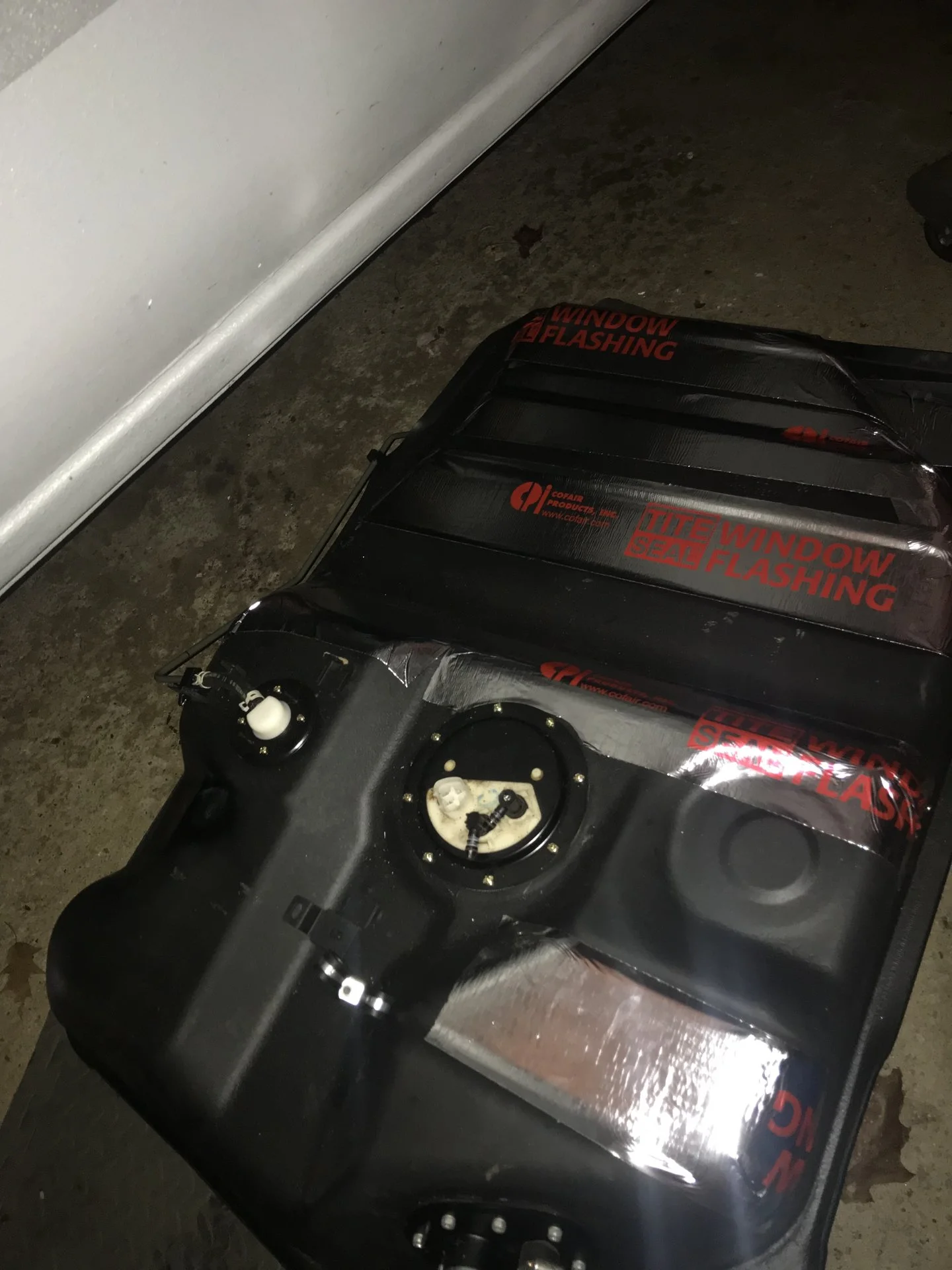

Tried installing the fuel tank last night and I could not get the bolt in through the strap. Going to try again tonight with a 70mm bolt and see if I can get the straps to form up a bit. I’ve run new nicop brake lines from the front as well as fuel lines. Also been cleaning up the chassis and axle, one side shows sorta what the other looked like before cleaning it up. Still need to do the same down the passengers sid along the muffler.
Fuel tank in place, pro tip for those that struggle with replacing fuel tank straps in the future, use a 50mm bolt, slightly longer than stock but not too long that you have to put the stock one back in place after snugging straps up. 50mm bolt is perfect solution when bolting up the straps.

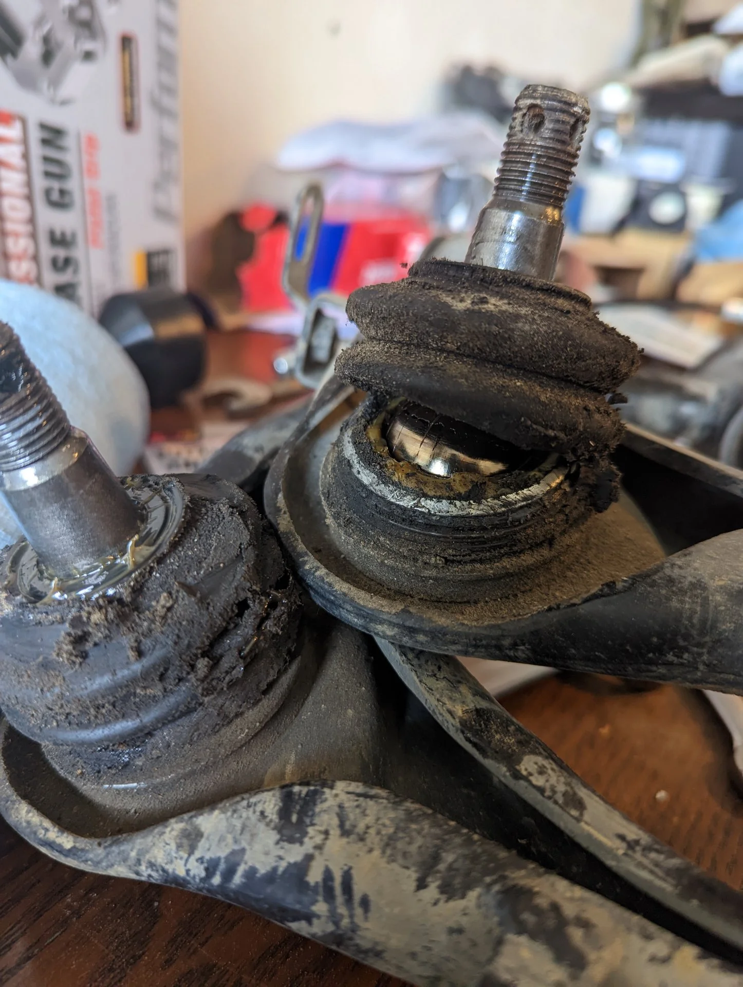

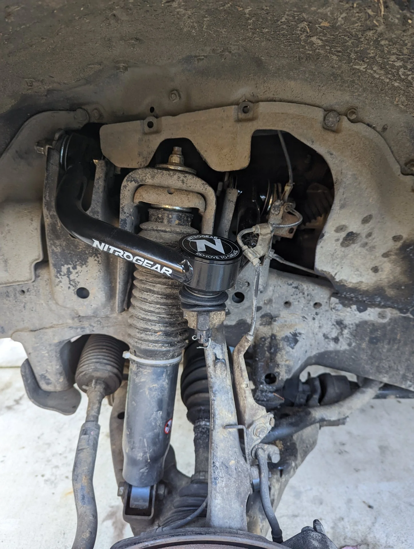

I just finished(like 10 min ago) installing my UCA's and sway bar links. I've been procrastinating the control arms for almost two months. The OEM ones I removed I believe are originals. 253k and were totally shot. Took about 4 hours - my first time - and wasn't terribly difficult. Now time for an alignment.

I could have used this pro tip yesterday! After a lot of struggle, I got the rear tank strap in place and tightened, but that rear inside mounting bolt is quite difficult. Great tip for others in the same boat, as I was unsure how much longer of a bolt could be used. Because those straps are secured to the body, not the frame, I was hesitant to use a longer bolt unless needed. Glad you got that project wrapped up!
I'd bought a 50mm and a 70mm bolt hoping one would work, and the 50mm worked like a charm and didn't bottom out on the body.
I said to hell with them both and replaced them with zinc galvanized strapping. Holds as tight and in location as stock. Though, I doubt either of you are in the rusty fun filled mess that I am 😂.

If I hadn't already put it back together I would likely borrow that idea! Re: rust, here in Maine we're about as familiar with rust as it gets. The combination of the ocean and a snowy/icy climate make working under vehicles very... fun? :vomit: I suspect @2020 Rocks may be in a similar situation over in Ohio unfortunately. I suppose anyone in need of tank replacement due to rust is familiar with how enjoyable it makes it to work under a Cruiser.

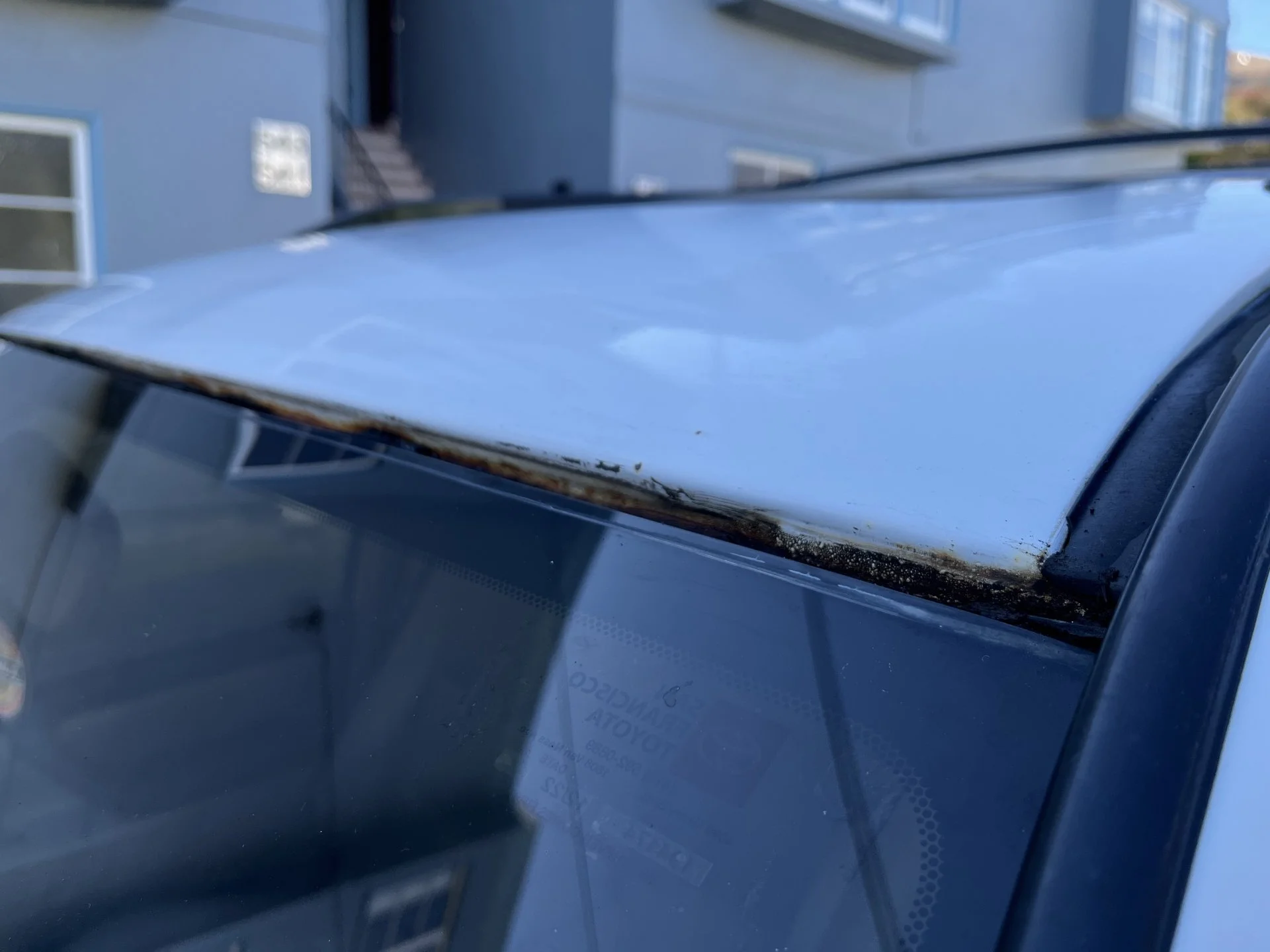

So I finally found a windshield installer near me that seemed like they would do a good job, use rivets, oem gaskets/seals, etc. I had a mobile appointment scheduled this morning. I removed the wipers, cowl, and screws from the previous install in preparation. I didn't full remove the side trim, but I peeked behind it and it all looked pretty good.
Unfortunately, the installers found rust behind the top seal when they pulled it (doesn't look too bad to me). While they said they could do minor rust repair, they were afraid to go any further with the job and recommended I take it to a body shop.
Now I'm left searching for body shops in the SF Bay Area that can fix this and install new glass. On top of that, I'm moving in three weeks and am really hoping I can get this fixed in time.
Even though they didn't complete the job, I would recommend Super Auto Glass if you need a windshield. They seemed really honest and thorough – just wish they were could do more rust repair.
