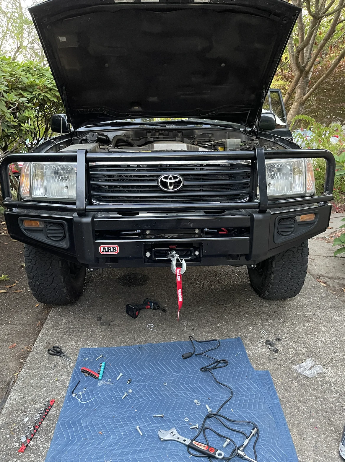

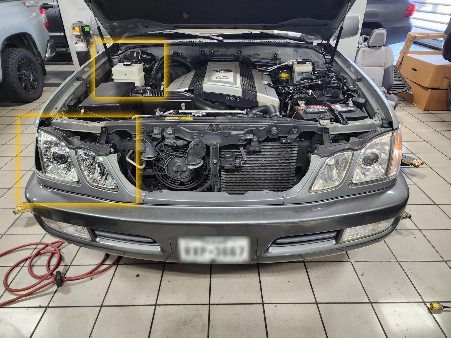

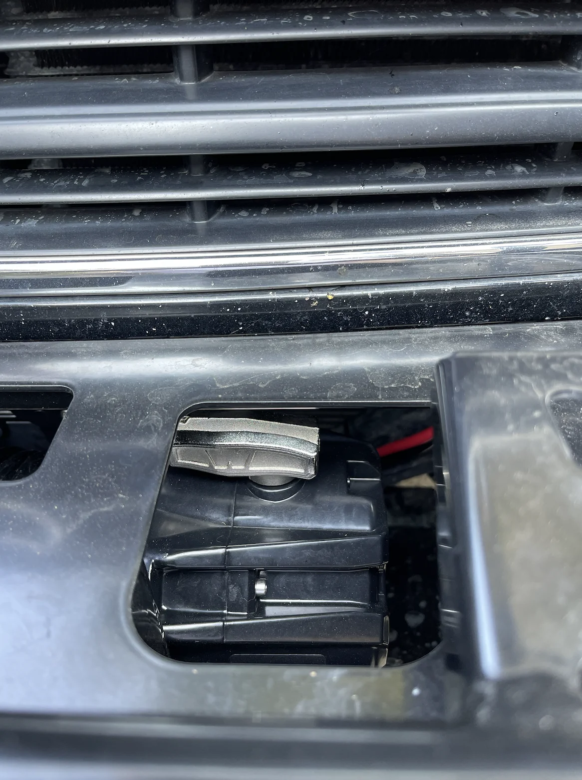

AHC pump and headlight replaced. Forgot how insanely crystal and clear these glass lights are brand new. Now I need to sort out/replace the janky HID kit the PO put on it.
The previous owner on mine replaced one side so that one is a bit clearer for me. The other side works just fine but it always bugs me that it is a bit off. How do you plan to handle it? Just going to replace the other side so they match?
I'll throw some polishing compound at it and buff it clear(er) again. If it needs it, maybe some light sanding. It doesn't bother me $500-$600 worth lol

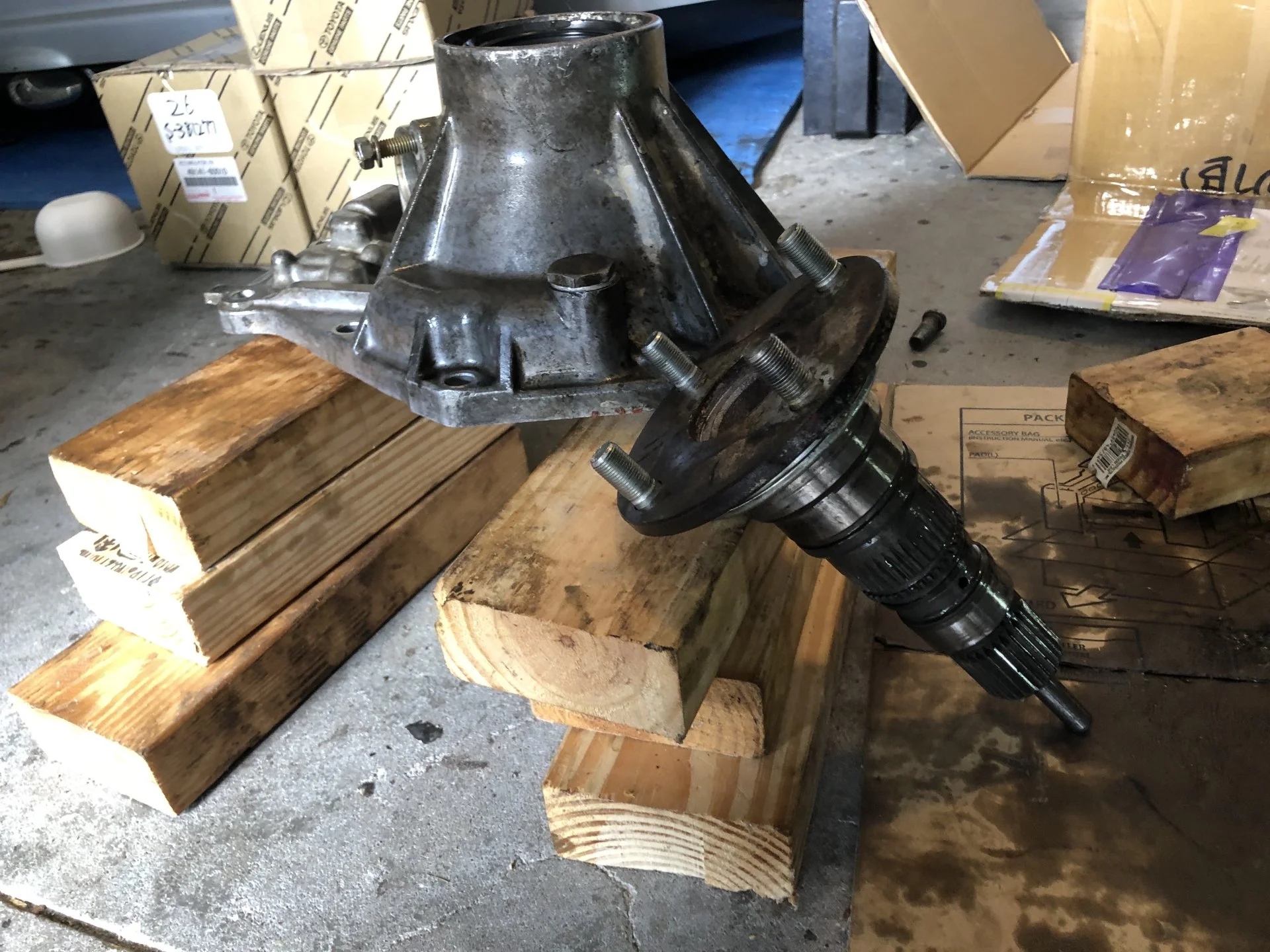

Removed the rear cover of the transfer case to get at the loose dust shield that has been making noise. Got it fixed and went ahead and put a new seal in.... Having some trouble getting it back on though, seems like it isn't sitting flush by a tiny bit on the drivers side. All the videos I've seen show them doing it with the whole tcase off the car... Hmmmm, gonna call it quits and take another stab at it tomorrow.

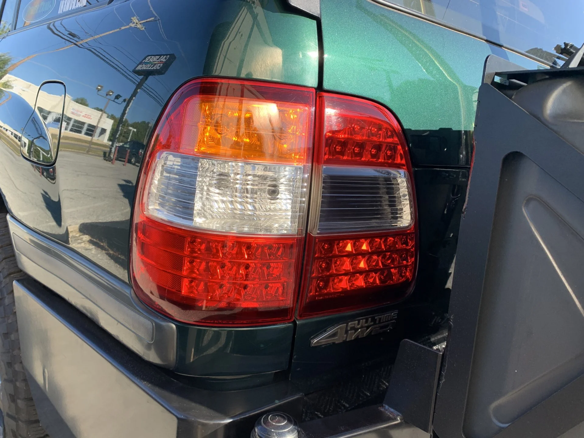

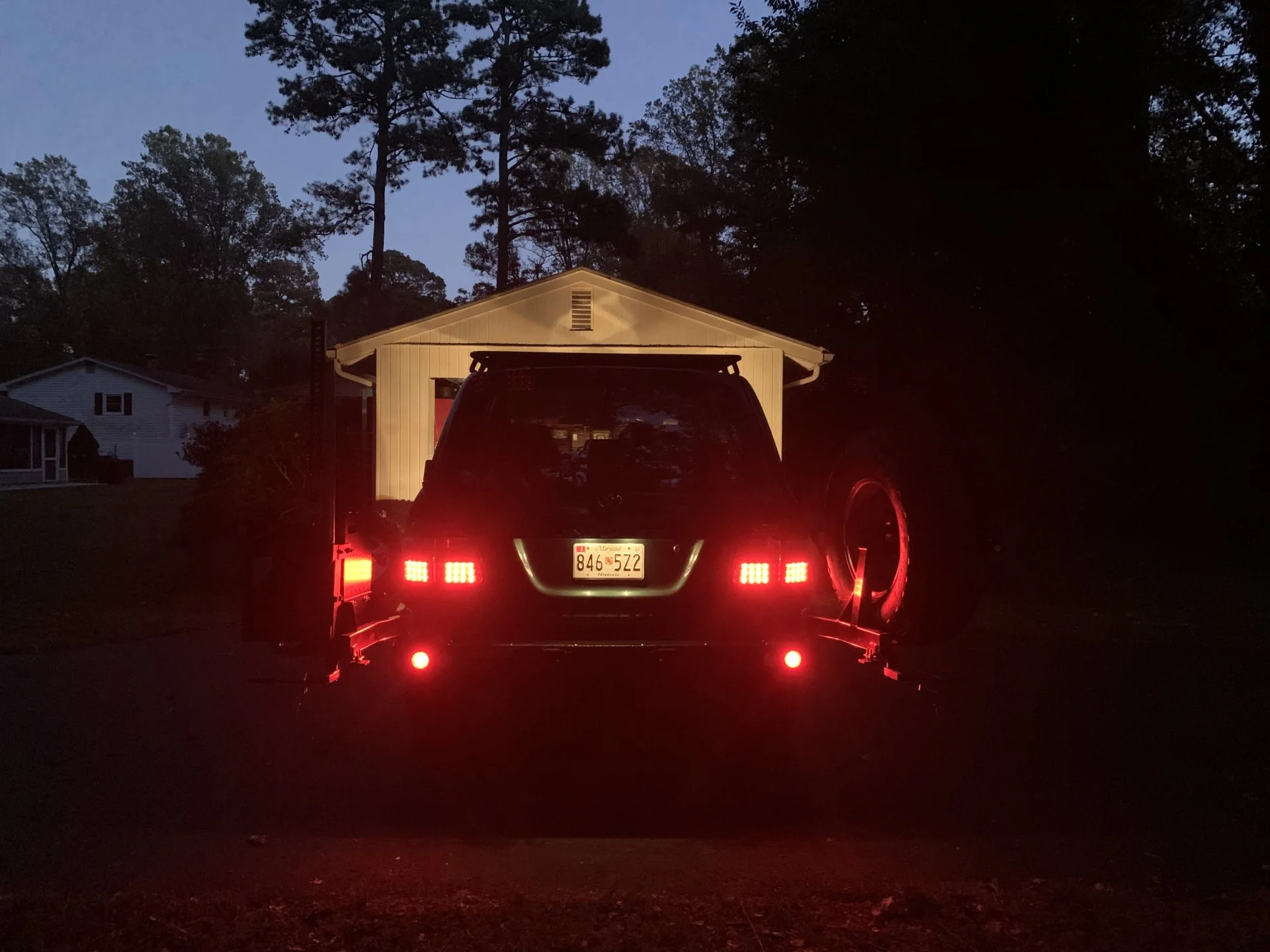

Well after having these on the shelf for 2 years lol I finally got around to installing my VX led taillights
View attachment 3136668View attachment 3136669

make sure the oil pump drive cog is lined up perfectly or it won't sit flush

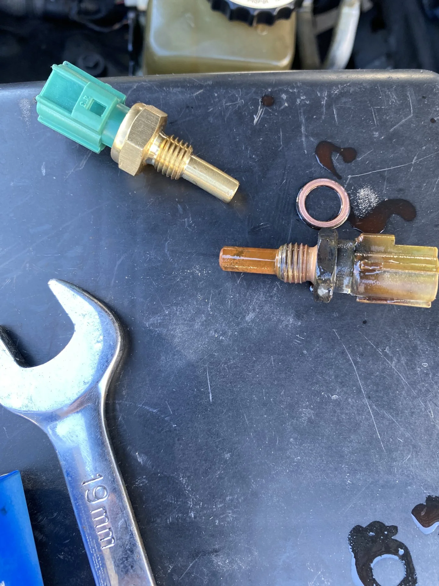

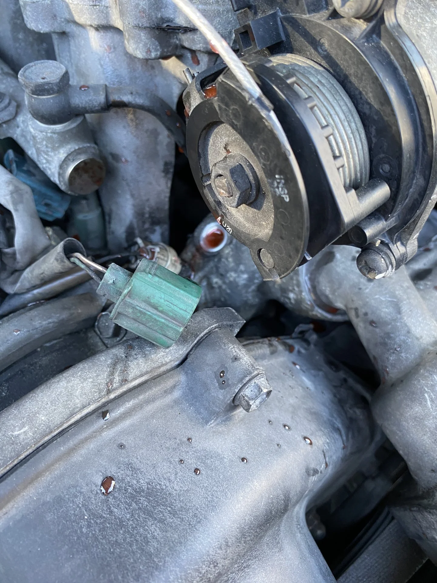

Huge shout out to @ClassyJalopy and @MongooseGA for being generally awesome and having some fantastic ideas to help me along. I had that super sweet cold start 007 Bond smoke screen going on. After eliminating the scaries like head gasket failure or compression loss we came up with this. Thanks, fellas you rock! Burned coolant temperature sensor. I owe you guys some non-HR-approved contact at a later point. Or adult beverages.
Stuff used:
P/N 89422-20010 $57 + new copper crush washer
pick for releasing the plastic clip
19mm (left loosey/righty tighty)
PB blaster for 15 mins.
rag to wipe off the coolant and PB blaster
brake clean to clean up the mess after
One creative curse word
wash your hands you filthy animal.

Those wires running up to that sensor experience a lot of heat cycles and become brittle, you may want to wrap the end there with some extra electrickity tape
Good call sir. That will be next. Thank you. I have some spare loom lying around from that awesome alternator mess so I'll throw that on there for safekeeping along with the electrical tape.
