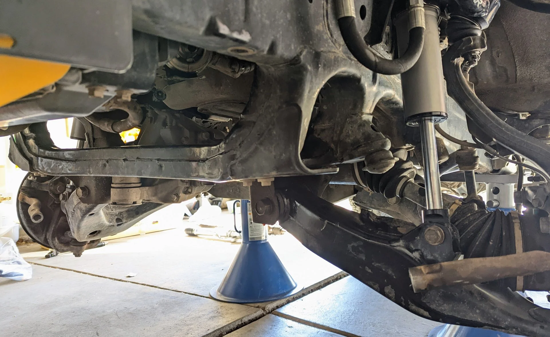

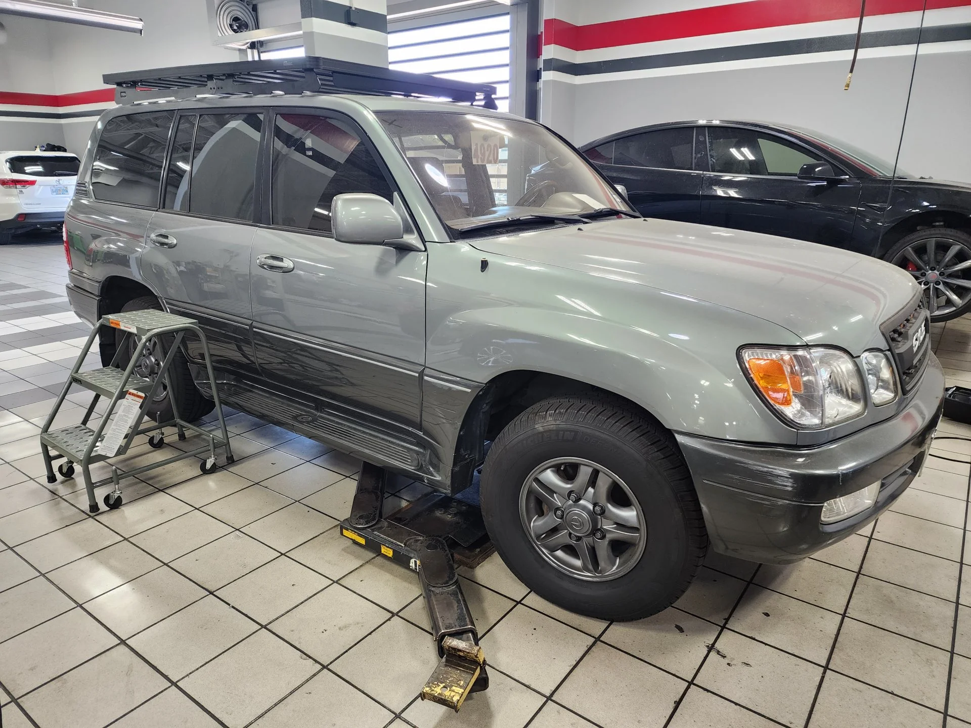

Went to the dealer for an alignment today and change some oils on my other Lexus. While on the alignment rack we ( I ) discovered a damaged torsion bar so no alignment for me after the new rack, all new OEM suspension, and OEM control arms. So, I made do a with sway bar link swap and some not jacked clock spring action. The dealer was pretty butt hurt I did all the previously mentioned stuff on my own so they made sure to find some stuff that is wrong. Hence the clock spring and links. Already knew about the third incoming alternator cause number dos is still howling like a dying cat. Nana nana boo boo stealership. Maybe next time I ask them to do something they'll just take the job I asked for instead of slamming me with a $15k estimate? Here's photos of my sweet clock spring action and links cause we like photos and junk.

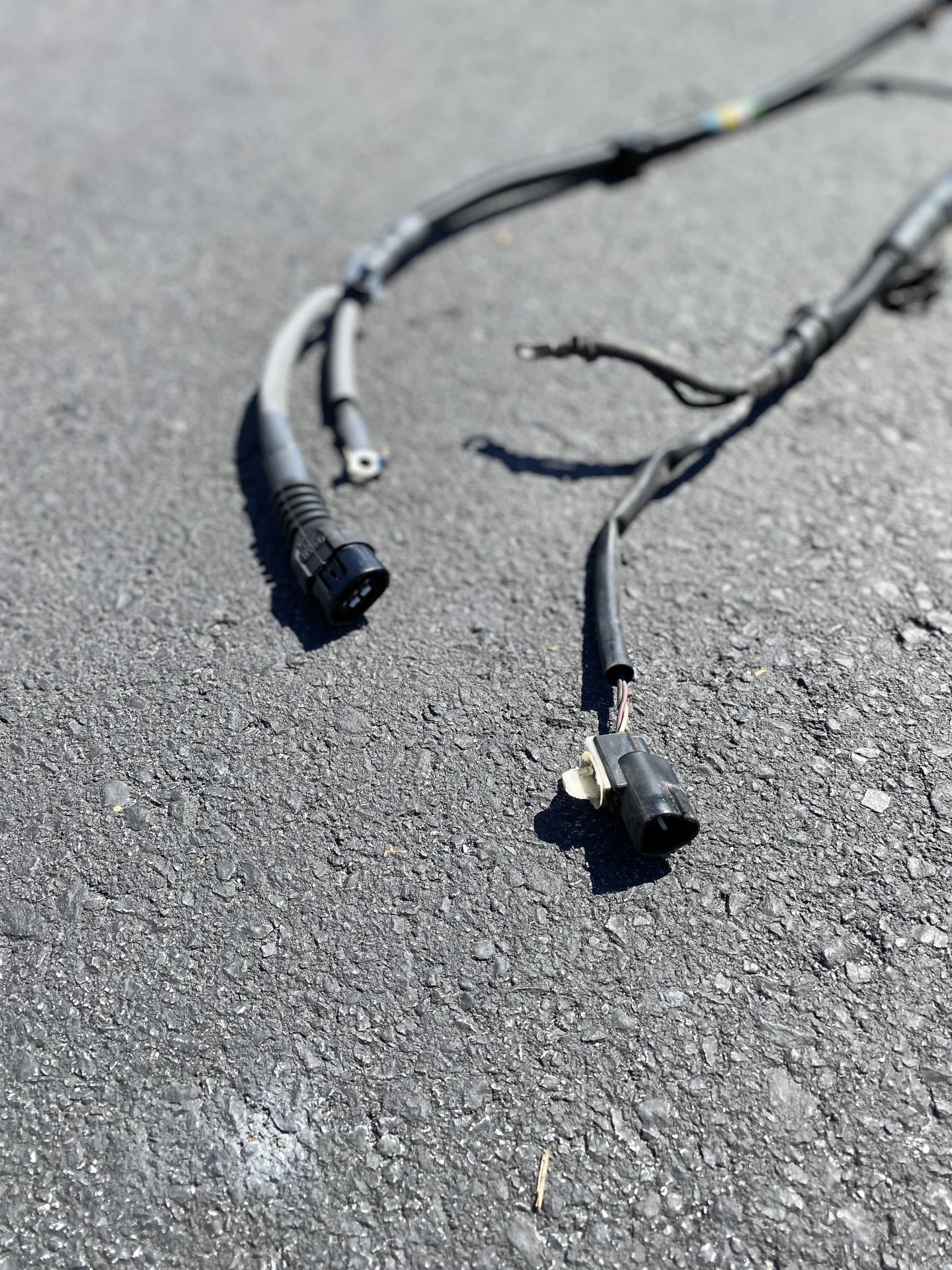

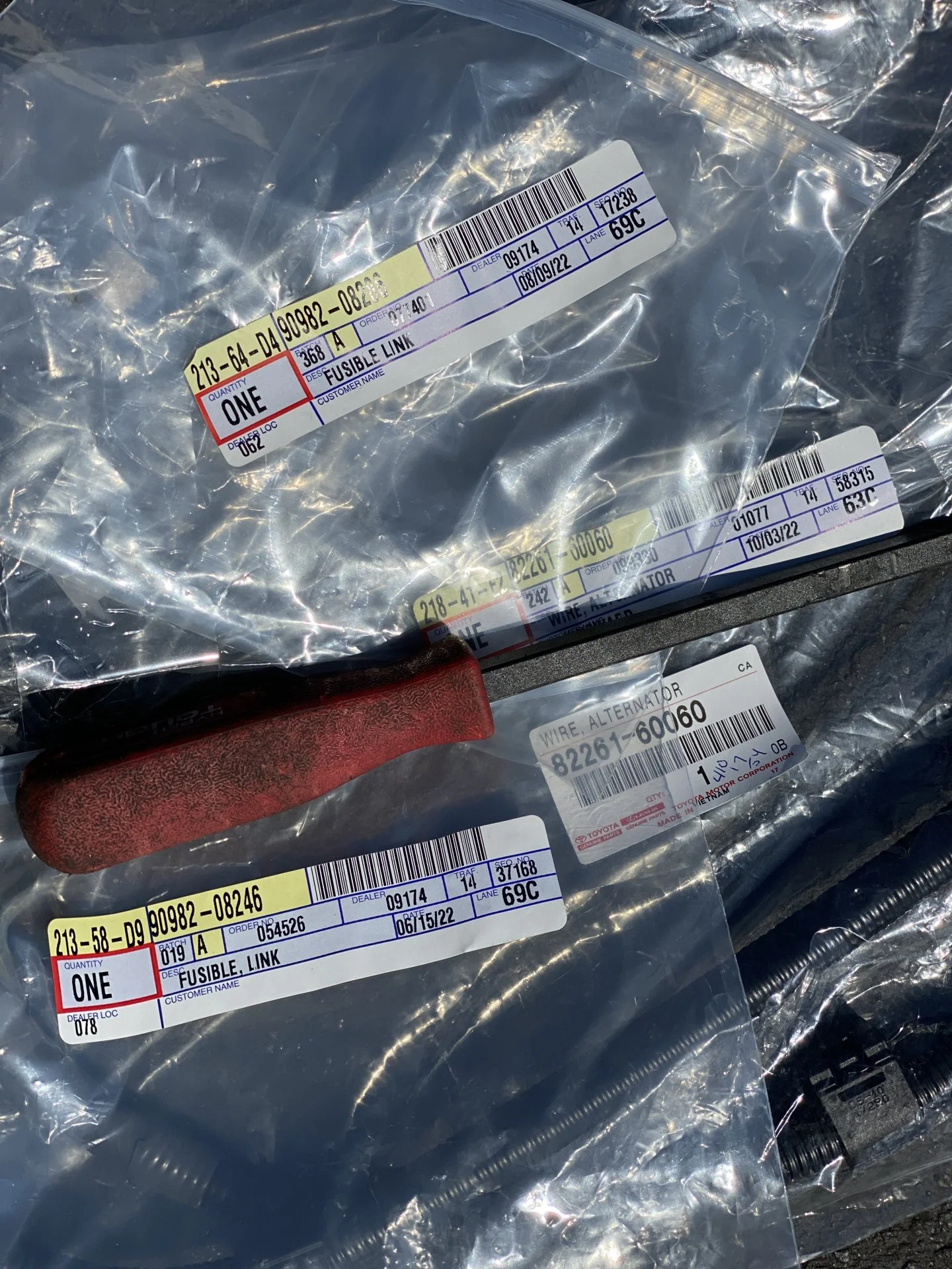

Anyhoo, I made some progress today. Alternator number four works great! New harness, new fuseable links, new terminals. Amazing when it is all new and all OEM it actually works correctly. TBs were ordered to correct the sweet '64 impala bounce I have going. No more leaks, noises, or other garbage. Goes to show how much extra work being impatient was for me. I should have just waited for the OEM stuff instead of trying to hurry and get it up and running. I have now spent probably twice what the OEM stuff was and a year of waiting for parts that are now readily available. Please learn from my idiocy. Wait and buy the expensive good stuff. Here are more photos and good part numbers.

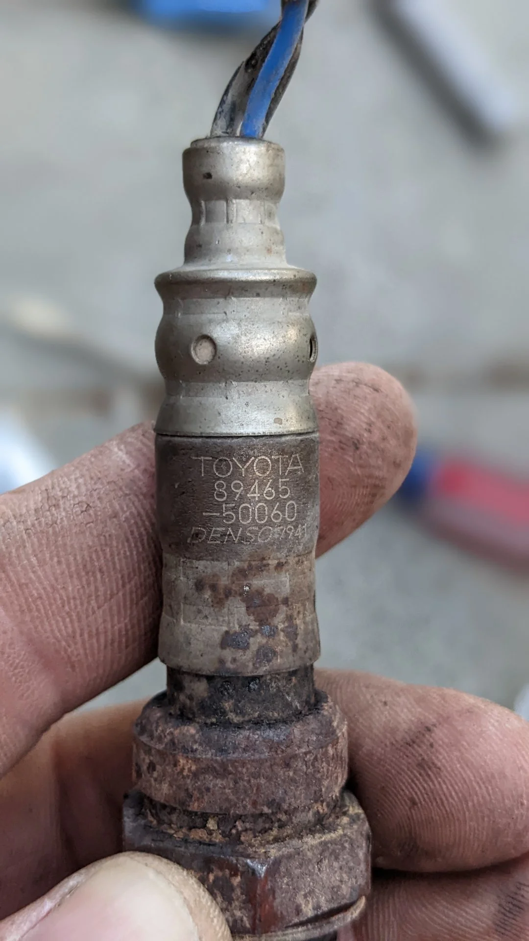

Bank 1 Sensor 1 was the last original oxygen sensor on my 100. It had been a trooper for 370,000 miles, but the heater recently failed and triggered a CEL. It was a good run ol' friend. I hope your Denso cousin from Rock Auto lasts 1/2 as long.

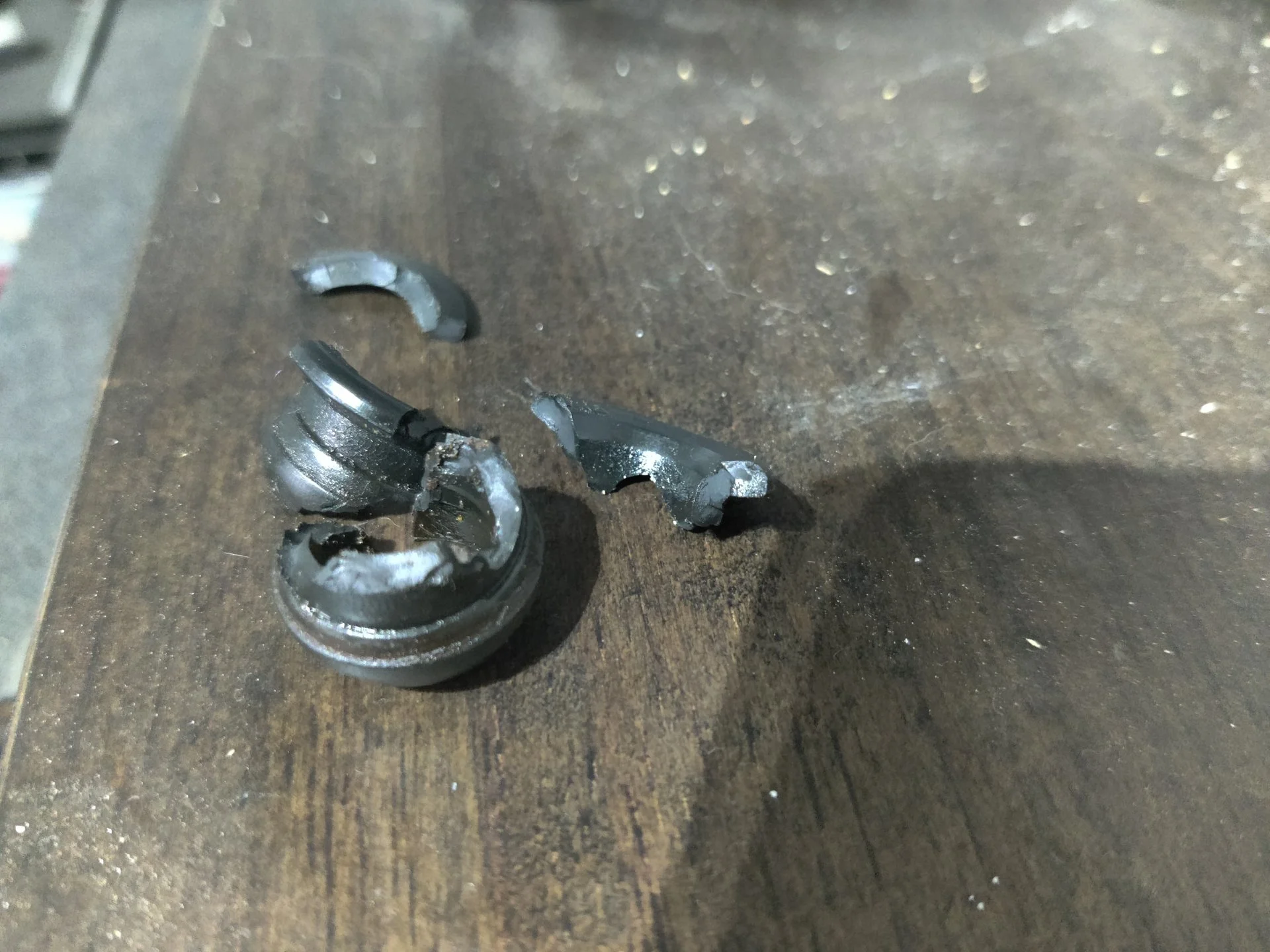

Bastard PCV Valve Grommet and PCV Valve changed.
Luckily it was only 5 intense minutes with it trying to crack apart. I was able to get it out with needle nose pliers and a screwdriver, I tried with a screwdriver first leveraging it on the side but it was pushing it in. It was really close to going in once or twice with the big chunk shown until it could rotate sideways and twist out..
How many new curse words in five minutes?

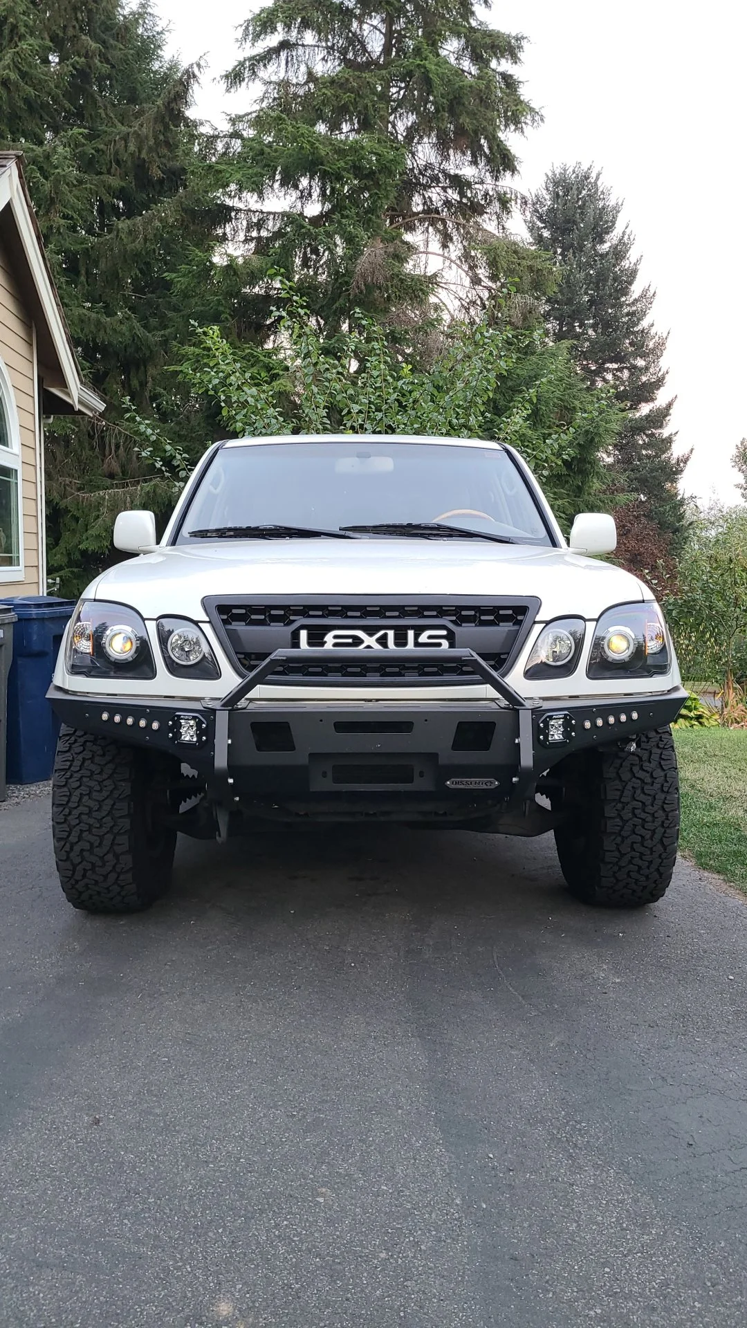

Installed the Garage Alpha Grille.. Install isn't perfect as others have mentiond.. you'll need some longer screws here and there. But overall it was simple and it's a great product! Very happy and the guys at Garage Alpha were more than pleasent to work with..
