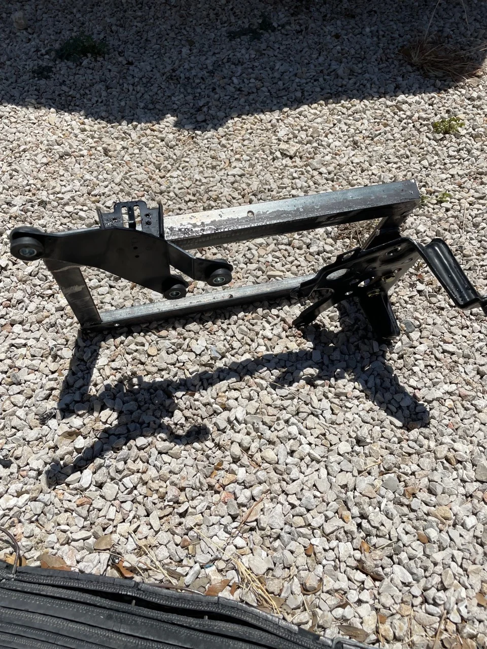

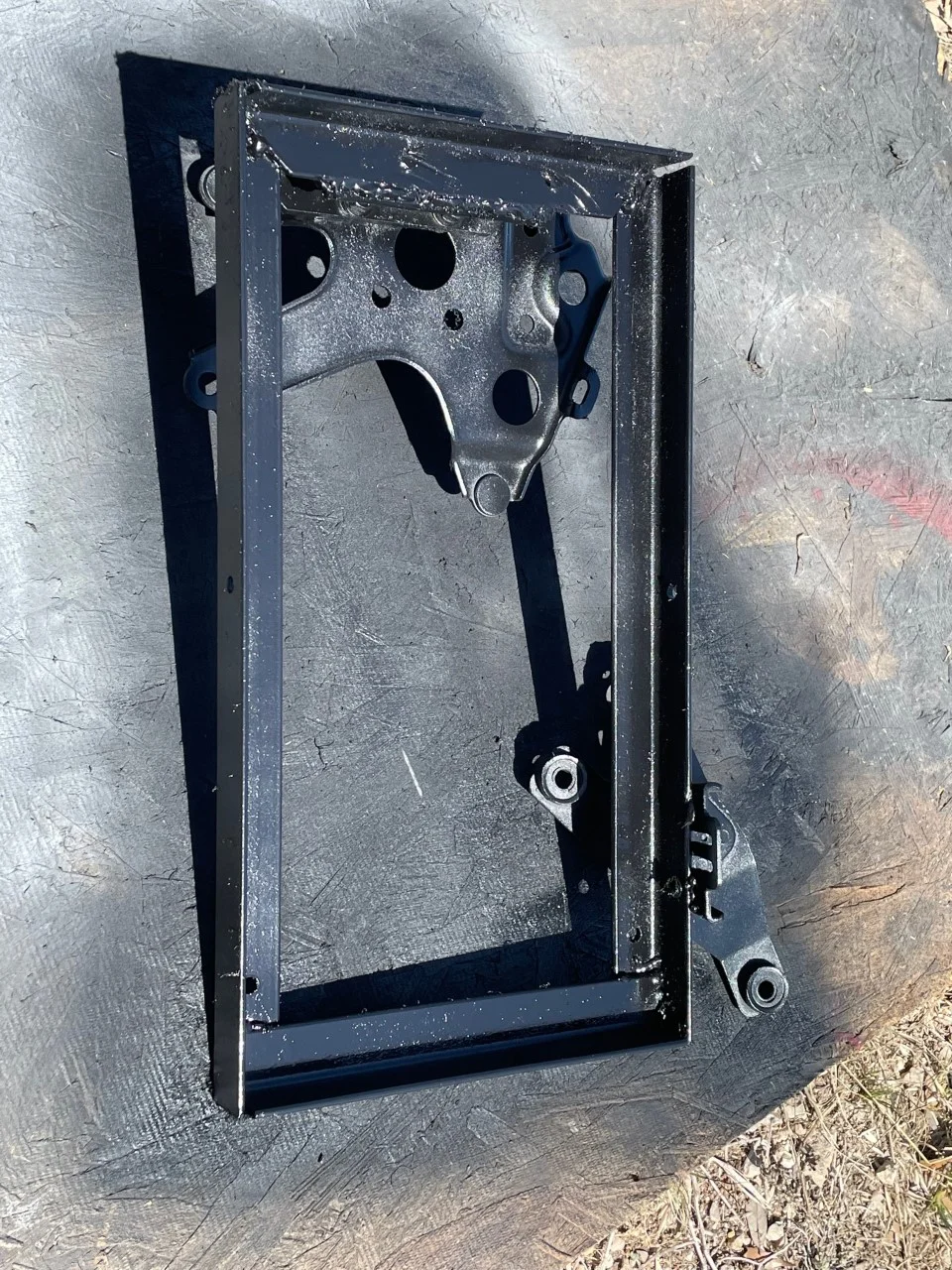

What do you do when no one makes a second battery tray for an H8 size battery? Well, you cut up an old AHC motor bracket and use your 5th grade level welding skills to weld some scrap, some unused trailer spring hangers, and the power steering mount together. That's what. Now I just need the actual battery. :)
Looks like there’s a 5th grader who’s about to graduate! Looks good man. Function over form, unless it’s seen.

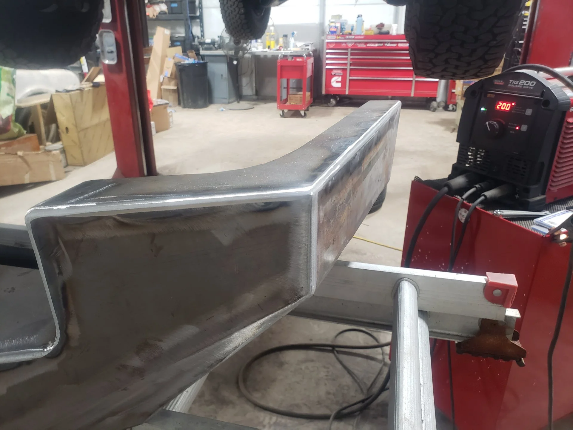

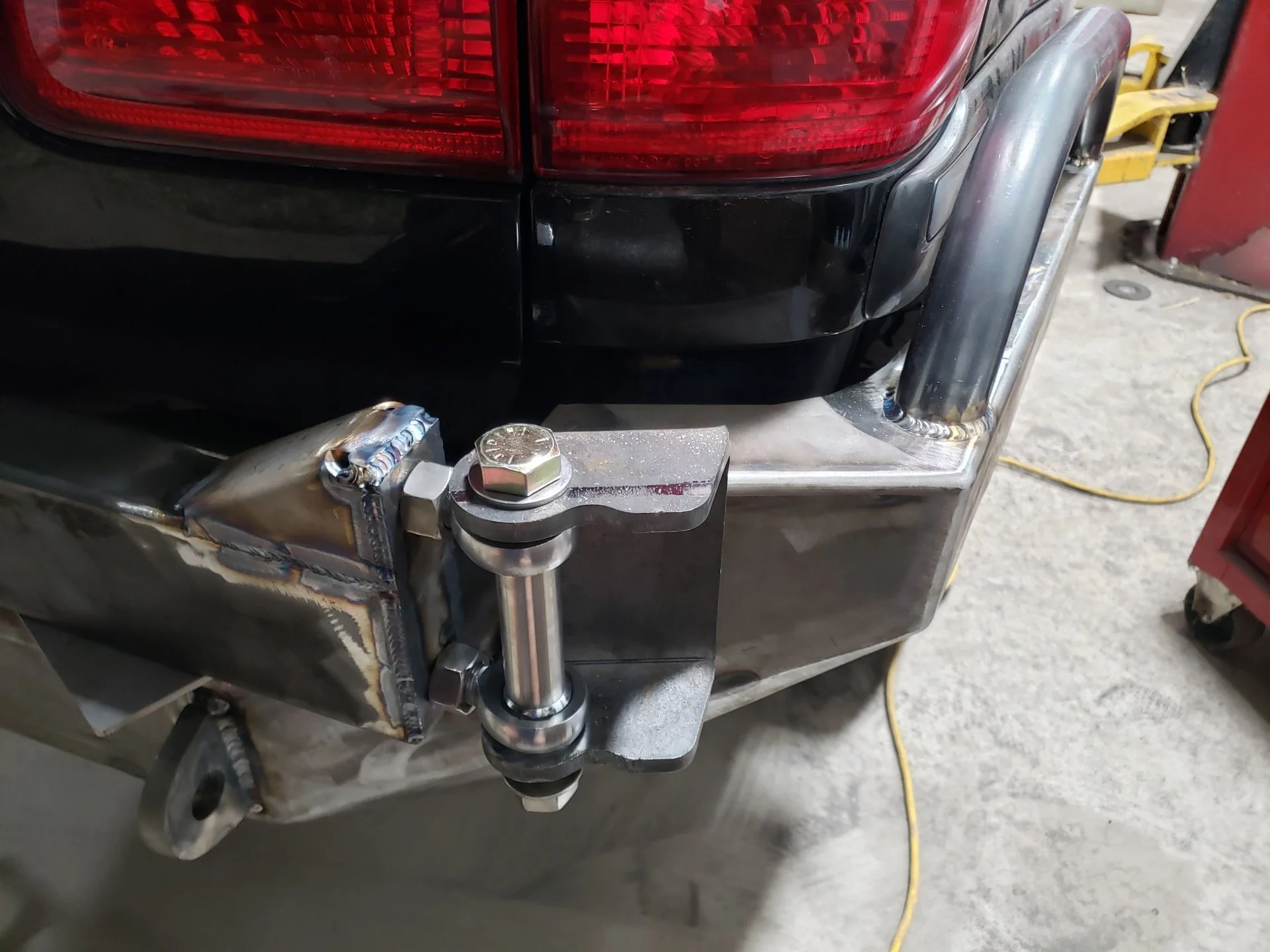

Almost done with the rear bumper, but need to finish a few interior stitch welds and put the tubes on for good.

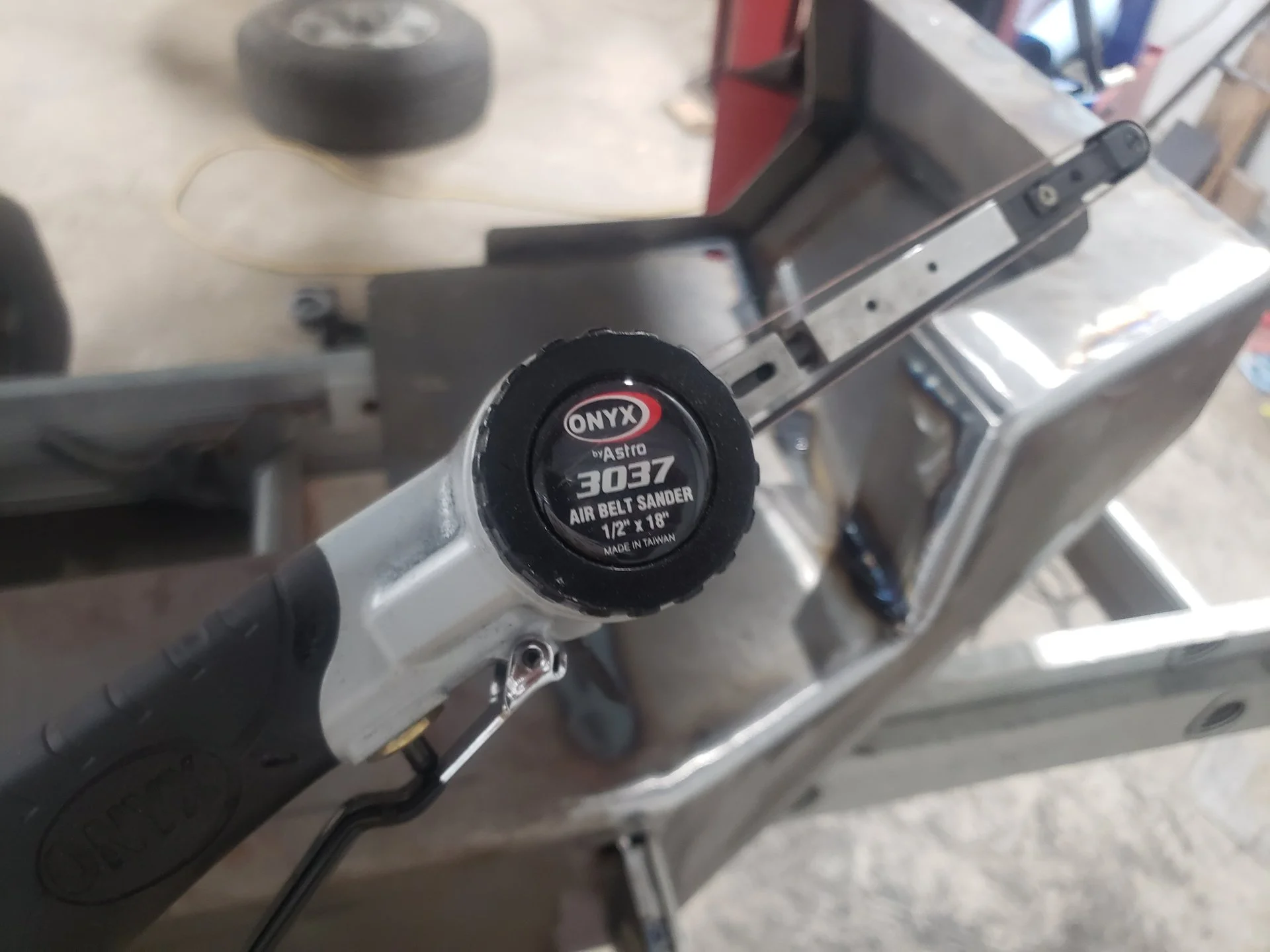

This tool is a secret weapon for sure.

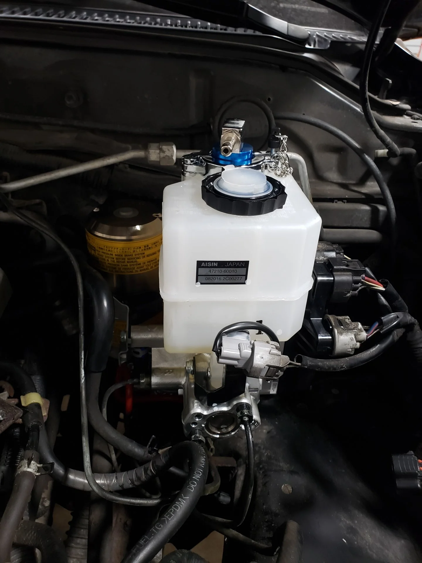

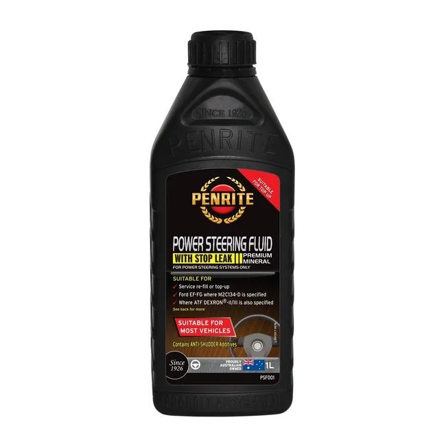

Power steering fluid flush - black and water-like. God knows if it was red or amber previously, suspecting it was its first from how much of a bastard the return line was to get off. Can't believe people don't do this preventative stuff. Flushing used a little more than I estimated to get it clean, so went back for a 500ml top up.
Cracked the nut on the steering gear box and gave it half a turn, appeared to stop so backed it off a smidge before retightening.
Did the job, responds like a normal power steering wheel now and a lot smoother! :)
Next: that pitman arm bushing looks totaled. EDIT: tie rod end boot
Thanks for this … what does the steering gear box nut tweak intended to do please? Did an empty and replace a few months ago on mine which eased up the stiffish steering a bit, but it’s still like wrestling a bear to turn. Cheers
will be on the left side for you but basically brings the meshing of the gears closer together in the steering gear box

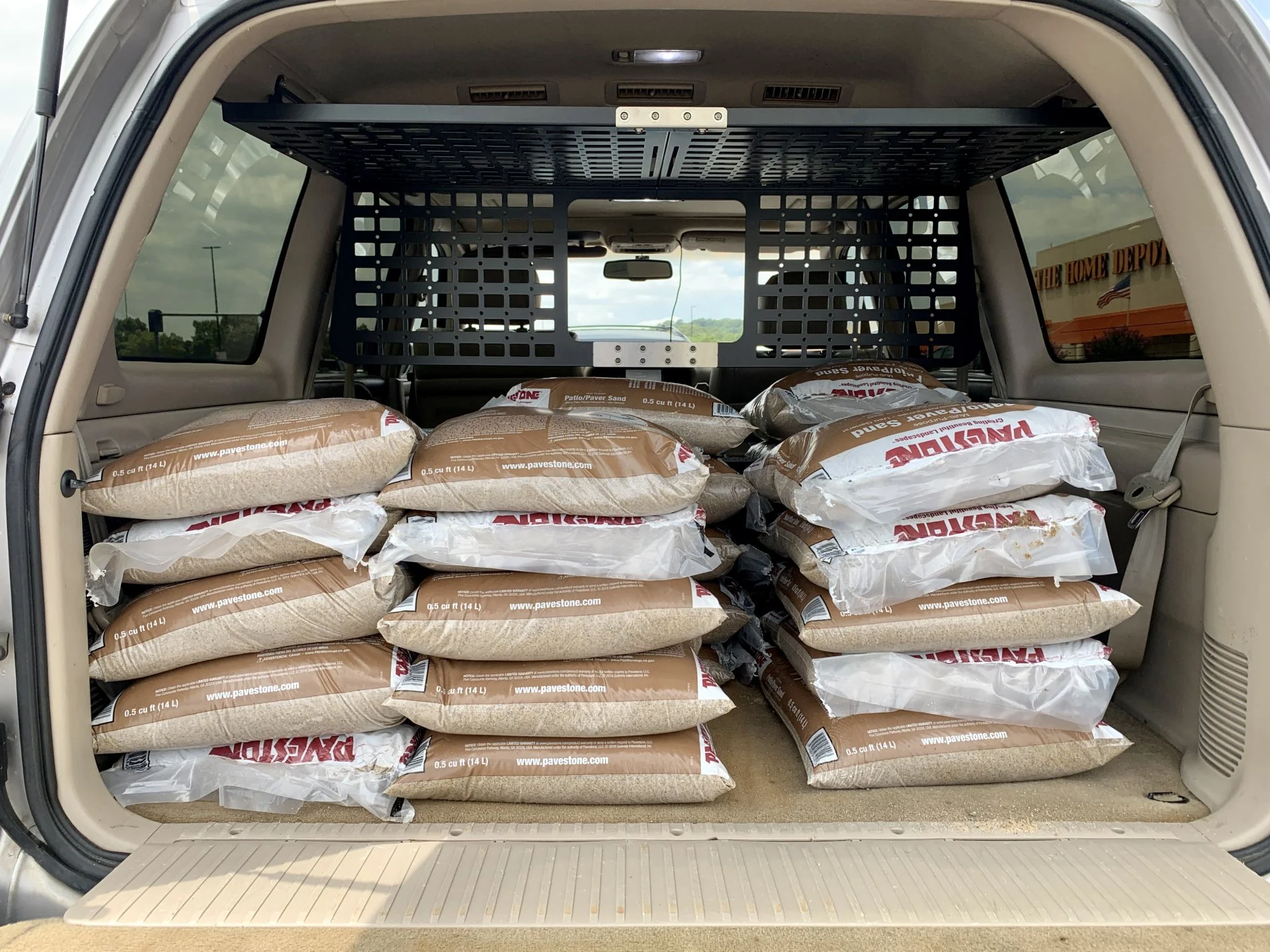

Hauled 1,200lbs (25 bags) of paver sand for a patio. Decided not to get bulk delivered to the house because all the places around me have a 3yrd minimum + delivery fee which was a lot more than I needed. It really reaffirmed my need for a rear bumper though. With Iron Man springs and Tough Dog shocks, it rides soooo much better with weight in the back!

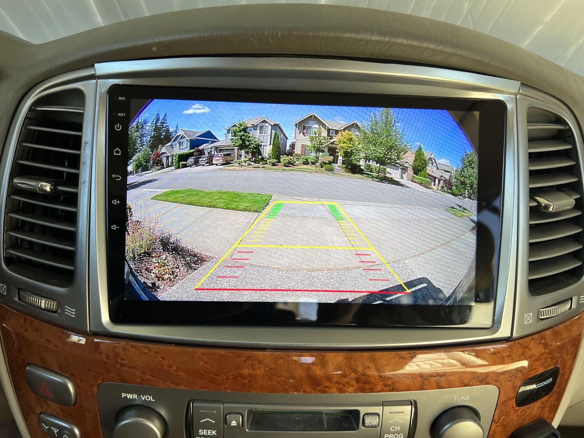

Got my aftermarket rear view camera working where the Teyes automatically shows it when shifting into reverse. Details about the install here: LX470 2004 | Need help with Android Screen - https://forum.ih8mud.com/threads/lx470-2004-need-help-with-android-screen.1277592/page-14#post-14517117
If you're wondering, I have a windshield sun shade on right now. Overall, pretty happy with how quickly it works and also the improved video quality over the OEM camera.
Did you take off the white OEM clips from the OEM unit and put it on the new frame. If not it will cause that huge gap at the top.
