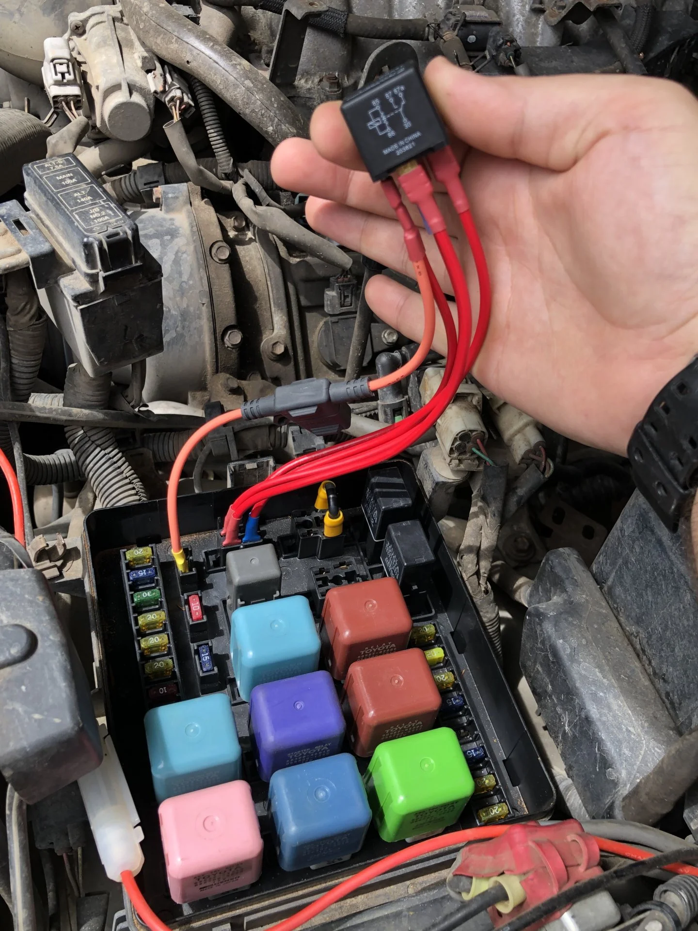

Just picked up my parts today. Any advice?
Pretty self explanatory. I ran the (+) wire along the drivers side frame rail and tucked it into the plastic tabs that would have held the AHC lines. Remember you'll want to use at least 12 gauge wiring per the instructions, butt connectors and ground connector. I removed my underneath spare tire carrier since I have a swing out so I just used the existing hole/bolt for a ground as shown in the pic.
Recommend using a circuit tester to make sure all your connections work and clean them as well as you can especially if you have corrosion/rust. I ended up using a little dielectric grease too.
Overall a 1 banana job with very minimal "wiring" needed. Just some crimping of heat shrink butt connectors.

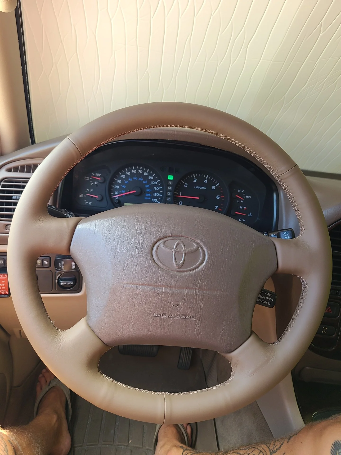

10-4 thank you. Yes I got everything removed all the way down to and including the nut that holds the wheel on....and yanked. And yanked. And yanked...no joy. Figured I was missing some sort of ring clip or something. Put it back together for the moment. Fishing trip tmrw got cancelled, so looks like I'll be sewing instead.
Like sauce box said, keep the nut loosely on for sure.
It also helps to push, not just pull. Yank-push-yank-push. It’ll give eventually. Removed mine a few times, never needed a proper puller (although I’m sure that would make life much easier).
@saucebox @Beto Cruiser done and done. Thanks for the tips gents. Still have 'muh grill. And a pretty damn skimpy new wheeel if I must say.

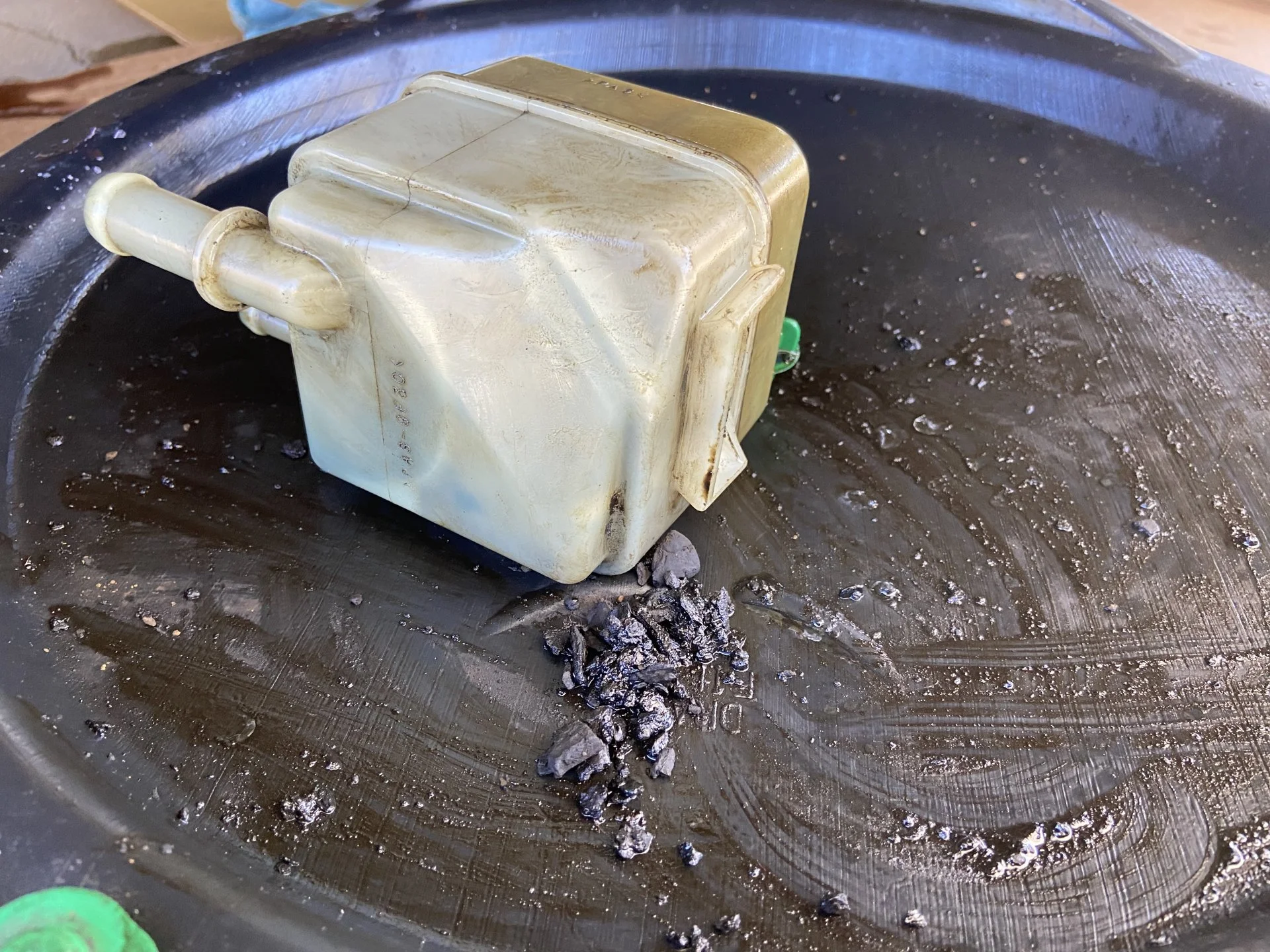

I flushed my power steering. Look at the crap that came out of my reservoir. Feels like only a matter of time before I need a new pump!
I flushed my power steering. Look at the crap that came out of my reservoir. Feels like only a matter of time before I need a new pump!View attachment 3056849
I suffered that in a bad way last summer starting in early August. My problems started with an aftermarket reservoir and cap that would not properly seal. So without an airtight seal, dirt and mud were sucked up into the reservoir. The clogged reservoir and particulate caused the pump to fail. Then it turned into multiple system flushes and another damaged pump until I could get the system cleared up. Make sure your cap seal o-ring is tight. I use a fluid extractor like MitiVac to keep an eye on fluid quality since then.

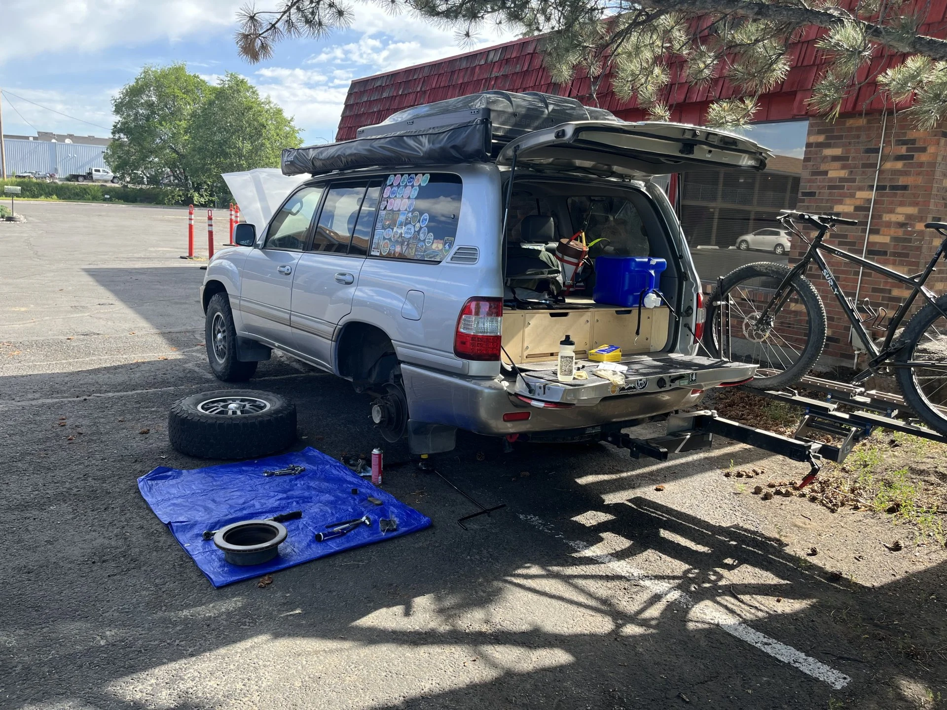

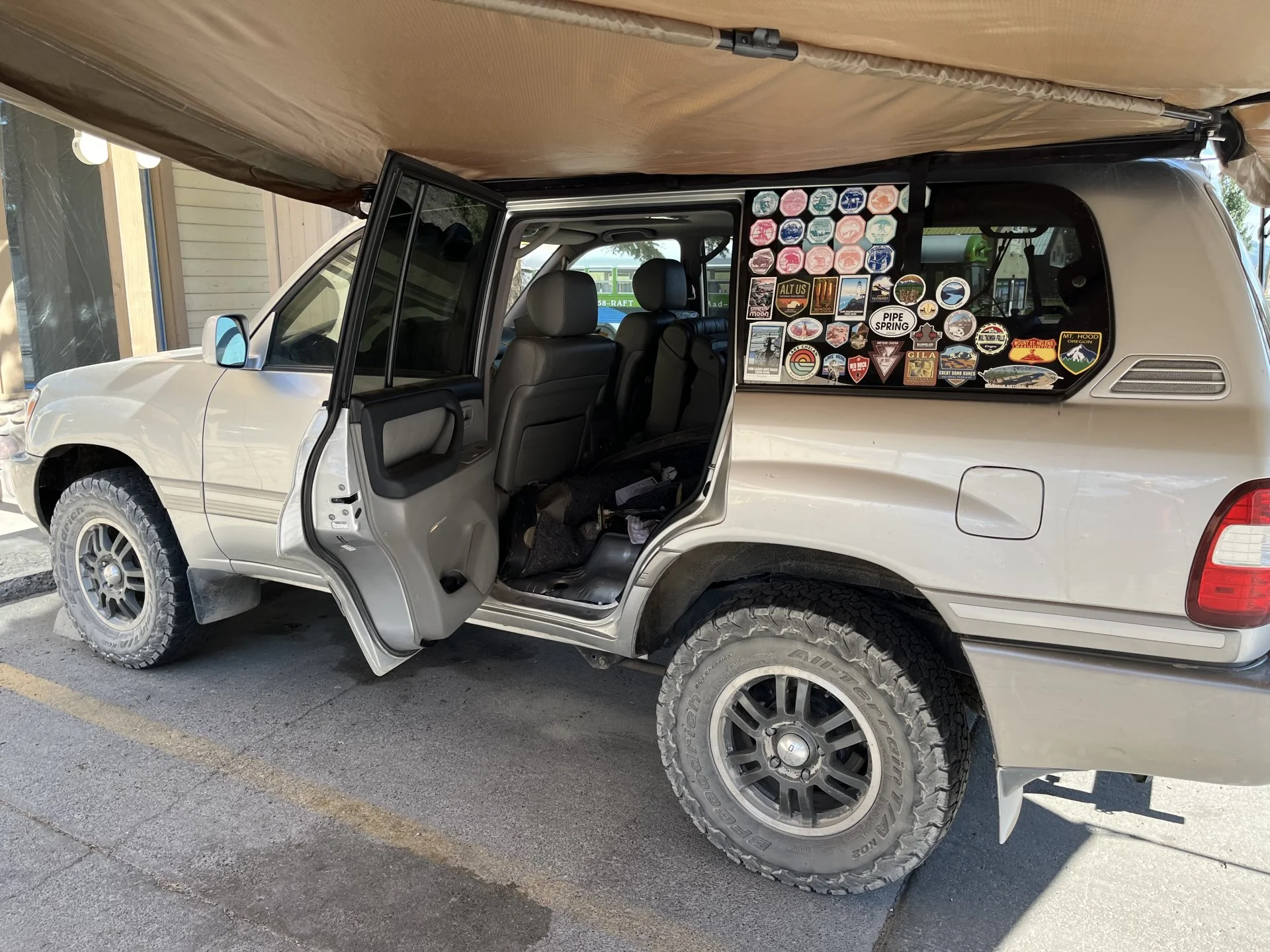

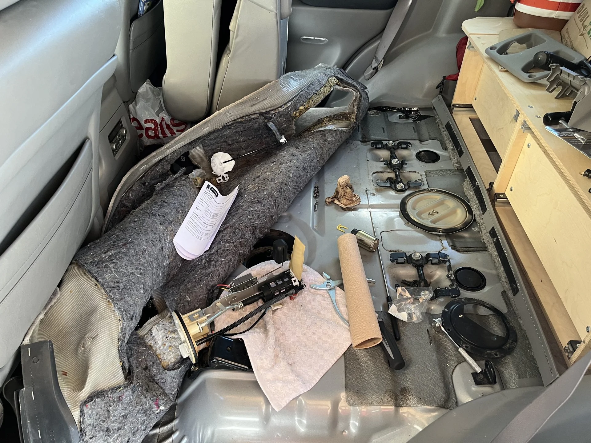

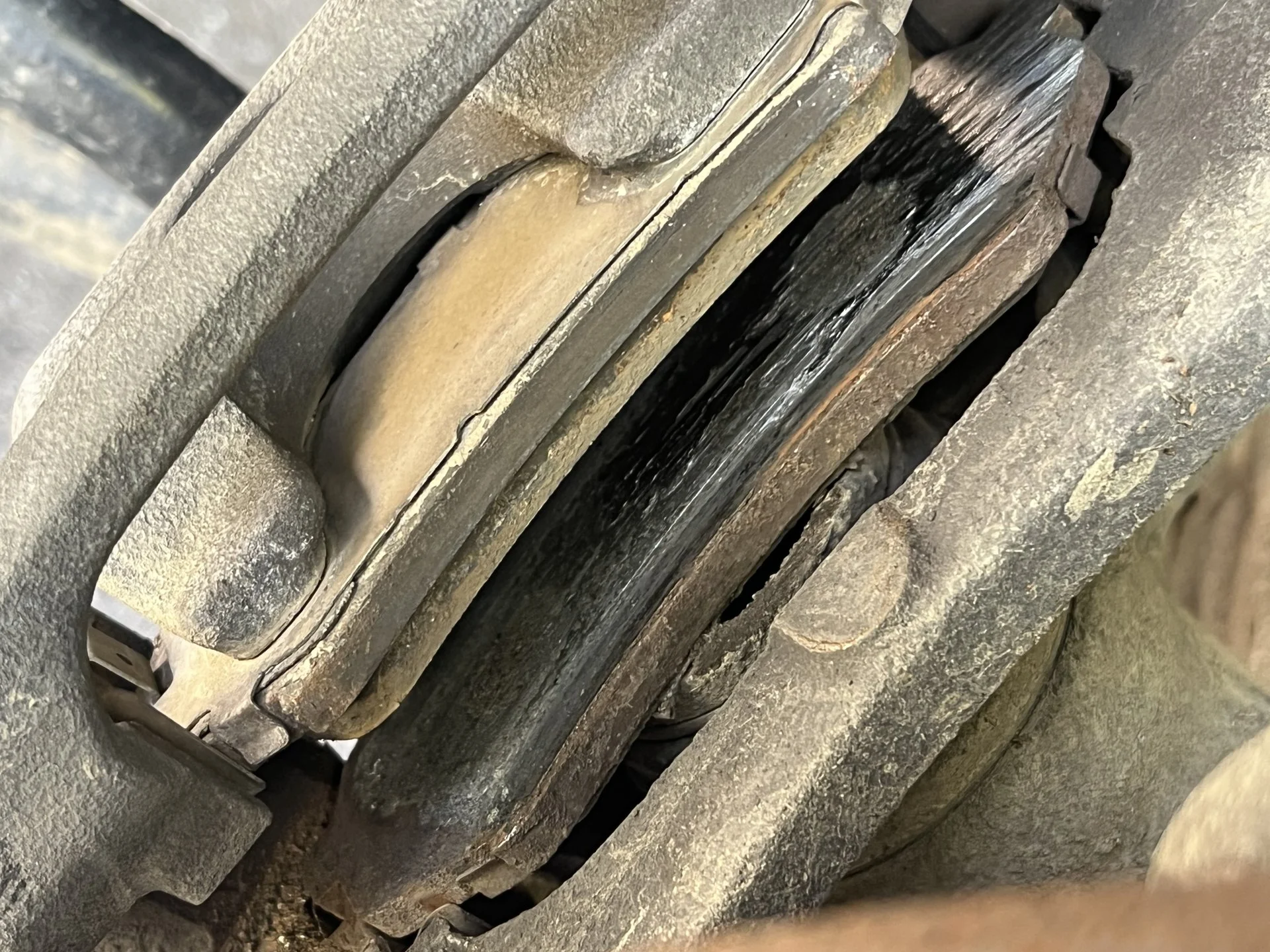

The only problems I’ve had with this truck was with the AHC right when I picked it up in Michigan and the booster pump in Yellowstone on my way back home to Washington. It’s been flawless for nearly 30k miles and almost exactly two years until last Wednesday when I got near Yellowstone again. At the exact same time I find the LR caliper was sticking and the fuel pump starting to go out. Fingers crossed I’ll get to Michigan without further incident.

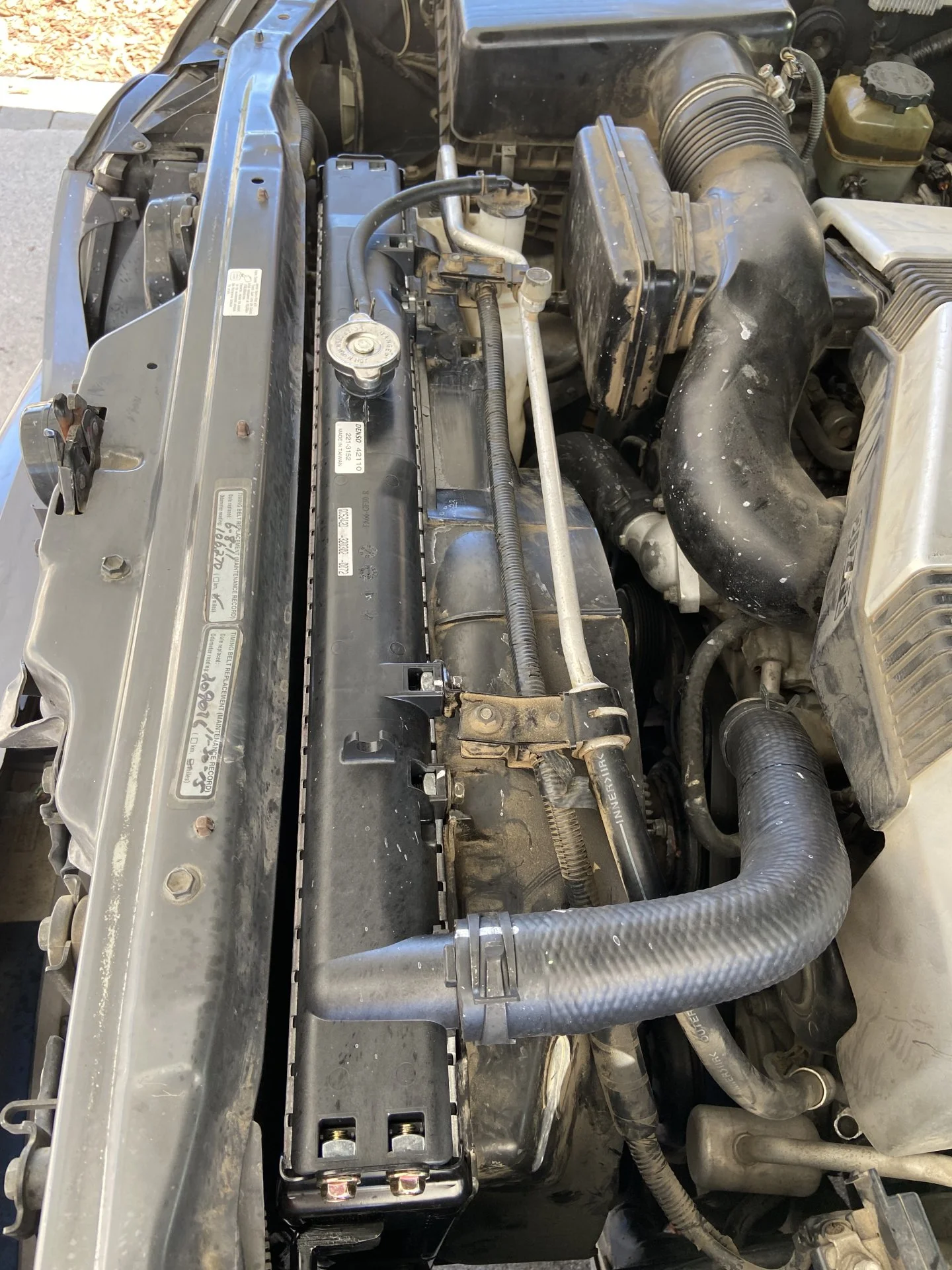

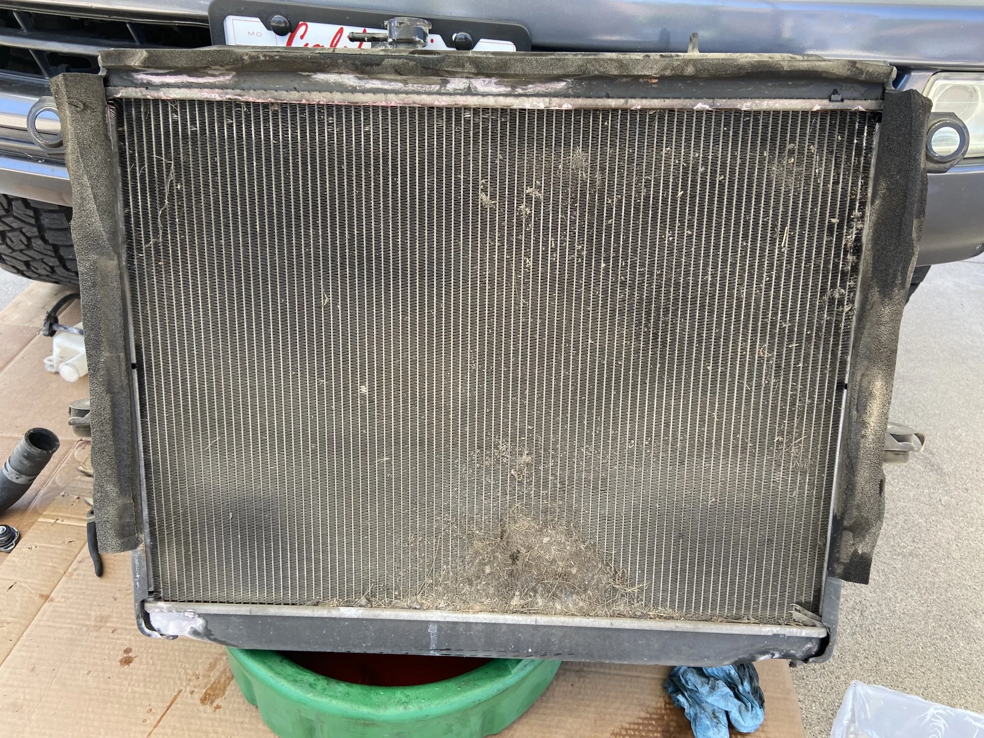

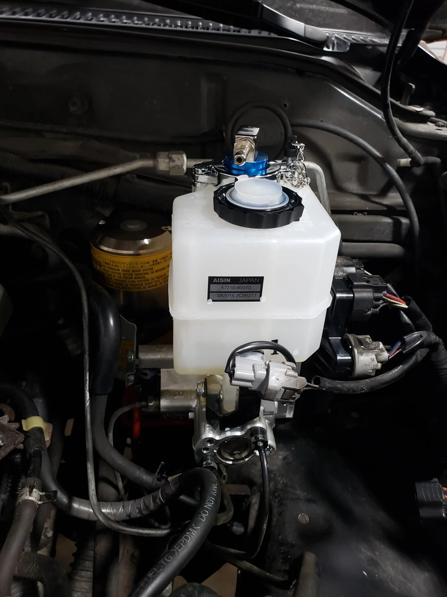

Yesterday I changed the radiator and coolant and flushed the brake fluid. The radiator was original and lasted 17 years and 252k miles before it started to leak. Despite all common sense, I couldn’t bear the price of an OEM radiator (now seems to be made in Mexico), so I ordered a Denso (made in Taiwan) from Rockauto. I also swapped the upper and lower radiator hoses and the thermostat with OEM Toyota.
The brake fluid was of unknown age and a pretty nasty dark green. I replaced it with Toyota DOT 3. I had no way to actuate the ABS in my garage, so I tried the slam on the brakes in a gravel parking lot method. I think it worked. The fluid came out a bit green during the second bleeding after being pure clear before.

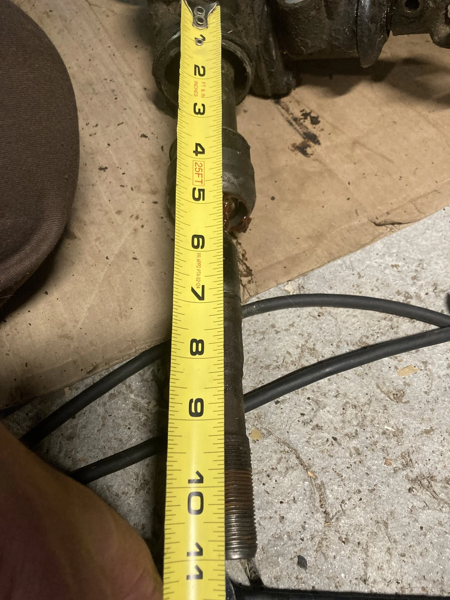

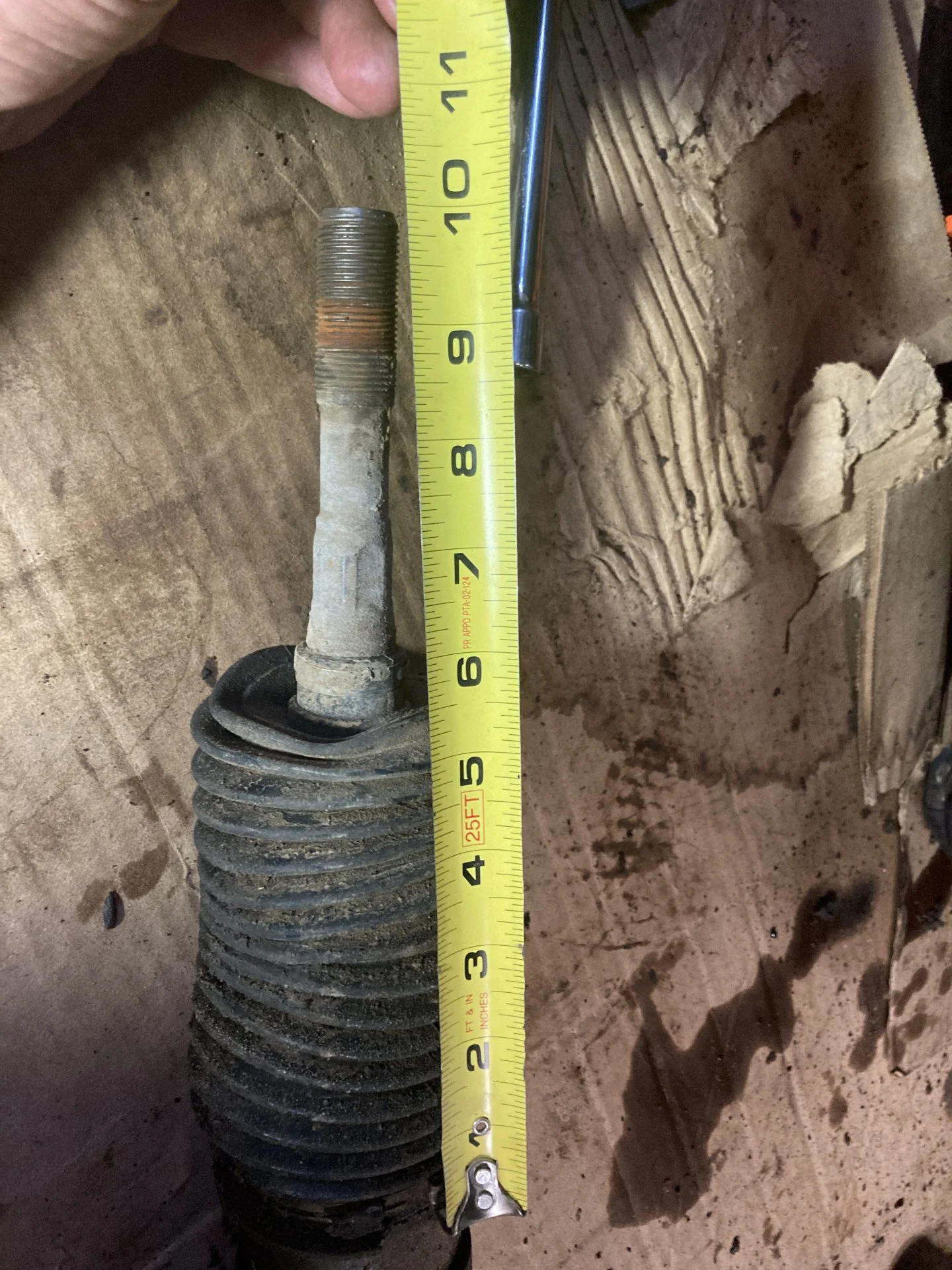

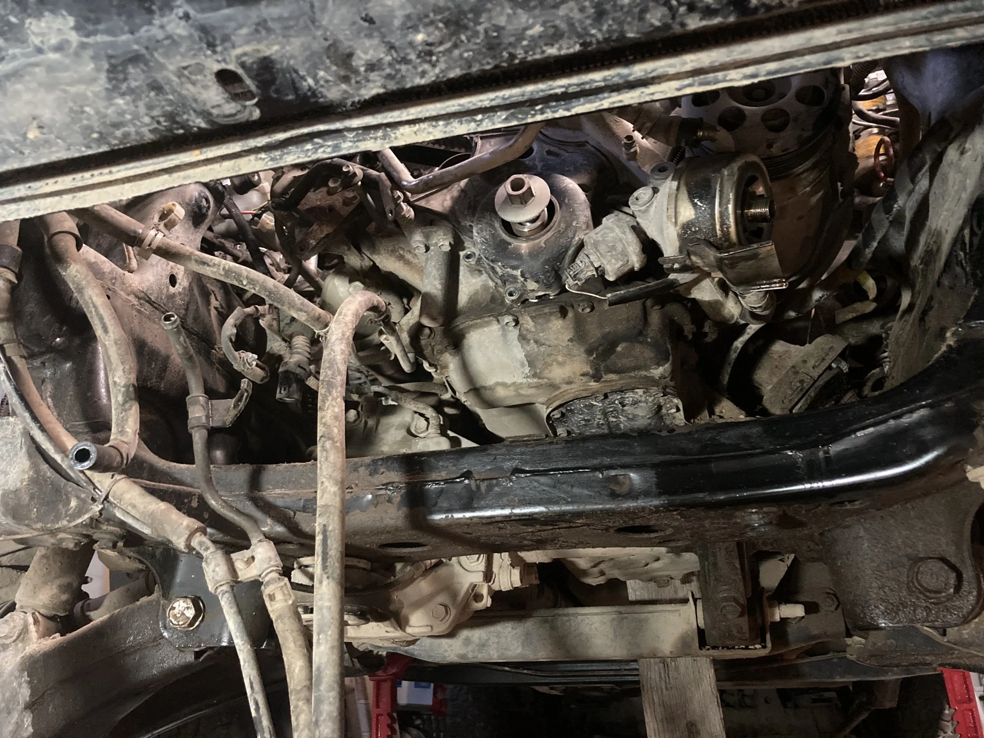

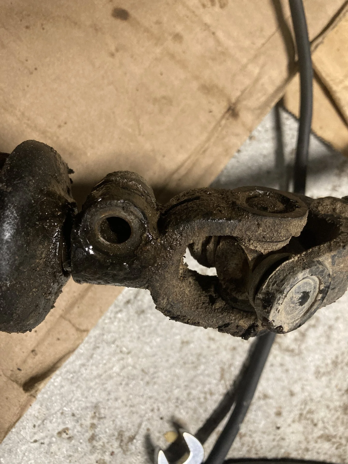

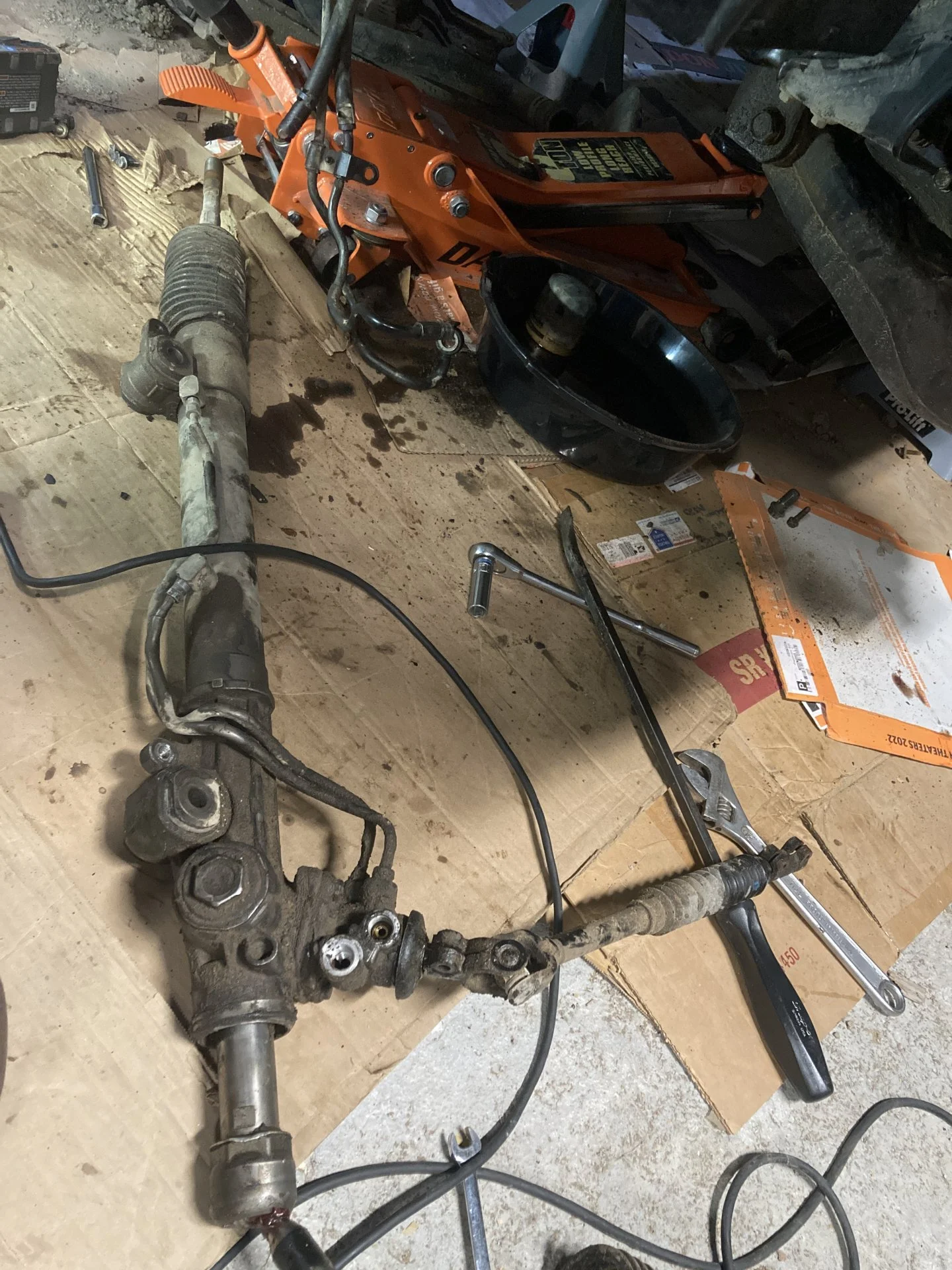

Finally got the steering rack out! My lower bolt just below the steering shaft u-joint came out east enough, but a couple hours of pulling, hammering, digging farther into the timing belt/ water pump stuff, and I couldn’t get it to release. Re-read the steering rack thread and saw someone had pulled it out with the shaft attached…out in 5 minutes…this would have been ZERO fun without pulling out all the other stuff I already did (shroud, fan, radiator, pulleys, etc). Now, to degrease… Also, one big question; I measured the inner tie rods as it came out, centered, but the ds one is 11” out from the boot band, and the ps one is 10”.(?) any ideas?

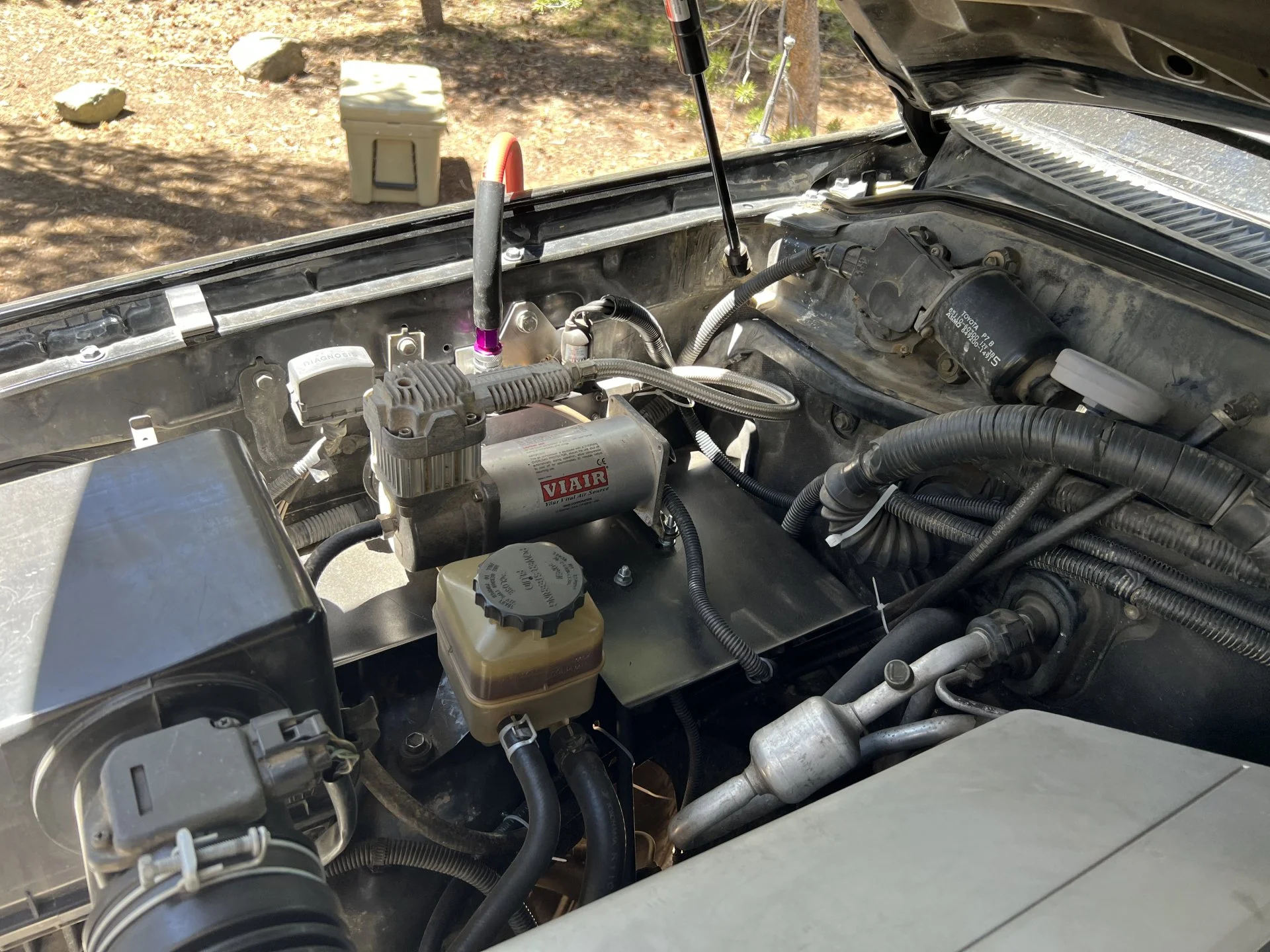

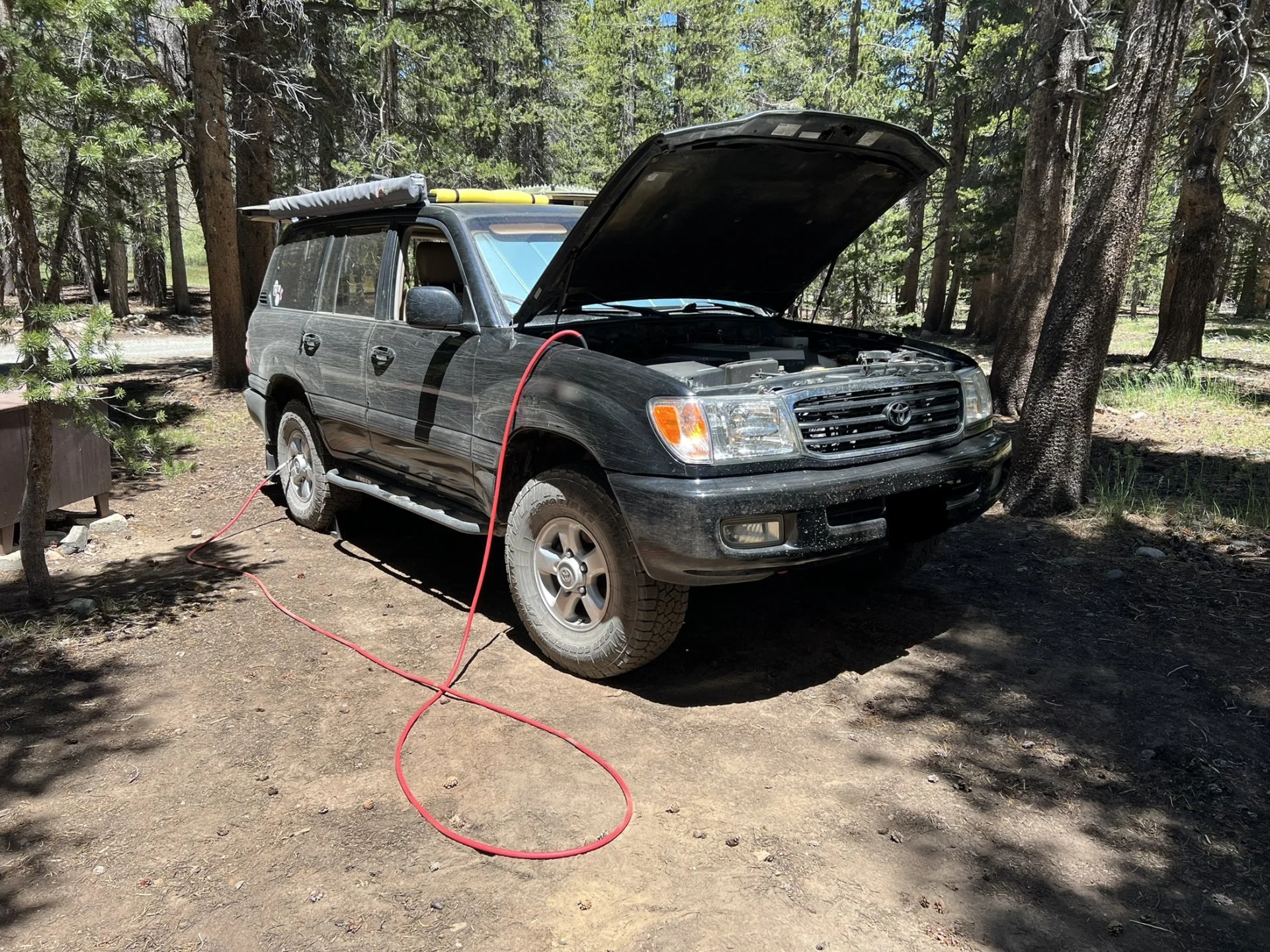

Right before we left I finished up a custom tray in the engine bay for the air compressor. I decided to relocate it here since it was getting caked in dirt while mounted under the vehicle. Pretty happy with the spot, just need to touch up a few areas and finalize the wire mounting.
I went through all that with a new rack and didn't change the intermediate shaft to get a new u-joint. It started failing (binding) last fall on turns. It has just been replaced. If you're going to this much trouble, go all the way.
