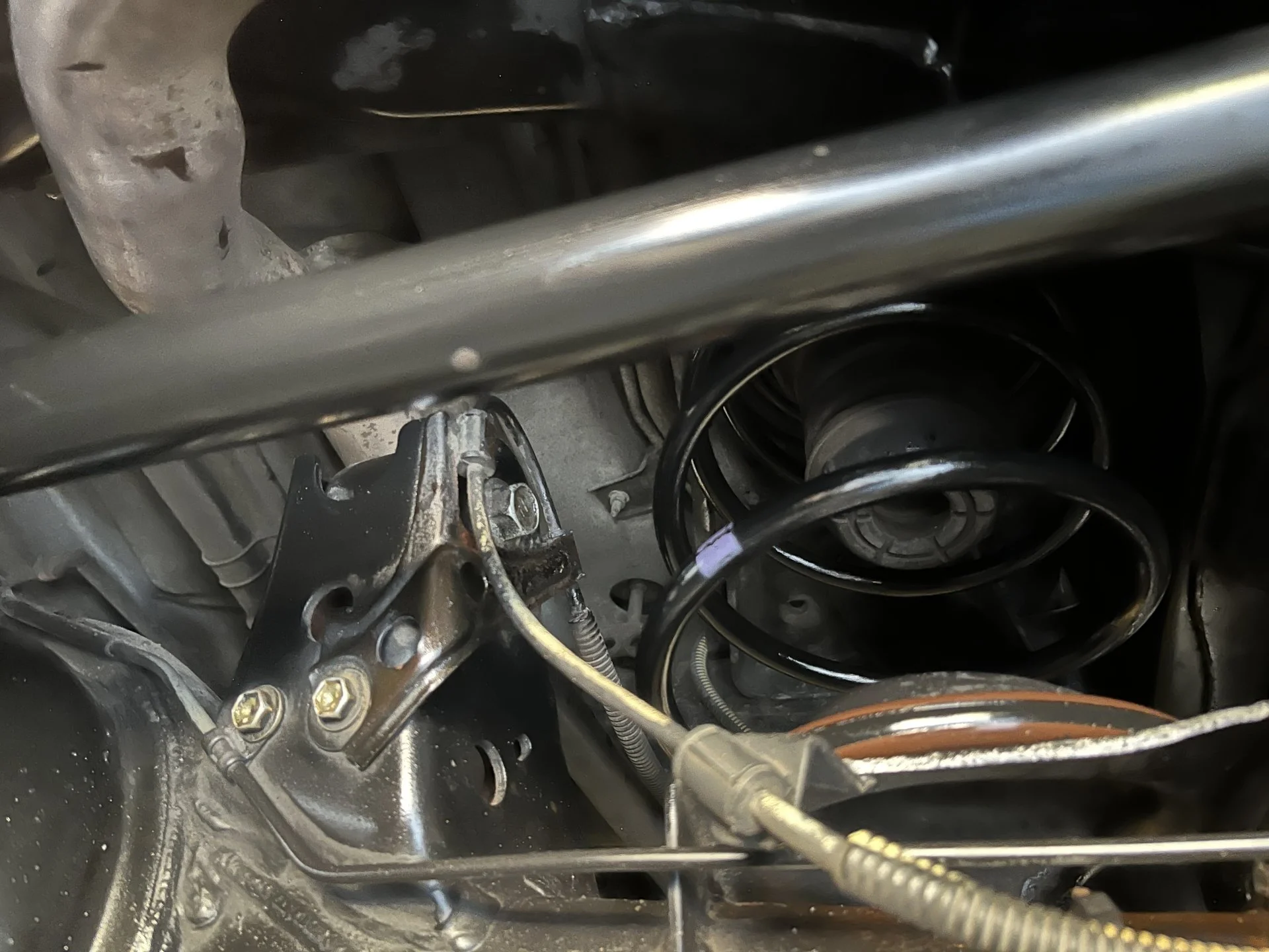

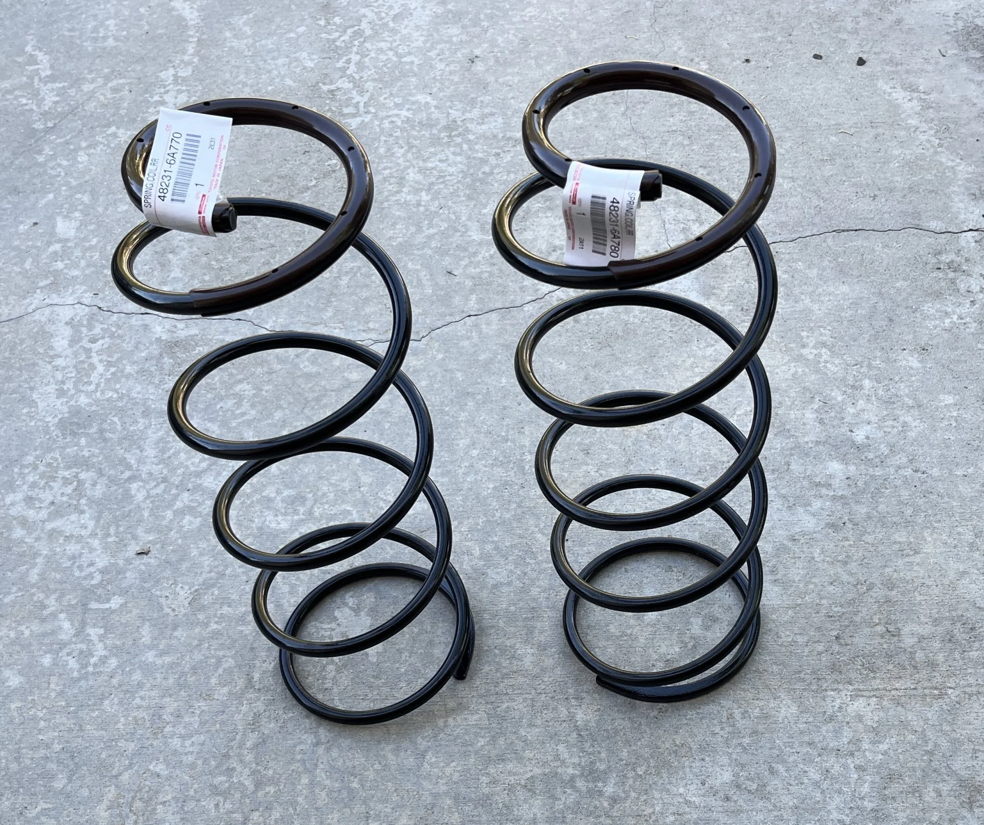

Replaced my tired LX AHC springs with 05-07 LC AHC Springs (Purple and Brown labelled) + 30 mm spacers. Insulators were included in these 2 toyota P/Ns.
I removed the diff breather mount and a brake hard line + soft section out of an abundance of caution while dropping the rear diff.

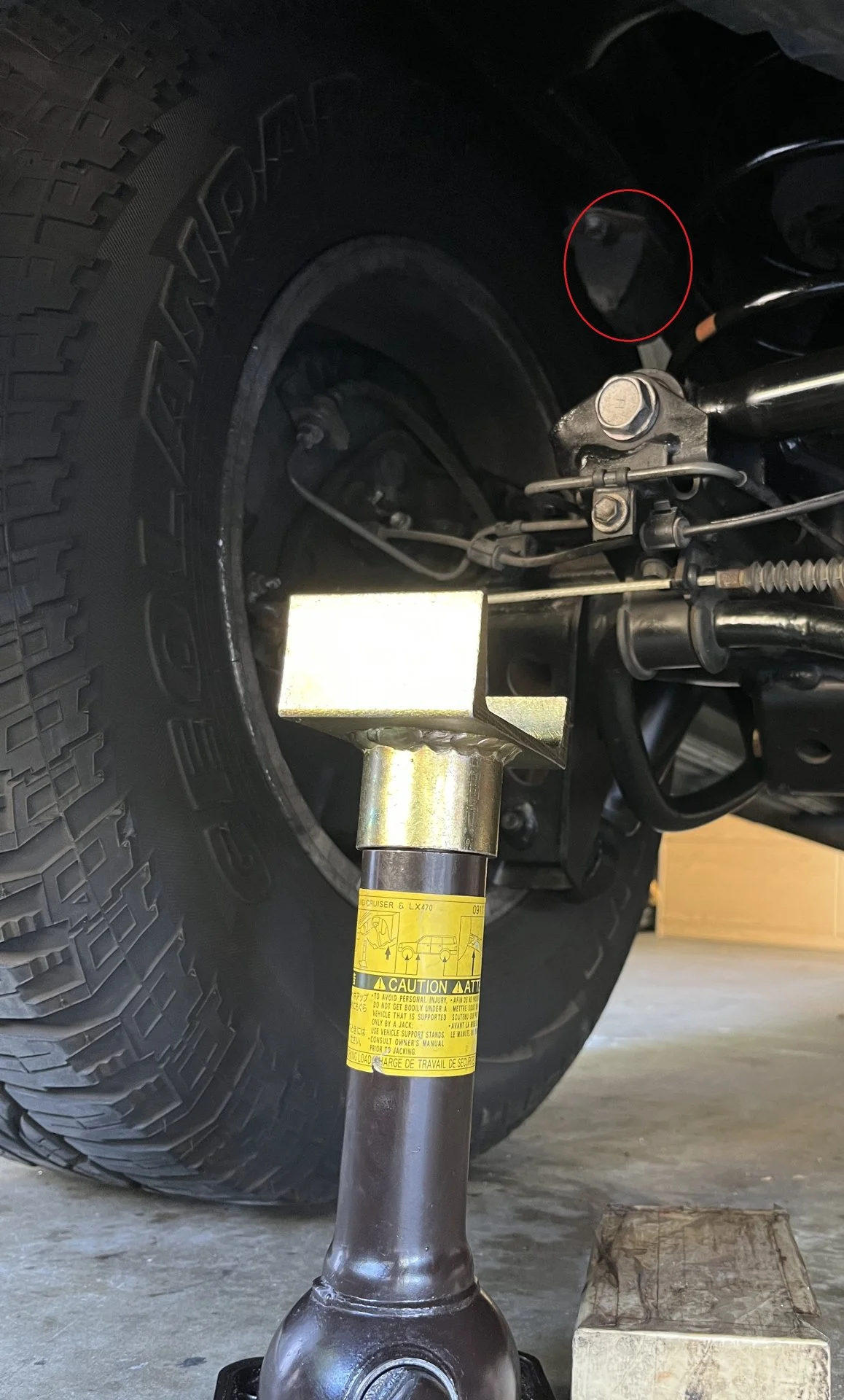

Right side spring was easy. Without a second person, I got the left spring on with the help of a factory bottle jack sitting on the diff housing (next to the rear left crossmember). It was anchored against a rubber block on the frame in wheel well area to get the amount of clearance needed.
The @LandCruiserPhil factory bottle jack adapter comes in handy for seating the left spring in case the frame/diff is off-center if you're not working on perfectly even ground.

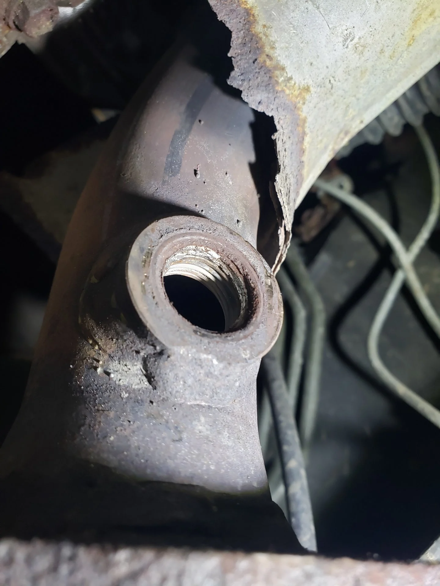

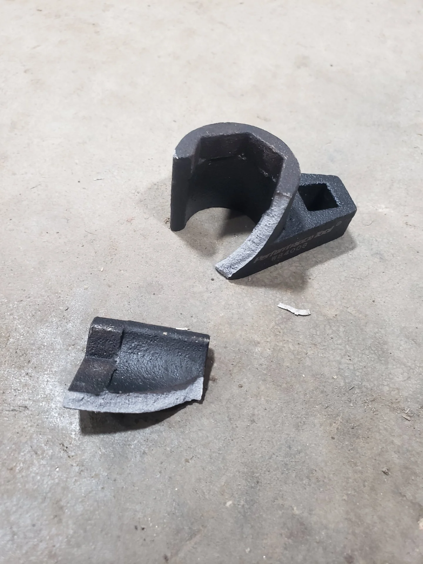

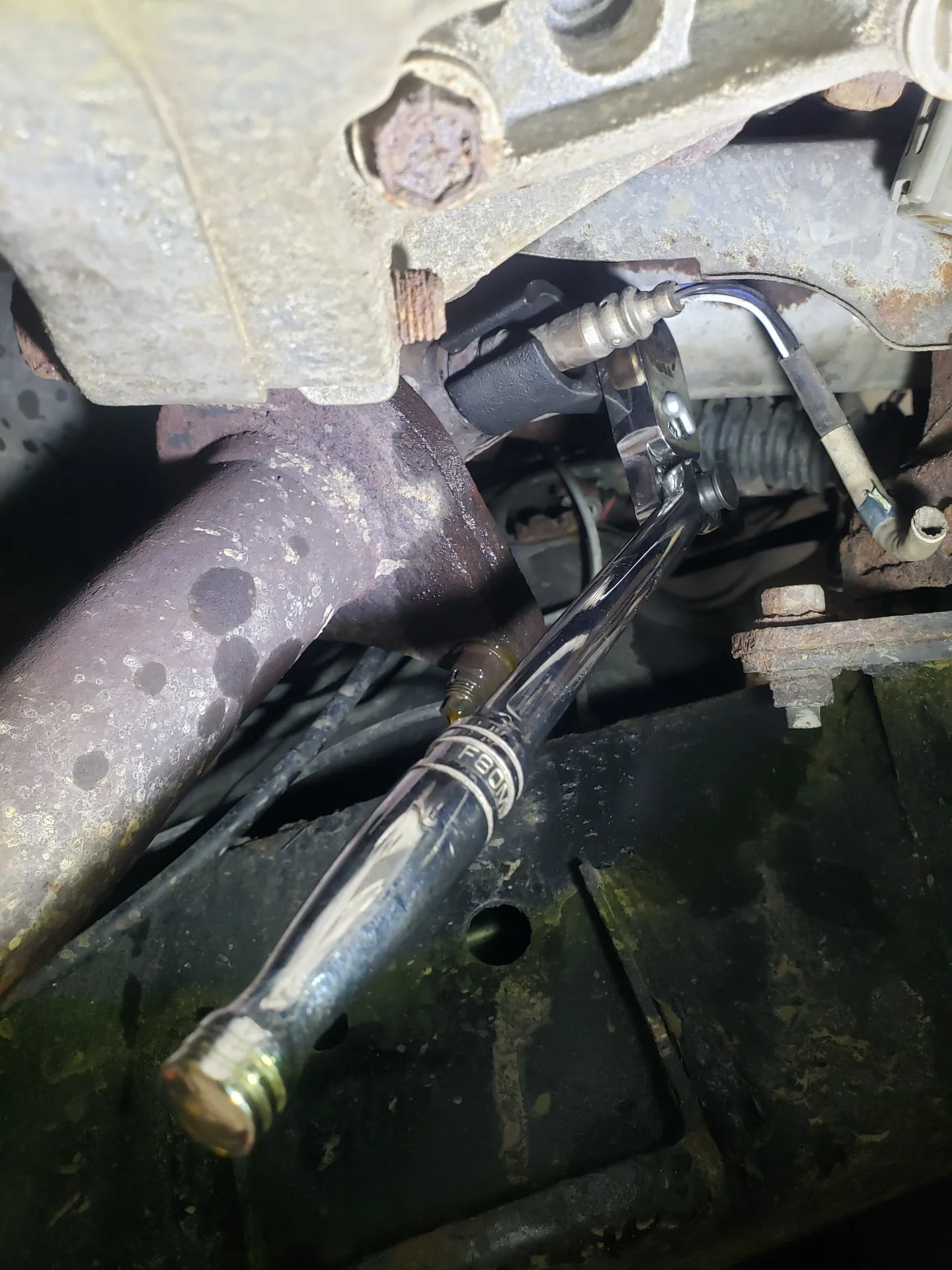

Got coilpacks and plugs changed out. The coilpack bolts were so rusted that I had to use a bolt grip extractor on 6 of them. Got the passenger upstream o2 sensor out from the top, and while working on the drivers side, this "overseas" piece of s*** exploded. Contrast that to the tool attached to it that i thought I spent too much on, but just paid for itself. At this point in my life, I'm just buying tools that make life easier somehow.

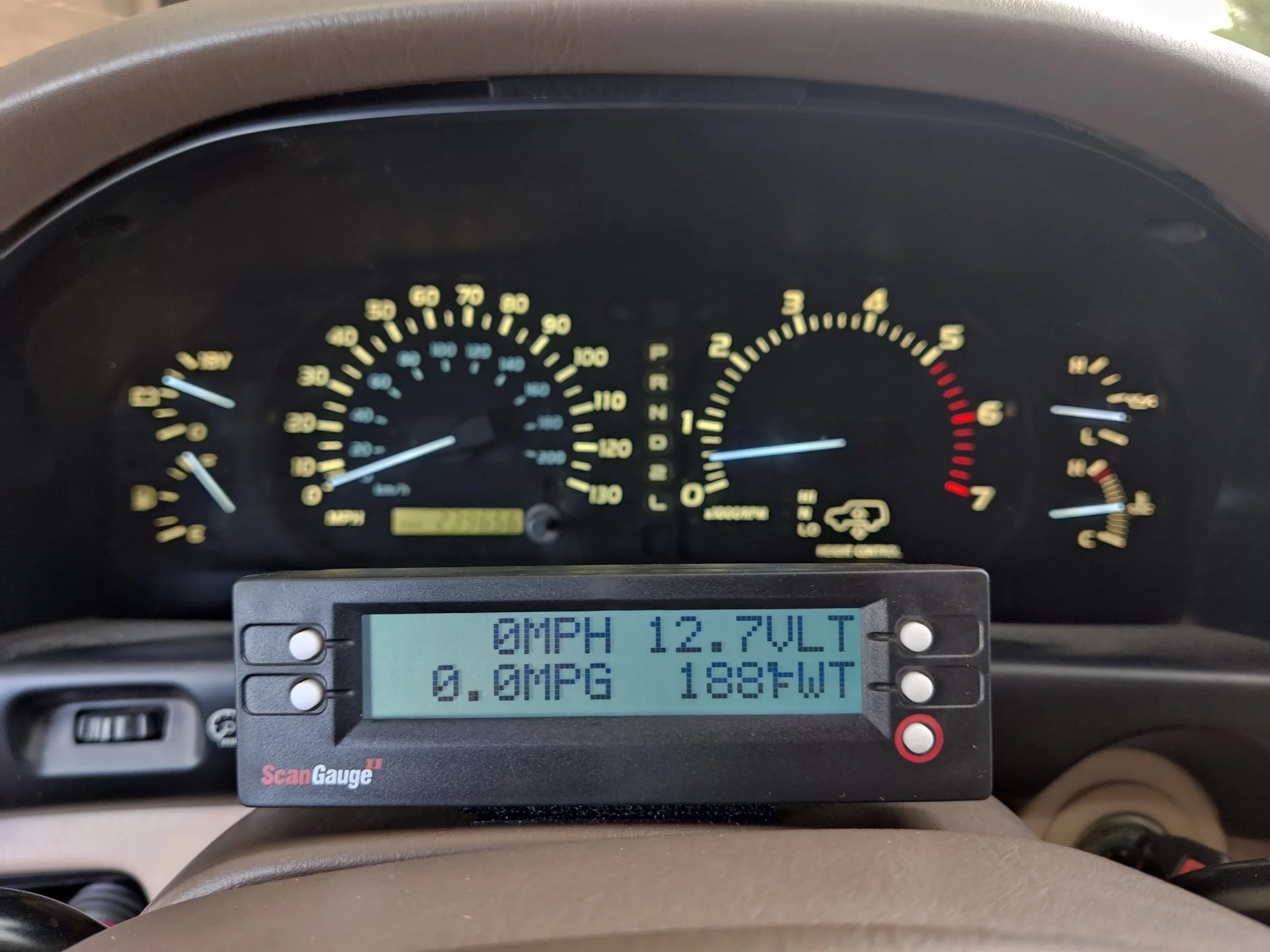

ScanGauge II thrown in following some charging and cooling issues. Will be getting one of Ben's mounts to put it in the overhead console but it works here for now...

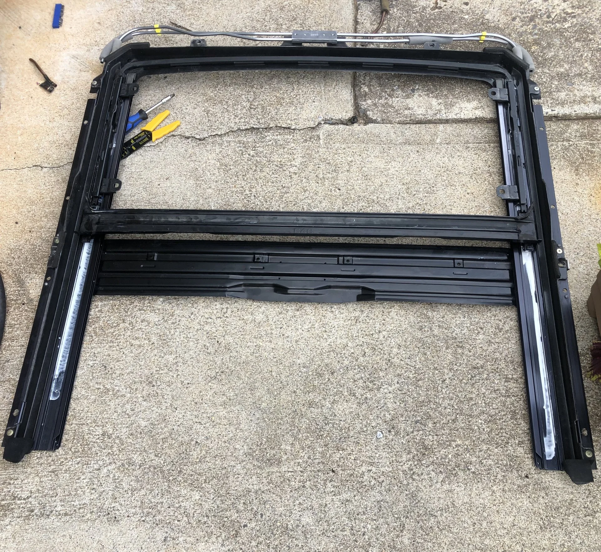

Replaced my sunroof cables and cable guides this week. My sunroof had gotten stuck open, and with a lot of forcing I was able to get it mostly closed. Did it over three evenings after work. Operates faster and smoother than before now!
One of the more useful features is to display the transmission temps. Especially in warmer climates or if you tow much.
Yeah, I remember the thread for pulling that info, just need to set it up
Knock on wood never had to do this, but feel sooner or later inevitable

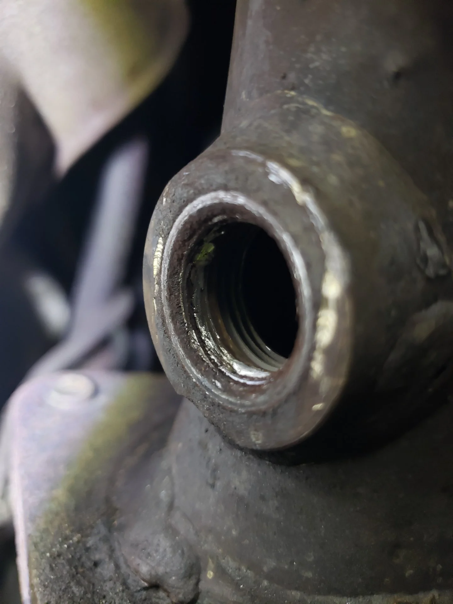

Even with lots of heat and oil, I managed to gall the living s*** out of the driver's o2 sensor threads. Hopefully there's enough usable thread so I can run a tap through there without having to order that chaser you run all the way in, spread out and then tap by pulling back blind. I don't know why I didn't cut the spark plug and put a real socket on it, but I'm not even sure that would've been the ticket. That thing was pretty stuck.

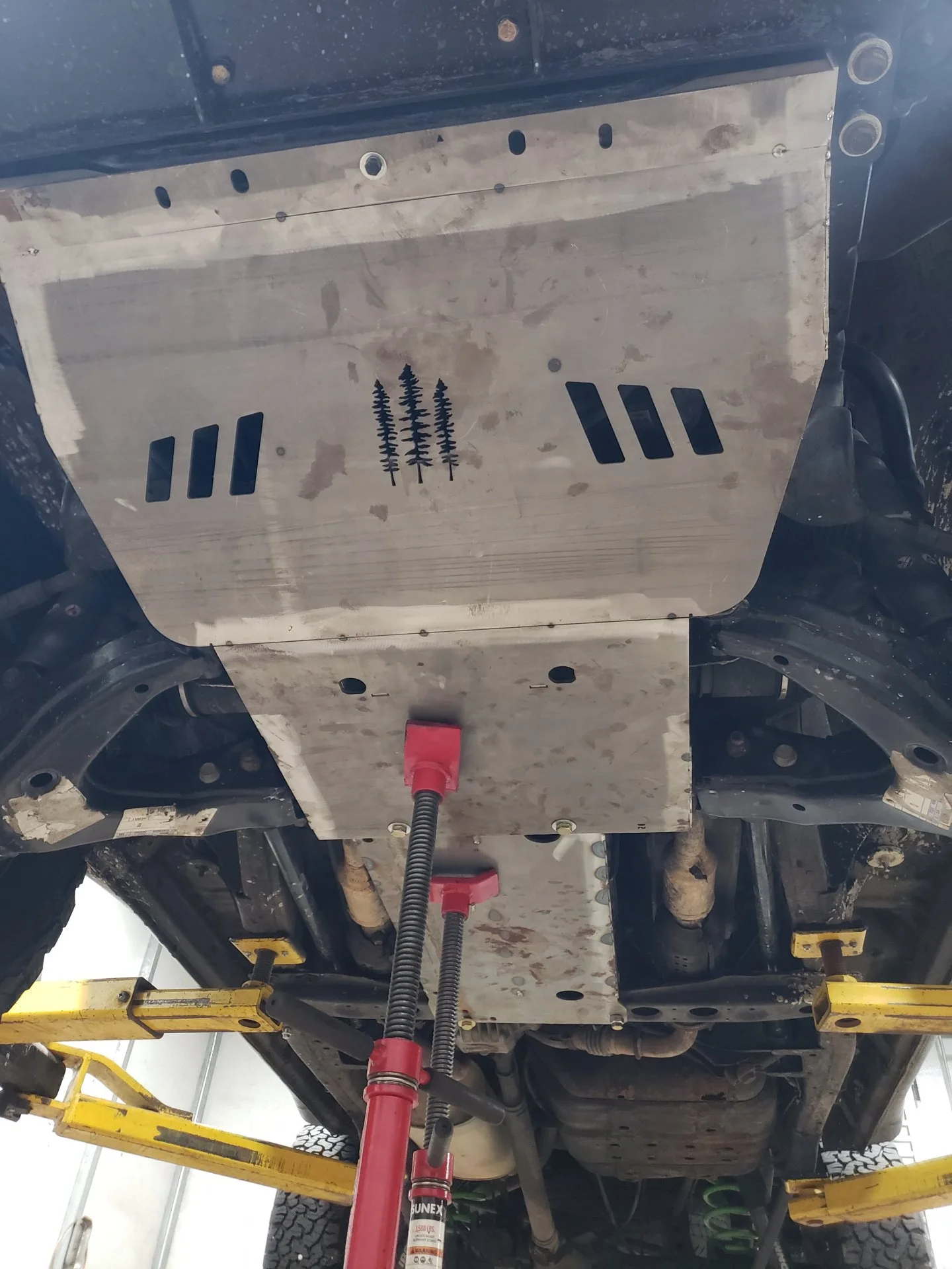

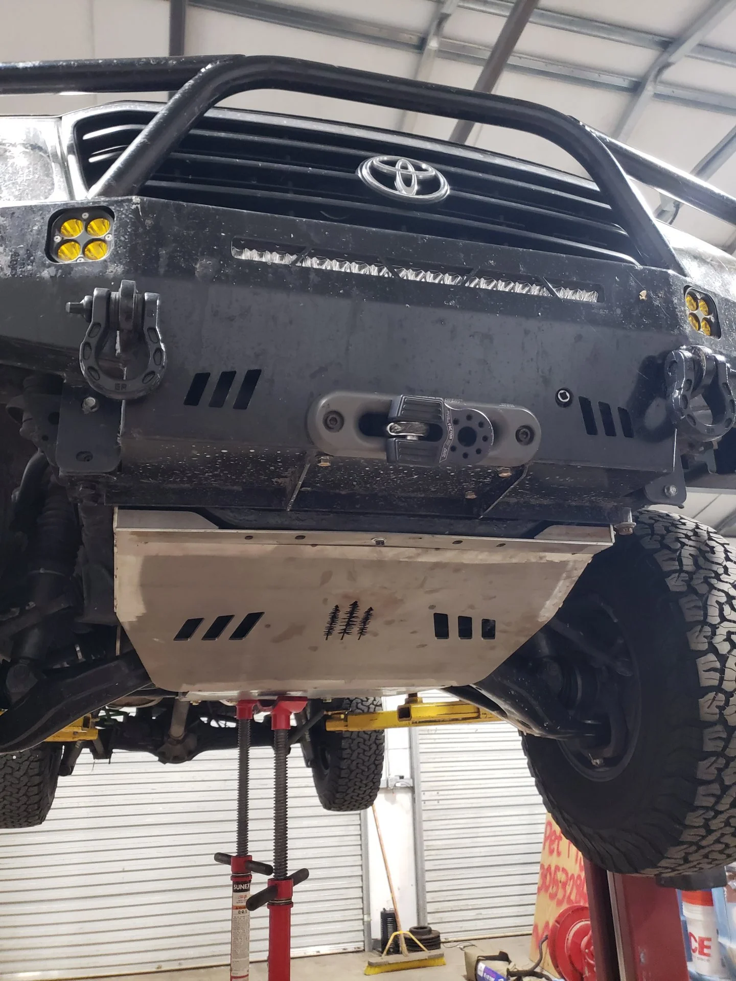

Also got more of the coastal skid plate done today. I had to modify a bit of it to get it to fit, as mine is a 98, and i think they used an lc/lx with a later steering rack as their r&d truck. I had to section a bit of the plate to clear a bolt for the steering rack in the crossmember. No big deal, and Brandon is aware now. I have some adjusting of the engine skid and tacking the transfer case skid to do before welding the entire thing. When this is done, I'm starting on their rear bumper.

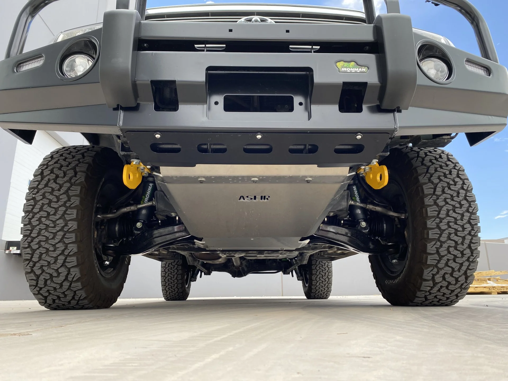

Currently building a Coastal front bumper. I like how you cut out and added the led light bar in the center.
