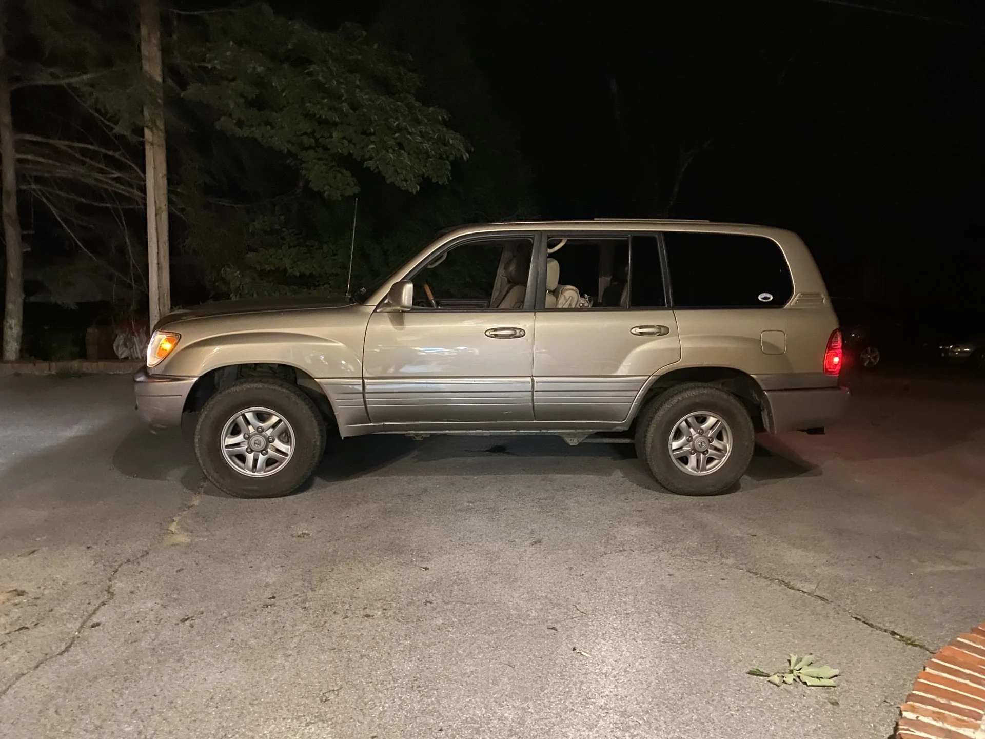

Helped @offroadengineer remove his OEM steps in preparation of White Knuckle sliders
Wow! what year and do you have before pictures? What does that cost?
Mine is a 2006 LX470 built 7/05. Costs/ordering is in the linked thread. Manual install (more details in the thread)

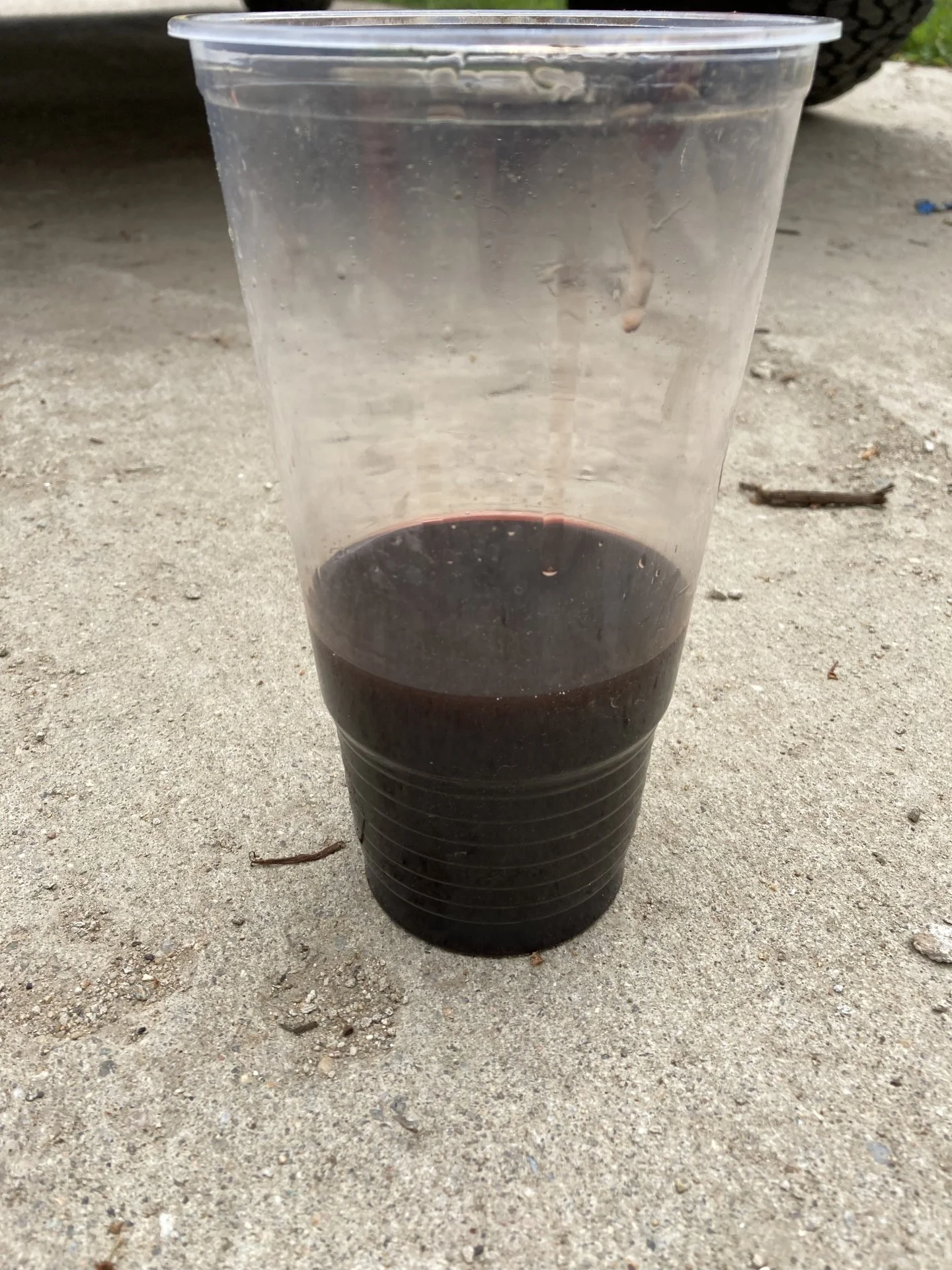

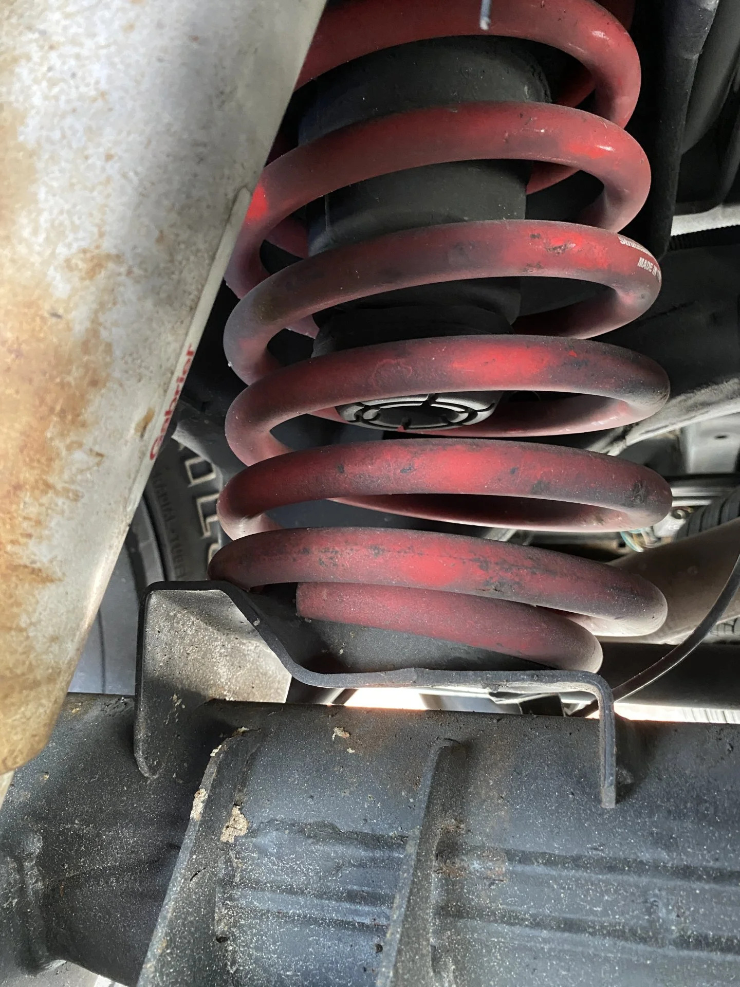

Changed oil with Mobil 1 Advanced Synthetic and a OEM filter. I also swapped out all the rubber bushing on the rear sway bar and endlinks.
