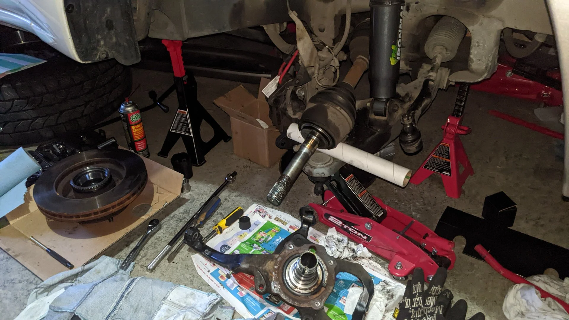

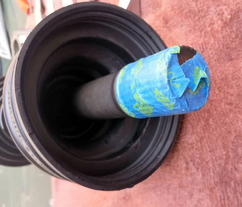

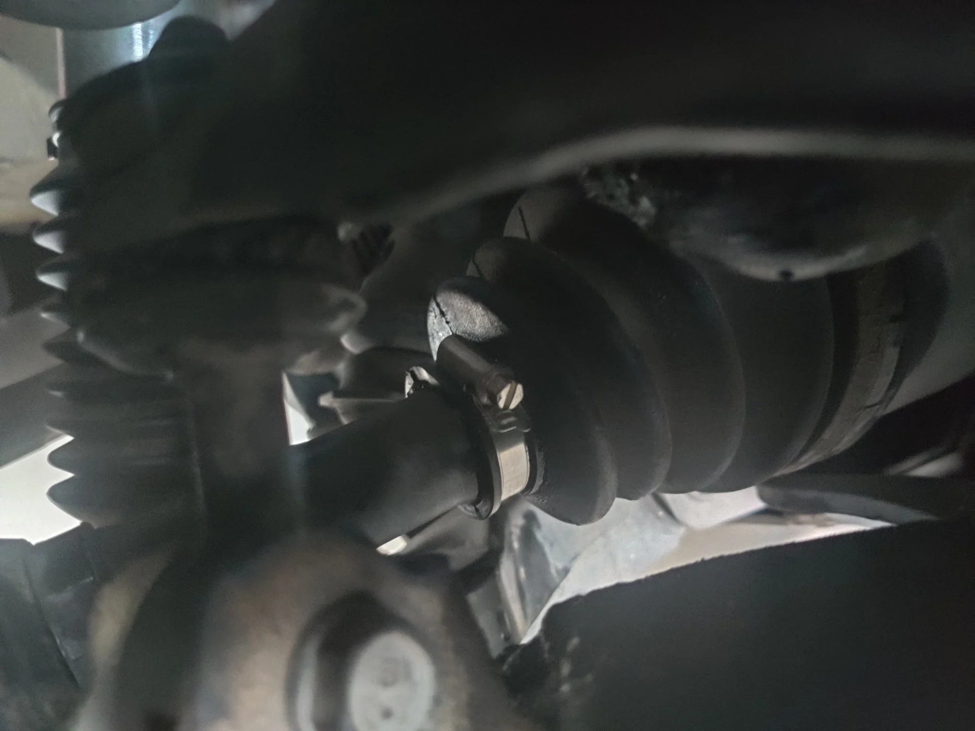

CV Boots on both sides apparently didn't like the Eibach Lift in front set at 21.25" even with the Slee Diff Drop, throwing grease. Seemed to be the clamps when inspecting, hope the recommended McMaster clamps do the job. I left them just finger and thumb tight with a ratchet screw driver, needed a little more tightening and I am scared to overtighten them. I will check through the week, but seems very much improved.
Yes I quoted myself :).
Update: Leak is all gone on both sides, thanks McMaster Clamps.

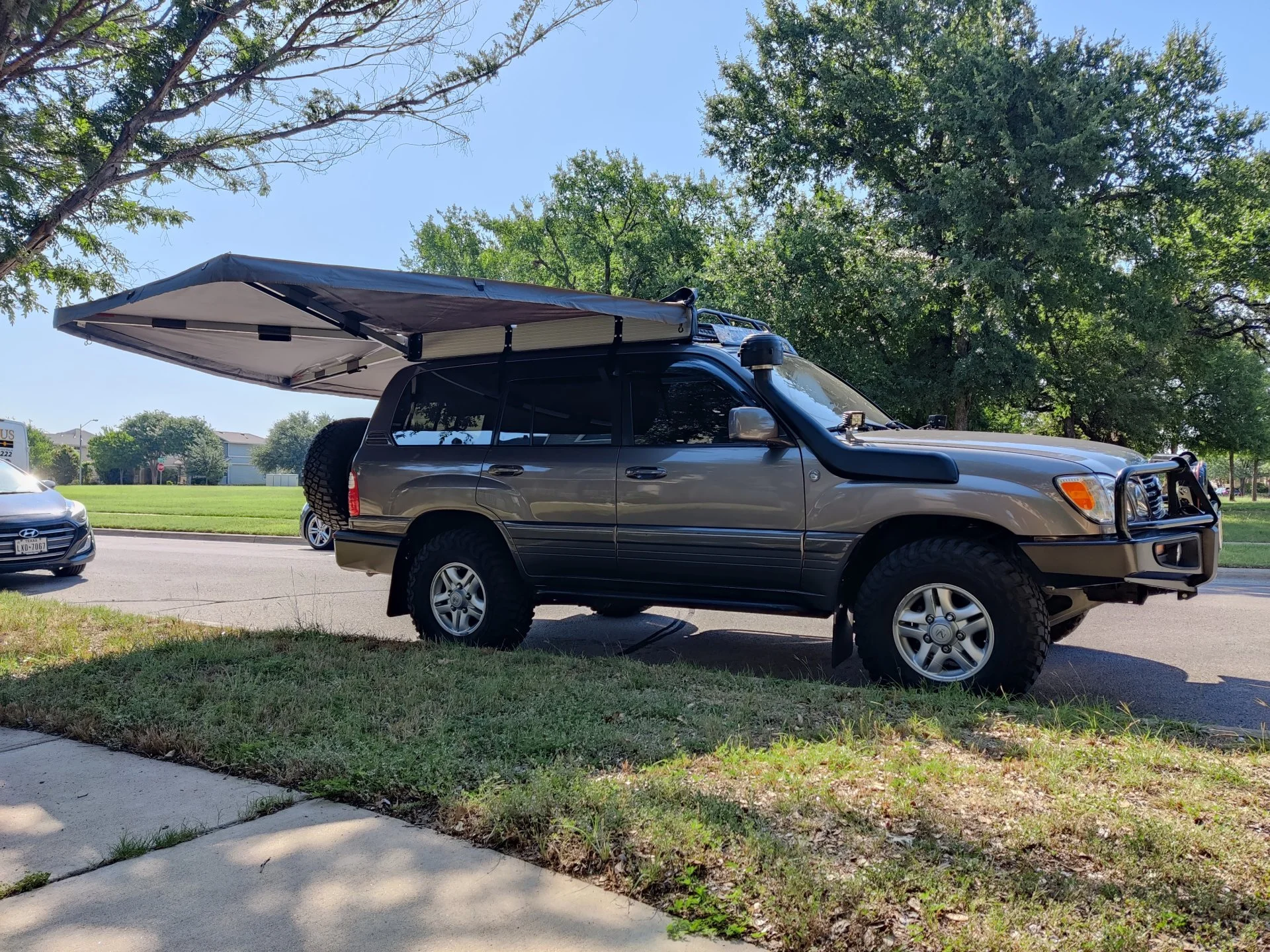

Threw my OVS 270 Awning up on the Gobi rack this morning. Sits just like I had hoped with the Fourtreks Mounts.
