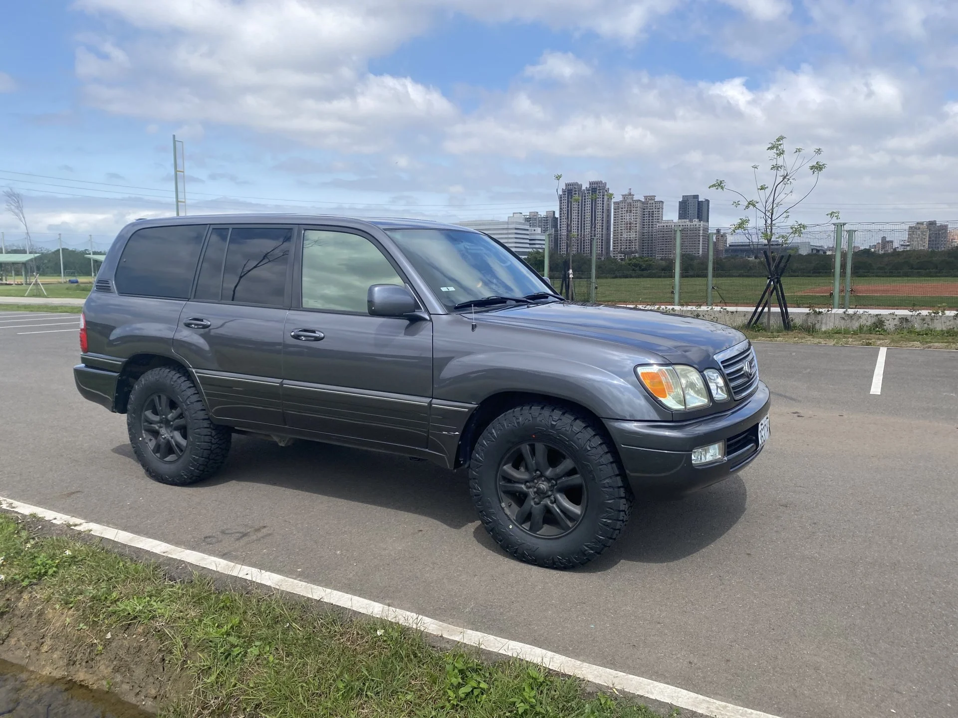

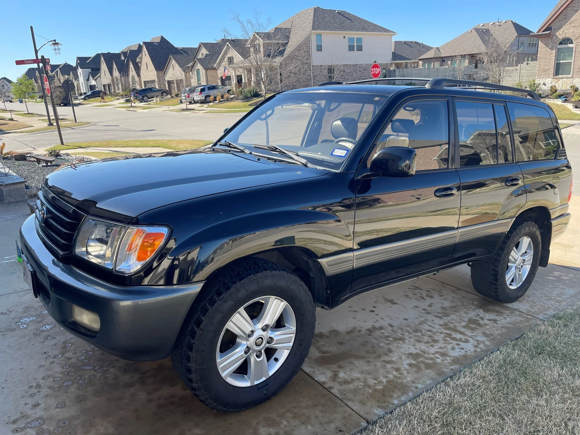

Trying out some 2014 Tundra TRD Off-road wheels

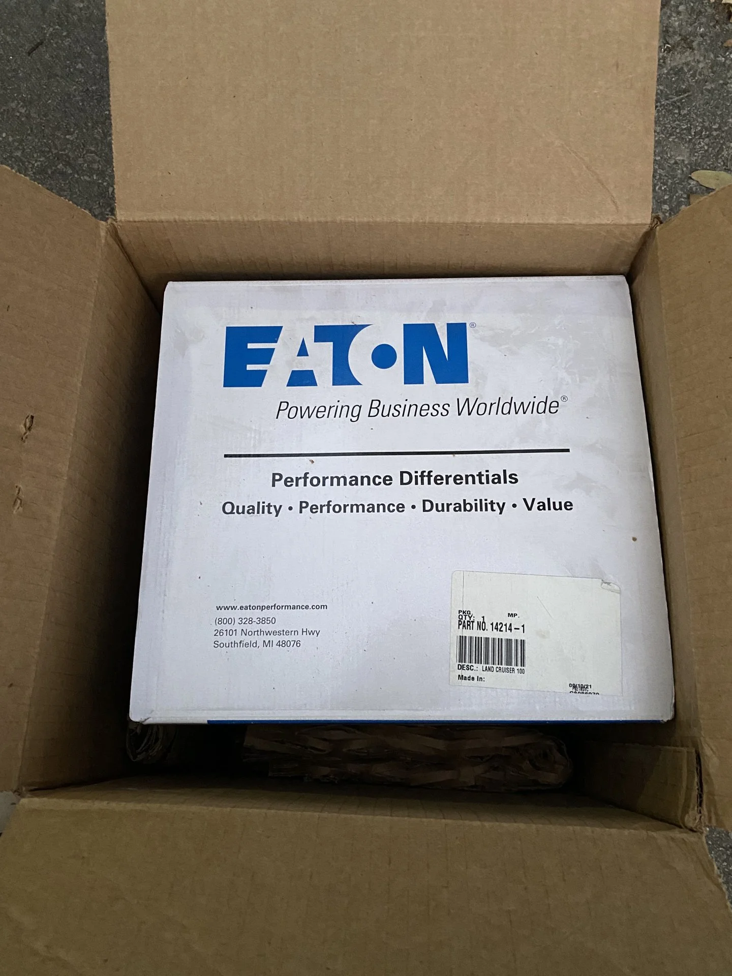

is this the same part as the harrop/eaton? or is eaton a different part number?
If I’m remember right from when I was looking for a rear locker they are crossed referenced but Harrop AU has a different part number than the Eaton but they are the same unit.
I reached out to the guys at Cruiser Bros for snagging this puppy, just verified the part number against Eaton’s application guide.
Appreciate it man

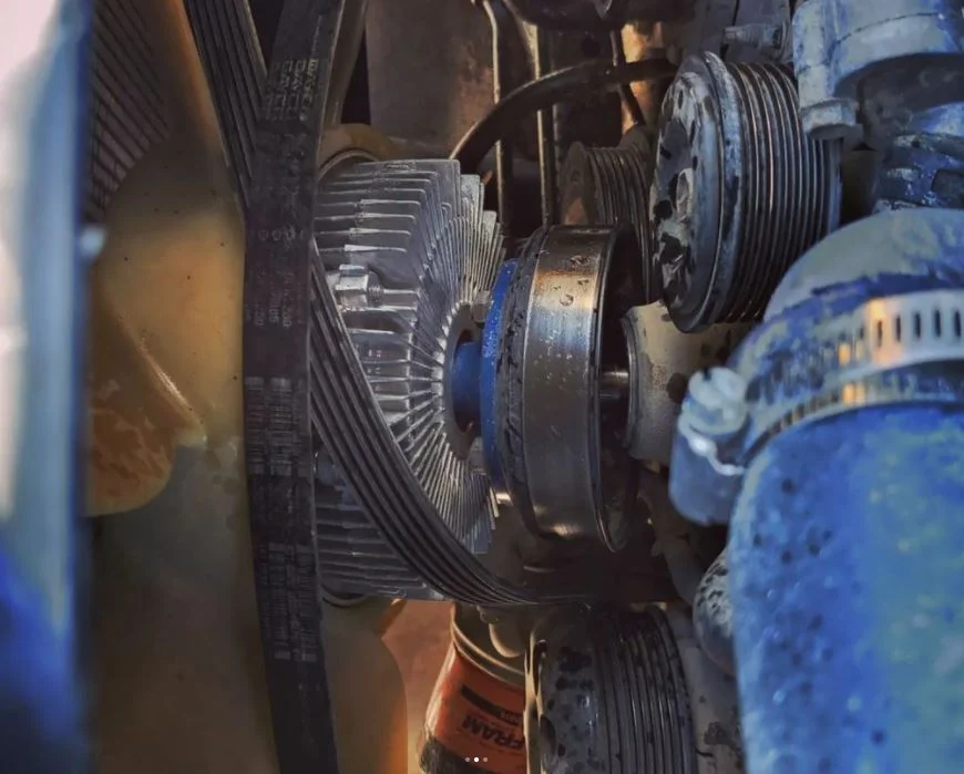

Broke it...
Thinking back to the timing belt job I did a year ago I can't recall if the fan bracket was replaced, but I'm guessing it wasn't. I think the brand new fan clutch finally did it in after 235K miles.
Parts were on order before the tow truck showed up. Should have it back up in no time.

This must be the year of fan bracket failures. I'm losing count of the number that I've seen fail over the past 6 months. I replaced mine a few months ago.

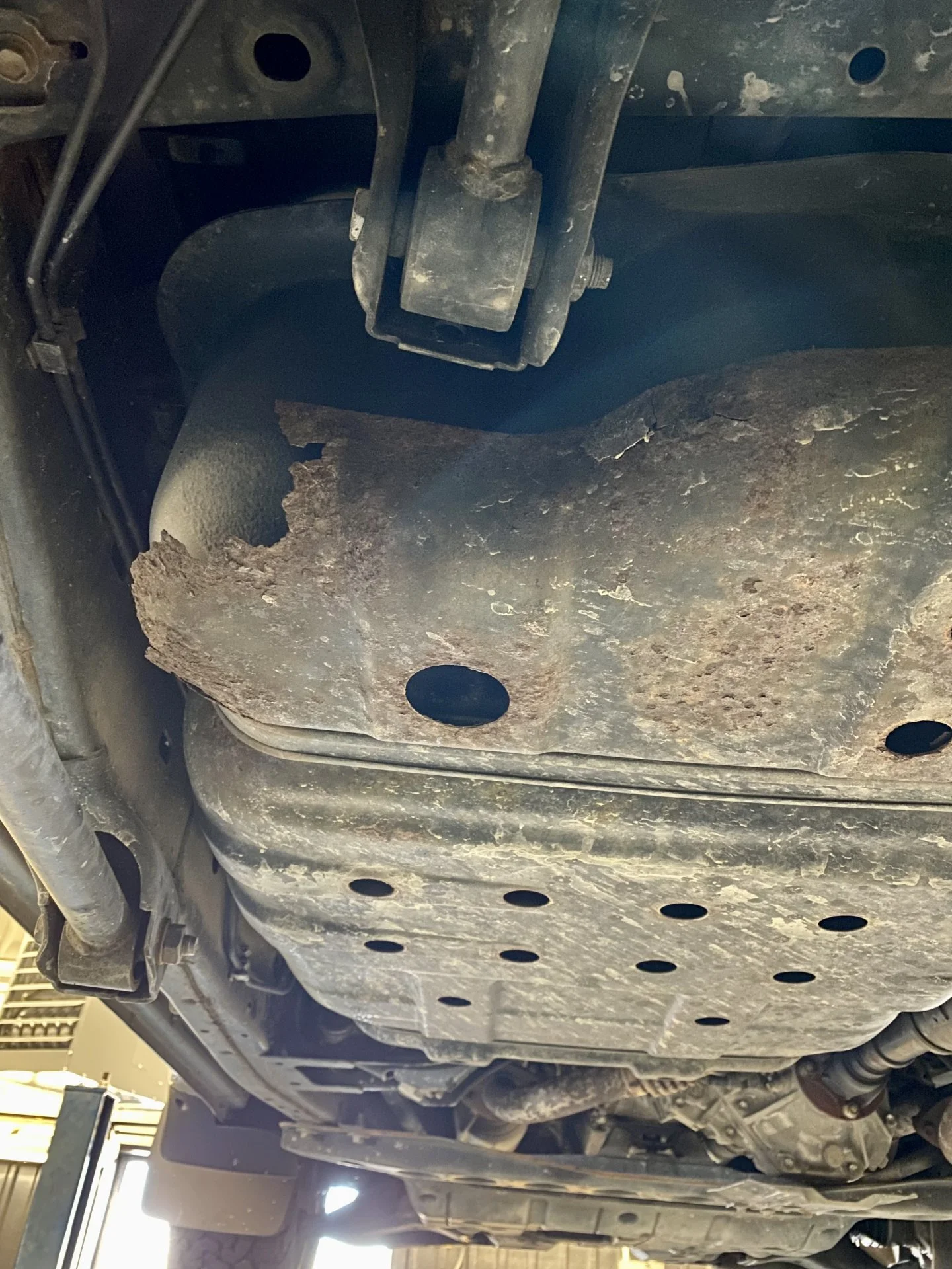

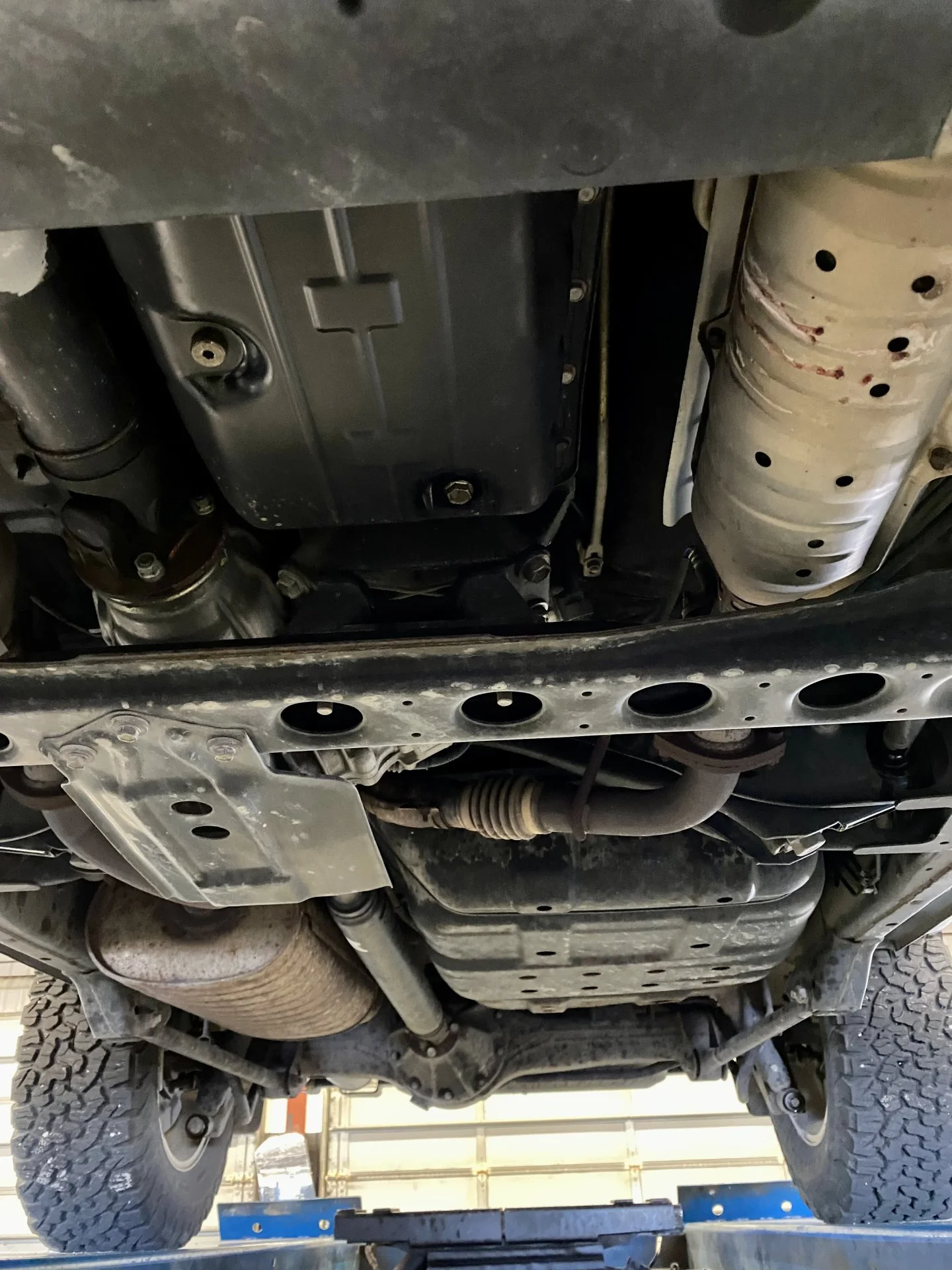

Not a whole lot going on. Got big booty Judy up in the air and knocked out greasing the U-joints and slip yokes. While I had her in the air noticed that imma probably need a skid for the fuel tank.
Greased up, took a 5 mile loop, and checked again.
Fuel tank skid not too bad, but might end up getting one sooner than later.
General inspection.

Mine started making horrible noise at 248k miles. Since it requires almost as much disassembly as the whole timing belt job, I just did the full timing belt at the same time too!

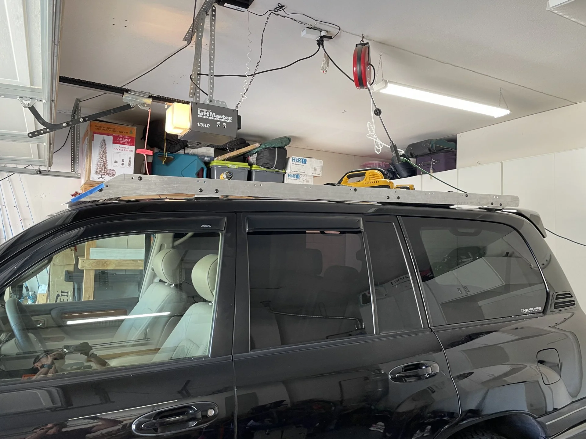

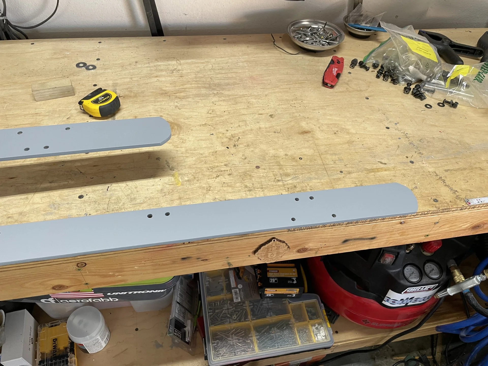

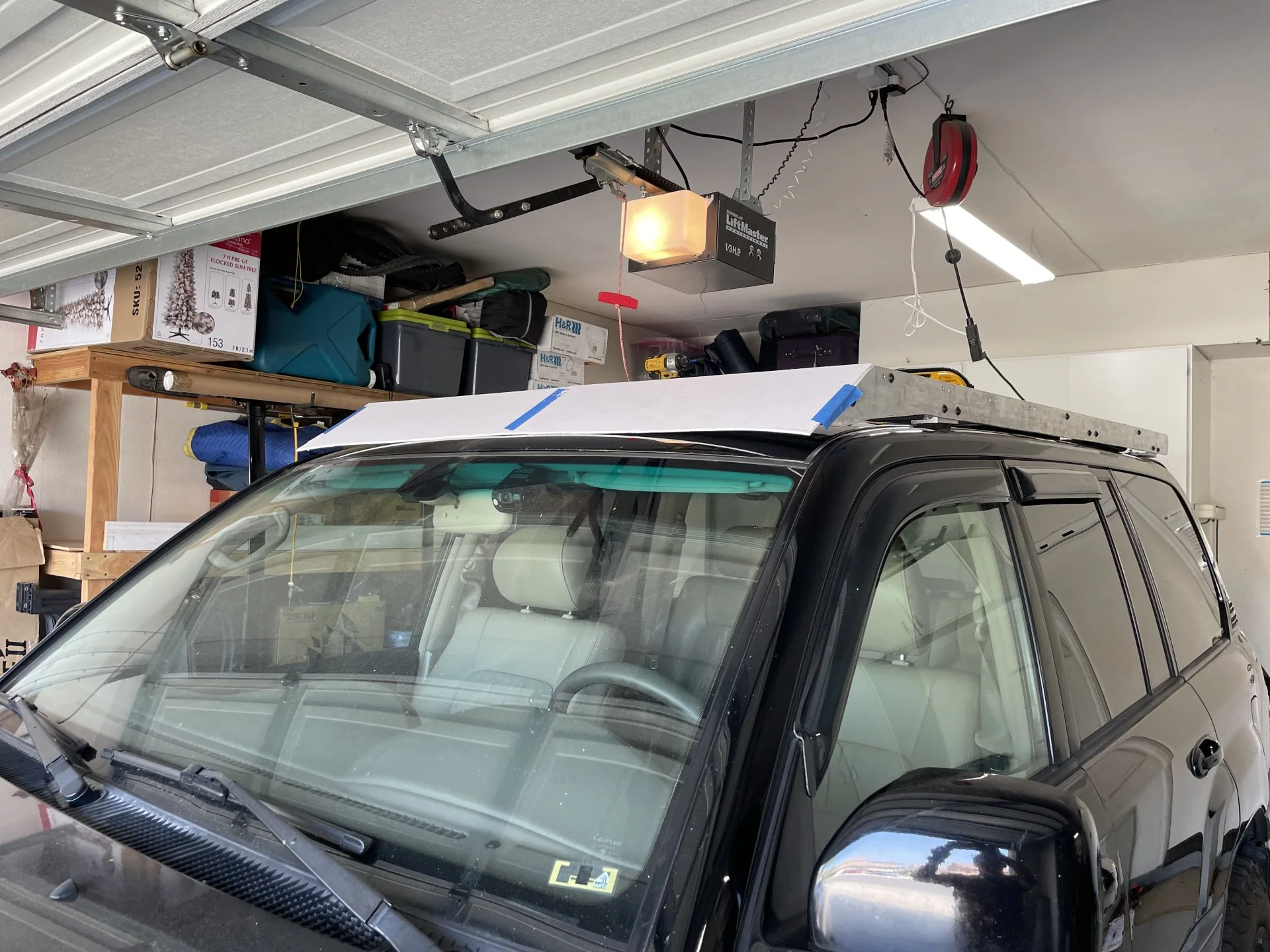

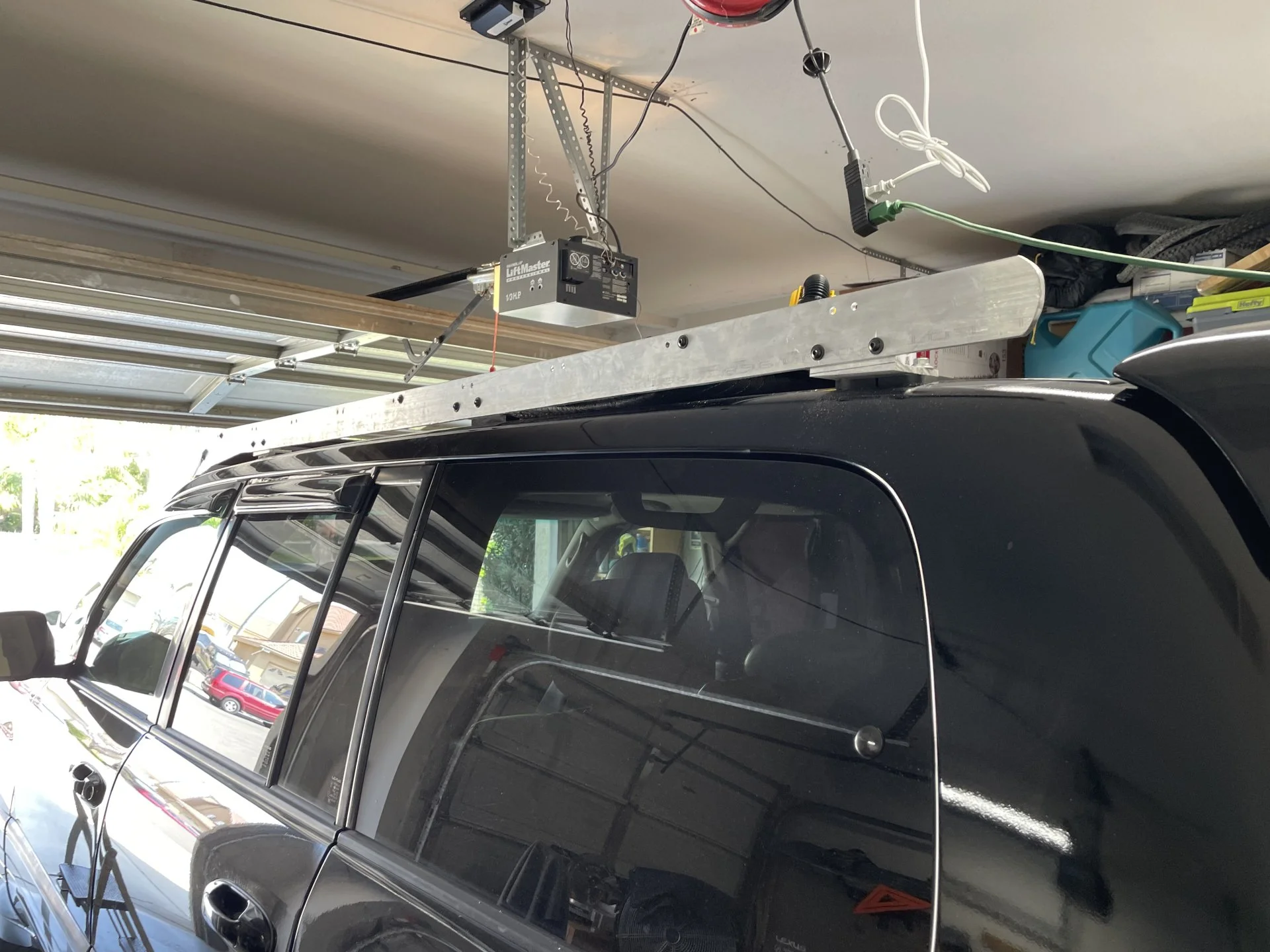

Had some time today so i drilled and mounted the side rails to the bracket. This thing is stout, 1/4” aluminum bracket this thing isn’t going anywhere. After that i cleaned up the drill holes and sanded and primed. Going to lay down satin black hopefully tomorrow. Excited to finally get this done. Oh i mocked up the wind deflector with foam core. Probably pickup lexan or acrylic for now.

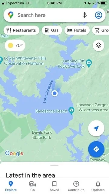

I took Lexi (not the most creative name, but it fits that Mint Eucalyptus metallic color and my wife likes it) out for a shakedown ride down Horse Pasture Road to check out the sunset over Lake Jocasse. Had a flat tire when I refilled, down to the rim. Thankfully it was right across the street from a tire shop, and they found it was just a bad valve stem, so after paying $10, we were on our way. Here are some pics along with my observation:

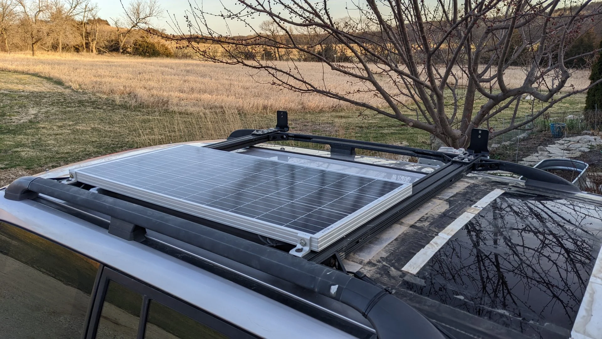

After loosing a flexible solar panel on I70, I replaced it with a solid Renogy.

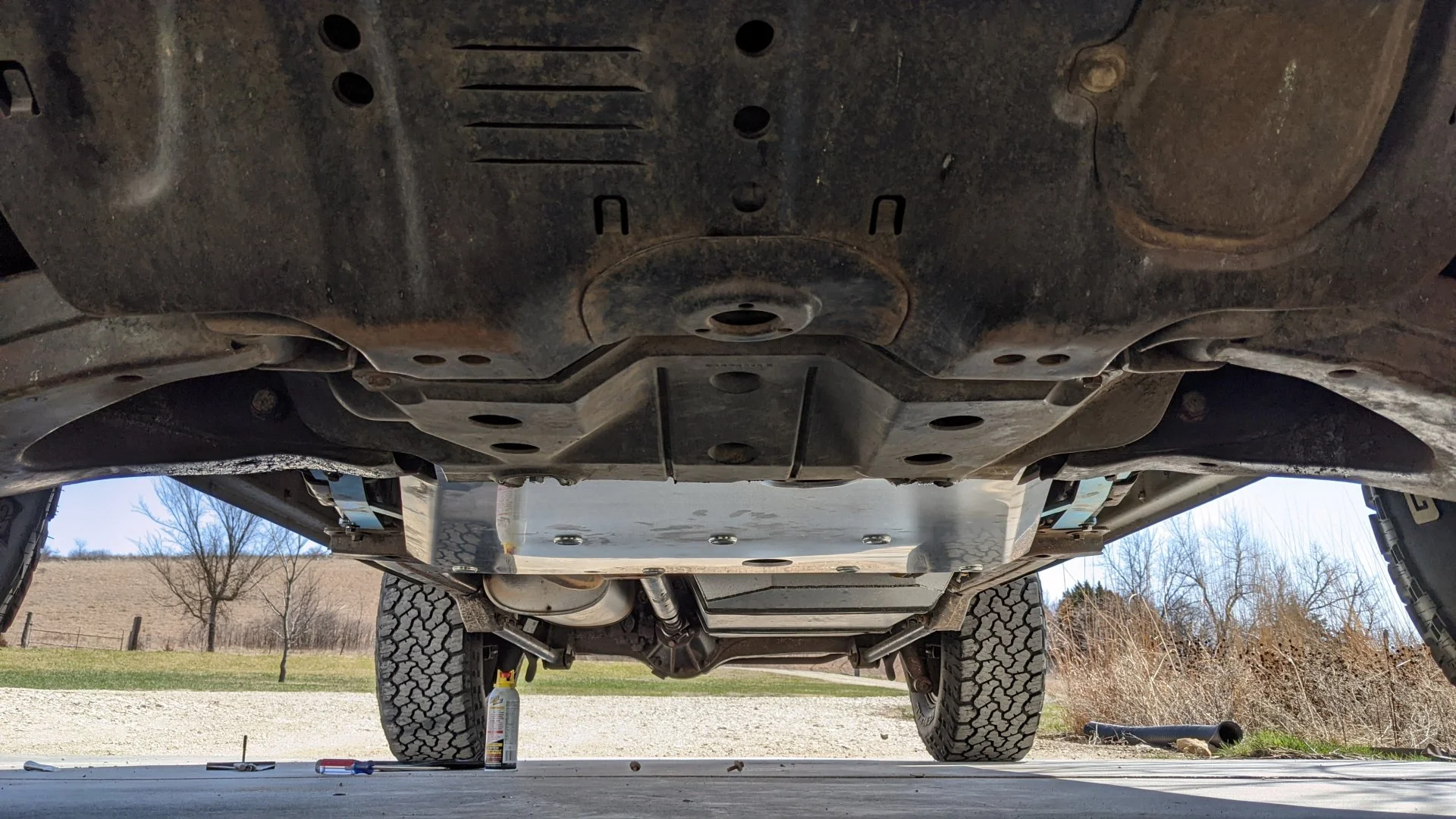

Installed a cat prevention device, aka ASFIR center skid. I cut down the stock belly pan to use with the aftermarket skid.

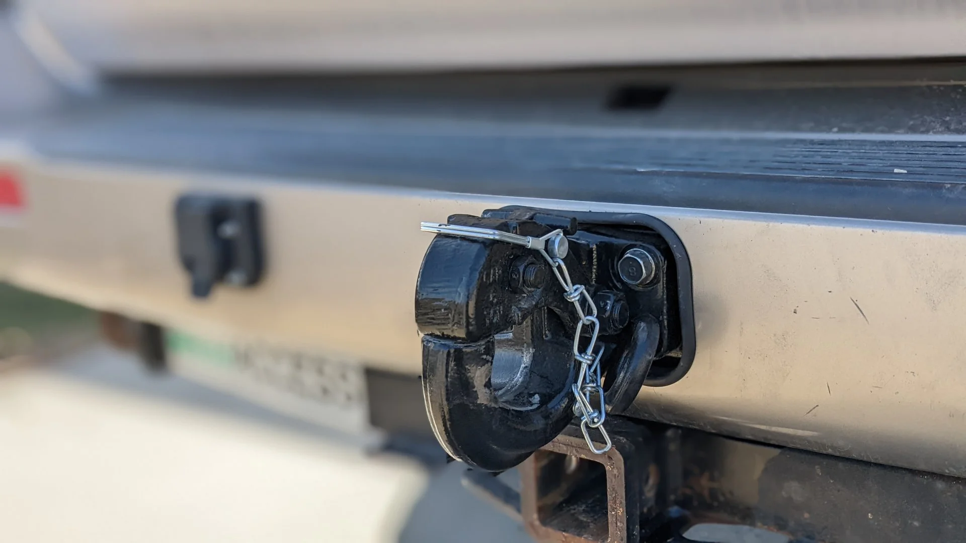

I exposed more of the cruisers overseas standard features and installed a pintle on the rear cross member with Toyota fasteners and trim piece.
