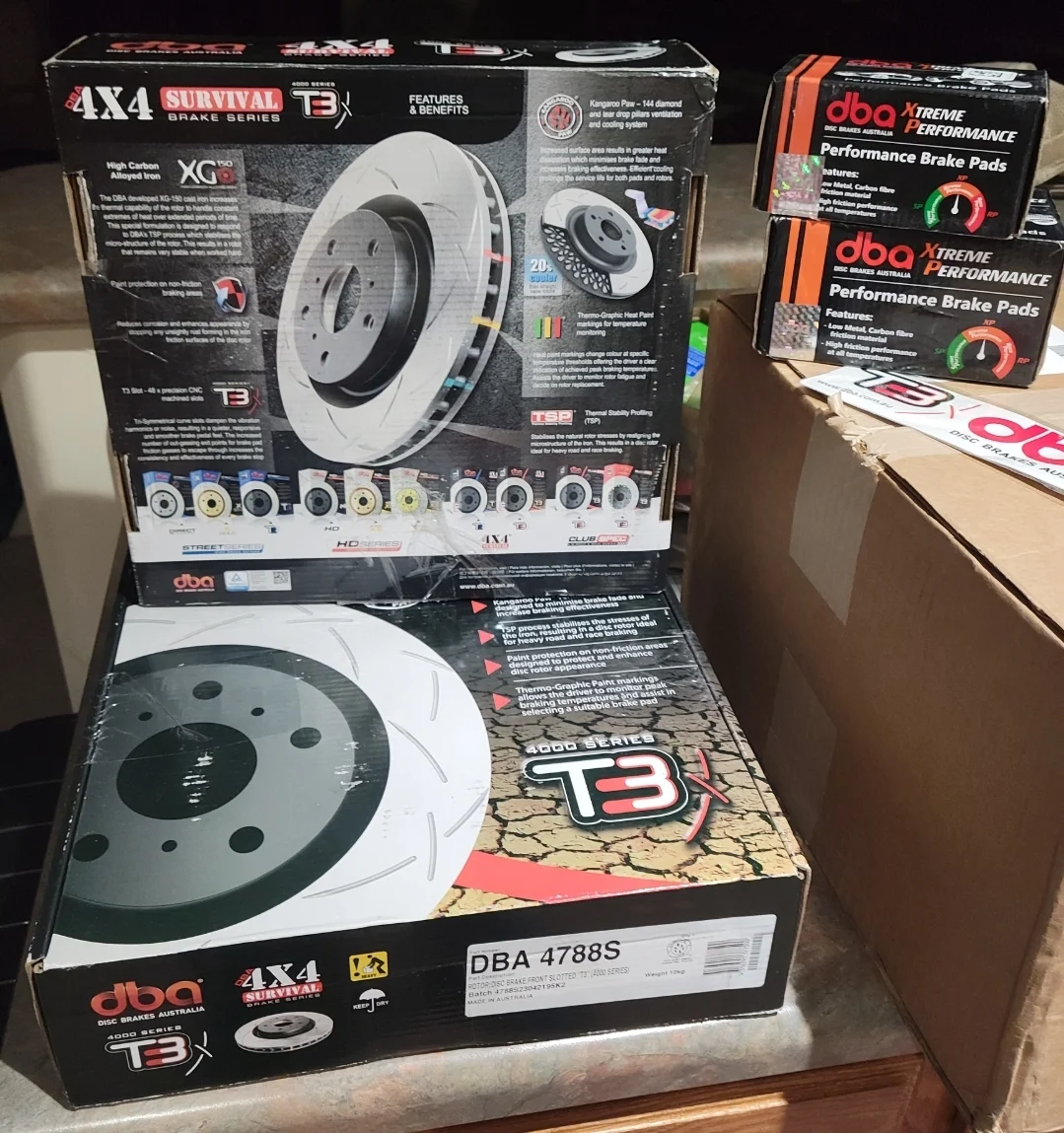

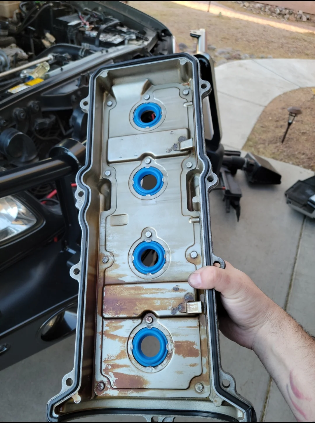

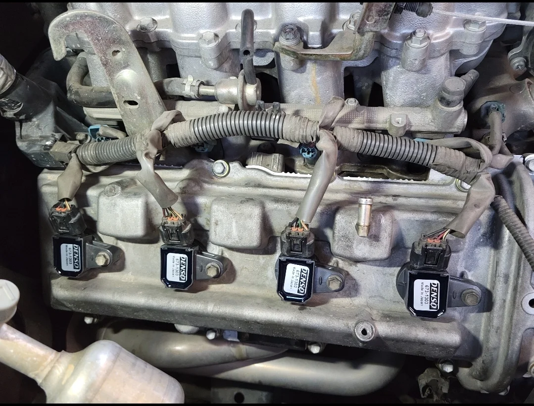

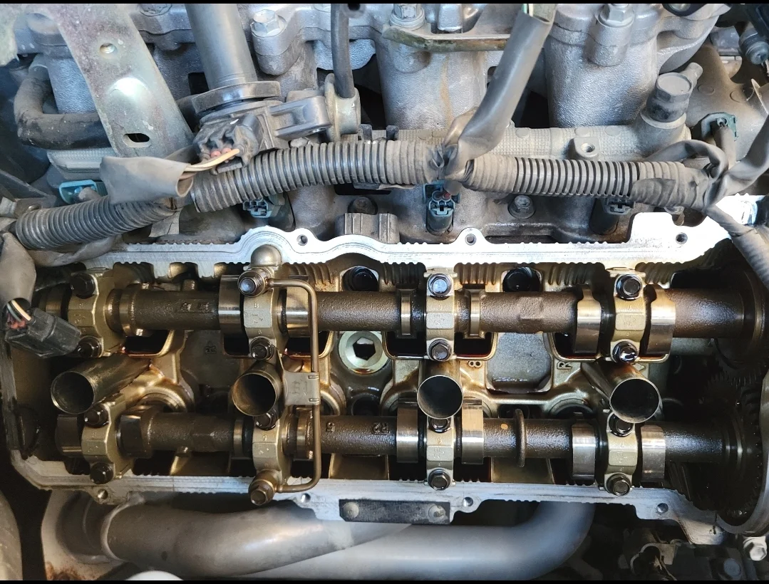

Got alot of maintenance done. New valve cover seals, spark plug seals, all 8 denso coil packs. $43 each from home depot with my military discount. New plugs, DBA front and rear rotors and pads, and Cruiser outfitters front end kit, bearings, races, hub flanges, snap rings, Amsoil full synthetic grease. Currently has 289k on her. I also cut off the rear resonator and welded a straight pipe. I have DT headers and magnaflow muffler, sounds very good now.

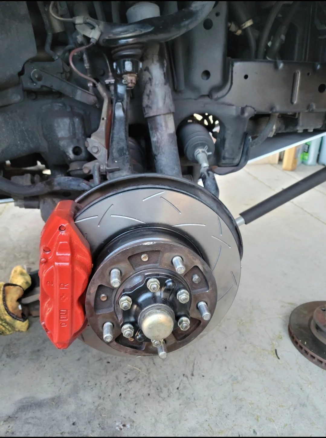

View attachment 2965642Looks good and looks like you’re having too much fun. Hahah. Why DBA rotor and pads? I just have factory rotors and pads so wondering what the interest is in for DBA or changing them out? Thanks for your feedback.
Yeah it was lots of work but its my zen. I've been a master ASE monkey for a long time.
I did alot of research on metals and make up of rotors. I don't like power stop products. And I wanted more stopping power then oem. These DBA rotors are very well built and vented well. And have thermo paint markings to keep an eye on the heat transfer. It brakes very smooth and quickly stops this tank lol. I got the rotors from buybrakes.com and the pads were on autoanything. If you go to the DBA website it shows you all their product lines, history of the company etc.

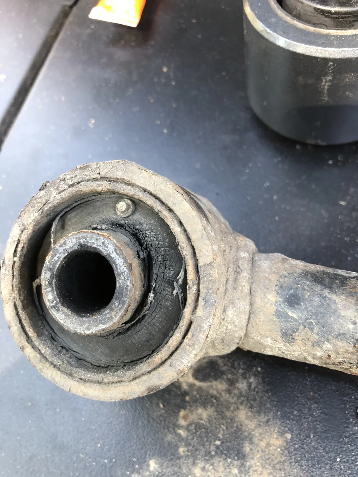

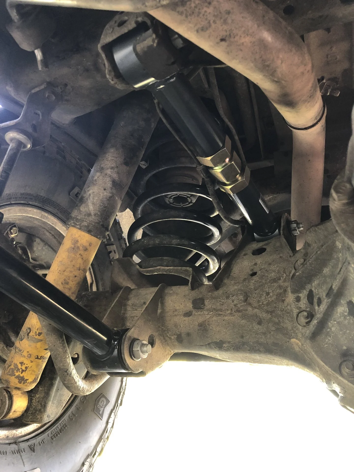

It’s definitely been a learning experience this past week. I’ve never dealt with pinion angles or installed rear control arms, even after 8 years as a dealer technician. But nonetheless here I am working with it and learning.

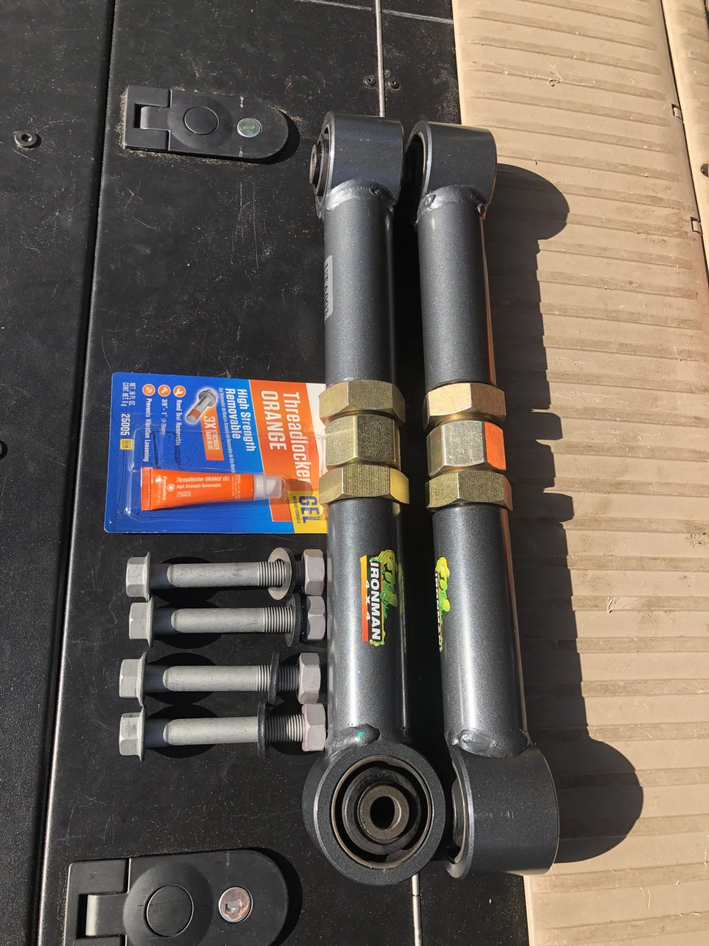

I’ve installed the @ironman4x4 upper control arms that are adjustable. This will be how I adjust my pinion angle. I measured it quickly this morning and I am roughly 4* difference between the output shaft flange and the pinion flange. I definitely have enough inward adjustment to achieve close to 0-1* difference. They also have factory style bonded rubber bushing to maintain the factory style ride that you lose with poly bushings.
On the lower control arms I’ve gone with @spc lower control arms the have both a factory style bonded rubber bushing that mounts at the rear axle but, also has a cross-axis joint for better flexibility that mounts at the frame.
I’m happy with both products. I’m confident they will withstand many more miles of abuse. The only thing left to replace in the rear is the panhard bar, as well as installing the DVSystems panhard relocation bracket.
It’s definitely been a learning experience this past week. I’ve never dealt with pinion angles or installed rear control arms, even after 8 years as a dealer technician. But nonetheless here I am working with it and learning. View attachment 2966197
I’m happy with both products. I’m confident they will withstand many more miles of abuse. The only thing left to replace in the rear is the panhard bar, as well as installing the DVSystems panhard relocation bracket.View attachment 2966198View attachment 2966200View attachment 2966199

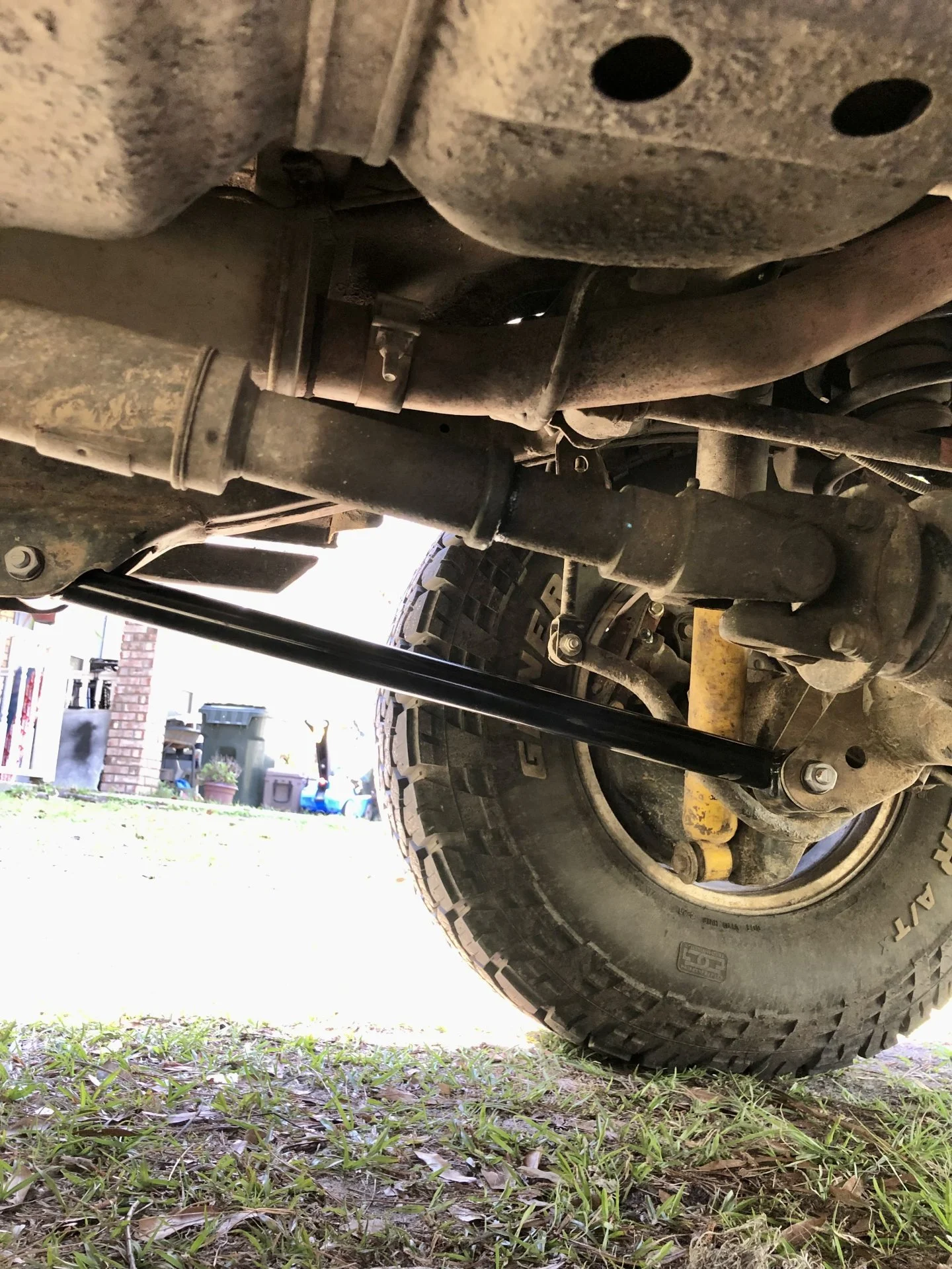

Nice work - I'm installing the same arms. If you researched it, what panhard bar do you think you'll use. I haven't got that far yet, but next up.
From all that I’ve read, I’ll more than likely be using a new OEM panhard bar in conjunction with the Delta Vehicle Systems panhard relocation bracket. The bracket should recenter the axle as well as bring my panhard bar angle back to or close to zero. Using an OEM bar, I’ll be able to retain the factory bonded style bushings to help keep what’s left of a “factory” ride.
