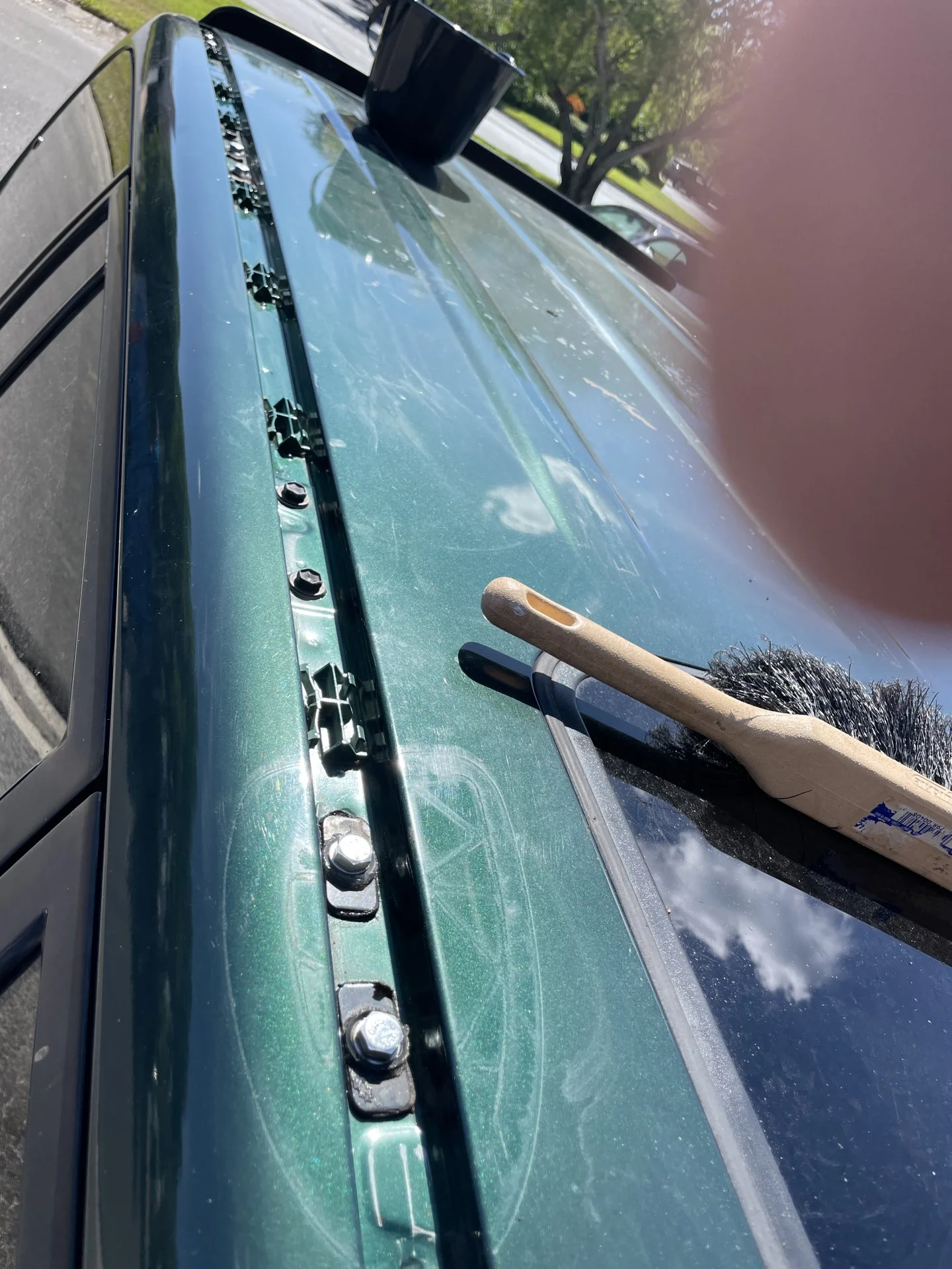

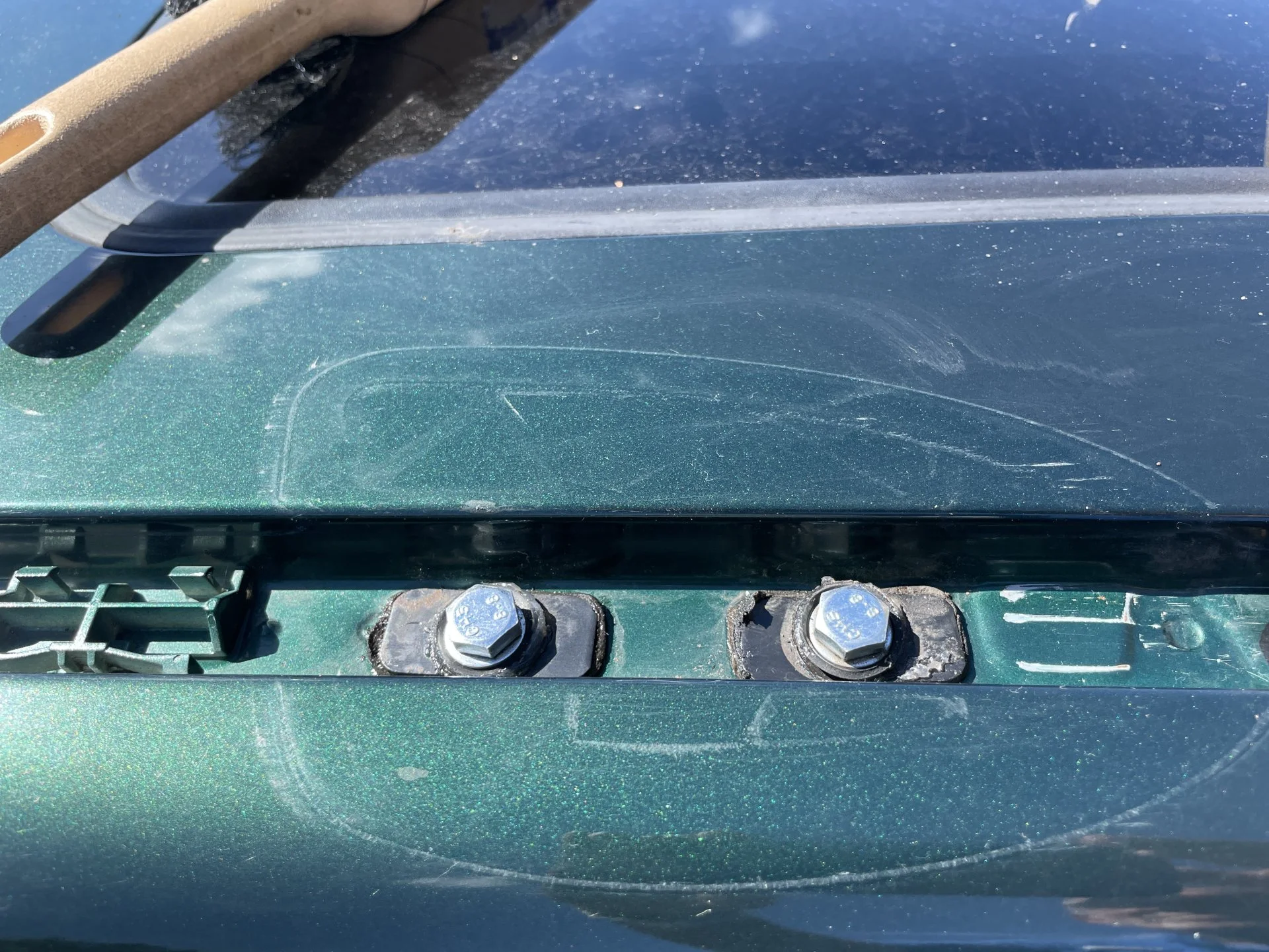

Before the LC went to paint I removed the rack and and sealed the fixing holes .....

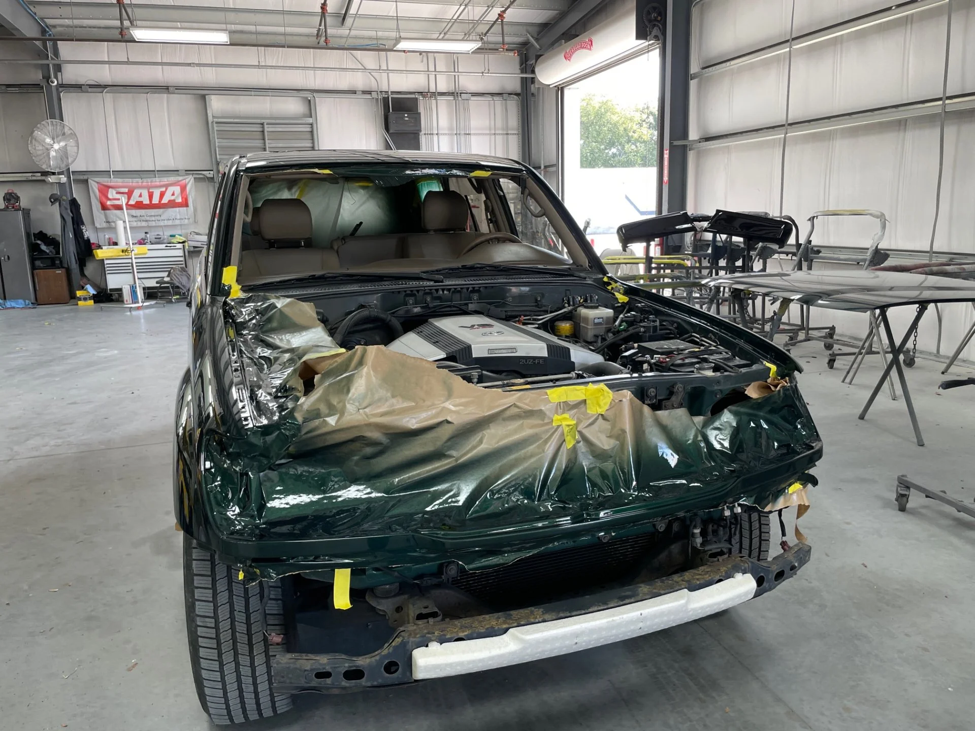

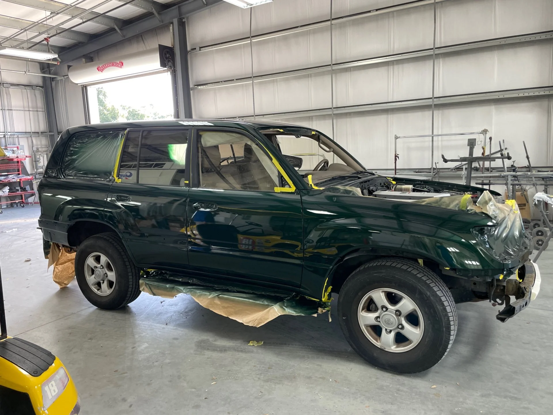

Here is the vehicle in the paint shop last week. They are doing very thorough job, grille and most lights removed, door handles and bumper covers off, windshield out ...

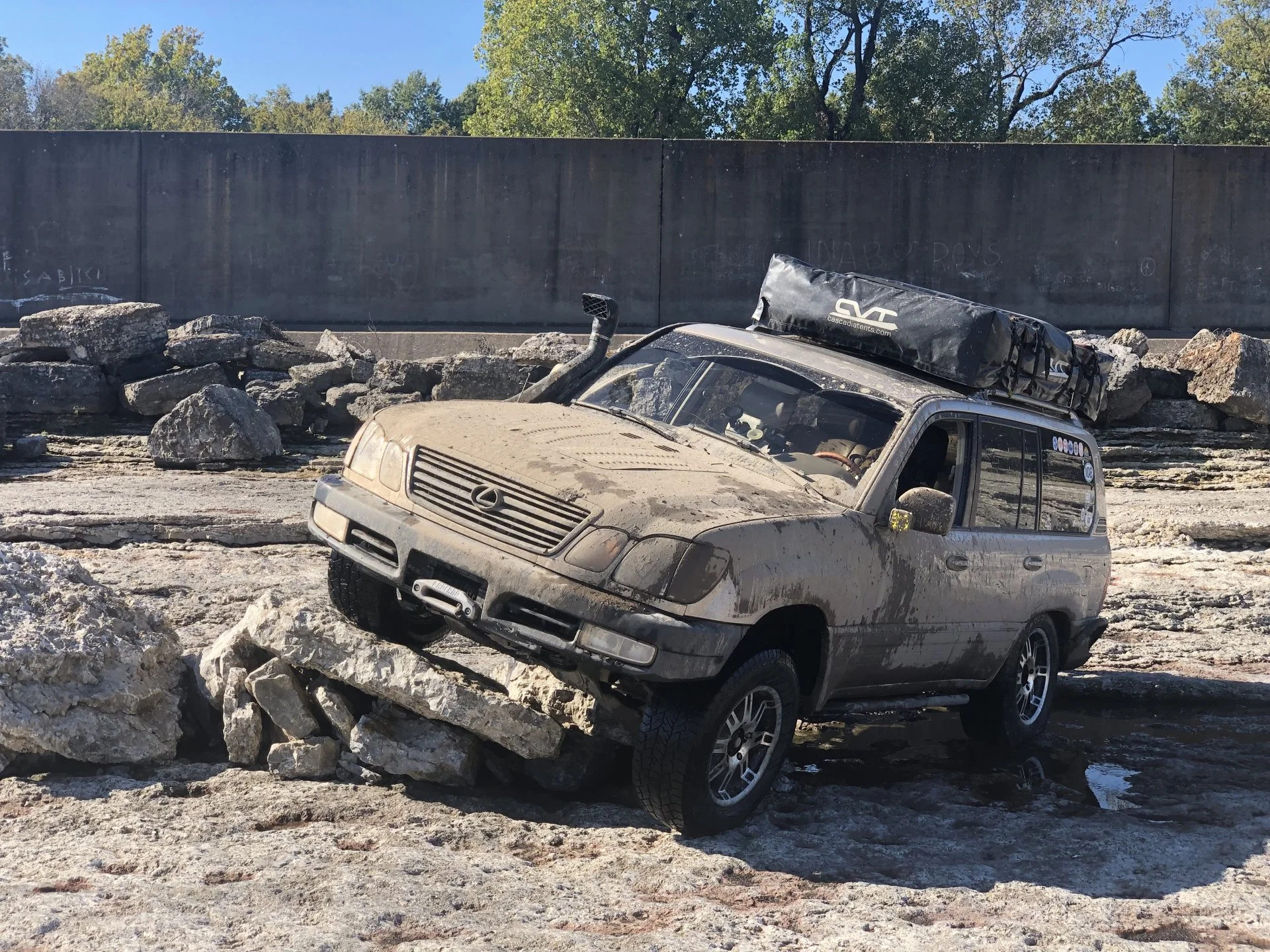

Well, finally decided to join the club here on Mud.
We did some wheeling this week, trimmed my front bumper and installed a Badlands Apex 12k winch and winch plate, and did some basic reorganization in the cargo area of the cruiser to clear up the middle seats for hauling another couple out into the wilderness!
Also have taken both driveshafts out and cleaned and regreased the U-joints in an attempt to stop a pretty severe driveline vibration from 50+MPH, rotated and checked balance on tires, and greased both driveshafts as well. Going to be checking in on what you all think about this issue this evening. Looking forward to talking to, and hopefully learning more and more about this rig with you all.
