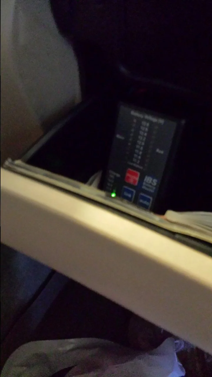

Added IBS Dual Battery hook up. Feels....redundant??? Btw, if you're considering this, save yourself some of the hassle and slap that puppy in the glovebox. Longer means a bit more hassle..

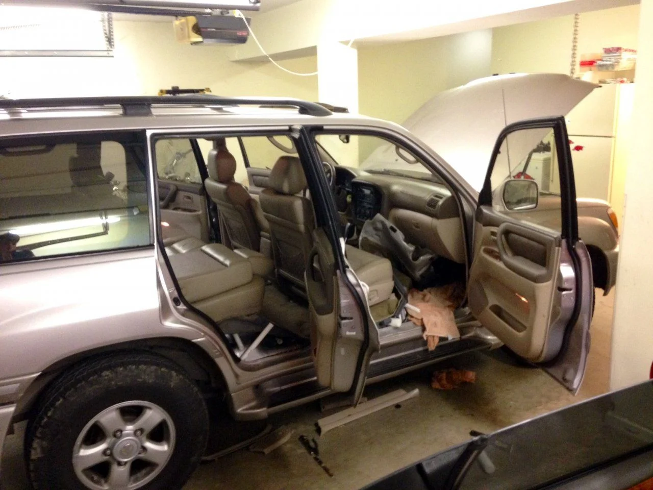

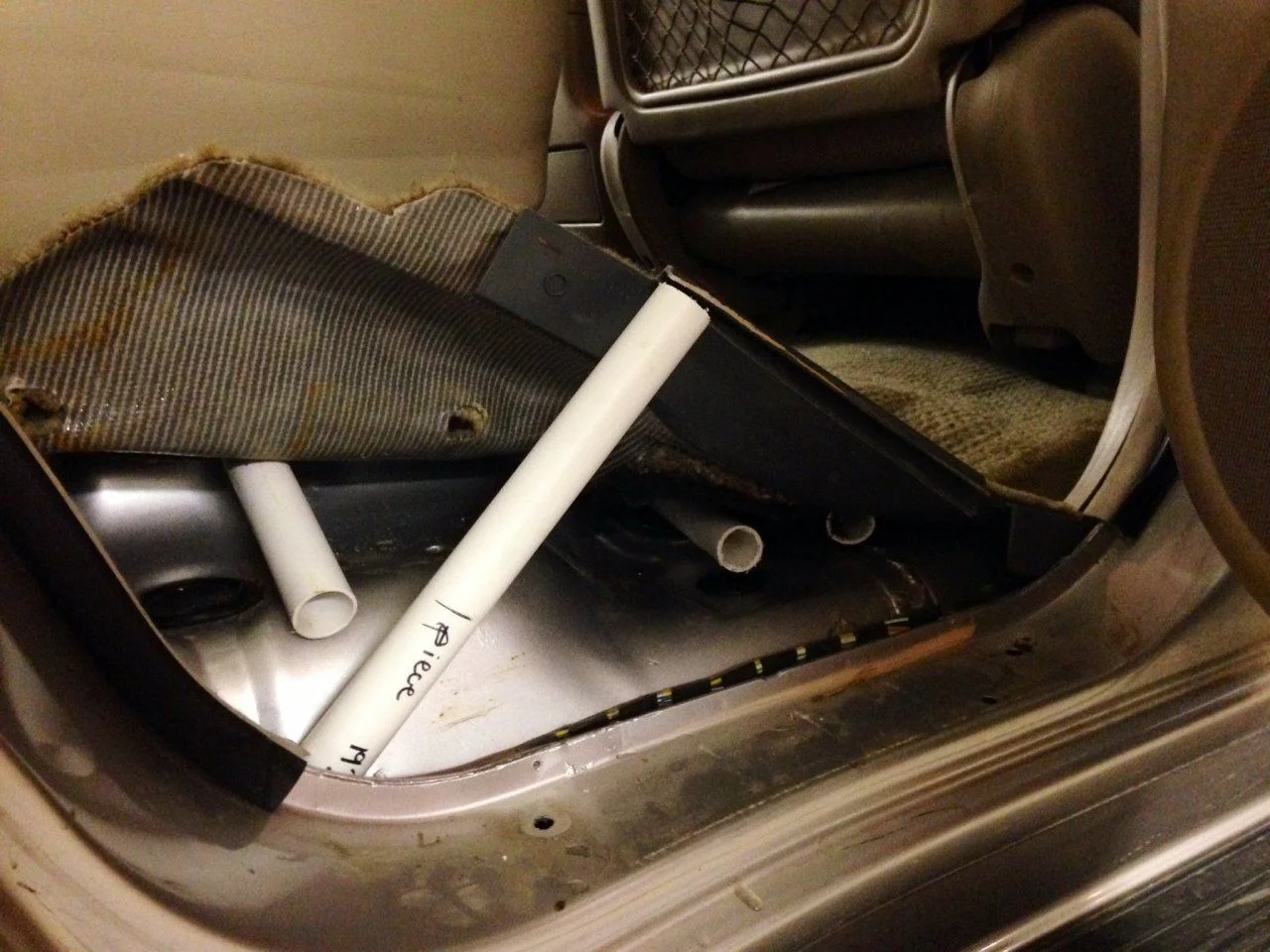

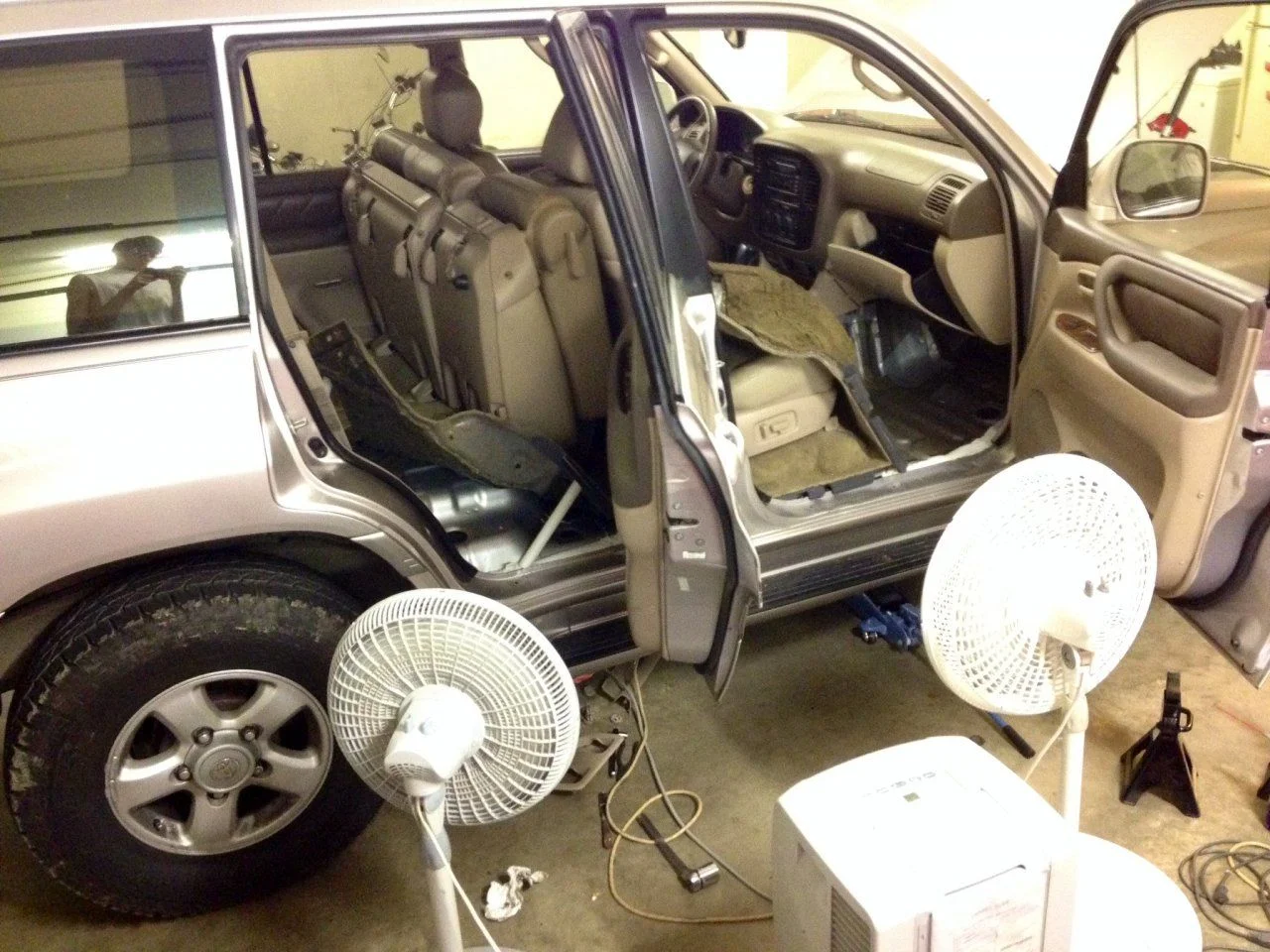

Update: For those of you who know I sunk my Hundy in the creek a few weeks ago, I finally got to bring her home! Now begins the drying process. The foam matting under the carpet is SOAKED and I didn't want to pay the dealership to strip it apart and leave it to dry for a week so I decided to do it myself. After driving it home with no issues I parked it in my garage and took off almost all of the trim around the console and door frame that holds the carpeting down and stuffed cut pieces of PVP under it to allow air to circulate through and dry everything. I got 2 large fans on the passenger side (which received most of the water damage) along with a dehumidifier and another fan on the other side facing the drivers area. After I get a good majority of the water out of the easy-to-get places, I plan on putting everything back together and closing the doors with the dehumidifier and a couple buckets of Damp-Rid inside to get the remaining moisture out. I want to get all the water out that is possible to avoid any mildew odors that might arise in the future so I am leaving it in there to dry for about a week.

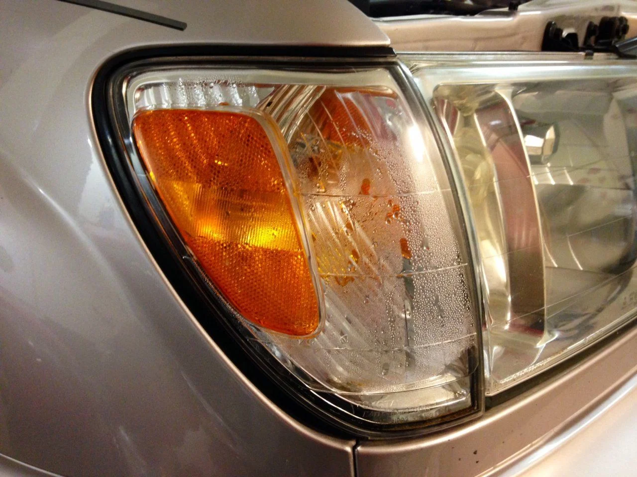

Another problem I'm having is there is water in the right front blinker and DRL housing (shown in pics below). What's the best way to get that out so it doesn't continue to cause more problems in the future? Does anyone have any suggestions or advice they'd like to share with me? I'm open to anything that might help/speed this process up a little. I'm just glad I got her back in good shape!

Can't you take out the matting ccompletely and let it dry outside in the sun?
This will give you a better dry surface for the interior of the car as well.
^^ Take it out and wash it using any number of carpet cleaning products and let it dry in the sun.
Even though you live in an area with high humidity (vs. the west/southwest), the sun really can do wonders.
What about the headlight?
