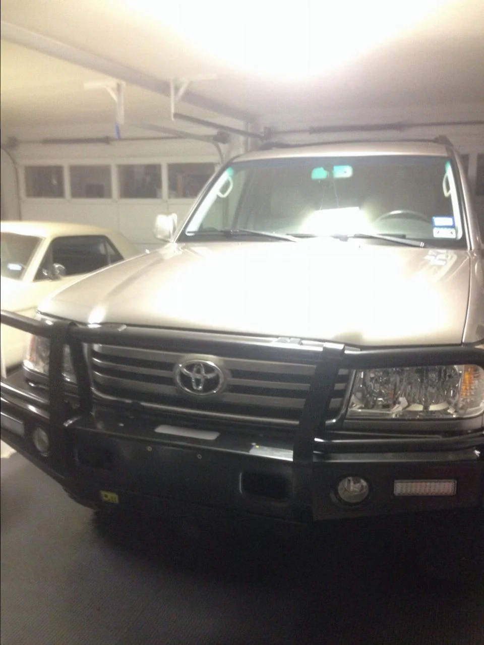

Bolted up a TJM T13 (still need to wire up the lights, raise the front end 0.5 inch, and get an alignment)

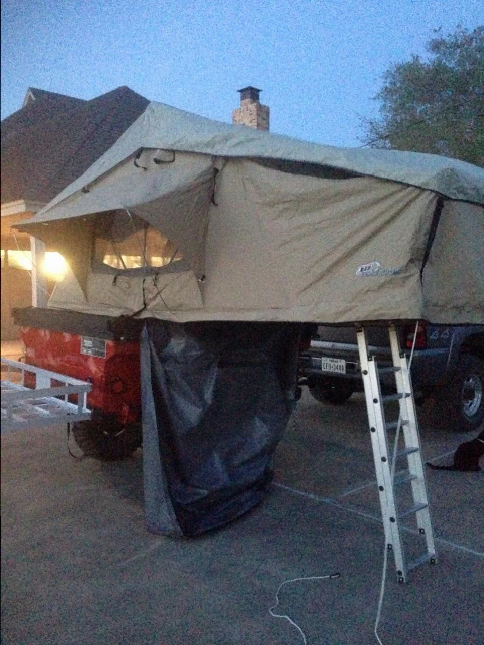

and drove 12 hours to pick up our sleeping accommodations for HIH

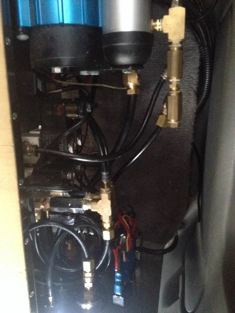

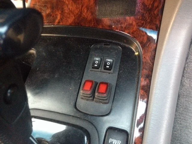

Did a bit of work with my on board air. Grabbed some solenoids of eBay and set it up so I can fill and empty the suspension air bags with a flick of a switch. Mounted a gauge for each side and one that shows air compressor pressure, and an air pressure outlet. Can also control it all from the drivers seat ;) Hides away quite nicely once the draws are pushed back in.

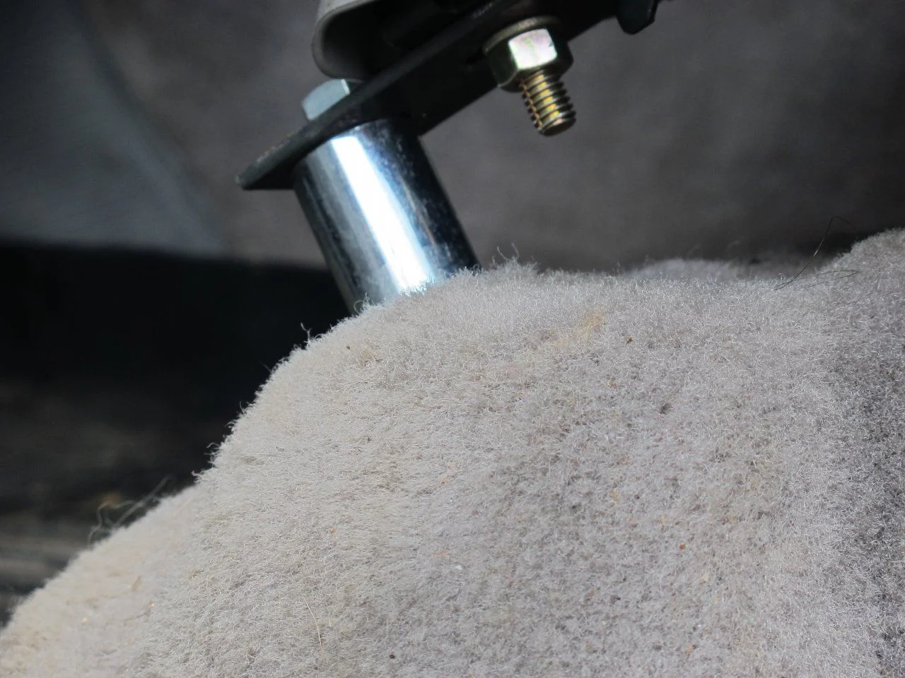

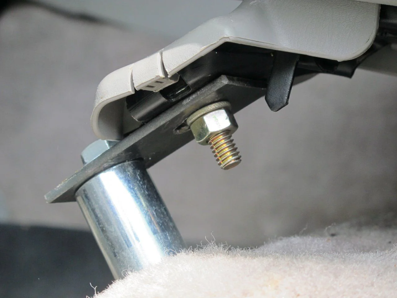

I accomplished another life changing mod today. Being tall and long legged, I have found the depth of the seat and lack of adjustability a constant annoyance in the year I've owned this otherwise lovely vehicle. I fabled up some brackets and devised a way to add about an inch and a half of height to the front seat mounts. It's SO much more comfortable now. More thigh support, the seat feels deeper and I'm actually able to adjust things in a way that I'm comfortable. w00t!
Oftpiste.....got some pics on the mounts you made.
It's not super pretty, but I'll grab a pic later. Two short steel brackets, one end bolted to the seat, the other with a 1.5 inch spacer under it for the height increase, and a new, longer bolt through the spacer and into the floor.

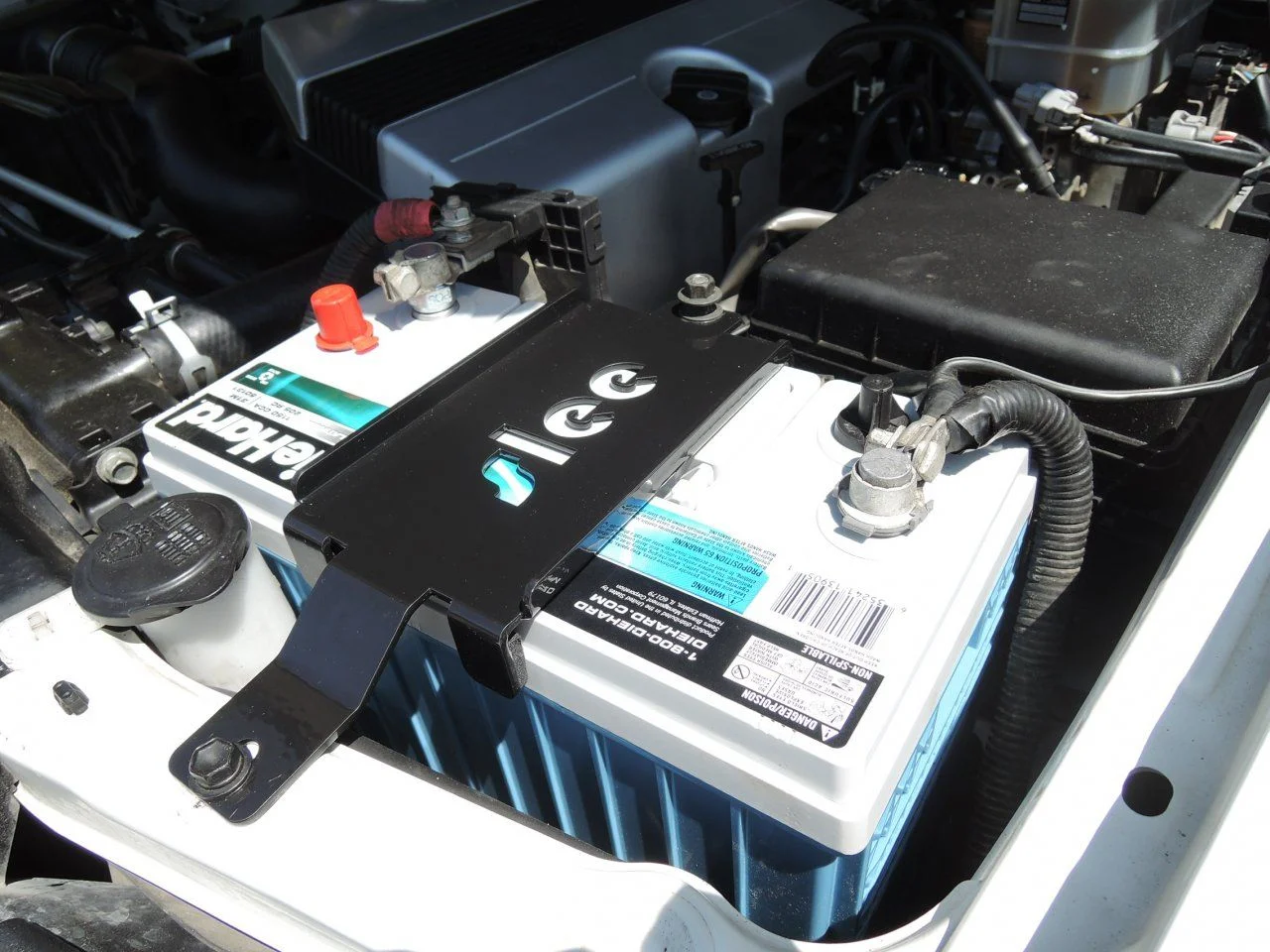

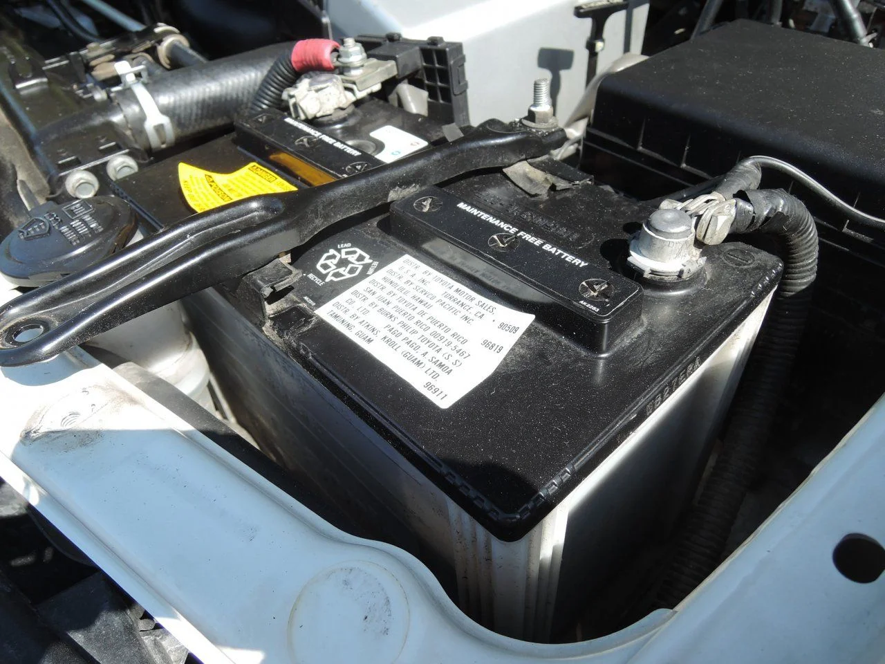

Out with the old and in with the new...Die Hard Platinum Group 31 Marine Battery installation.

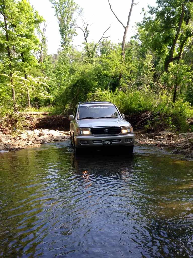

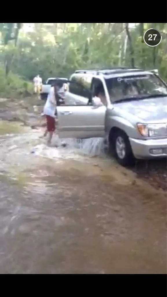

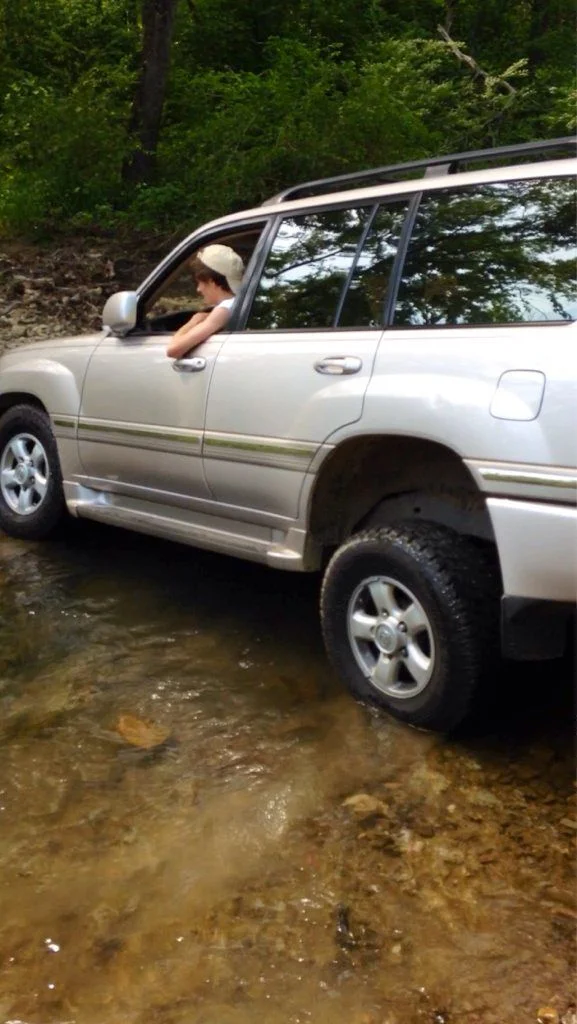

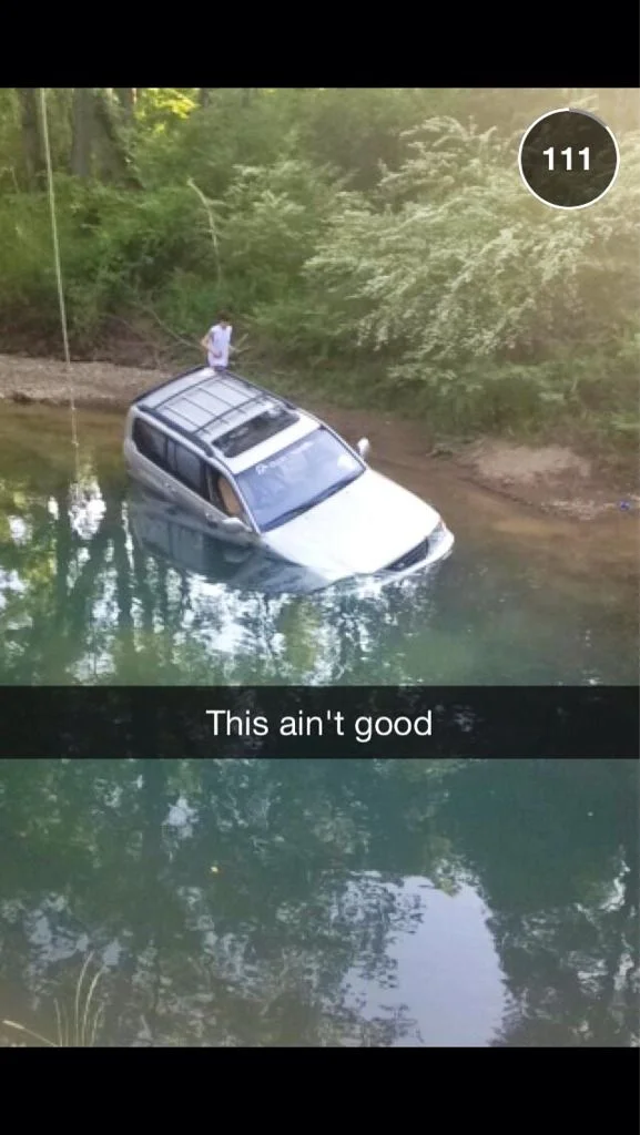

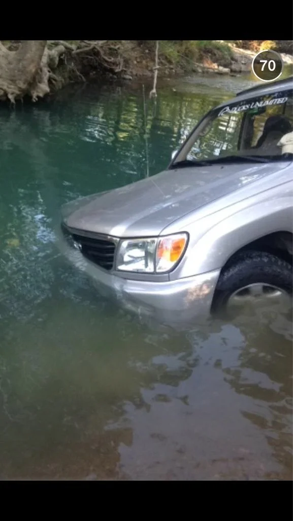

Update: Well after sinking my Hundy in a creek 2weeks ago and sucking water into my intake and engine block, I finally heard back and the engine did NOT seize! I was amazed and it even surprised everyone working at the dealership. They flushed all the fluids, changed my oil about 3 times, differential, power steering, brake, etc...They started her and when the pistons went in their upstroke it expelled even more water out of the engine block and intake then stalled. They continued drying her and started it again and she ran perfectly! No abnormal sounds indicating bent pistons or rods and she purred smoothly just under 1000rpms. After letting her run for about 4min they cut it off and checked the engine control module to see if she still had her brain and miraculously it did! They will continue drying and flushing as much water out as they can and I should be able to bring her home next week. Just proves how much of a beast Cruisers really are!!
The photos below show how the day WAS going - crossing a few creeks, taking a couple pics, and showing off my wheel travel - and how it ended up after hitting a patch of sand on the edge of the creek and it sliding out from under me bringing the car down into deeper water.
