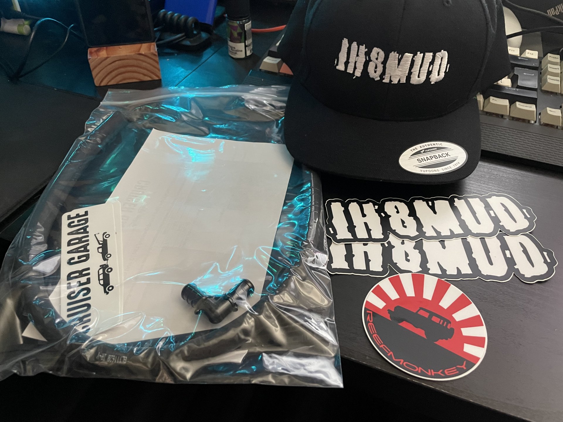

Got some goodies in the mail today. My AC drain line extension from @CruiserGarage and some mud swag

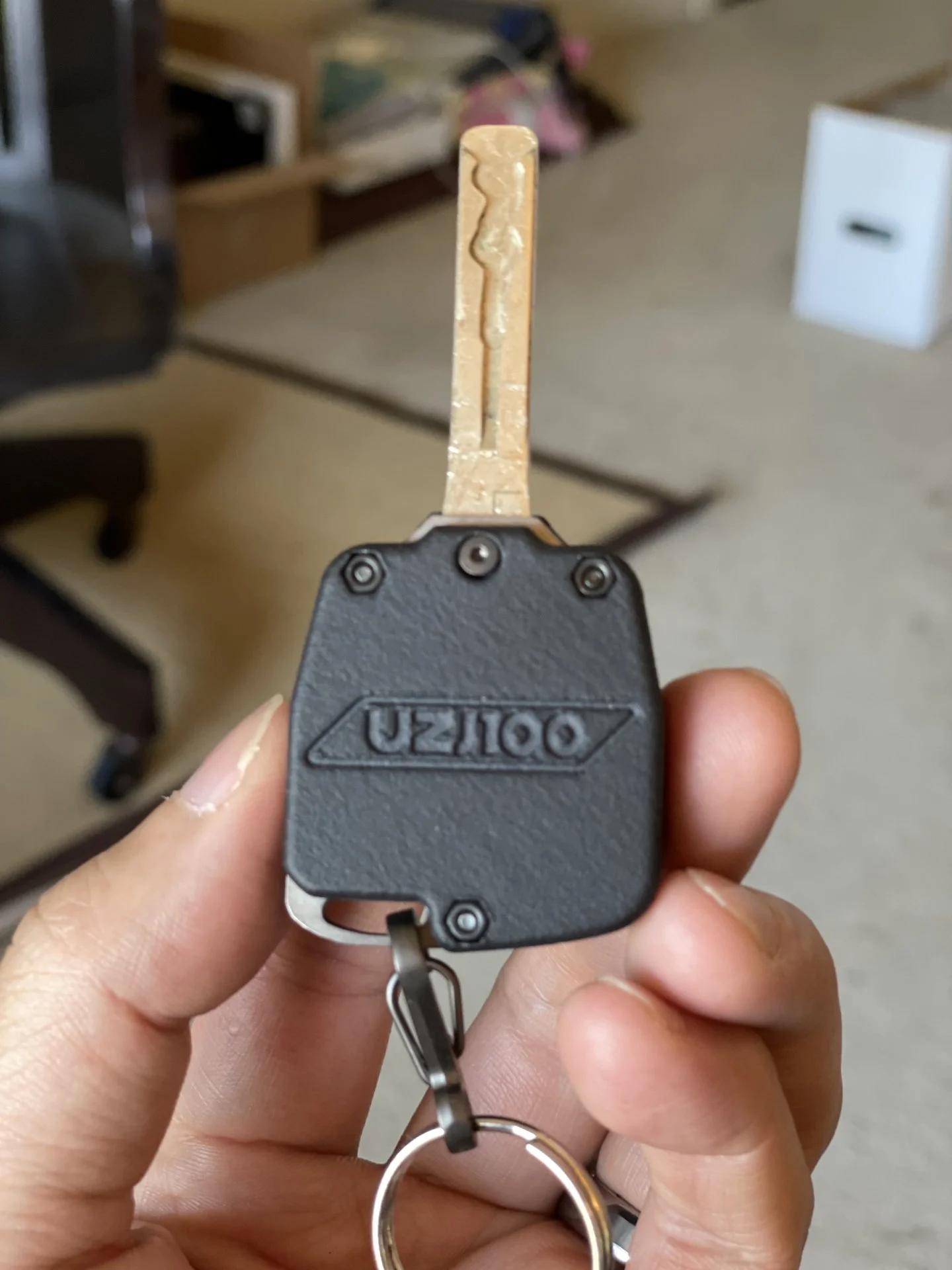

Got my YotaMD UZJ100 key case today. Really happy with it!

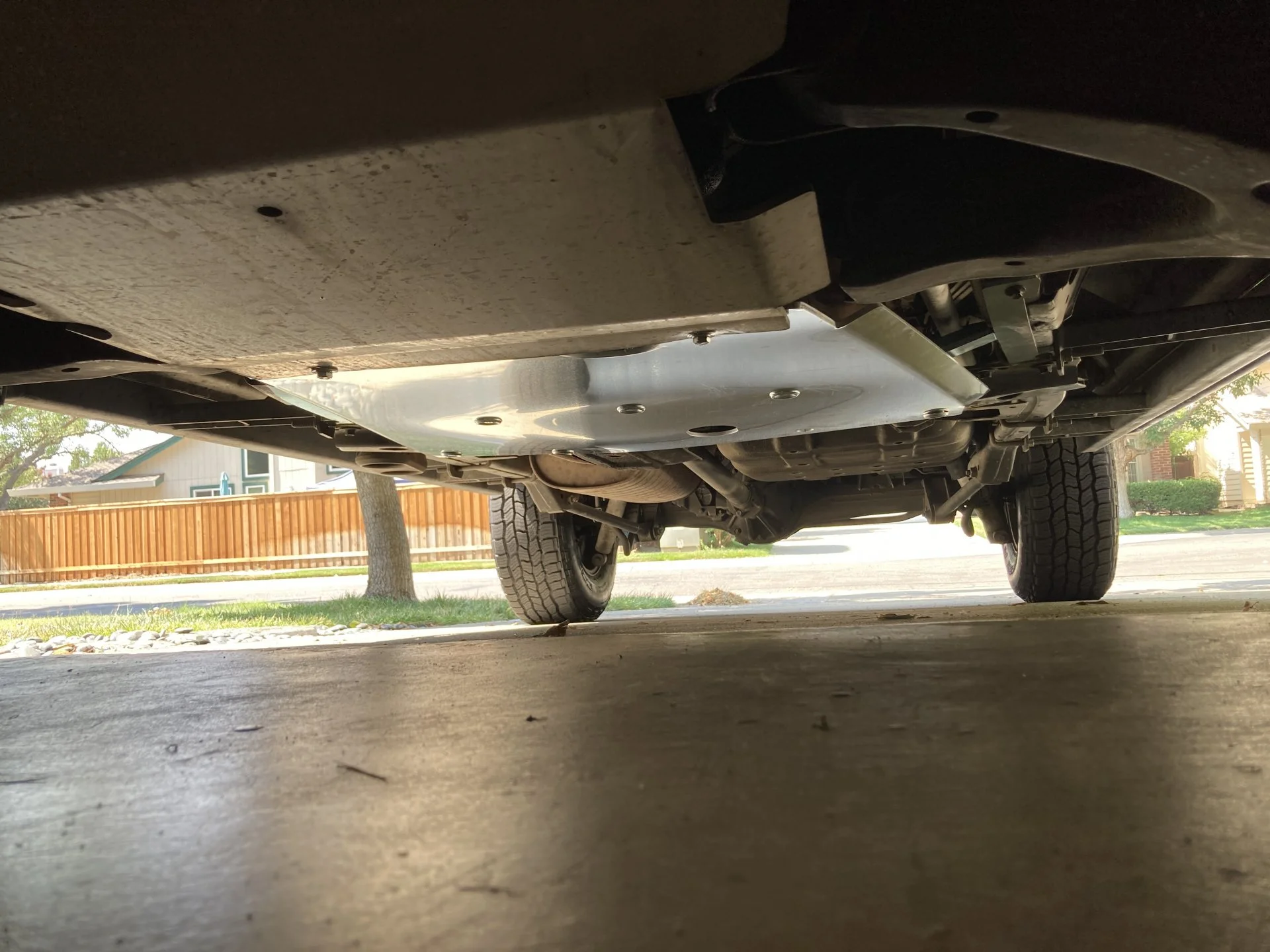

Added middle skid and new rubber...

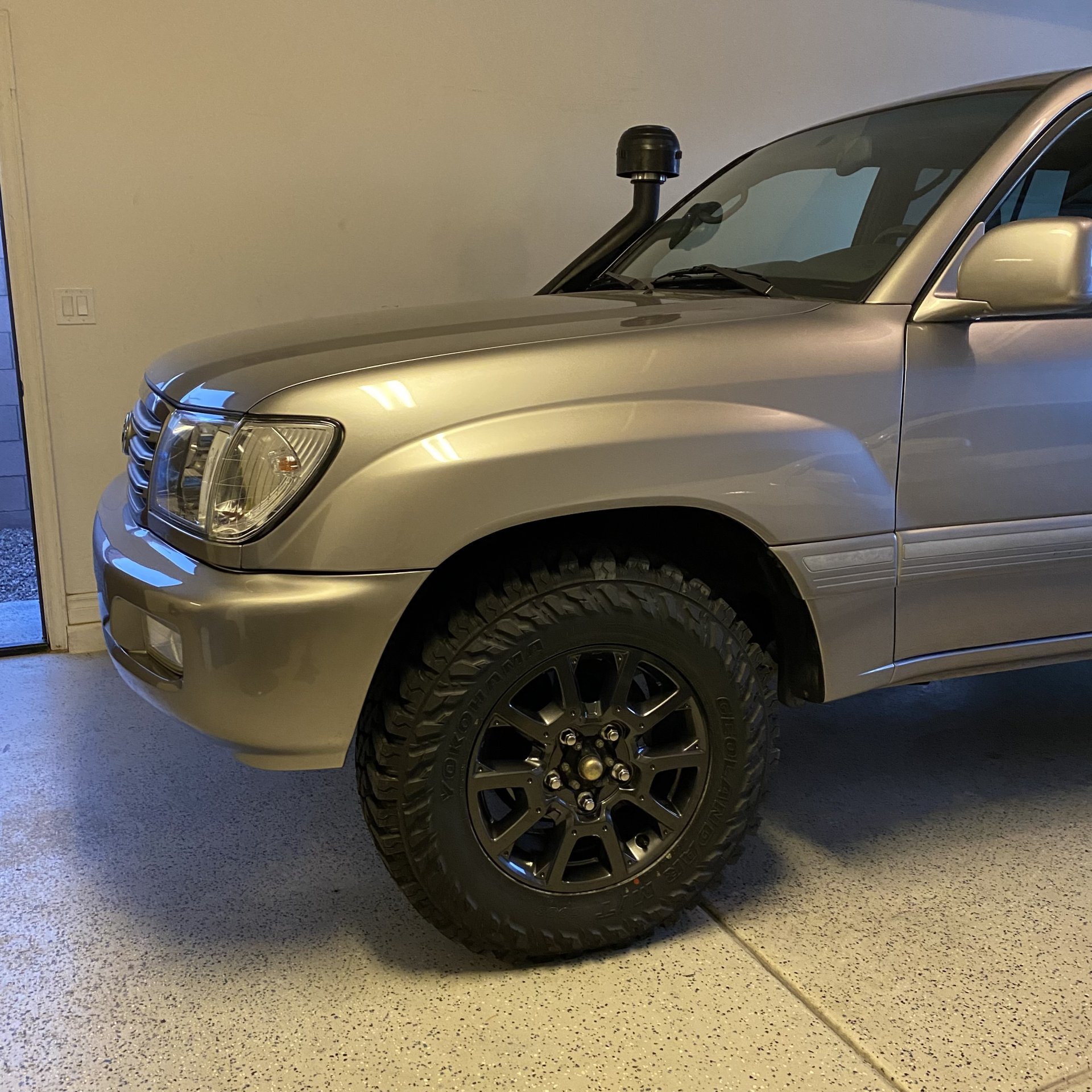

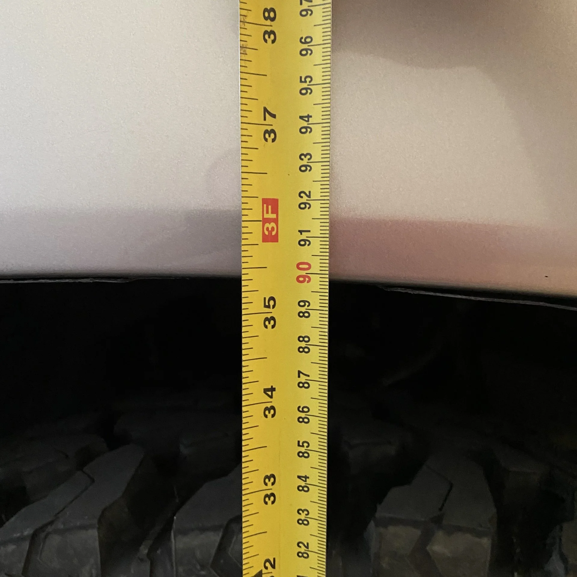

Am I dreaming? Was lifting the front end and leveling out the Cruiser really this easy?
After picking up a 30mm socket from O’Reilly’s, I got to work. All adjustments made with both front wheels off the ground and supports under the frame. Tires were at ambient temperature and pressure was equalized before starting.
Before:
+ Driver's side was 34.5" floor to fender
+ Passenger side was 34.75"
After:
+ 5 1/4 turns on the driver's side and 4 turns on the passenger side netted 36" floor to fender on both sides, which is about the same as the rears or just under
+ Droop range was 76.2 mm which is more than the 55 mm minimum.
Did I do it right?
Alignment up next.
Generally the measurements are taken from hub center to fender edge- before & after. Most do it this way which makes it more consistent for others to reference/compare against- especially to measure droop.
For the droop I did measure from the top of the cap to the fender.
Also now reading up on the rake and what’s ideal.

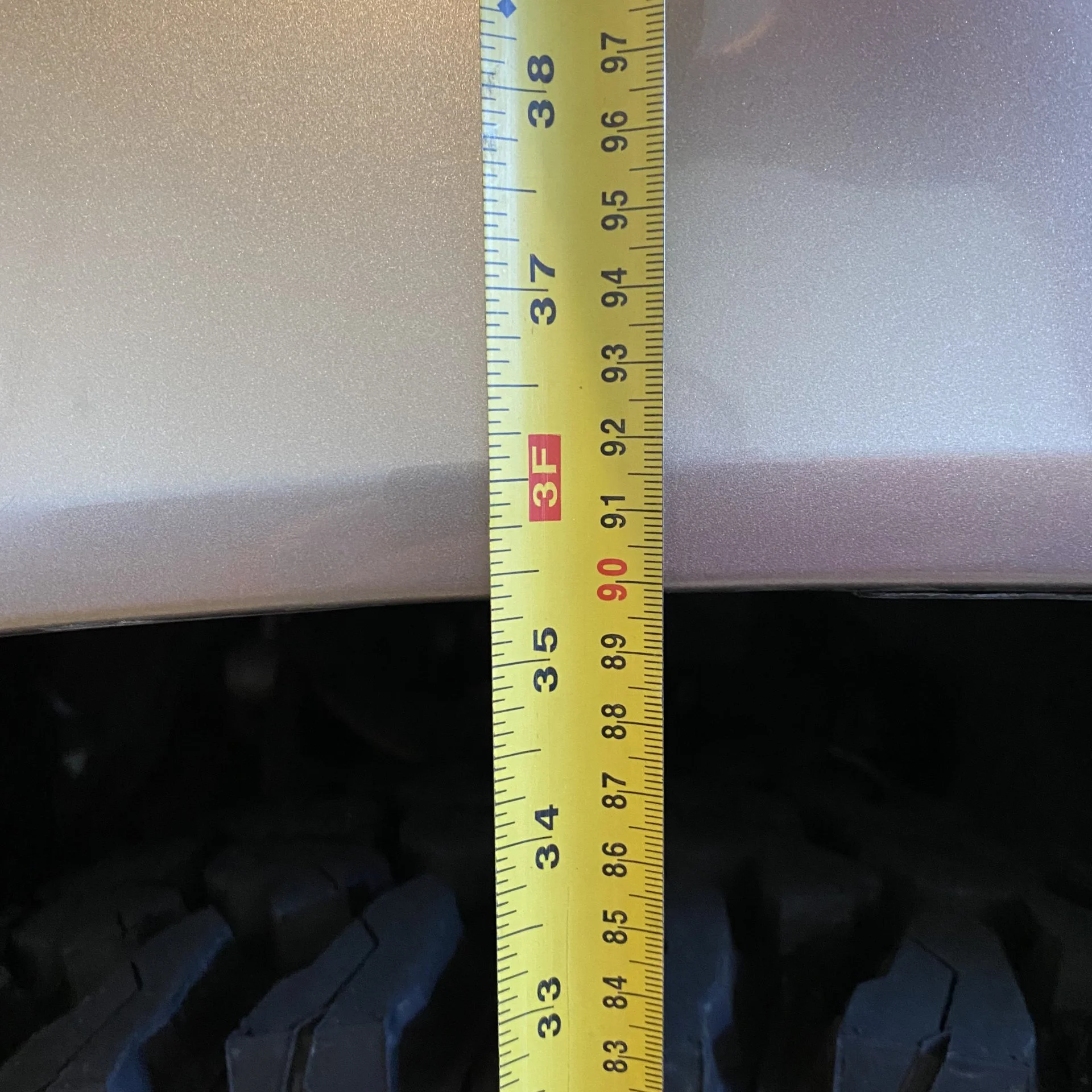

After driving it around last night, I checked floor to fender measurement again this morning…
Driver’s side:
Passenger’s side:
