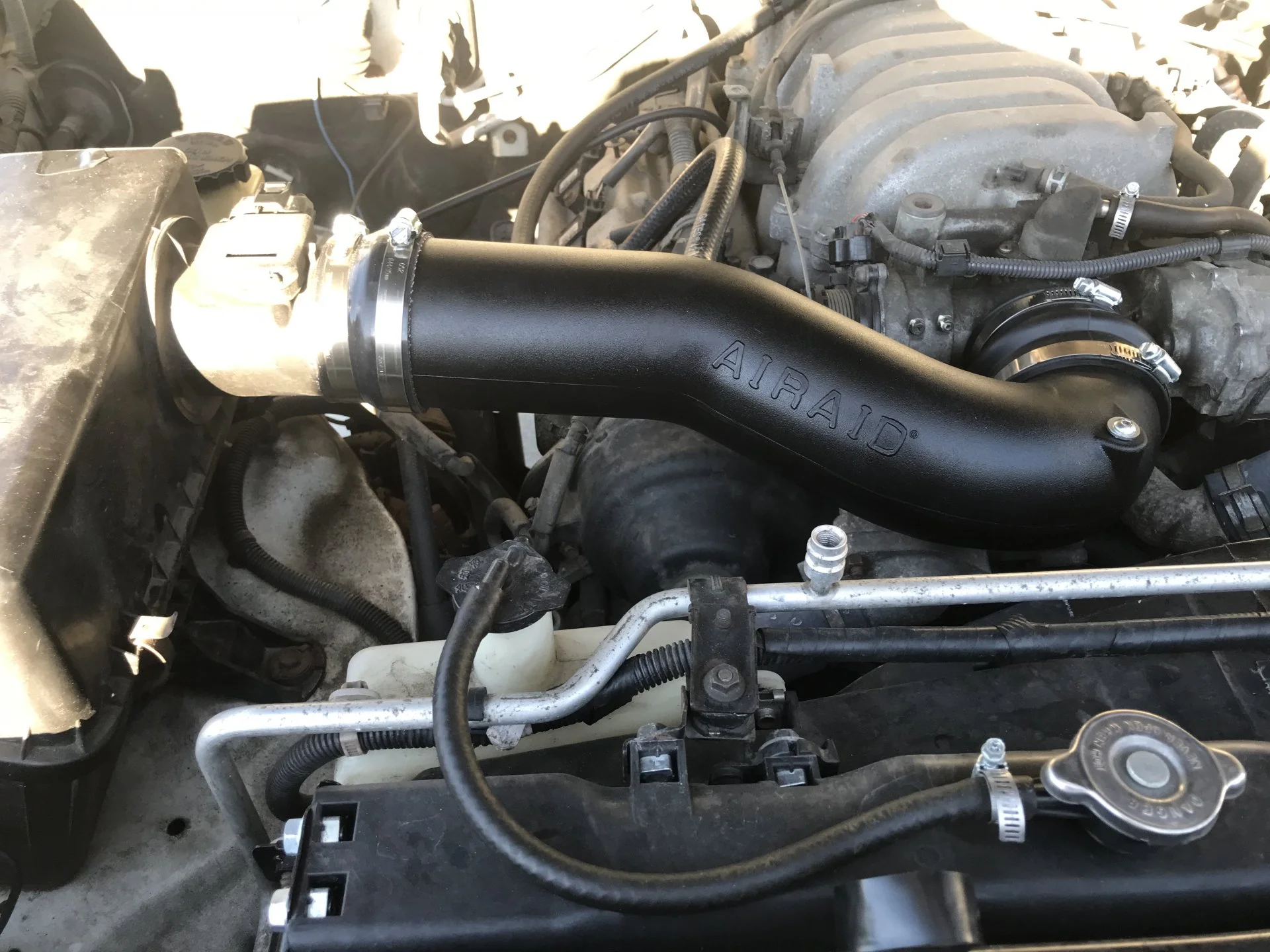

@2020 Rocks what airaid tube did you use, first gen tundra?
Yep, model 511-761. Mounting tabs on my old air intake were busted, had old tubing, etc. The airaid kit comes with everything needed, although I ended up needing a 1.5 ft of some vacuum hose. Cheaper than a new air intake, cheaper than K&N from what I came across.

Before seeing this, I had wondered if there was an intake tube that retained the factory air box but eliminated that labyrinth of air chambers on the factory tube. Thanks for posting this!
so you bought the entire kit and used the stock airbox it looks like. I like that idea

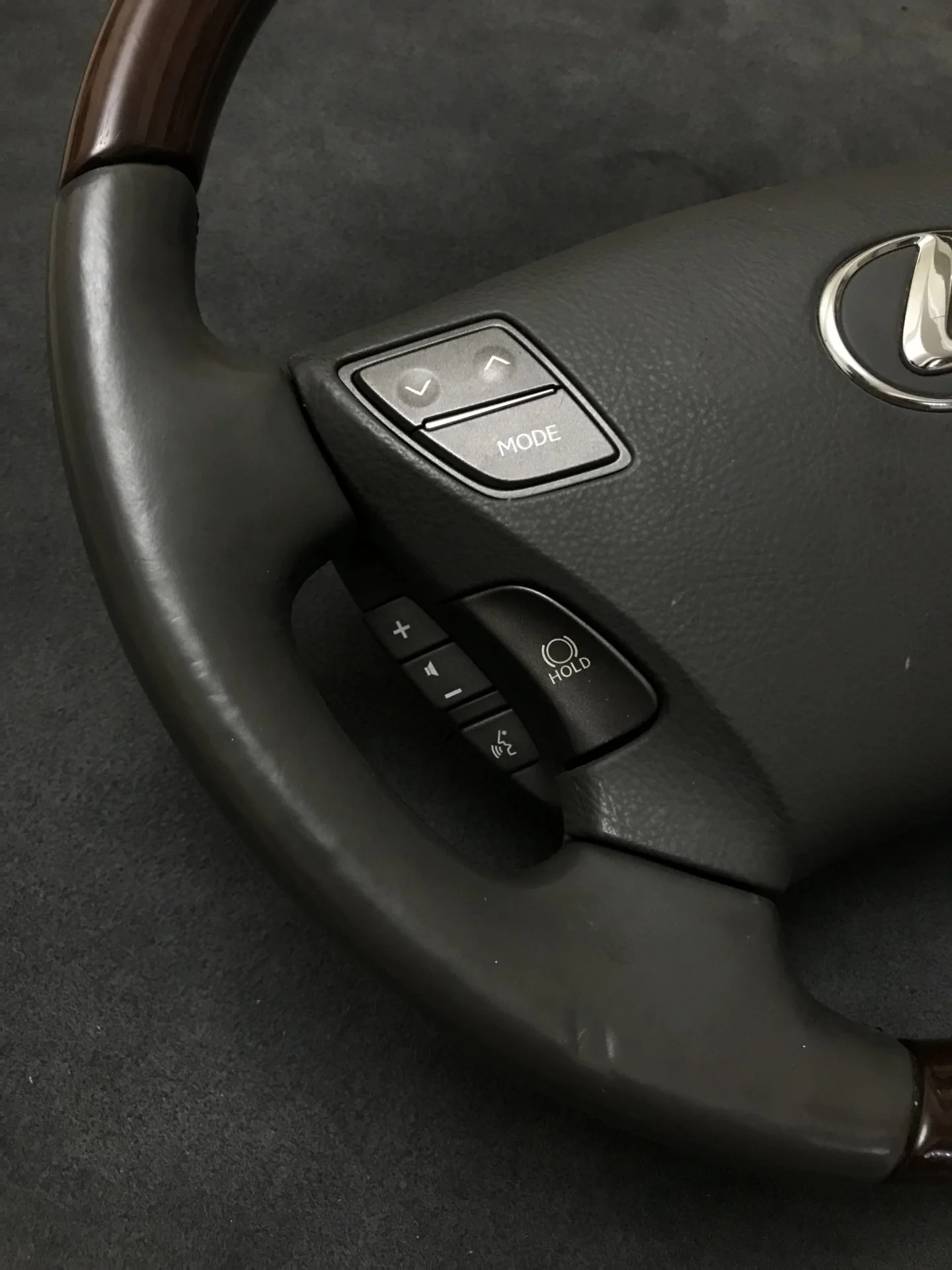

a couple of days ago, I installed a steering wheel with buttons from the LS460/LS600 on a non-restyled LX470 1998-2002. I spent most of my time re-soldering the resistors in the cruise control to make it work. Under the steering spiral wire, I used the factory one for 6 pins. All buttons work except HOLD, DISP, RESET, but these buttons can also be connected to the radio by selecting and soldering resistors. but I didn't have enough of another pin to light up the buttons on the steering wheel. In order for the button illumination and steering wheel heating to work, you need to install steering wheel switches and a spiral wire for 12 pins from LX470 from ~2004.
I also installed a steering wheel with buttons on the TLC100 1998

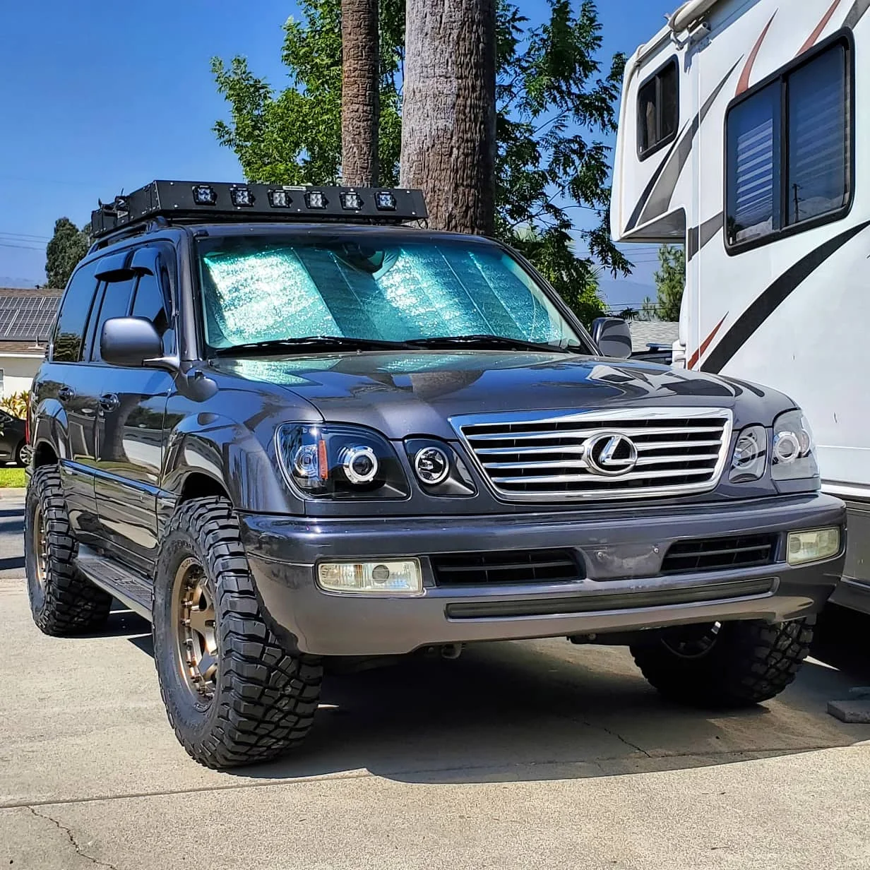

Having said that, here's an update on my LX.

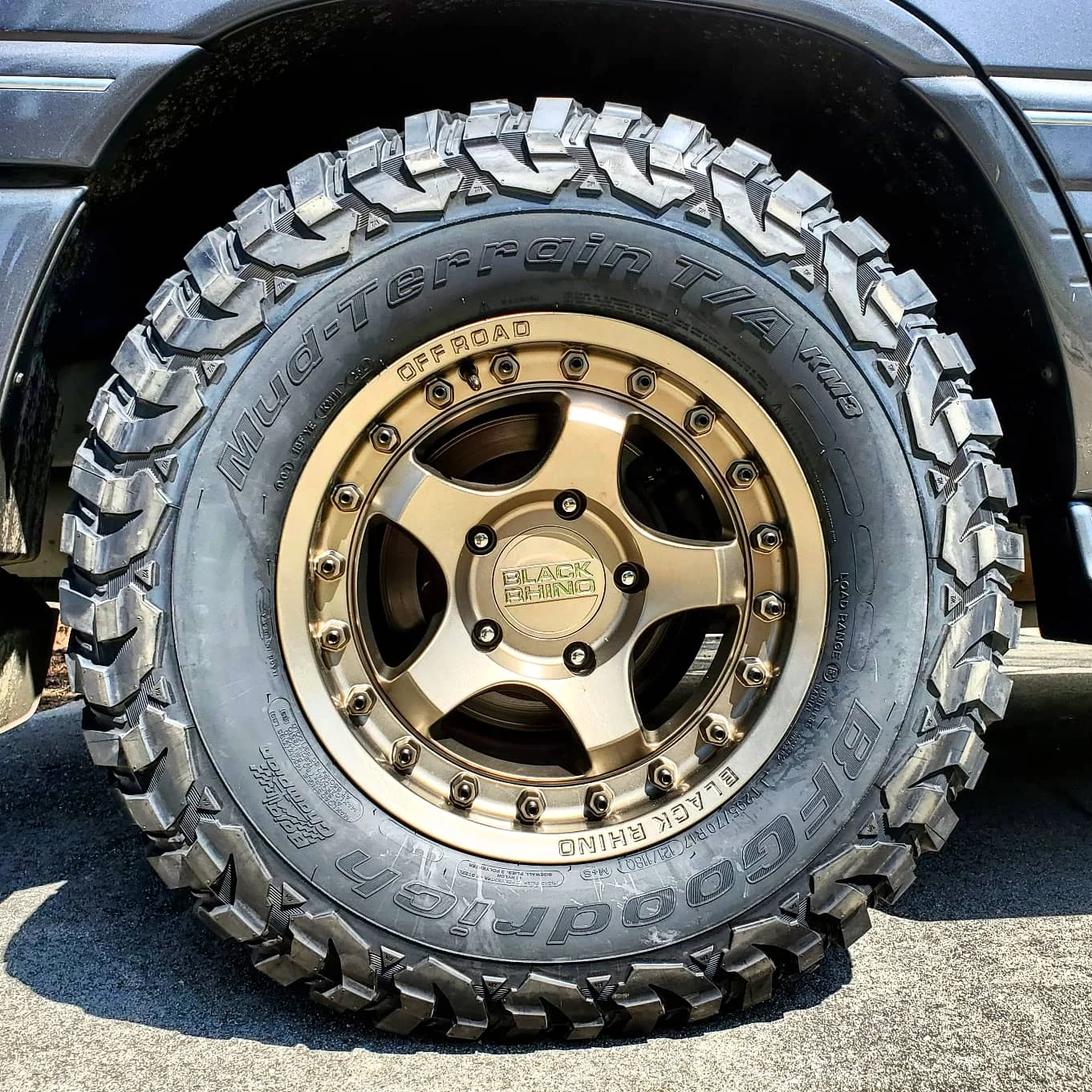

- Wheels/Tires (295/70R17 KM3s on Black Rhino Bantam bronze wheels)

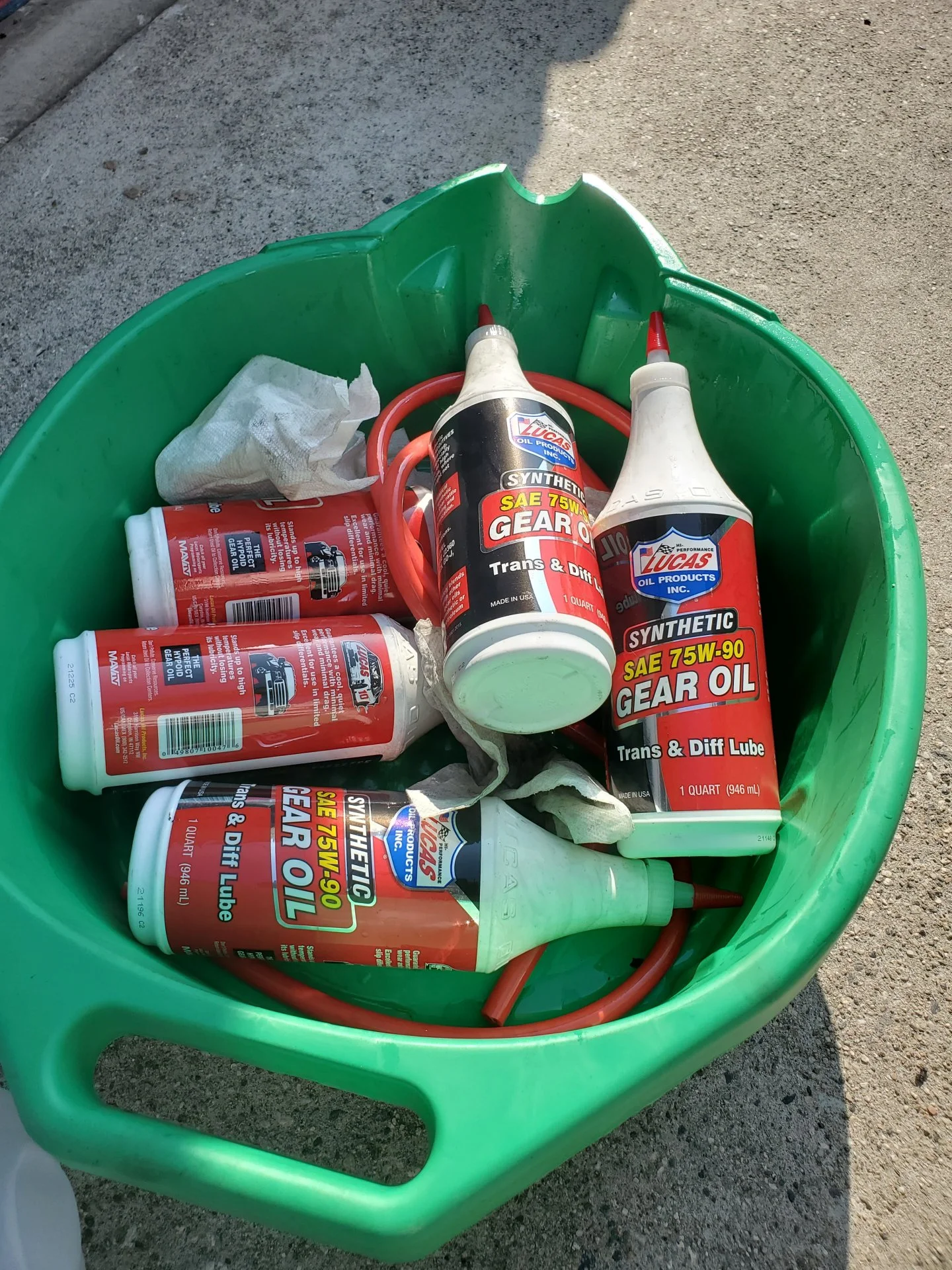

- Diff fluid, front/back/T case

@wormwood Details on your new headlights please?
Of course. I got them from Amazon and they were around $200. They come with light bulbs but I upgraded the low to LEDs. They're very easy to install. With a very tiny caveat, the body trim that surrounds the head lights doesn't have to be removed to pull them out. They slide in/out relatively easy. However, you'll want to use one of those body trim tools to unclip a plastic pin holding the trim down (it's right between the low/high beams. I can show a pic if needed) or you'll likely end up breaking the trim off like I did on one side, lol.
