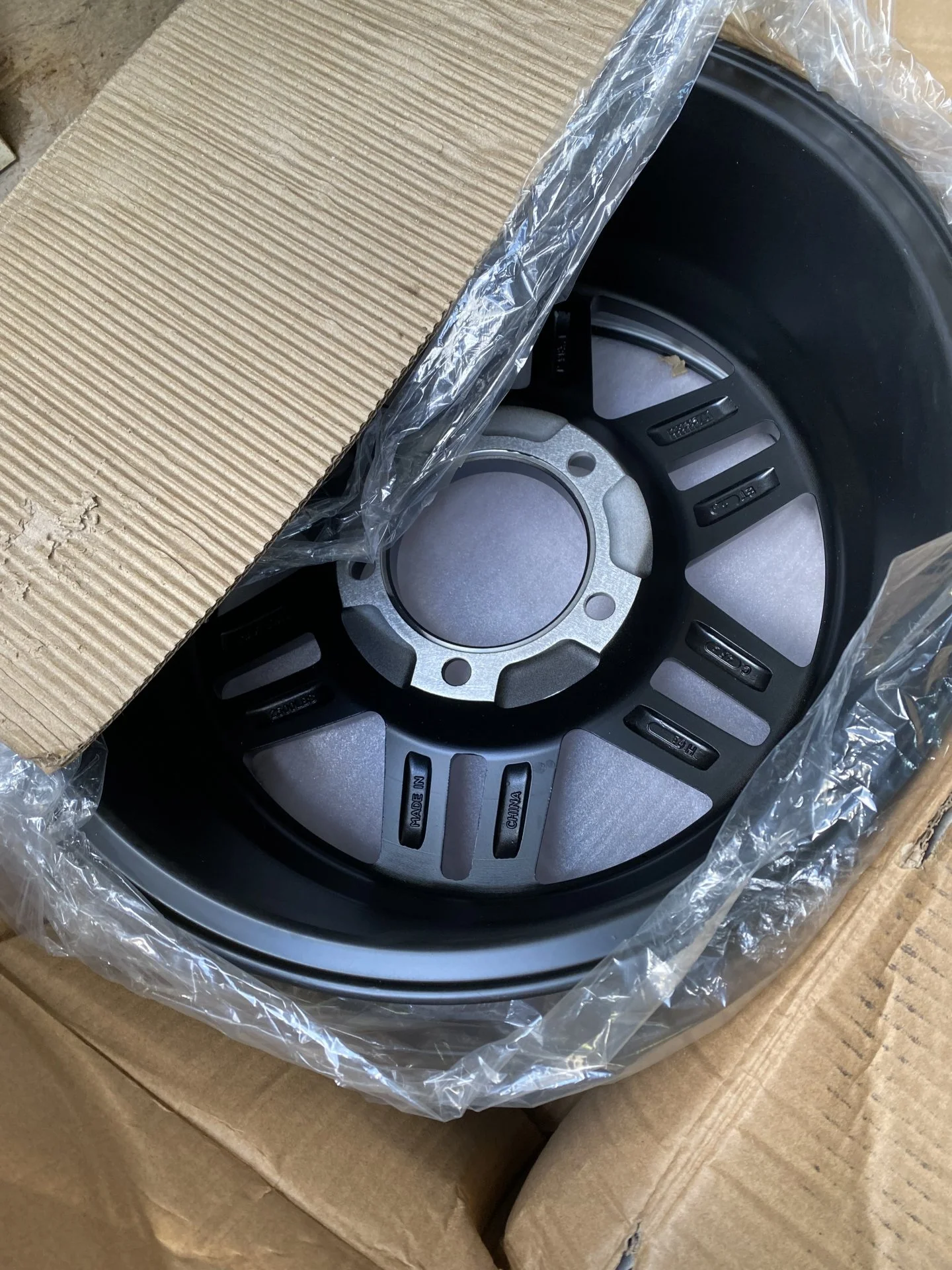

Huge thanks to @BenCC for picking up a spare Six Speed Icon wheel for me.

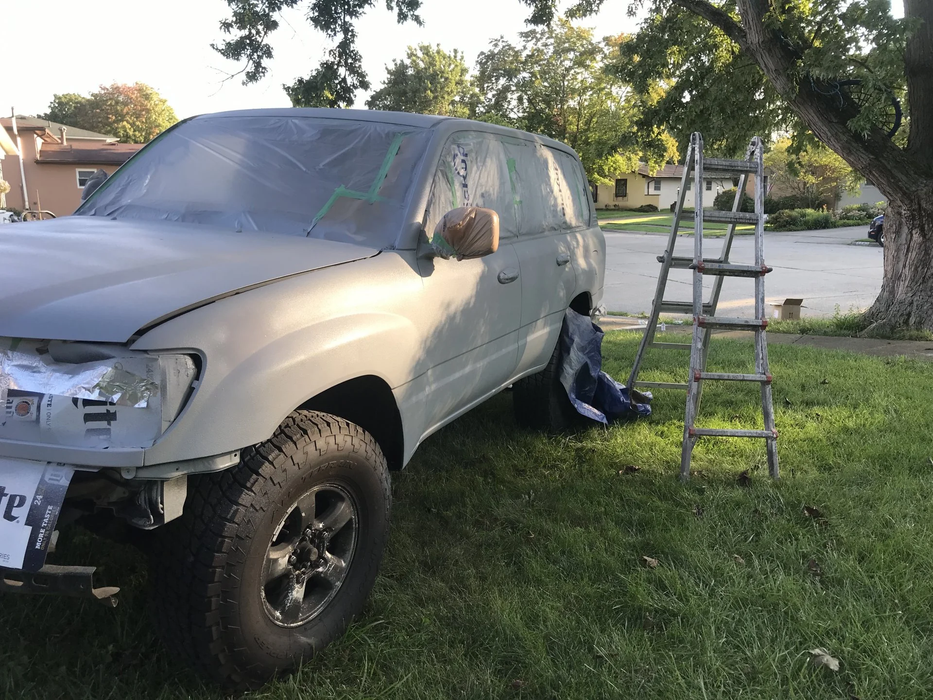

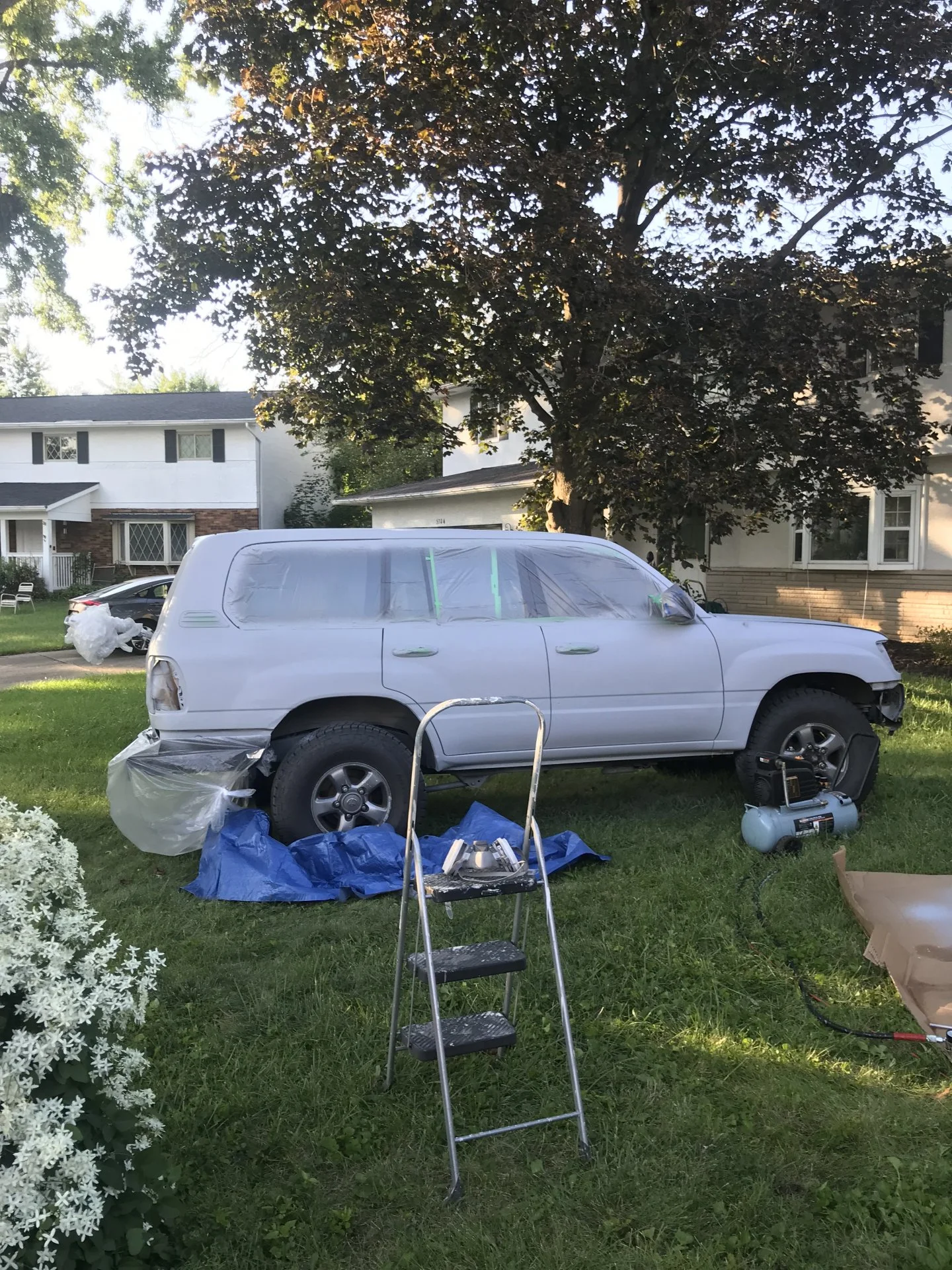

The compressor works fine, i was just too far from the outlet out at the street, once I used a short extension cord close to the house it did it's thing. I did order my kit with their schutz gun, and kept the psi at the gun around 80. So eight bottles is just barely enough to do two thick coats. If you were diligent you could probably do 3-4 light coats with 2 gallons. I will probably end up ordering one more bottle of tint and tintable base, i have plenty of hardner left over. There are some areas around the rear hatch and the foot tread area of the doors that I'd like to mask and spray.
Edit: This was only the body of the truck, I did not bother with the front bumper cover as I have a front bumper kit on the way from Coastal. Glad I did not start with the bumper skin as that was a thought at one point, or I'd have maybe not had enough for the truck to a thickness of my liking.

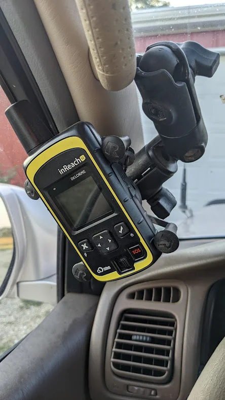

I needed a place to mount my inReach. Couldn't do a windshield suction cup mount since I have ceramic tint on the windshield. Used a RAM motorcycle mount with a M6-1.0 x 65mm socket head screw, 2 nuts as a spacer and some miscellaneous RAM arms I had laying around.
It held just fine over a week of washboard and rough roads out west.
