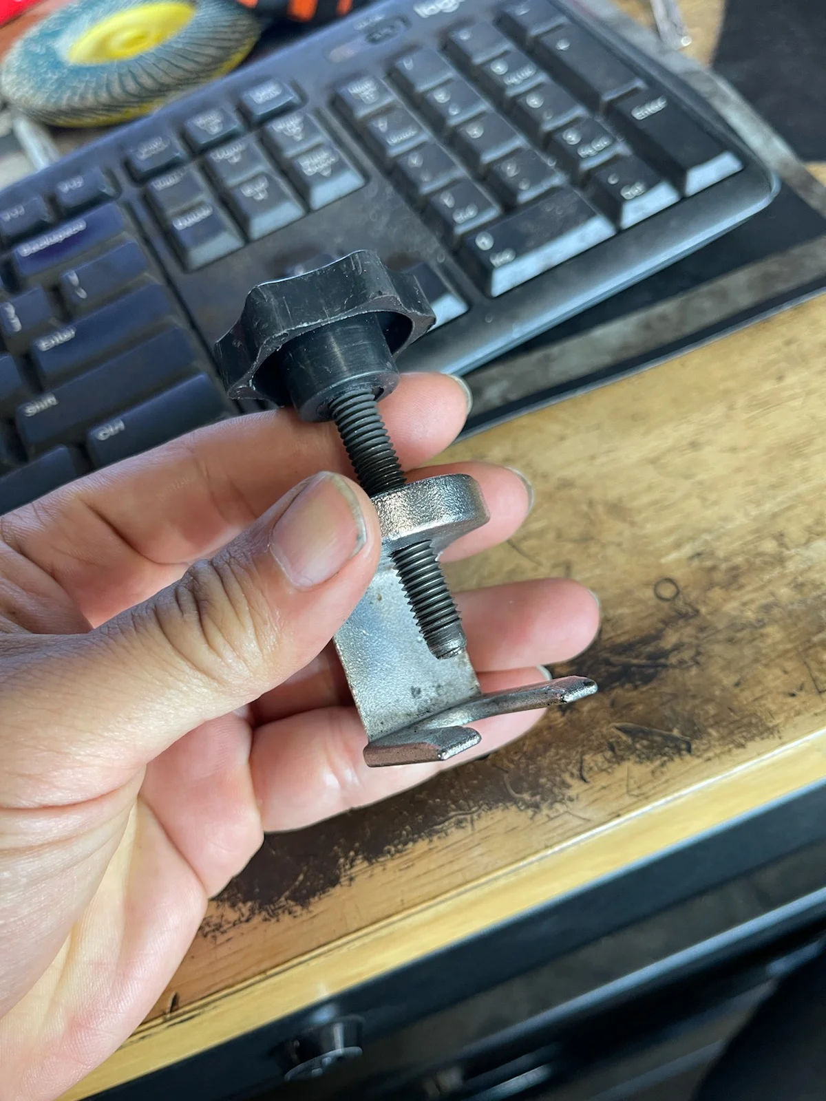

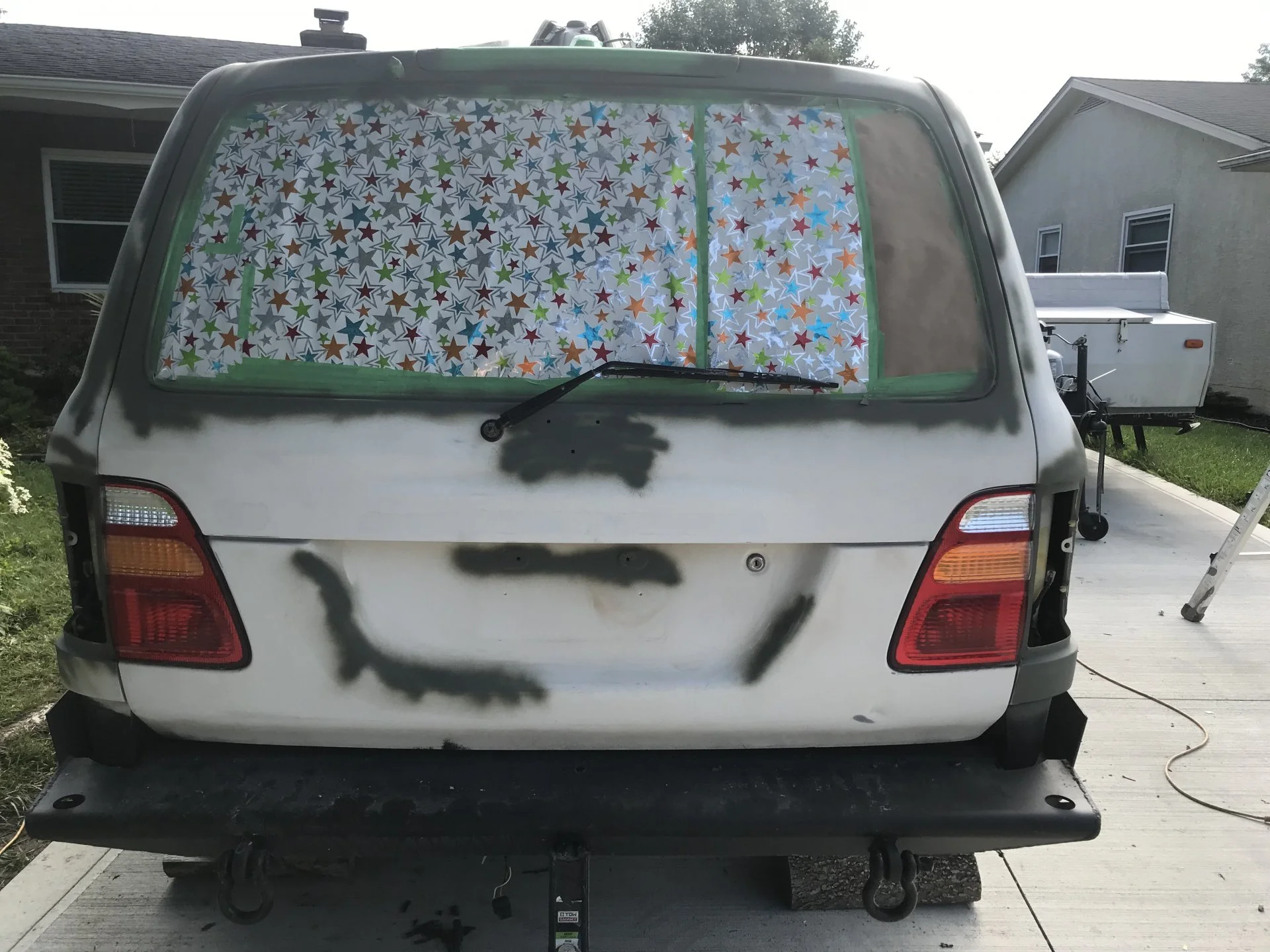

Btw any trick to removing rear wiper arm? I removed the nut but seems to be rust welded on there…
If it is rust welded, it will most likely break :(
Try some heat on it, maybe you will get lucky.
