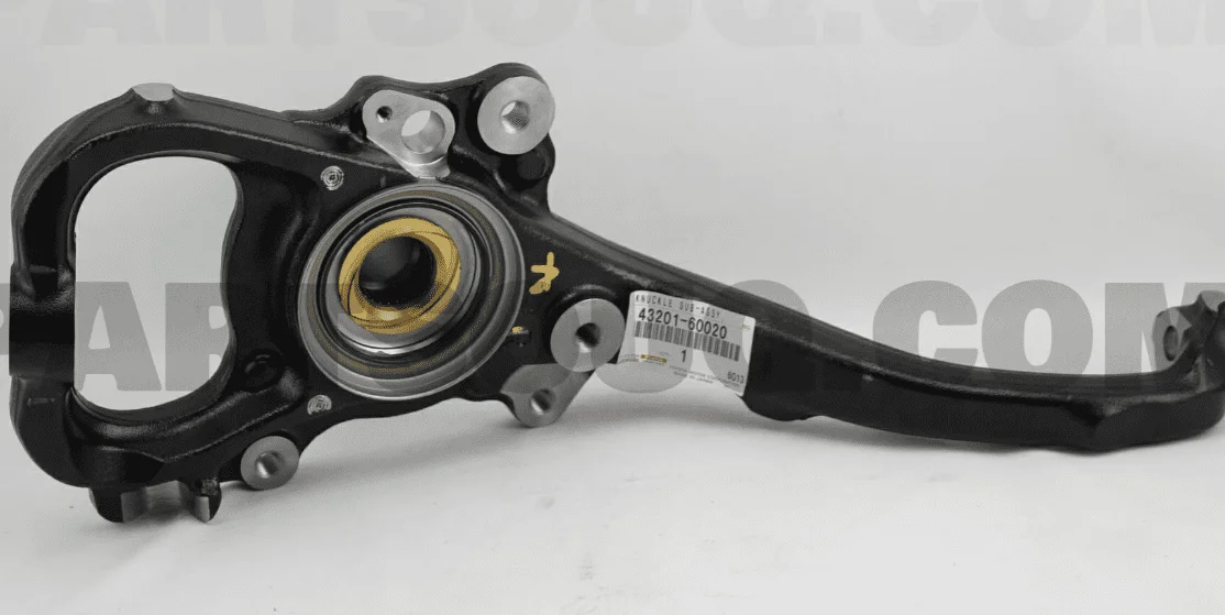

A brand new hub (at partsouq) is only $188 and it comes loaded with new bearings and bearing races and wheel studs and the ABS reluctor ring! When I added it my cart the shipping went up by only $13! ( I am ordering other stuff too!).I properly diagnosed my snap ring failure to a hub/wheel bearing issue. Jesus Holy Christmas what a mess. Looks like a new spindle, axle, hub, flange, hardware, wheel bearings + locking hardware, snap ring, and dust cap are in order.
I'd look at it soon as you can. This serviceable bearing type hub may be stronger than some of the sealed designs common on other cars but when it fails it makes a big mess.What happened exactly? I just started getting a strange humming vibration noise from my front drivers side area and assuming I'm going to have to open all that up and check...not looking forward to it.
do you mean the races are already pressed in?!?! Because that could worth the price of admission right there.A brand new hub (at partsouq) is only $188 and it comes loaded with new bearings and bearing races and wheel studs and the ABS reluctor ring! When I added it my cart the shipping went up by only $13! ( I am ordering other stuff too!).
Steering knuckle on the other hand is much expensive at around $485. When I had a similar issue I found one from a junkyard for under $100.

Yes, the races are already pressed in. I agree it is very attractively priceddo you mean the races are already pressed in?!?! Because that could worth the price of admission right there.
