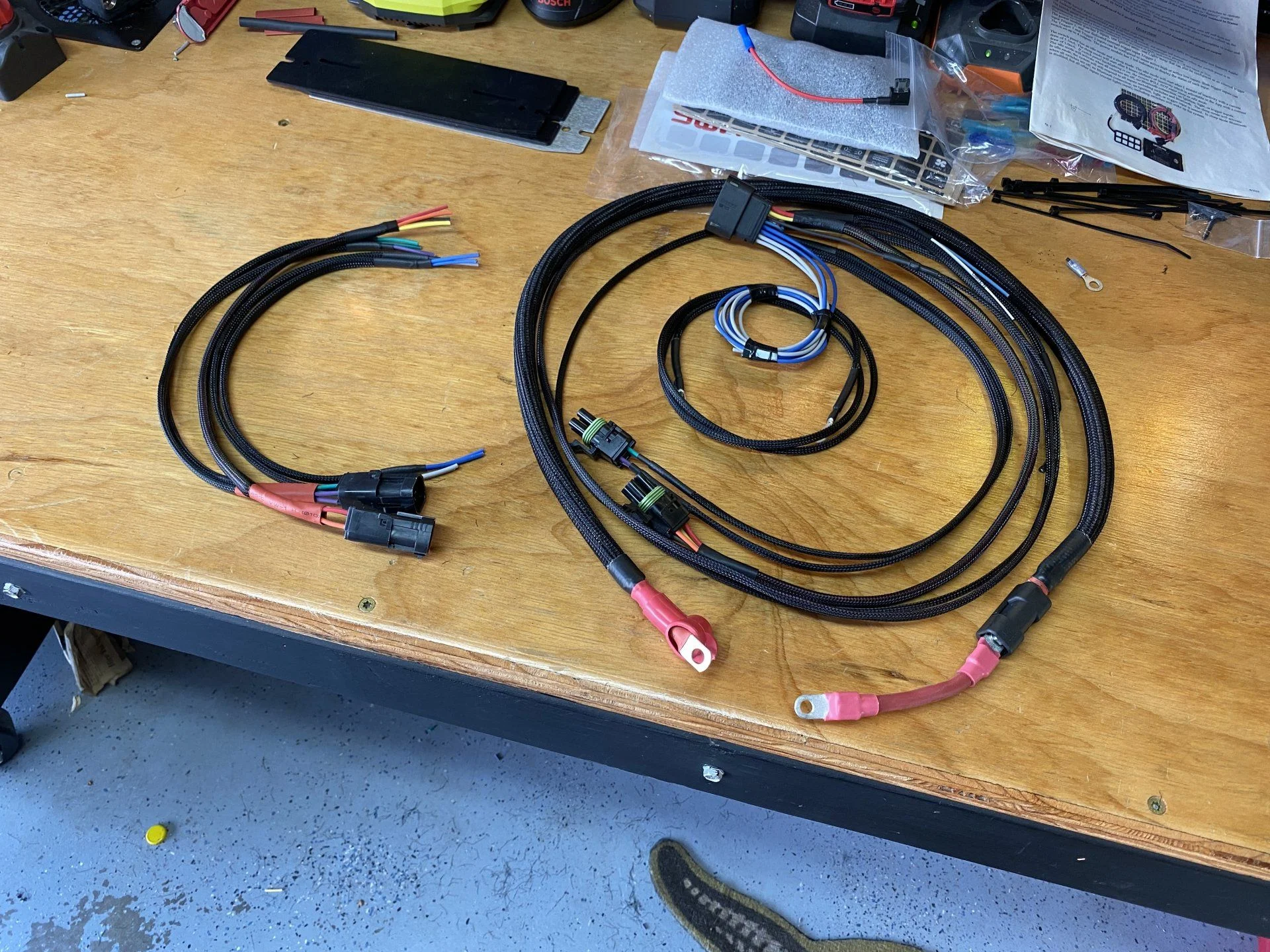

i spent some time making some harnesses for the switch pro. i’ve been pretty lazy as i have the complete dobinsons kit to get installed but dude i talked to about doing it has ghosted so off to a shop it goes soon.

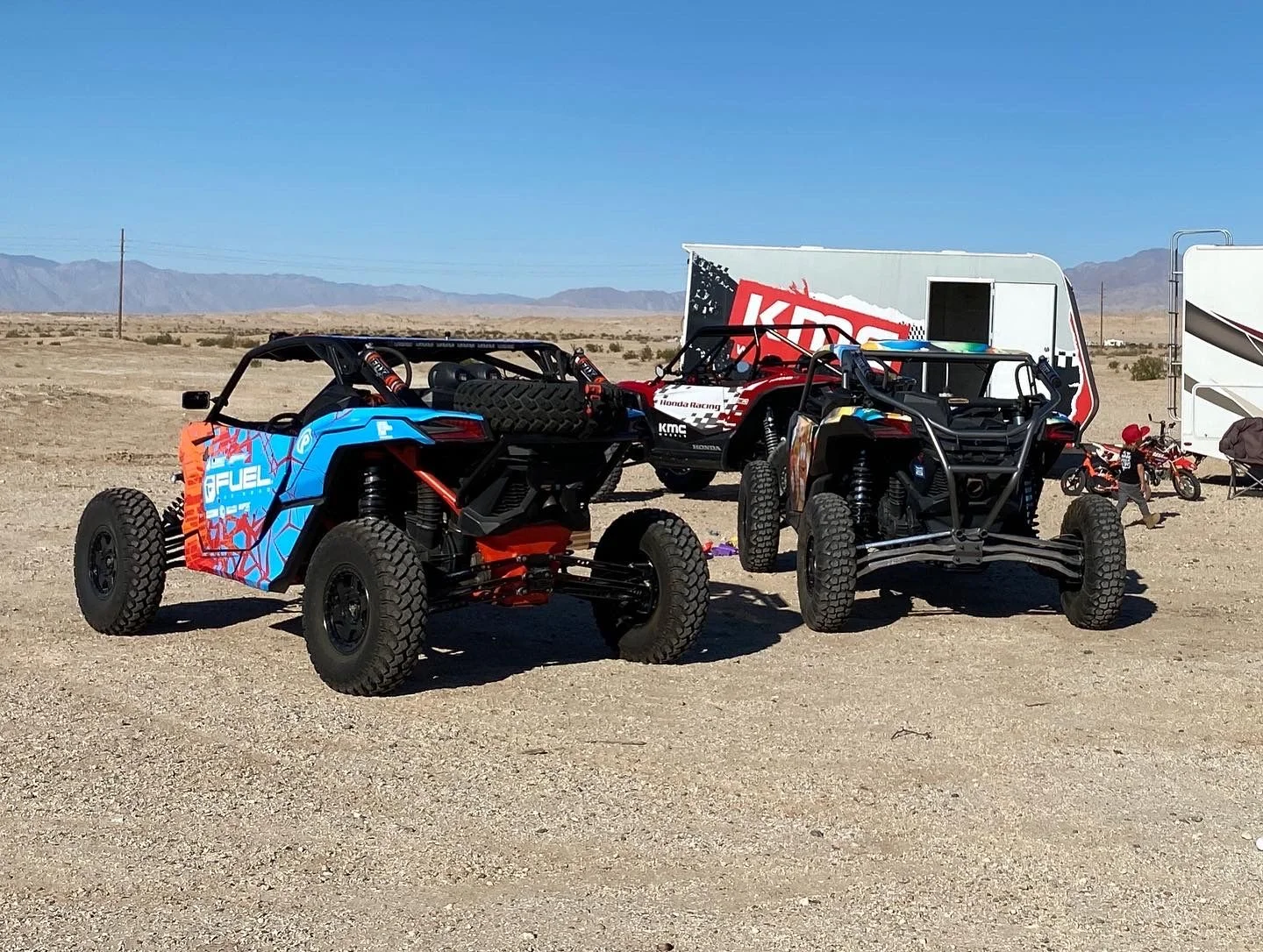

yesterday we took the utv’s out and the car on the right (my coworkers had a rather nasty from diff failure)

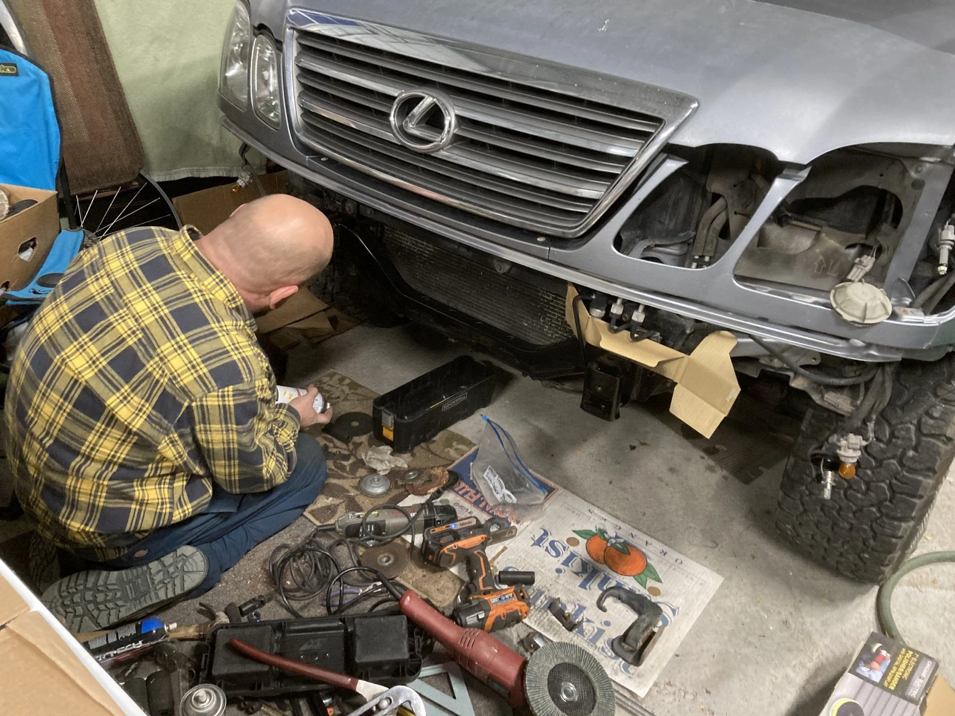

Unpacked the ARB bumper, driving lights, turn signals and installed them with the bumper still in the van. Cut off the lower end caps and painted. Might have got it all done this weekend, but when your water main starts leaking- there are other priorities...

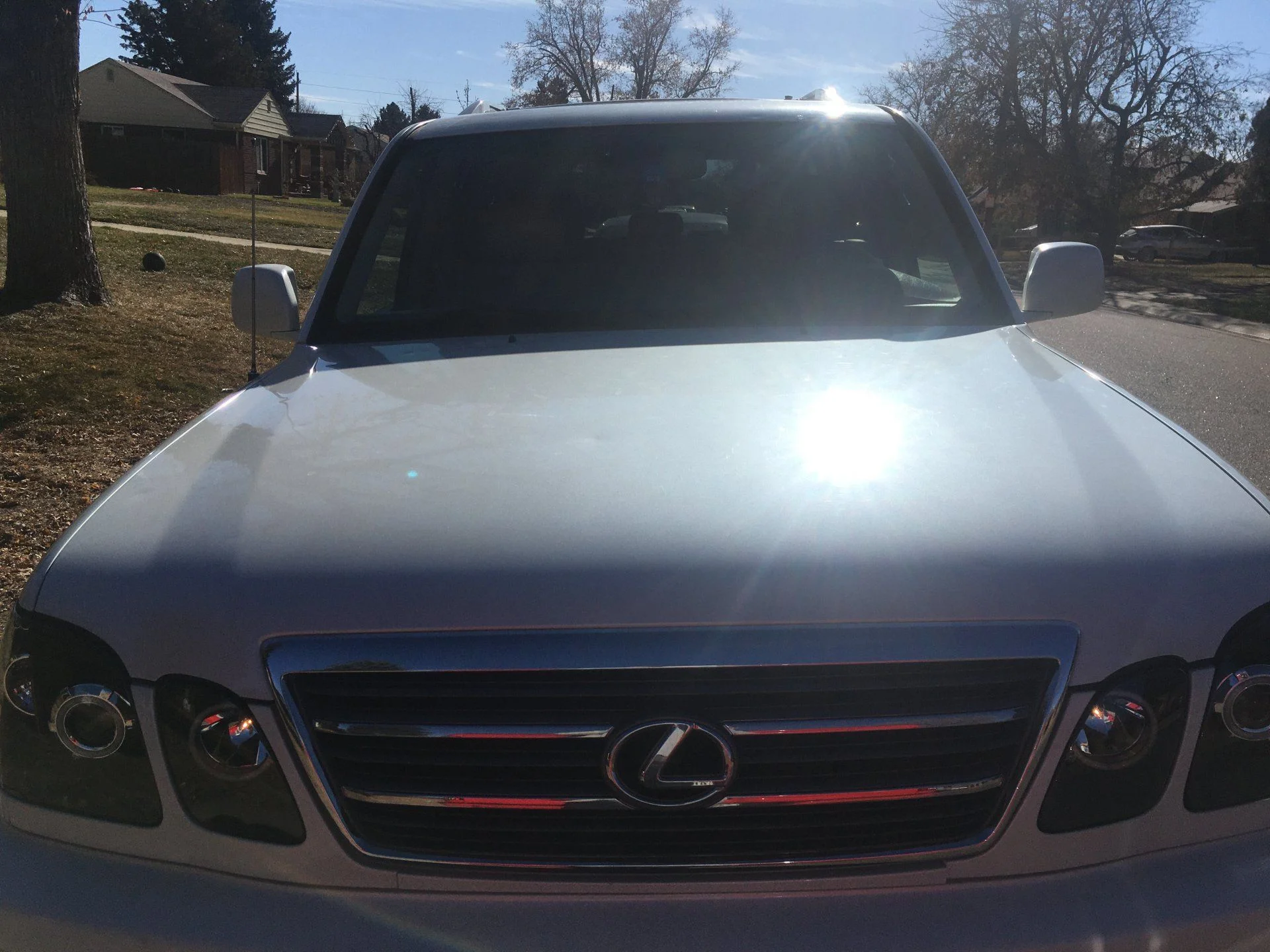

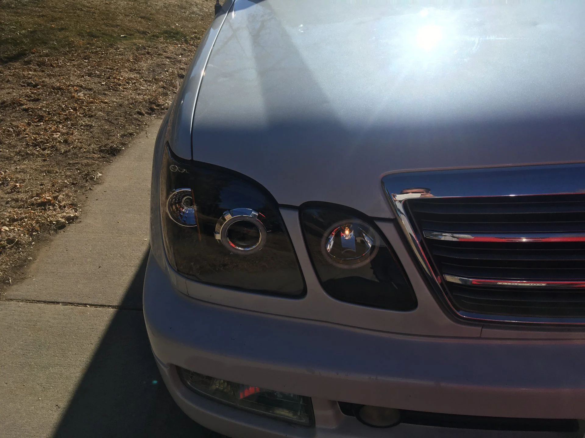

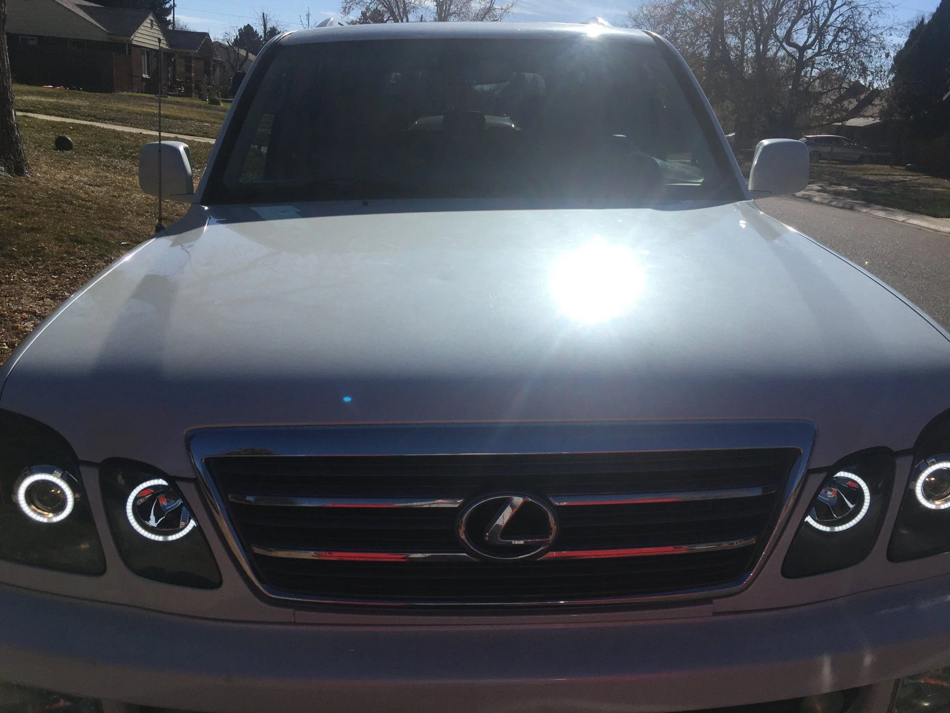

Installed some Anzo headlamps with Silverstar Ultra bulbs. These aren’t as nice as some of the HID/LED conversions folks on here run or offer, but they’re not a terrible alternative. The LX needed some new headlamps and OE replacements are a bit rich, these are in line with other aftermarket options with regard to price. There is a little bit of wiring involved for the halos and the bulb styles differ from OE (H7 low, H1 high.) All in all, I’m happy with the result and the black housings play off the white pearl well, the halos look pretty good in person. Let me know if there are questions.
Any night shots of the lights, and their pattern? I really only need one light, but agree OEMs are pricy. I could buy the pair for way less than one OEM.
I can get you some, I still need to adjust them a touch. Out of the box they were aimed a little low, so I need to bring them up a bit. I can tell you they’re markedly better than the stock lights were, the cutoff is much more defined, I also think the Silverstar bulbs help a bit.

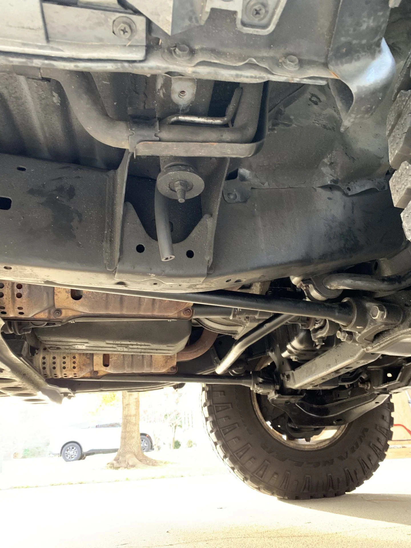

Adjusted my torsion bars to compensate for the increased weight up front. I’m now at 61mm of droop and 21.2” from fender to hub center.
Also installed the Cruiser Garage A/C drain relocation kit. Sure enough, the swaybar bolt directly under the stock drain location rusted up and I rounded it out while replacing my swaybar bushings. No more worries with the new drain location.
