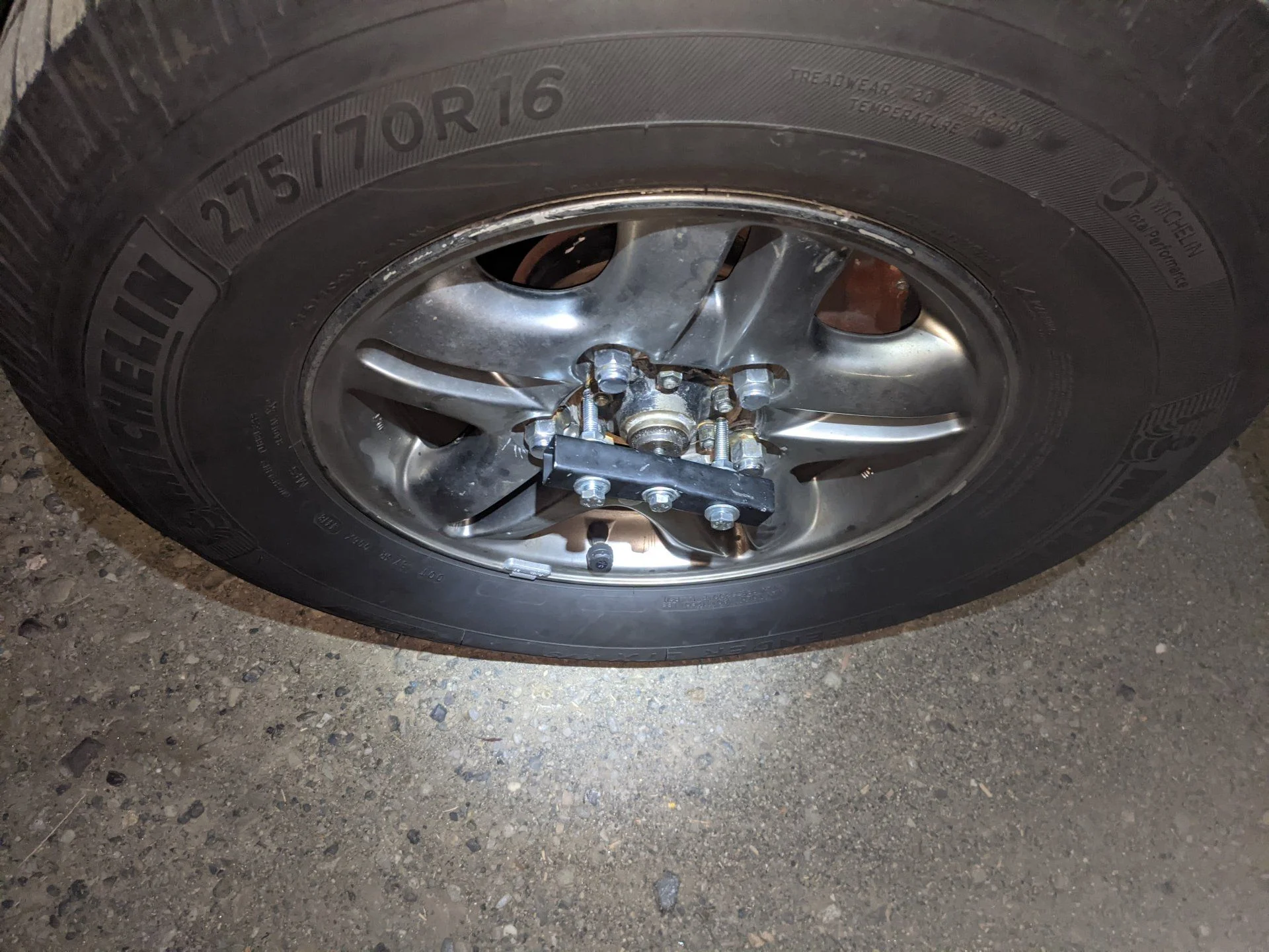

Towing from OR to NM, the DS snap ring broke and the end of the axle got chewed smooth. Am I stuck? NOPE
I installed @TheForger axle pulling tool.
Will I make it the last 950 miles without issue? We'll see!

Yes, driving with it installed. So far so good.
Snap rings won't work anymore. That end of the axle is worn completely smooth. There is no groove for a snap ring anymore.
Came down I-5 and cutting over to I-40 passing Bakersfield currently. ABQ is the end point

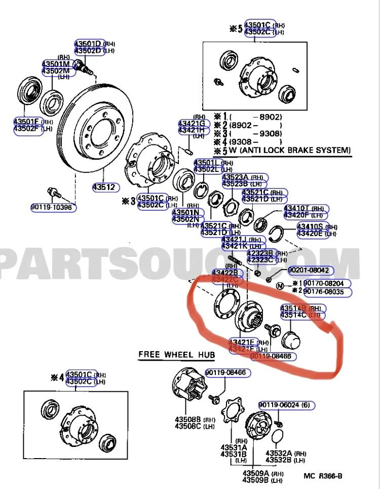

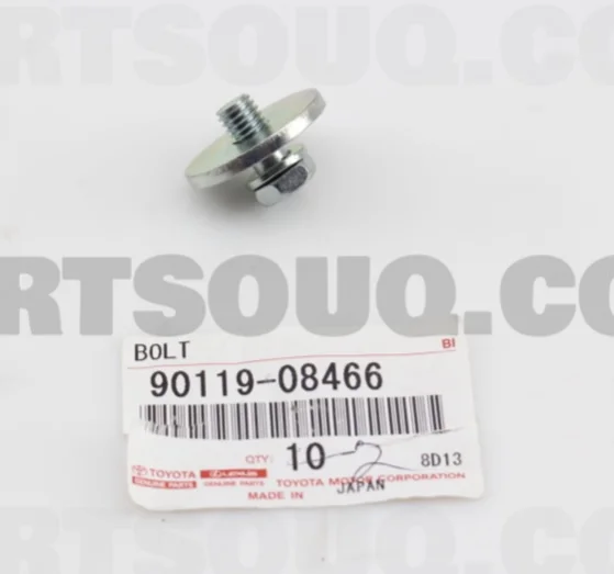

Before Toyota got all stupid with non-serviceable wheel bearings on 4Runners and Pickups, they used the same hub and hub flange design as what’s on 80 and 100 series Cruisers. As part of that design, all 89-95 4Runners and Pickups had both a circlip on the CV axle AND a “backup” bolt with washer in the end of the CV axle, under the dust cap.
@ramangain You can try buying this Toyota bolt with washer from a dealer, but no idea if they keep it in stock. It will screw into the end of the CV axle but I don’t know if the washer diameter is large enough to keep the axle from pulling out, because those early 4Runner/Pickup CV axles were 27-spline rather than the 30-spline that 100s use.

I'm towing a 6k lbs enclosed trailer with the 01 LX. 400 miles to go to ABQ. @TheForger tool working PERFECTLY so far.
Well I am very happy to hear that it's helped you get closer to home, I hope you can make it the rest of the way safely! I honestly never thought about using it for that purpose but now I will throw one in my recovery bag as an emergency trail/roadside fix. I'm guessing you just tightened everything down very snug and sent it?? Good thing the holes are centered so it shouldn't make your wheel too far out of balance
It's working like a champ. This newfound use should be near the top of the marketing highlights.
I just passed Flagstaff. Without this tool, I'd still be stuck at a Toyota dealership somewhere near Bakersfield, California, with my dog and enclosed trailer.
Taken last night. Looks the same today just dirtier
