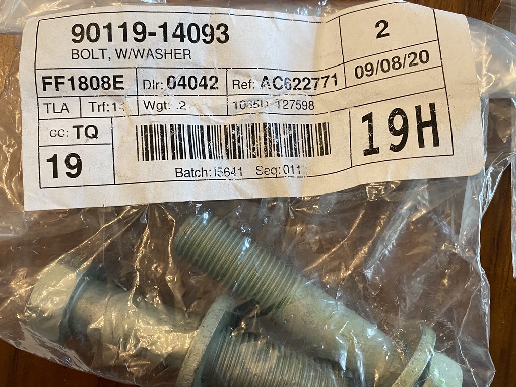

Any chance you can post or pm me the part #'s of all the hardware you're replacing with the shocks?
Yeah, no problem! I can do it a little later today.
Ok, I think these are the correct lower shock hardware pieces.... I could be wrong though but its what I ordered. The shocks came with the top mount nuts and new rubber bushings.
