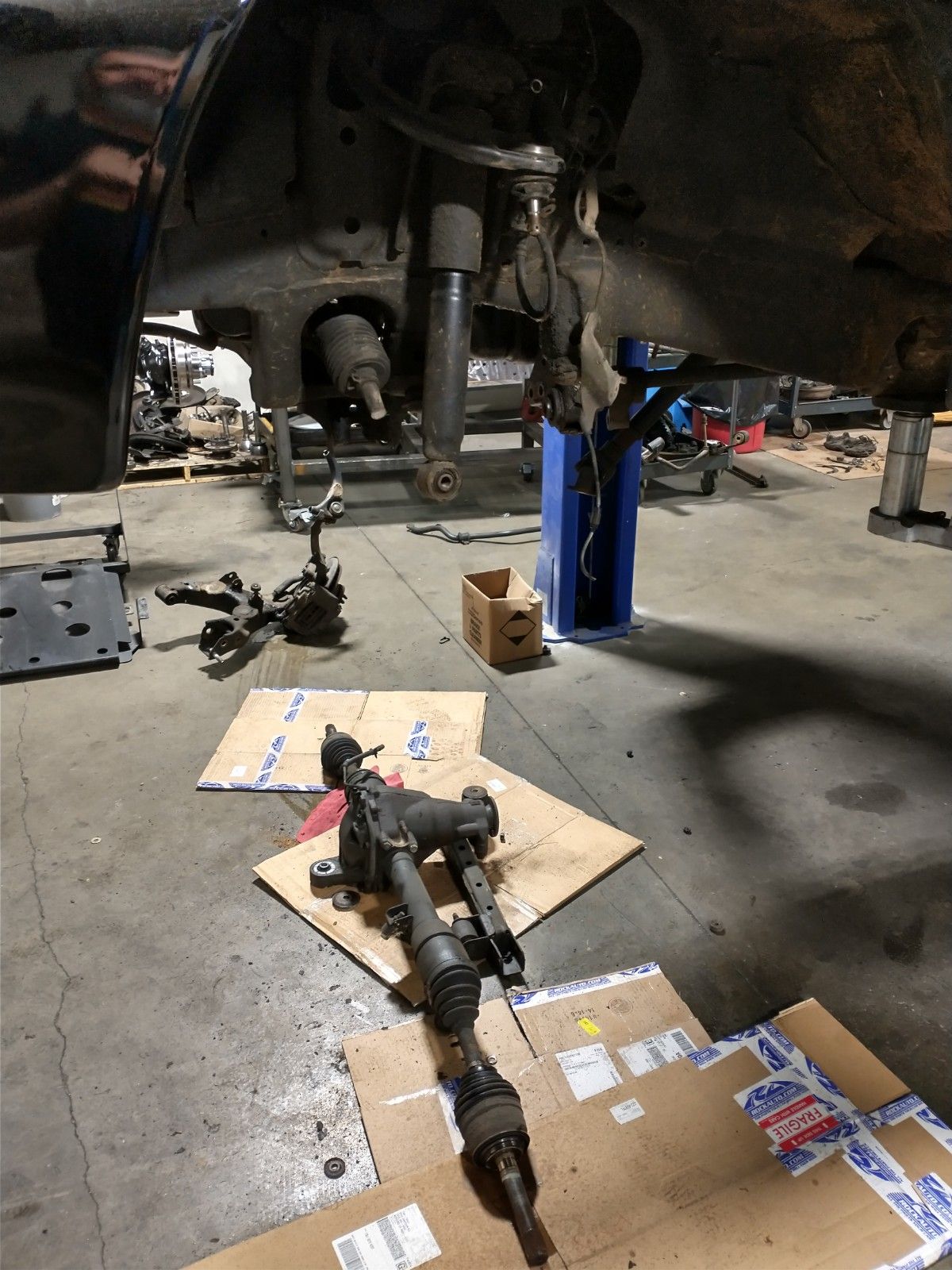

Replaced front diff/cv oil seal. I messed it up during cv reboot over 6 months ago (probably) or it's just age.
Found this crank pulley tool perfect fit to push new seal in

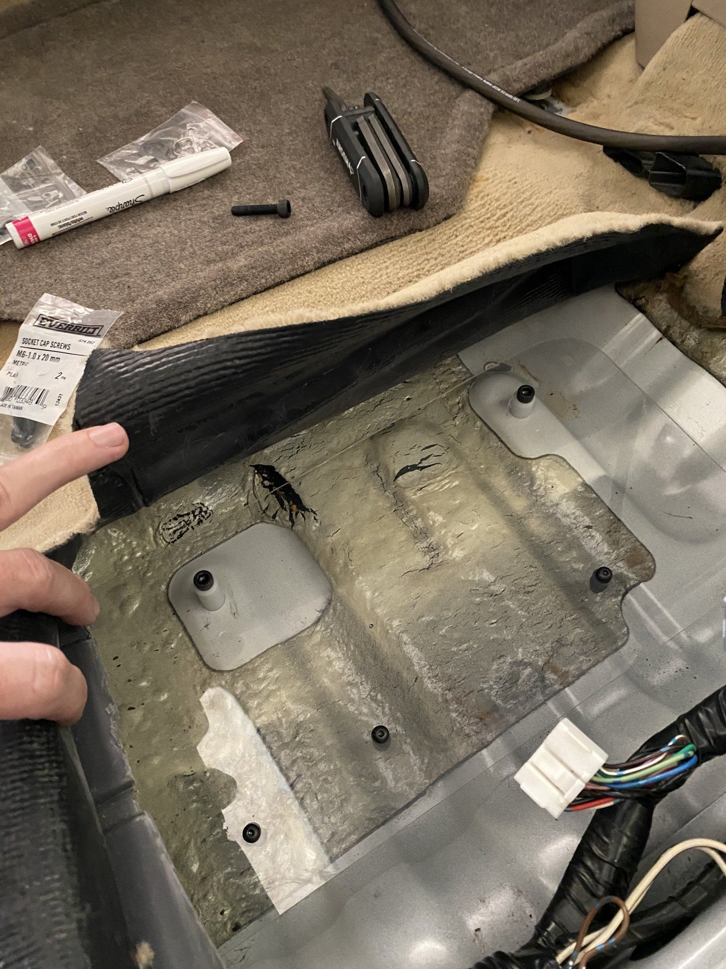

I also cut up an old camping pad and put it under the carpet for hopefully better sleeping. I'm hoping this will reduce the lumpyness of the seat mounting brackets by rasing up the floor around them.

Was it hard to get the carpet back down after you put the foam pad down?

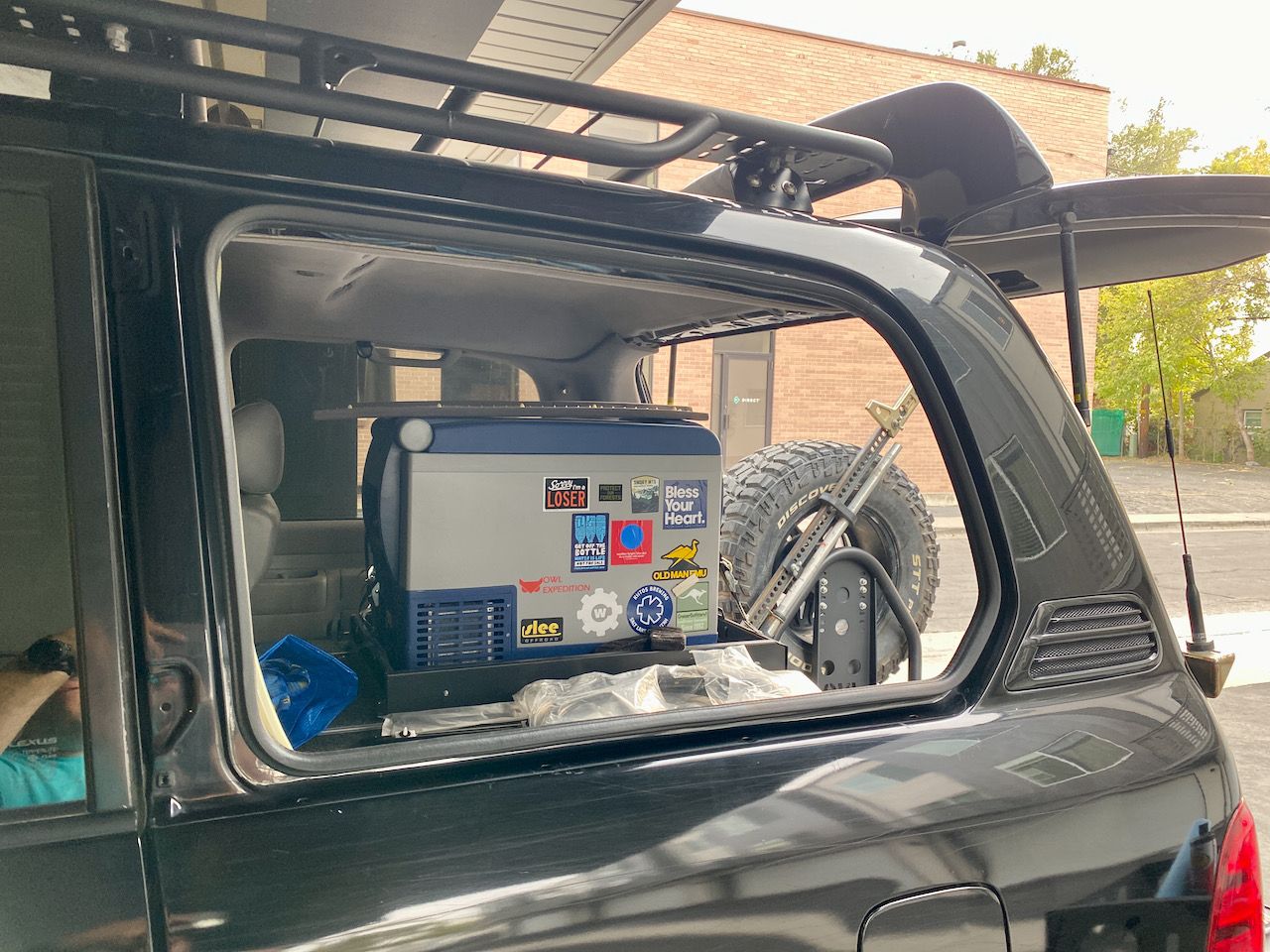

Time for new window seals and trim in the cargo area. Couldn't stand the squeak any longer, and couldn't see the point of not replacing the seals while I had the interior somewhat torn apart. Cry once, as they say. It was actually easier than I anticipated...I think I had both sides done in under 2 hours.
All three front hinge nuts were loose, and one was missing entirely.
The squeak isn't totally gone—I think perhaps the hinge next to the motor has worked loose over time. :bang: I didn't have the good sense to test drive it before reinstalling all the interior trim.

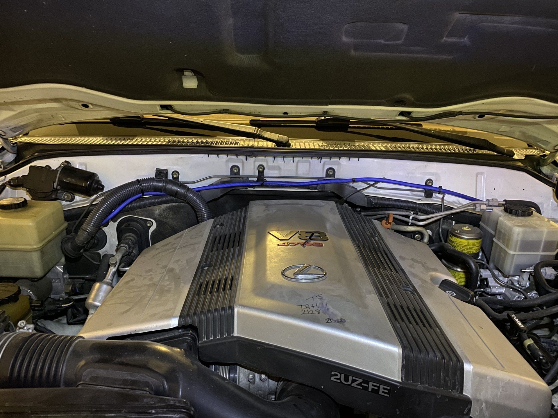

Replaced the camshaft position sensor. Did not take pics, but I accessed it by just removing the coolant hoses in front of the timing cover then ruining my knuckles reaching inconvenient bolts and maneuvering the timing cover.
The dealership who did the timing belt service 20k ago left too much slack in the wire for the sensor and it was rubbing the belt. Over time this caused it to penetrate the wire housing and cause a fault.
On the bright side, performance at idle and accelerating is definitely improved. I think the sensor may have been affecting ignition timing a bit and finally got to the point where it threw a code. For those of you replacing timing belts over 150k, might be a decent idea to go ahead and replace that part since it’s easily accessed during that service and not a very expensive part.
