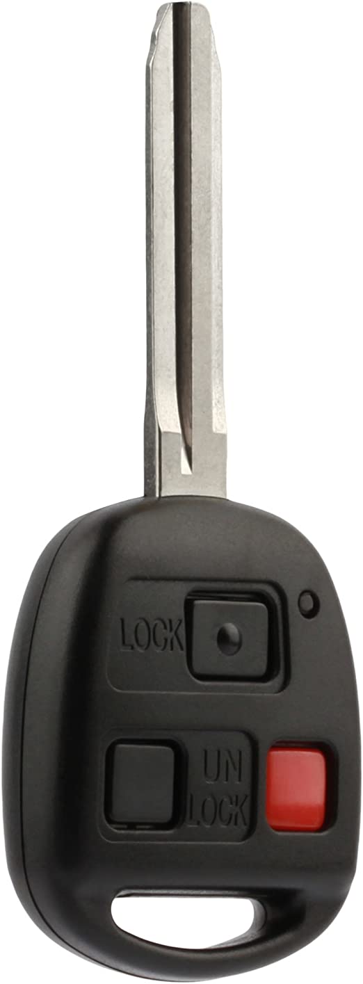

Ordered a new key fob from Amazon over 2 weeks ago... the key literally shipped from the town over from us and got lost in the mail for a few days... so I ordered a new one but had to wait a week for it for some reason since it wasn't "prime" shipping anymore. Anyways, it finally got here and i'll be taking it to the locksmith to have it cut tomorrow and programmed via DIY.
I am beyond stoked to have the ability to unlock/lock my doors with a FOB again. (hopefully) LOL.
