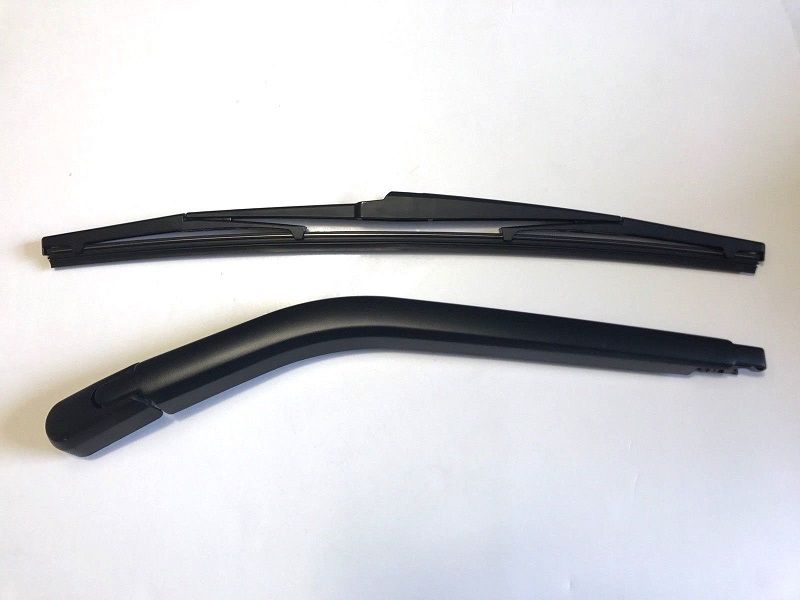

Rear Wiper Arm Replacement_LX
Went out and purchased a wiper arm puller after attempting to pull it off with a couple interior trim tools... :bang:
Popped it right off in 2 seconds. :cool:
Very happy with the result. Very nice fit and finish mates.

Looks great! Is that just an oem lx arm? Im looking to replace my sagging 98 lc arm
Cheers mate. No, these came from Japan (OEM)
These are for the first gen Toyota Alphard/Vellfire vans sold overseas but they're compatible with our 100s.
There were a couple vendors selling aftermarket arms in this style for a quarter of the price, but as some have found out, it's safest to stay with OEM!
Good luck,
G
Unless you current arm is bent or in bad shape, you can reindex your rear wiper to fix the sagging. This upgrade does make the 100 look more modern.
Absolutely correct @trdcorolla ... Mine was sagging but in fact it's still in very good shape. I went for the modern one-piece look. Anyone need a good '05 LX original arm with a Bosch blade refill? Standing by...

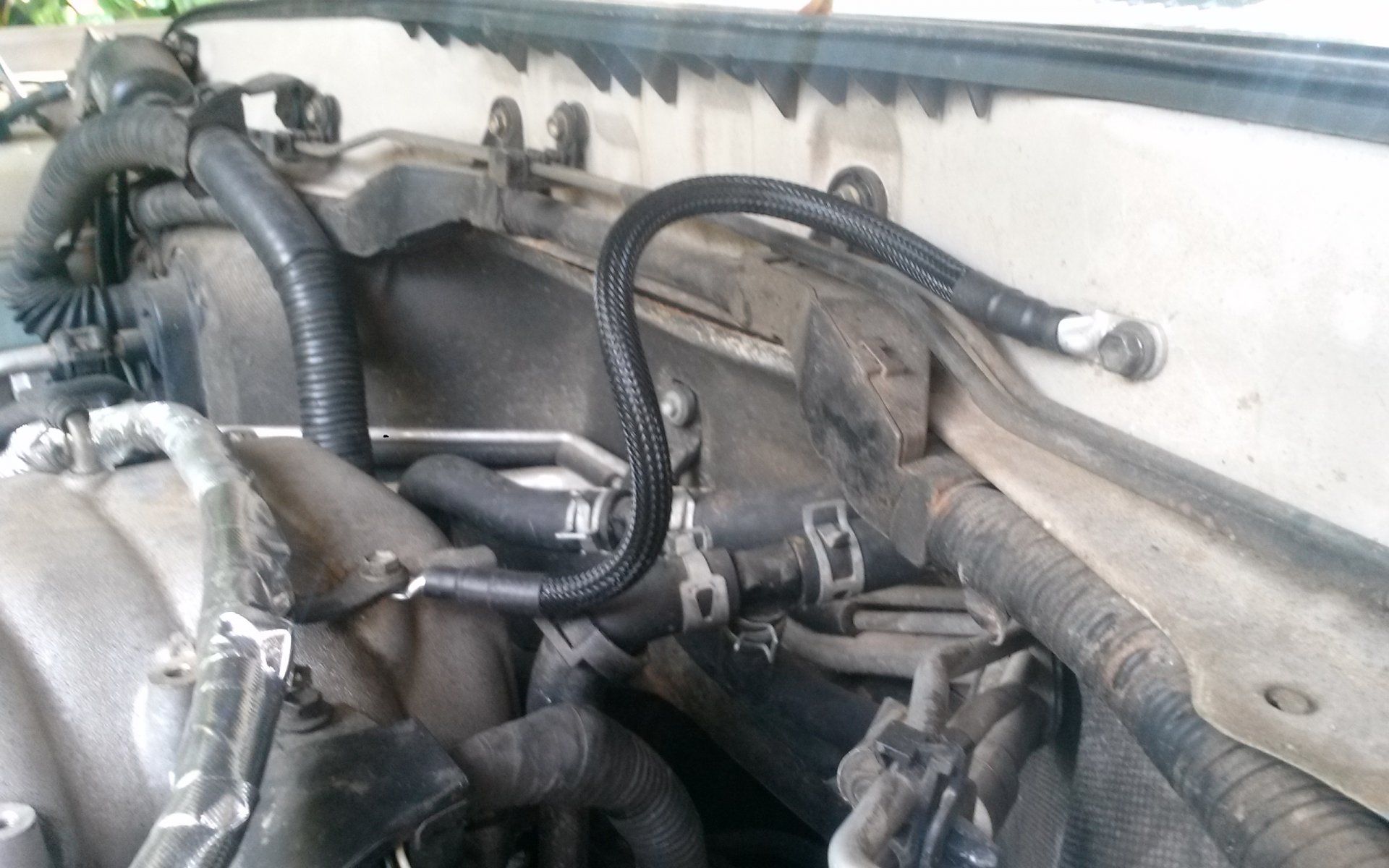

Did the Big Three. And added a slee terminal + extension. Negative terminal will have to wait until I get a crimper.
Sheard a bolt at engine block in front of fire wall, is where I bolted ok?
Also had to shave the bolt at the + terminal to get it to seat correctly.
The fuse link box is a little canted do you think that's a problem?
View attachment 2439306View attachment 2439307View attachment 2439308
Got cables from @TheForger great quality.
Good job! It would’ve been cool if you had a voltmeter inside the cab to have gotten a before & after reading. I noticed an increase of ~0.1-0.2V. I would say don’t worry about any of your questions I don’t see why either of those would be a problem. I had to shave off some of the positive lug on the cable I routed from the fusible link on the positive terminal to the alternator. Yours looks good to me! Also, not sure who you got the cables from but it wasn’t me :)
Sorry for the misdirect, bought the cables from @Fourrunner.
Thanks for your input.

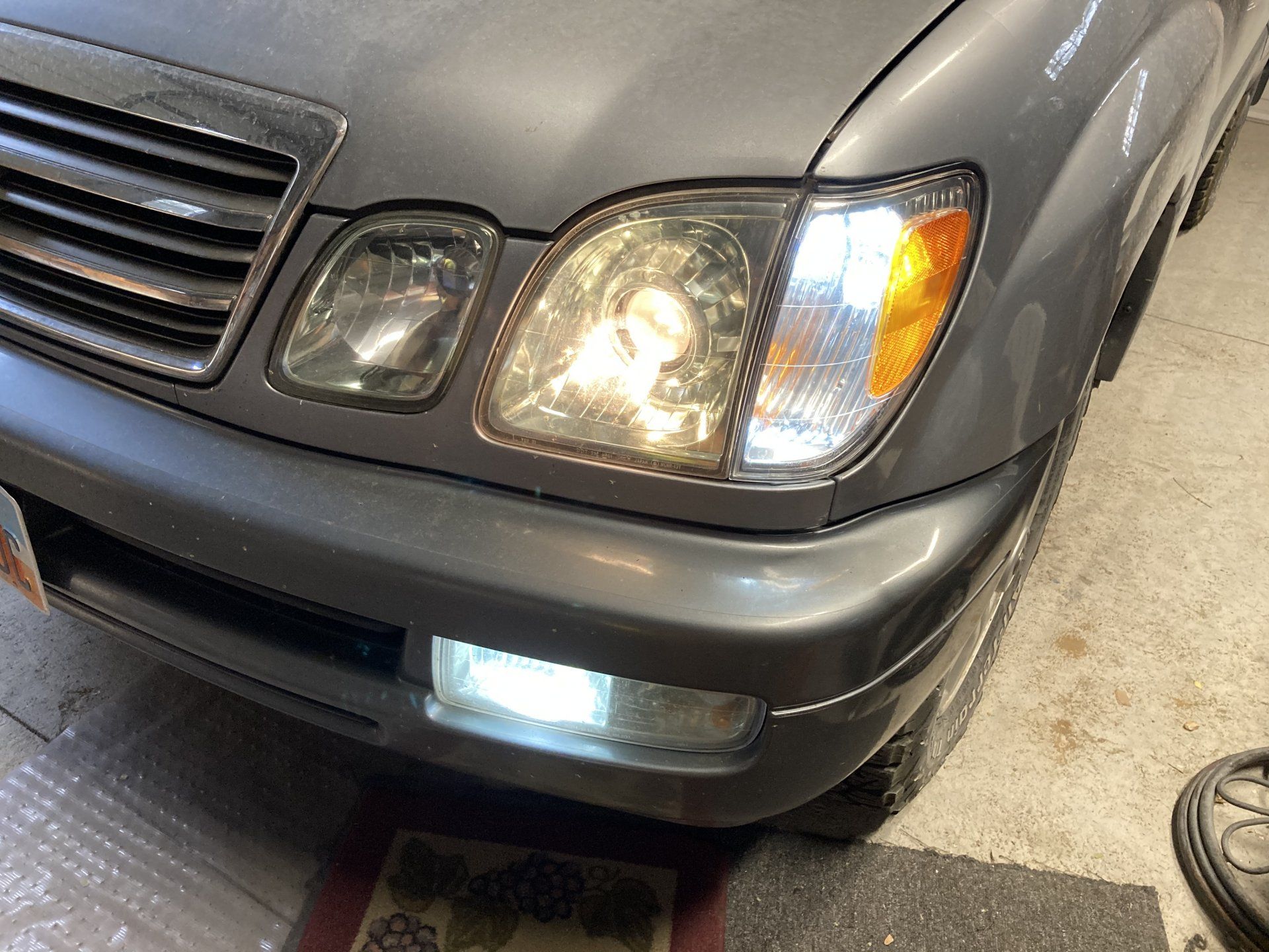

Finally got enough time to cobble together a temporary fix until my insurance company gets their act together with how much damage was done. Thanks to @ClassyJalopy for selling me a clean corner light. New LEDs in there. Also, getting ready to order an ARB front bumper, since it will pay for itself if used even once. Best part is my better half is on board and wants it with the bull bar.
Finally got enough time to cobble together a temporary fix until my insurance company gets their act together with how much damage was done. Thanks to @ClassyJalopy for selling me a clean corner light. New LEDs in there. Also, getting ready to order an ARB front bumper, since it will pay for itself if used even once. Best part is my better half is on board and wants it with the bull bar.View attachment 2439621View attachment 2439622View attachment 2439623
Did you do the flasher relay? That was fun 🤩
Are you replacing ground cables? May I ask why?
