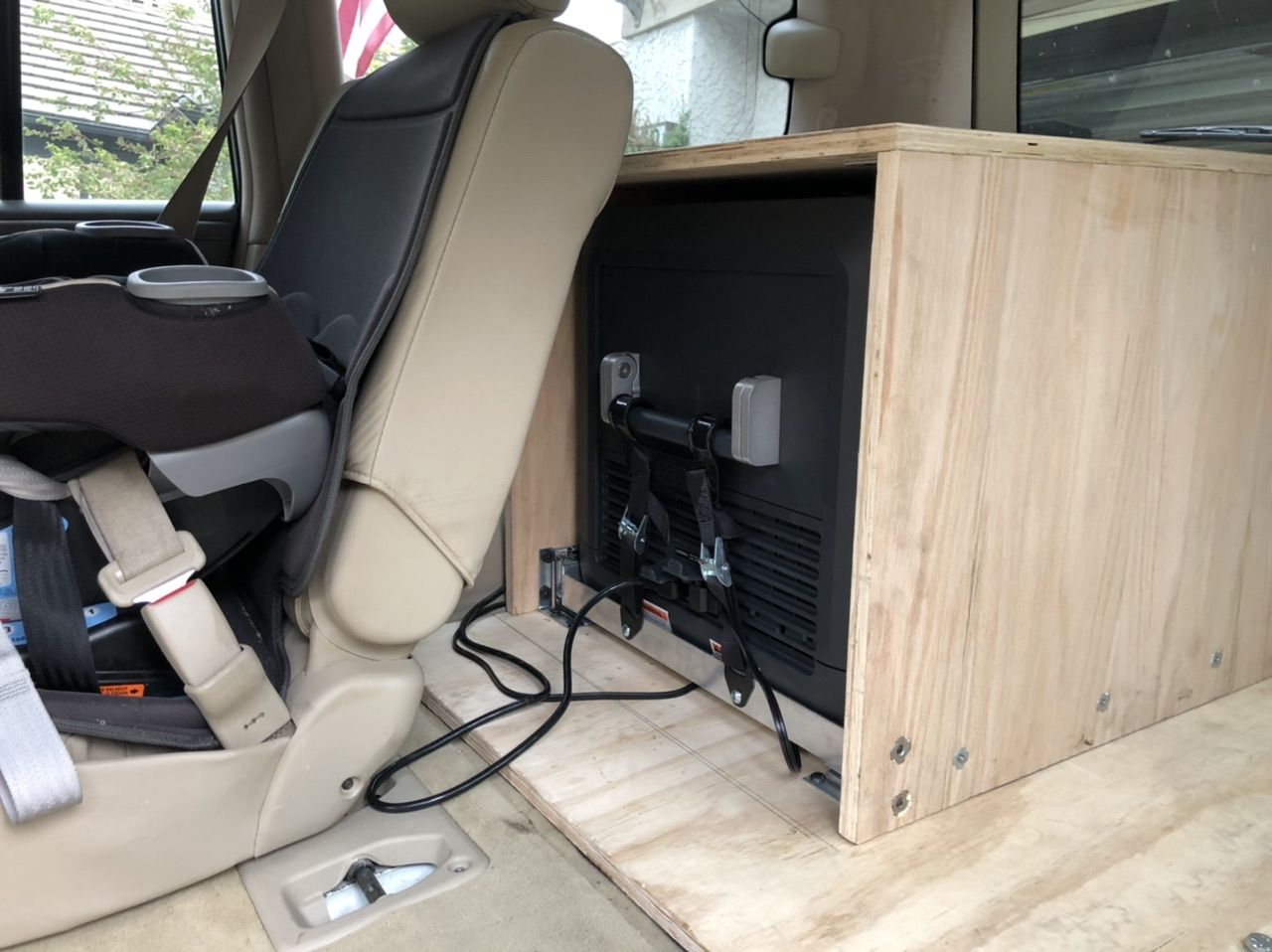

If you stuff your trunk during trips, you might find better fridge performance with the condenser and it's fan facing the rear of the vehicle for better air flow.
I have done some homework and Dometic states it needs two inches of clearance near the vents. As of this trip it will probably stay open like the photos but I do plan to cover the back but adding 4 vents to allow sufficient air. If that doesn’t work I’ll leave it open or add some fans to back. Thanks for looking out
