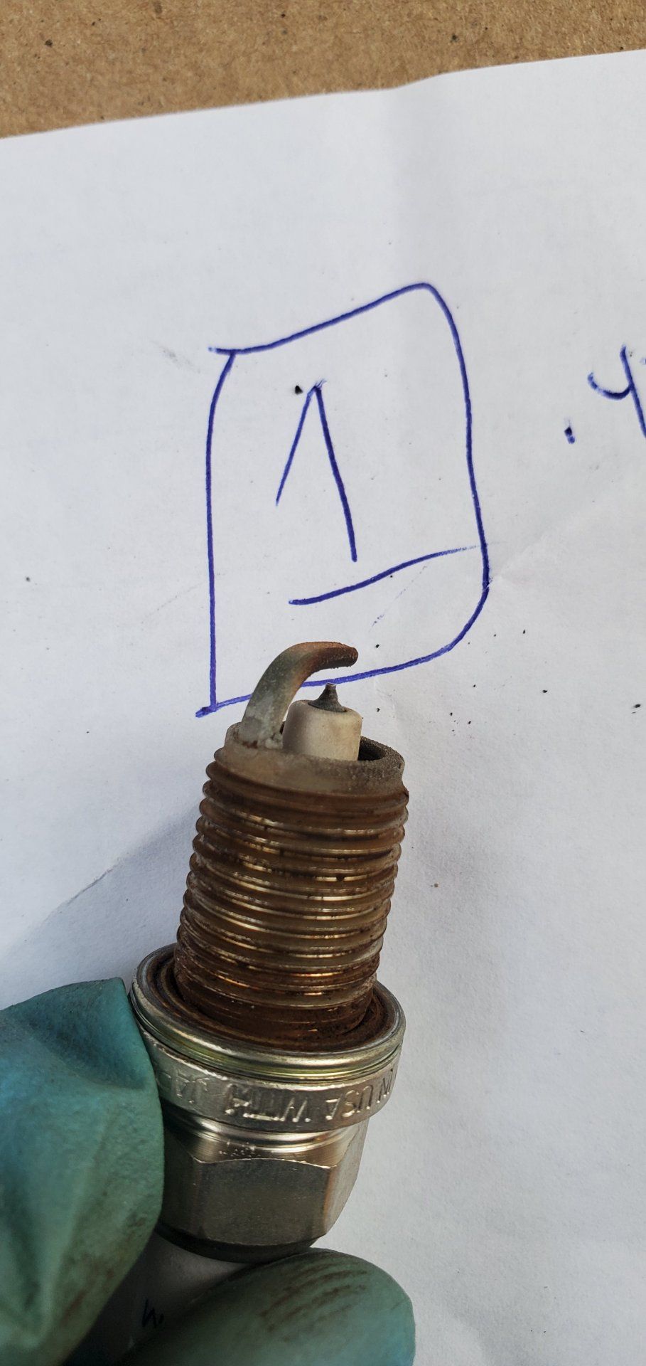

Replaced all 8 ignition Coils with Denso. Expensive but feels really good to have done with the new plugs! One coil was burnt nice and one had a crack but the others looked pretty good.
What was your rig's mileage at the time of replacement @silver02accord ? Did you feel any indications that it was time for a survey or were you playing a hunch? 🤔

06 with 212k miles. I have been baselining so just getting a lot of stuff out of the way plan on keeping truck for a long time (always wanted a 100). Here is a pic of thr one coil that def needed replacing, this was #7 at back of engine bay ds. The spark plug was also loosest on this and coil 5. The plugs were changed 90k miles ago with oem and looked weathered too - gaps were 0.43-0.46

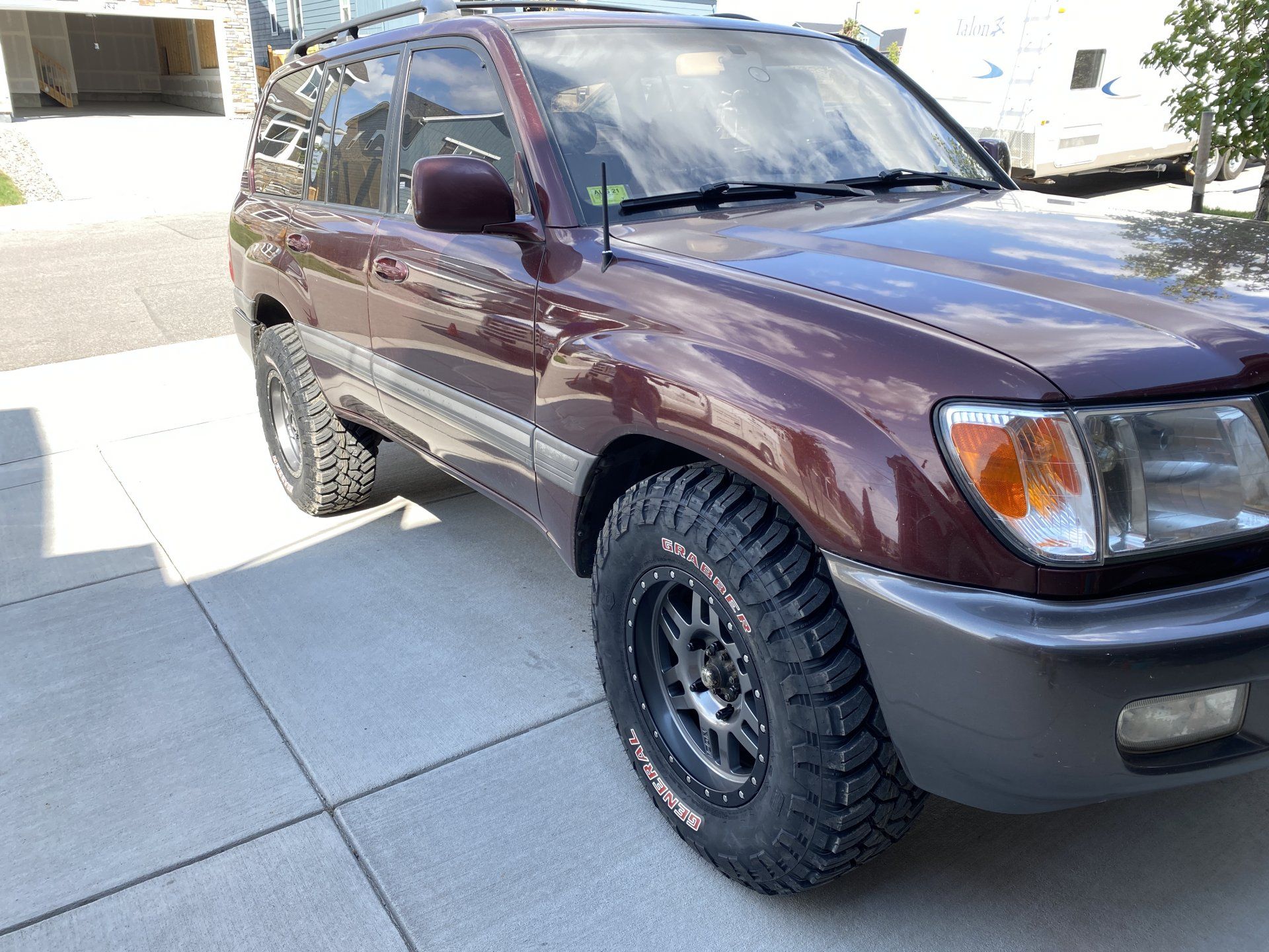

And got the new wheels and tires this week. Had to do some Orange County Choopers style “fabrication” to get the front center caps on.
Link for the antenna and how do you like it so far? I guess I mean in terms of reception, even thought I hardly use the radio.
Did you unplug the antenna motor from the fender or underneath the glovebox?
