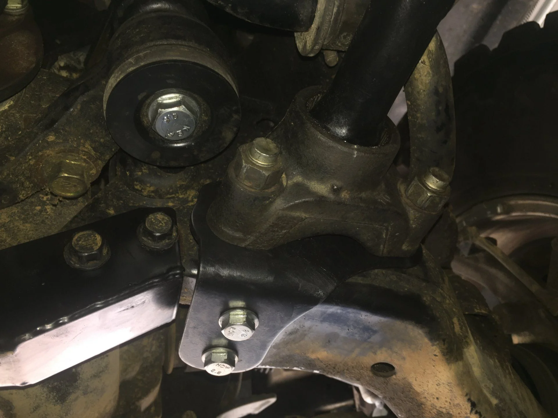

Finished installation of Ironman 2" lift with Nitro gas shocks, control arm reinforcement, Trail Tailor diff drop. Actually finished a few days ago but forgot the control arm reinforcement plates:doh:. While adding the plates I added a spline to the TB. Mine were almost maxed out using the recommended indexing while allowing for 1" rake. Adding a bumper/winch in the future would have certainly required reindexing. Much easier now while everything is greased.
Couple questions--Drove it about 50 miles without the diff drop. Noticed what looked like a small amount of fresh CV grease spray. No tear in the boot, appears to come from the inner clamp at inner joint. Thinking about cutting clamp, adding grease and reclamping. Is there a specific amount of grease that should be in there?
Question 2--I can only get about 2" of droop. I would like to have a little more. Is the limited droop a function of my stock UCAs? Haven't had it realigned yet.
Finished installation of Ironman 2" lift with Nitro gas shocks, control arm reinforcement, Trail Tailor diff drop. Actually finished a few days ago but forgot the control arm reinforcement plates:doh:. While adding the plates I added a spline to the TB. Mine were almost maxed out using the recommended indexing while allowing for 1" rake. Adding a bumper/winch in the future would have certainly required reindexing. Much easier now while everything is greased. View attachment 2331110
A few other members here have complained about new OEM CVS suffering from inner boot clamp failure. Keep an eye on it or just put rolled edge clamps on now. As for the grease, there is a LOT of grease in there (almost half a cup!) I wouldn't worry about adding any but contamination can be a concern if the clamp fails.
The front droop sucks balls on these IFS trucks. Remember all of it comes from the control arm bushings flex. And it is definitely limited by the UCAs.
In my experience the Nitro UCAs did give me almost another inch and a half of additional droop so if you wheel her than maybe consider those. FWIW I wheel my truck on stock UCAs all the time and can't seem to find much fault with stock UCAs.

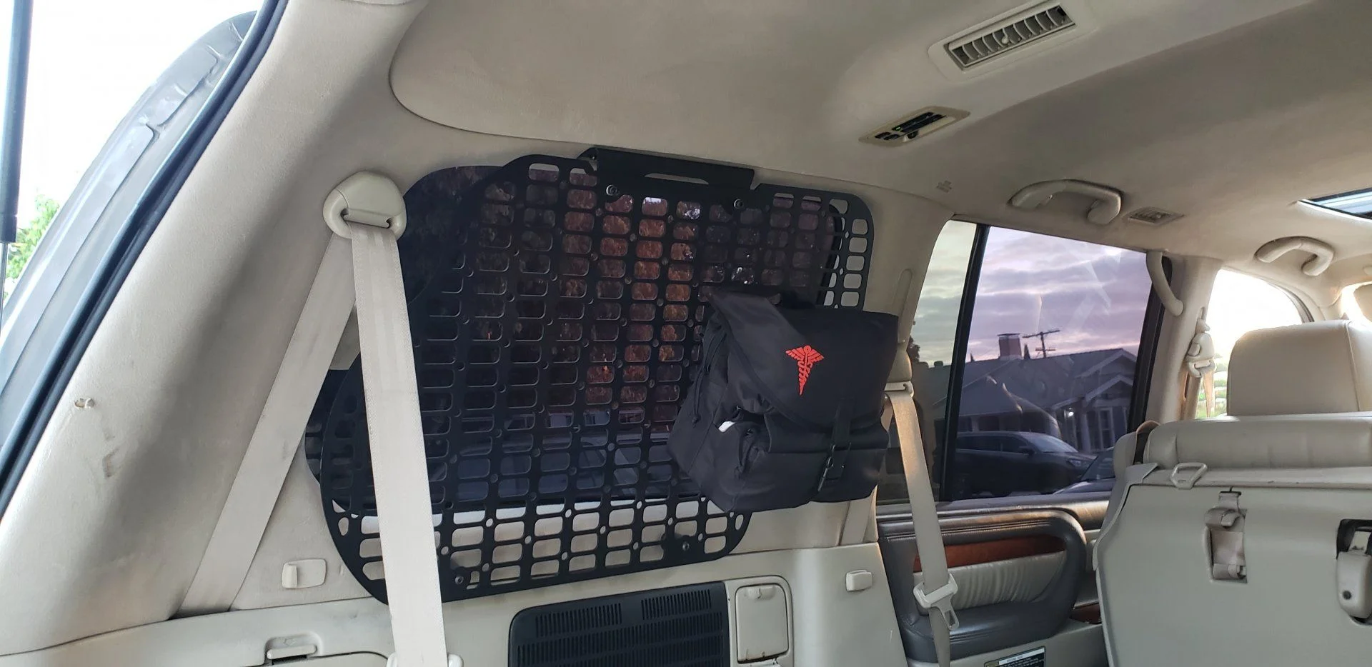

Installed orange boxx fabView attachment 2331059

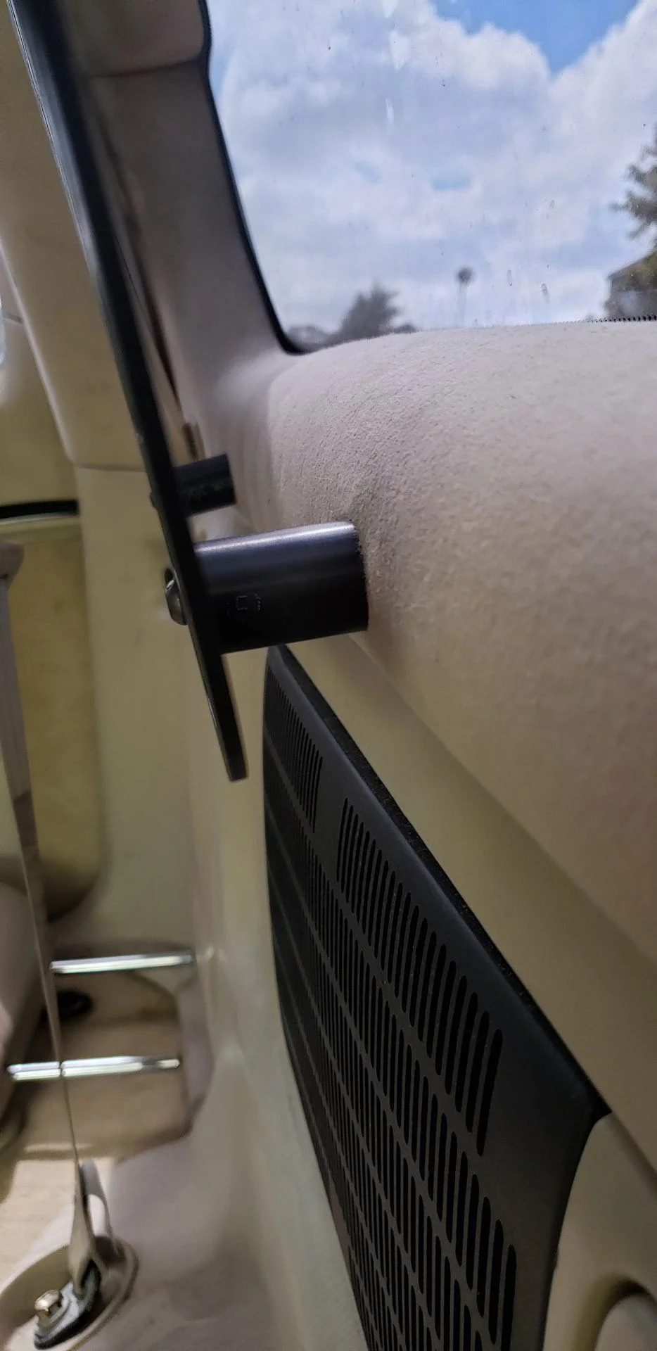

Nice! I've often thought about getting one. Do you happen to have any photos of the two mounting points at the bottom? Looks like you have to take off the trim and maybe drill a couple holes for the screws?
have to remove lower trim and drill 2 hole on upper trim. What i did to re inforce the bottom i drill tru trim and metal behind trim. added rivnut for better support.
