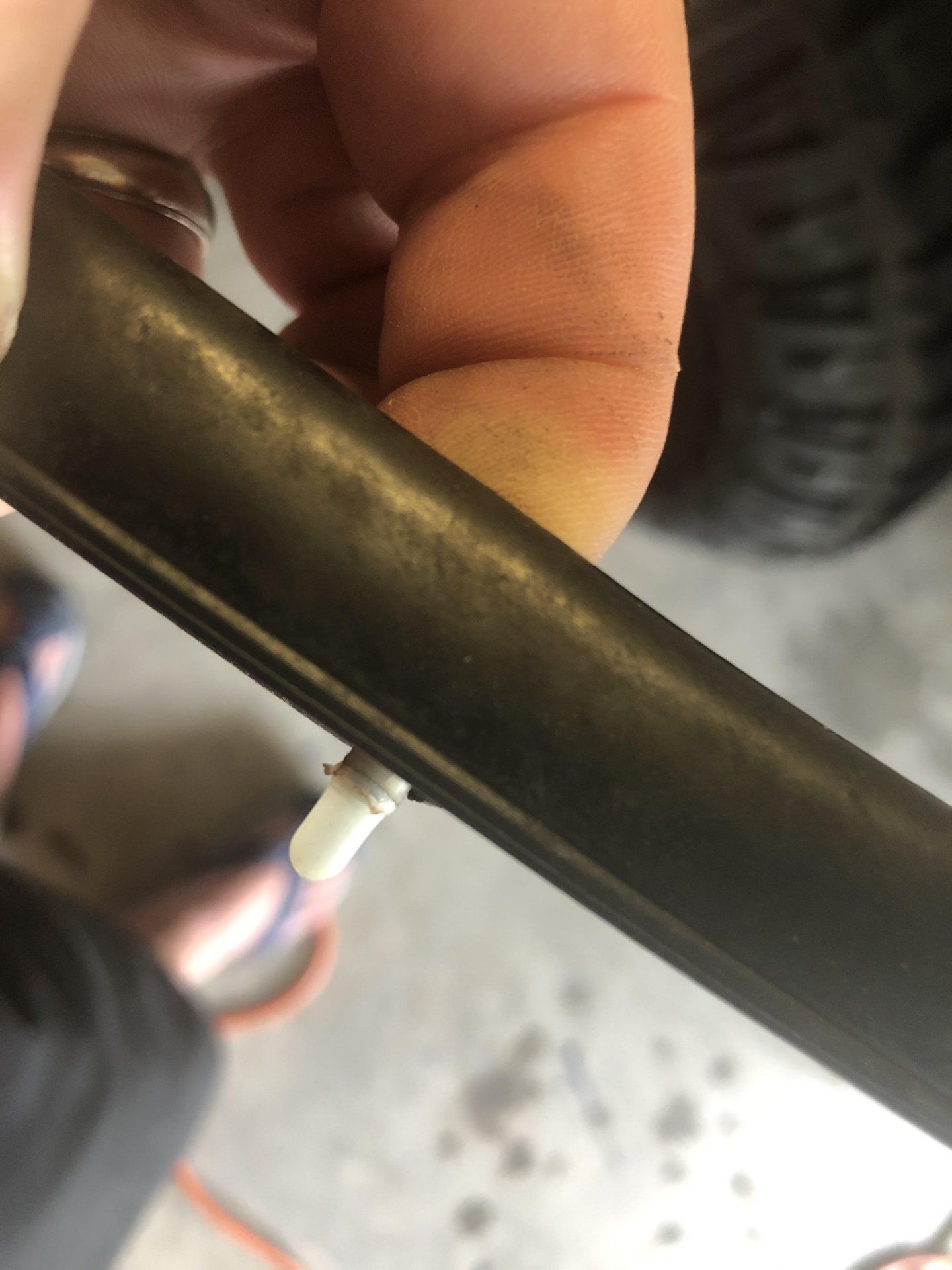

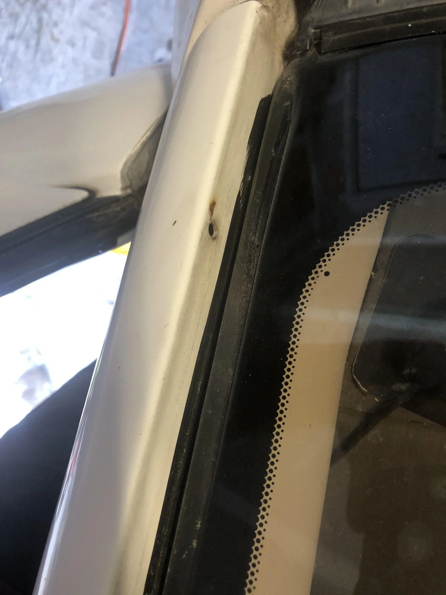

Decided I've waited too long to investigate the water-in-the-driver-floorboard issue. Could be the following: sunroof leak, roof rack rusty bolts, windshield replacement.
Sunroof no longer opens, but I don't care. Either way, I removed it and checked the drains. There was a little gunk but water flowed to the ground.
Had to remove the roof rack to get it in the garage and begin this process. Everything looked great. Only one bolt had any water on it and it wasn't rusted.

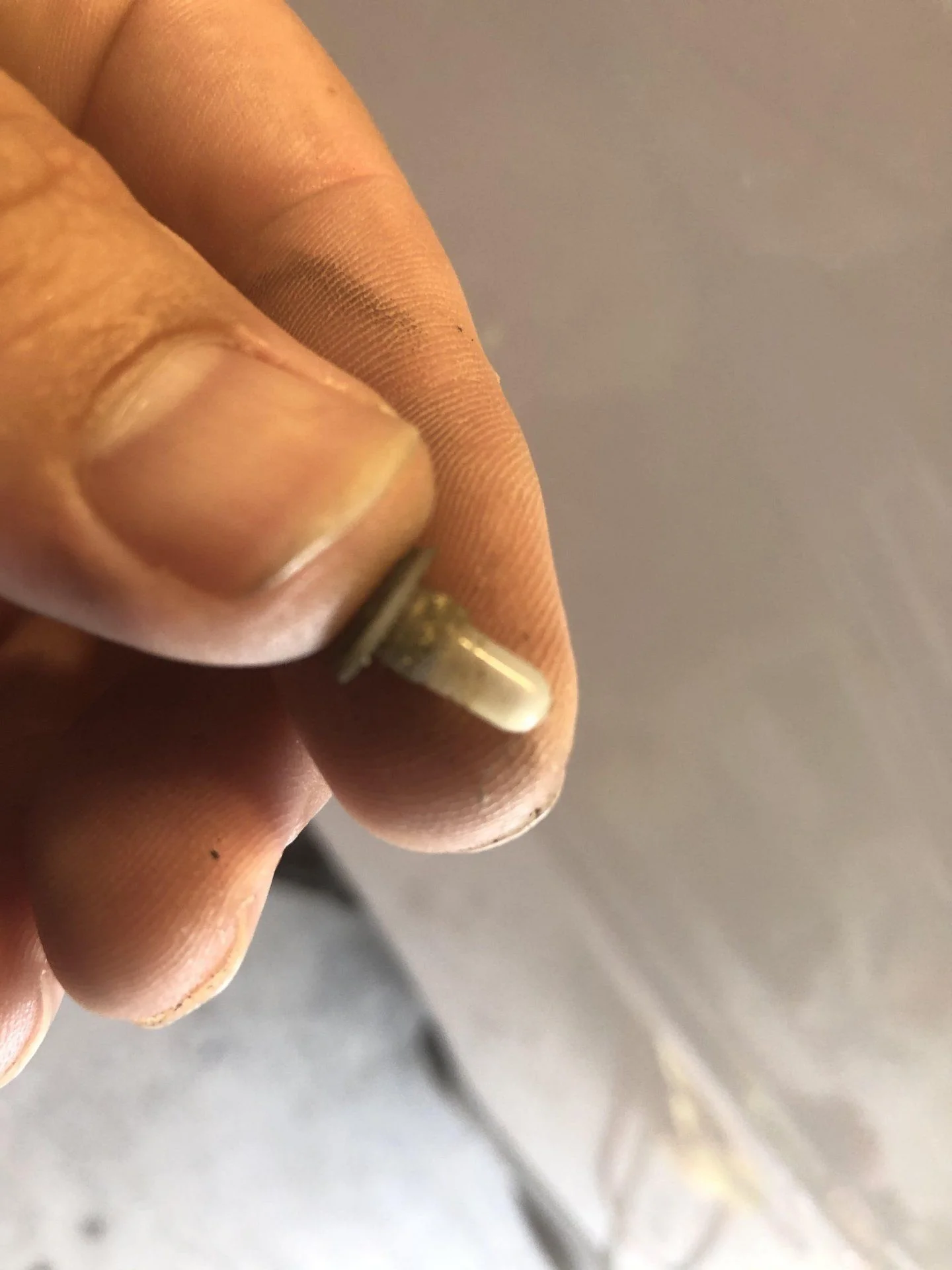

I had almost decided to bypass the windshield. Even though it was replaced a few years ago, I could tell rivets were used and I haven't read anywhere on mud that anyone had a problem with rivets. Screws? Absolutely. Rivets? No worries. Decided to check anyway. Started to carefully pull away the rubber cover...
and the whole damn thing comes off the truck with the rivets attached to the seal! WUT?
I'm not sure where to begin with this. I can tell the holes have not been drilled so the rivets should fit, right? What am I missing? What questions should I ask?

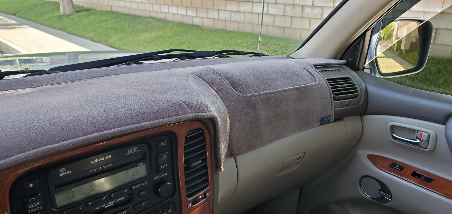

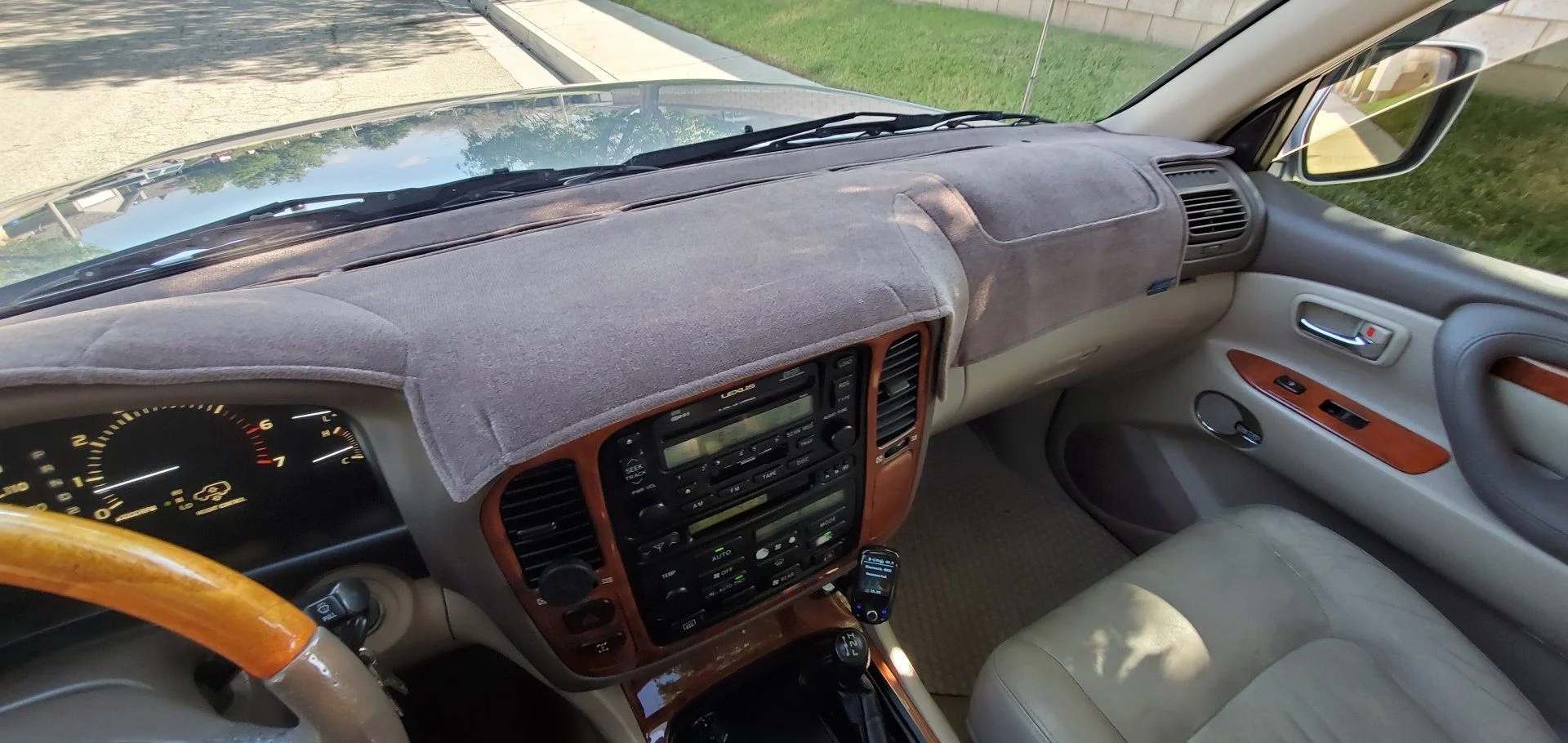

Summer coming up, installed dash mat to help with glare and reduce radiated heat from dash... also have 70% windshield tint to help.
Got samples from 3 companies to find a color that matches the 2 tone lx interior, taupe from dash designs in velour was the best match for me.

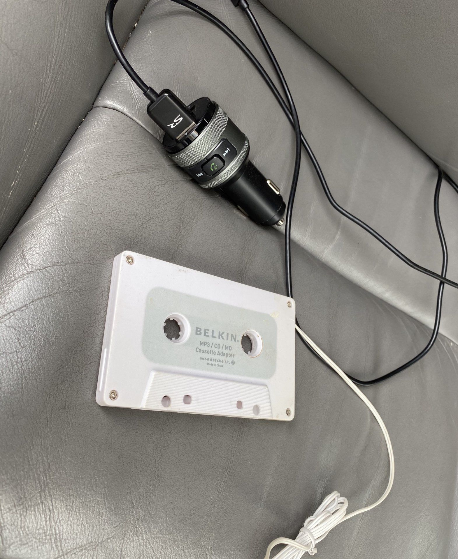

Cassette adapter.... that’s OG. (Ask me how I know)
